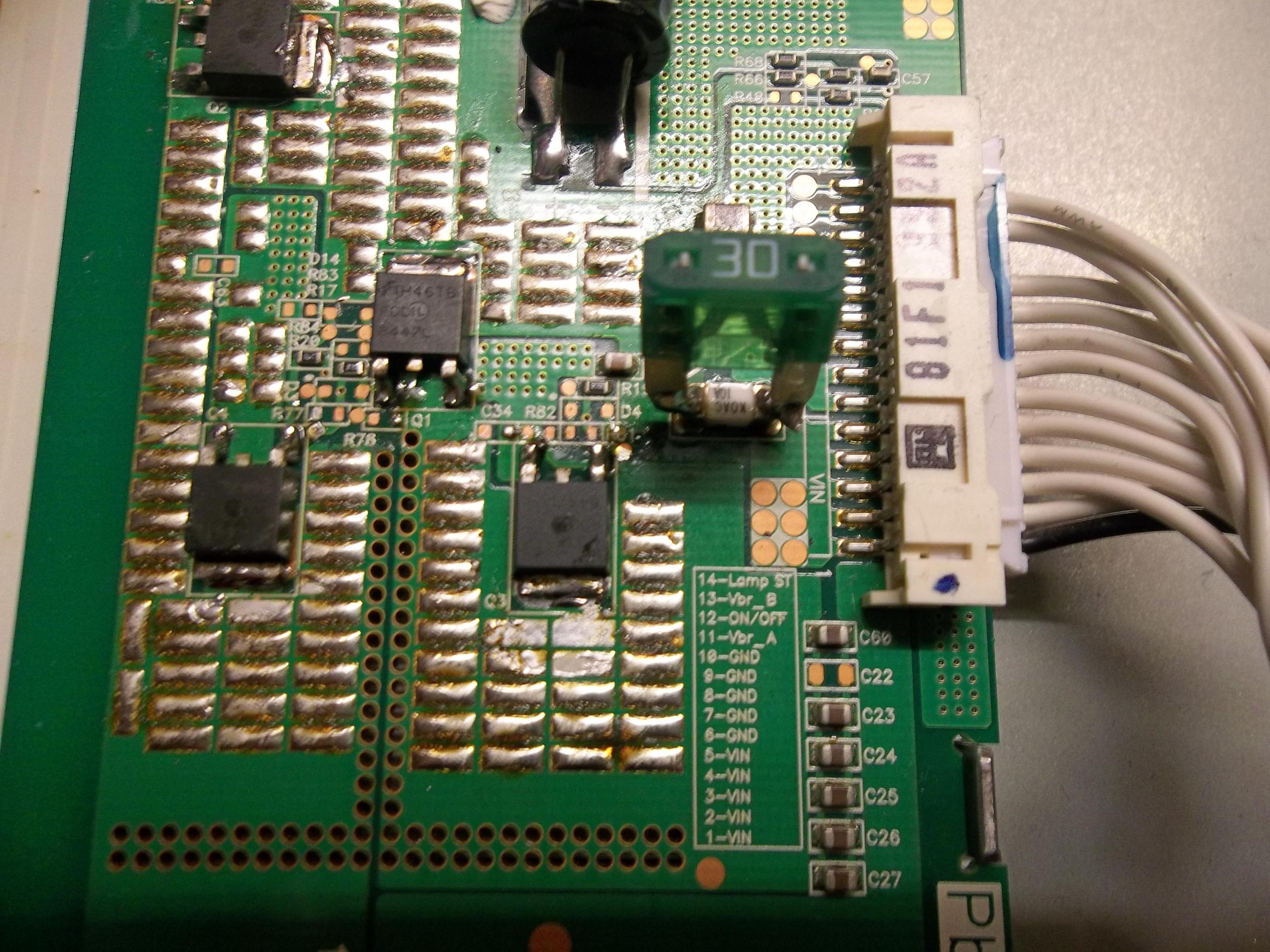

        Alright guys I'm looking for a replacement smt fuse. Here are the specs, 10A/60V DC.
        I narrowed down a search here as per the size but the exact ratings are not available, between what parameters can I choose the right one?

          Hi go for the 10A/63V fuse if the physical size is ok - it is sometimes easier to piggyback the old one than risk messing up the pads.

              I've even gone to Radio Shack and bought a regular size fuse holder and soldered it in.
                Re: Vizio VO47L FHDTV10A No display
                A 10A automotive fuse can also be a quick fix.

                        Hey I appreciate the effort guys. Now both those are way smaller. This fuse is about 6-7mm in length. The search criteria I posted before had a list of a bunch around the same dimension.
                        Maybe I should order a smaller one and compensate with solder to reach the pads?

                          Big thanks for your ideas, here is the result
                          Dont mind how messy the board looks. It was nicely cleaned afterwards.

                              But is that a 30A fuse? Kinda bypassing the point of a fuse with one of those...
                                #35
                                10a 125v
                                  #36
                                  Was talking about the picture where he has soldered what appears to be a 30A fuse across the current one.

                                    That's right Tom66, I picked it up by accident since they had it in the wrong bin at Radioshack. So I though I'd try it and it worked.
                                    I'll replace it with the right one when I can stop by tomorrow or something.

                                      Well with a 30A fuse, you'll know which component downstream maybe be shorted. Just look for the giant hole where that faulty component formerly dwelled.

                                        Can I go that high on the voltage then? The rating for the original fuse was 10A/60VDC.
                                          #40
                                          The voltage indicates the maximum voltage the fuse can safely interrupt. It's a value you make equal to or bigger than the original.
