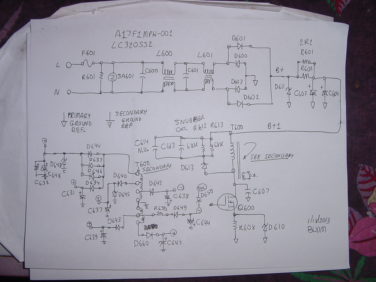

    OK, I just trace out the board. Check D611 to see if it is shorted.
      #42
      Re: Sylvania lc320ss2 LCD TV keeps blowing fuse
      OK, this is the best I can do due to the white paint masking on the bottom side, I cannot trace out the Gate drive, but this will give some idea what to look for on the board. You can see that it has many Zener Diode across the output of the power supply, they need to be checked.
      Check Q601 and all the Diodes in the primary side, Q601 could have been damaged also when Q600 shorted out.

                That's a lot of work @budm, thanks for taking the time.
                Yeah I had previously checked d611 and it was alright.
                Short of maybe 2 or three I think I checked all the other diodes on the primary side.
                I'll try a few things now and report back.

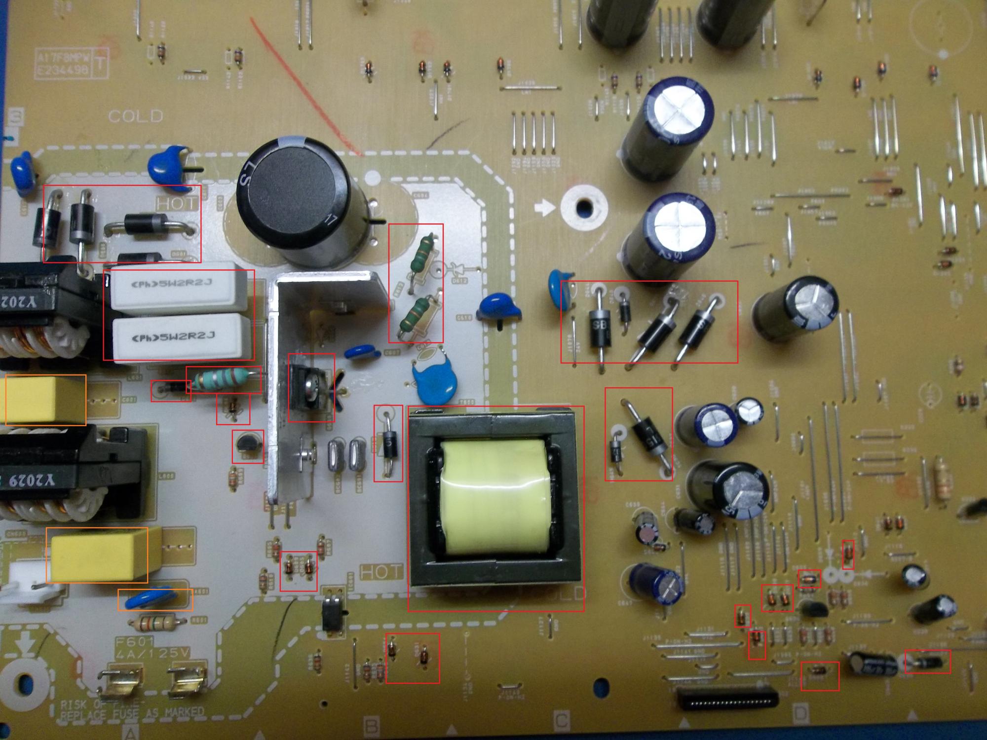

                                  Here is a picture highlighting the components I've tested today and also some from before. The ones enclosed in a orange square are those I'm not sure how to test therefore I opted for removing from the circuit (one at a time) and test to see if anything changed and it did not.
                                  The ones enclosed in red are the ones i've tested and found to be good.
                                  The two big inductors checked out ok with the blue ring tester.
                                  From the bunch of diodes (orange/black) there were a few reading higher than the rest, around 700+ where most other ones would read around 500 just to point that out.
                                  Would love to learn when and when not a component could be tested in-circuit. You know just a few things I could start learning like "you can check a given component in circuit as long as it doesn't have a certain component in parallel/series etc". I currently have an analog meter, a digital meter, a capwizard and a bluering tester.
                                  Also was wondering if using a lesser watts lightbulb (currently using a 100W) could help in getting the shorted component be spotted out easier due to it getting hotter. At the moment the only components that get slightly warm are the large cement resistors and the rectifier diodes, if I remember right.

                                    So is it still blowing fuses?
                                    Sometimes the lightbulb trick doesn't work for these designs, due to the self-oscillating nature. It'll just stay lit as the circuit oscillates.
                                    A lower power lightbulb would lead to less heat, not more.

                                        I wouldn't dare try it without the lightbulb. Last time I did, I had to replace some of the new components again plus thefuse which it blew up horribly. Since it's very bright and I'm not getting the right voltage on the filter cap I'm thinking there's still something shorted. And of course this is while on stand by, and the tv wouldn't turn on so...
                                          #60
                                          With the lightbulb in place and a self-oscillator failing to start you'll see nothing across the primary cap.
                                          Eventually you have to, unfortunately, risk it without the bulb, unless you have a variac to slowly ramp it up.
