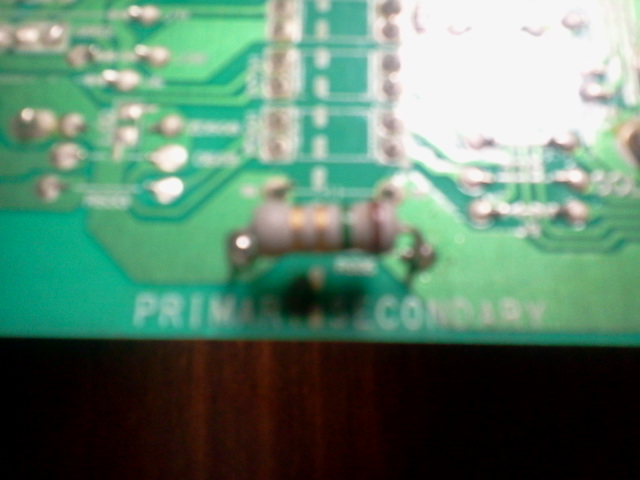

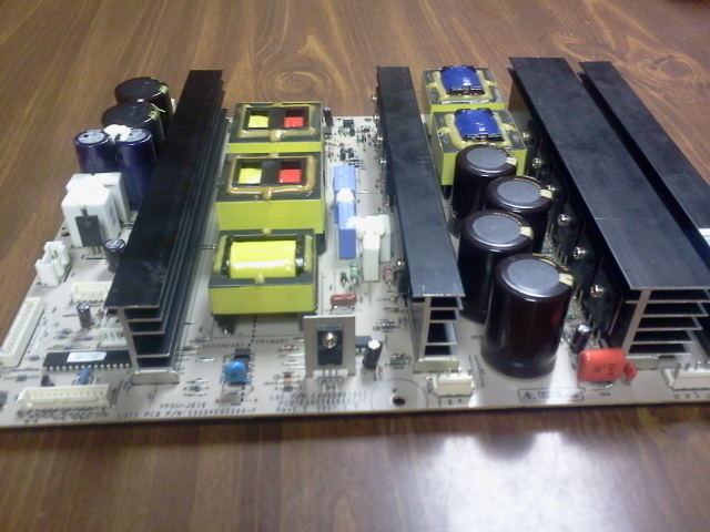

                  i put a repair kit on the (sub power board) i still have the clicks , but their not as often now?? i did notice a resistor on the large power board had a chip out of it or it went bad,, someone put it on the board ,and put it on the wrong side lol,,,so now i know that the lg and smaller board was messed with. i will need help on finding a new resistor, i will put a picture of it up later , i think the number on the board is r995 on the powersupply board eay32961801.

                      Measure the Vs voltage with and without the Y-sus and Z-sus connected.

                        this is one more pic, there is a burnt spot under that resistor . anyone know what size or where i can get another one from ?

                          Re: lg 60 pc1d recycles clicking
                          Is that on the bottom of the board?!
                          • tocold4u2
                            • Dec 2012
                            • 284
                            • usa
                            yes that is. i think someone was trying to replace parts ???
                              Is there a footprint marking for it on the top?

                                A low ohm resistor bridging the primary to the secondary?! Is that not safe?!!!

                                  im gona say that the part was put in wrong by previous owner, i tested vs and va they were both low vs 160 should of been 190 va 30 should of been 60 the still has the recycling clicks but its not as often as before. it is kinda hard to get a good reading when its doing that!!
