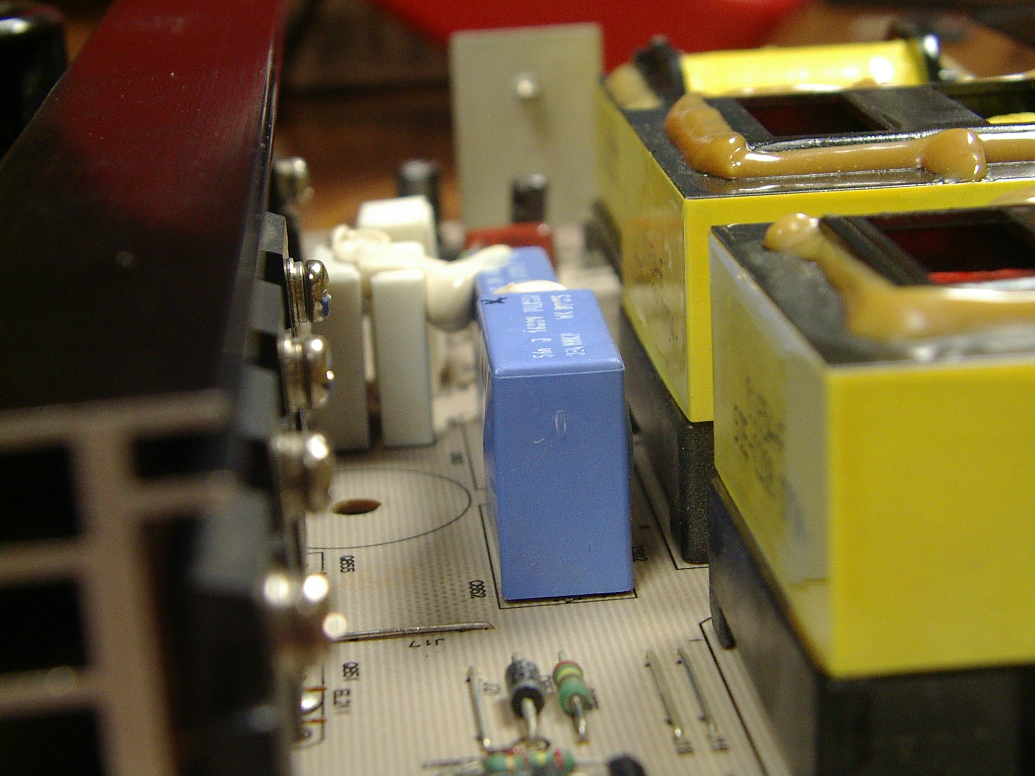

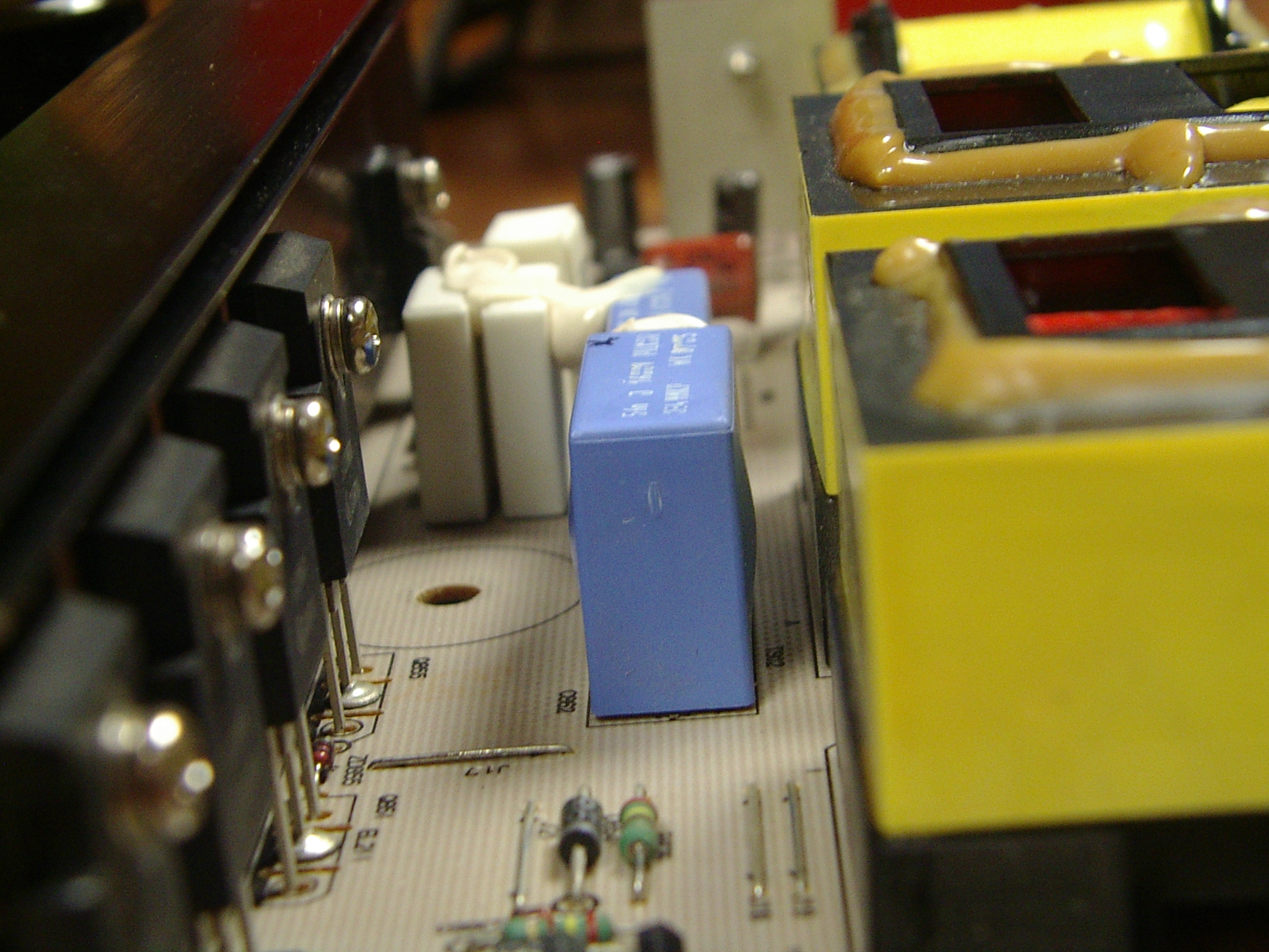

                                  #96
                                  Re: lg 60 pc1d recycles clicking
                                  i was looking at my power board scratching my head and i noticed a buldge on
                                    #97
                                    Yeah, if that's for Va, it could easily cause low Va.
                                    • tocold4u2
                                      • Dec 2012
                                      • 284
                                      • usa
                                      #98
                                      let me see if i can get another picture
                                        #99
                                        It's quite possibly the fault at hand -- try replacing it.
                                        • tocold4u2
                                          • Dec 2012
                                          • 284
                                          • usa
                                          #100
                                          well thats great atleast its a start lol kind of
