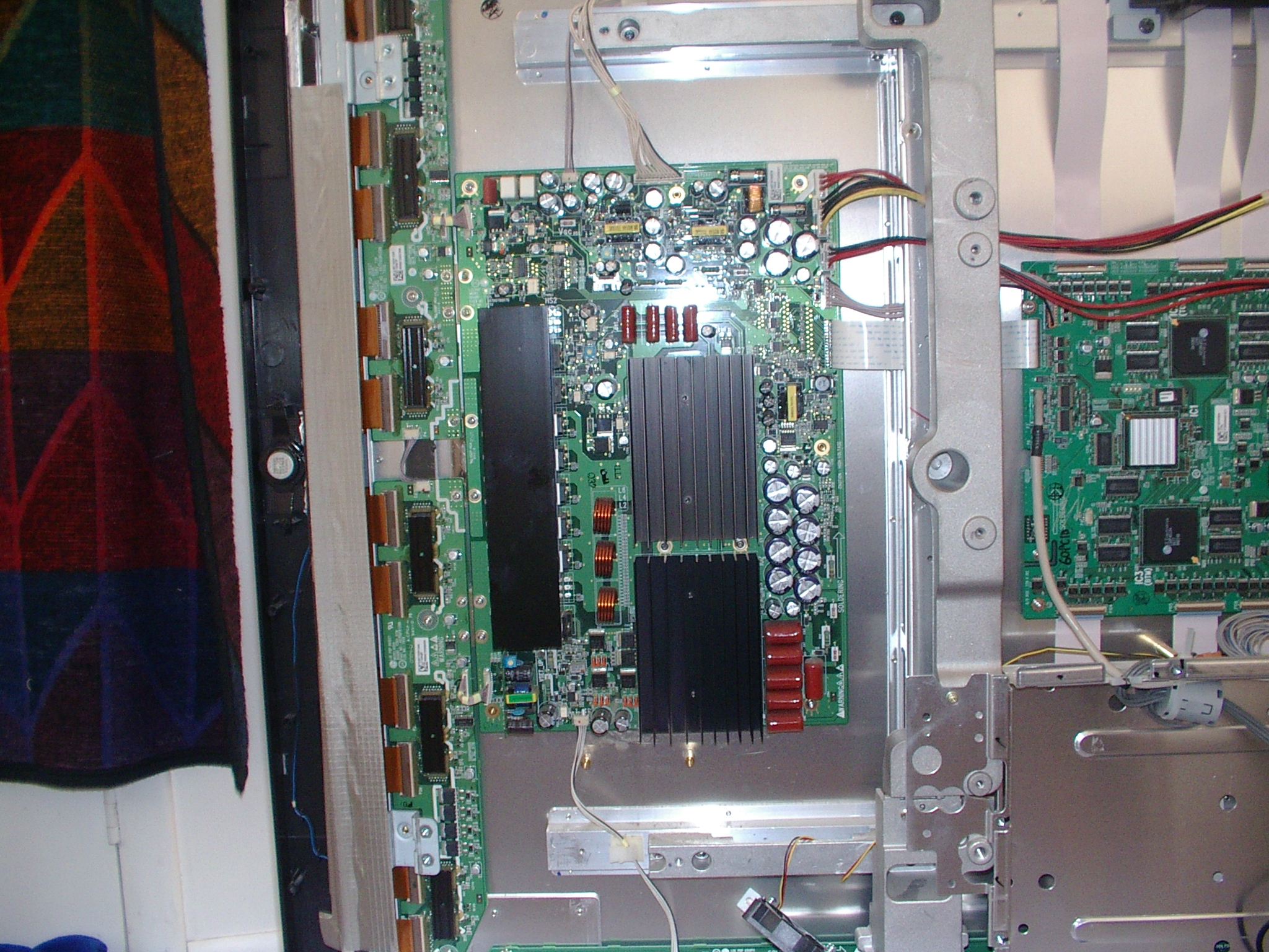

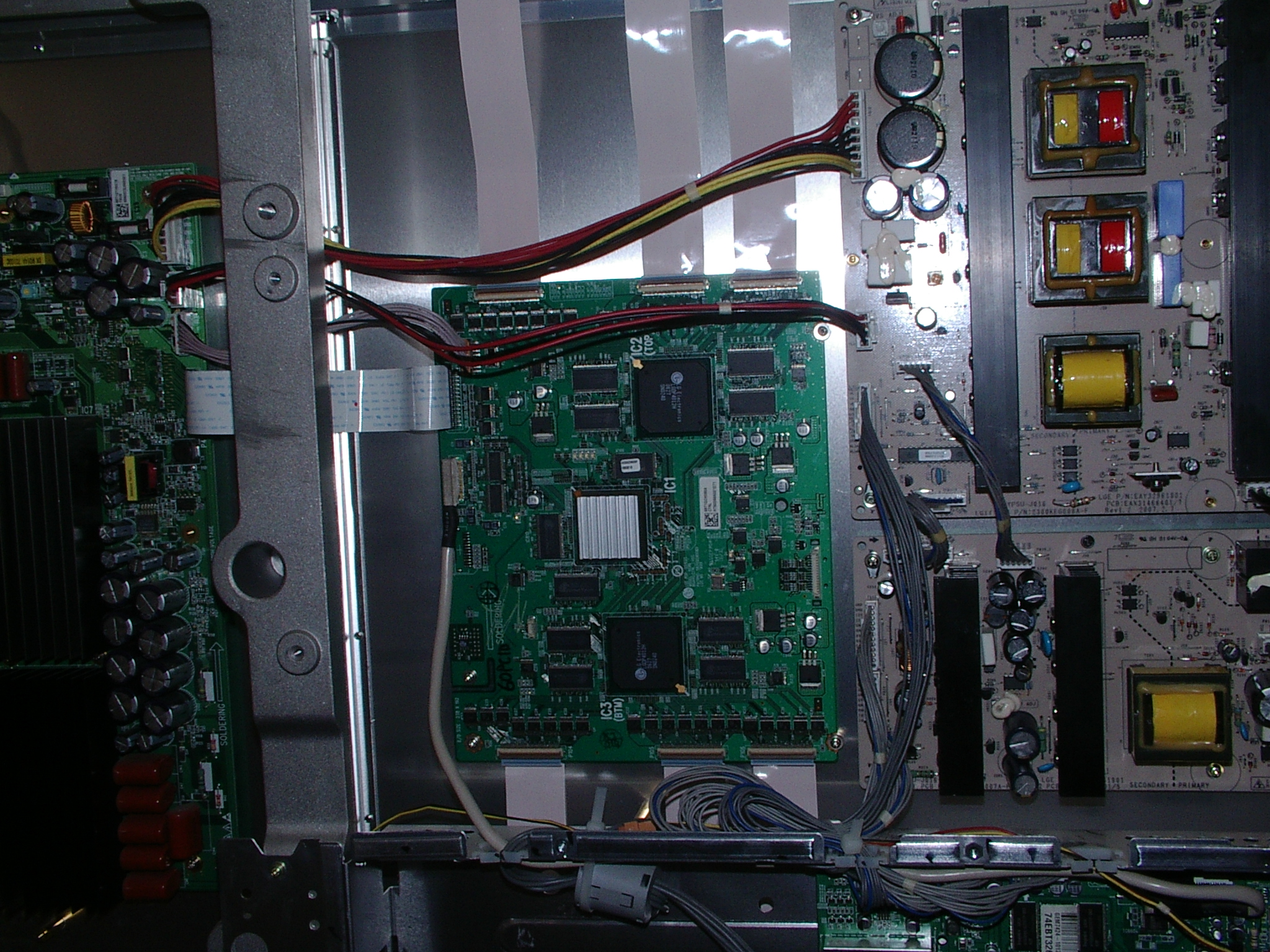

      im posting pics of each board one at a time so give me a bit cause its gona take me awhile,,,,,,,not sure if it has to do with these windy conditions or what??

          #64
          Re: lg 60 pc1d recycles clicking
          the y main
                another one
