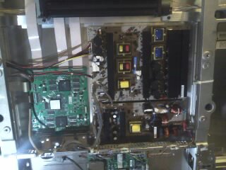

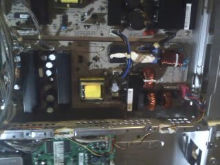

                Can you supply a top-down picture of the PSU?

                    #49
                    Re: lg 60 pc1d recycles clicking

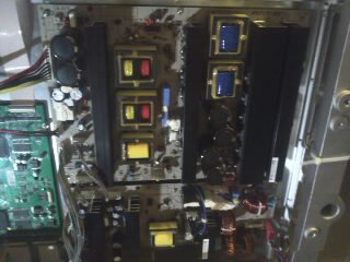

                    here is 2 pictures

                      #50
                      could i have a shorted board ? or a pannel?
                        #51
                        You need to try the DC volts scale of your meter on a battery. Outlet is good and all but only tells us if AC scale works.
                        We will need a clearer photo than that.
                        If the Va (panel) was shorted you would likely see 0V though you could rule it out by unplugging the Va wire on the Y- and Z-Sustain boards. Be careful, do not plug this in while the set is running.
                        Va is only used by the plasma panel drivers which are bonded to the panel. So either panel is shot, which is very rare to be honest, or the PSU has a problem... bets on the PSU.

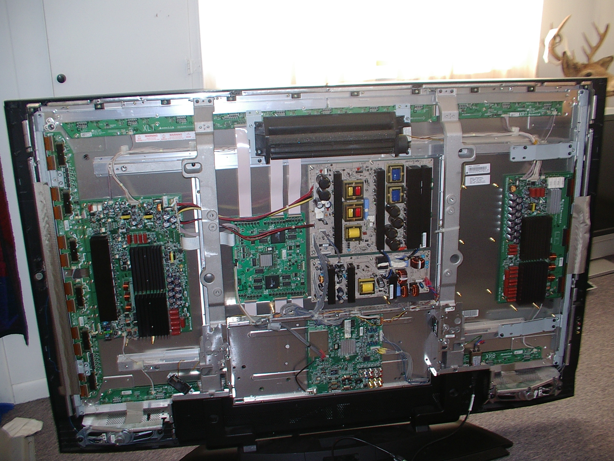

                          here is a few more pictures

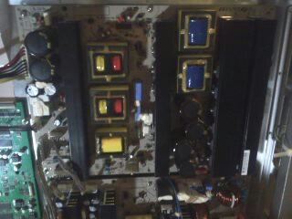

                            #53
                            and here is two more
                              #54
                              Again, I can see very little in those photos.
                              Remember the photos are my eyes. I do not have this board in front of me so I do not know what it looks like and how it is laid out.

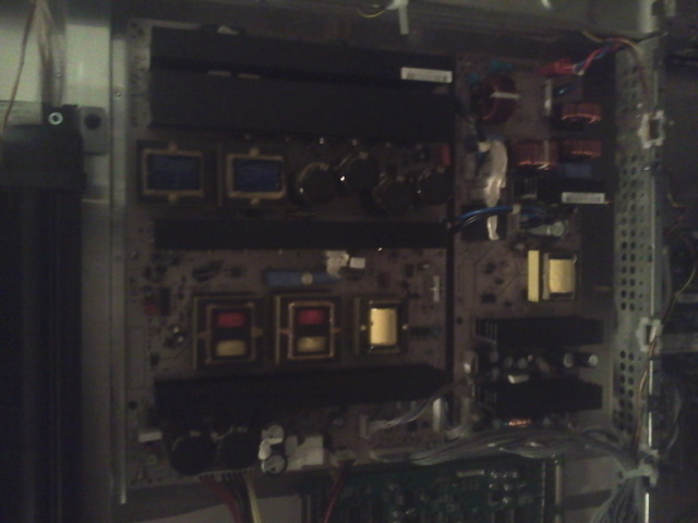

                                #55
                                i have some pictures that i took with the camera instead of the phone,,,,i just got to figure out how to make them smaller first. and i tested a battery,,,,,,1.48 so yea its working

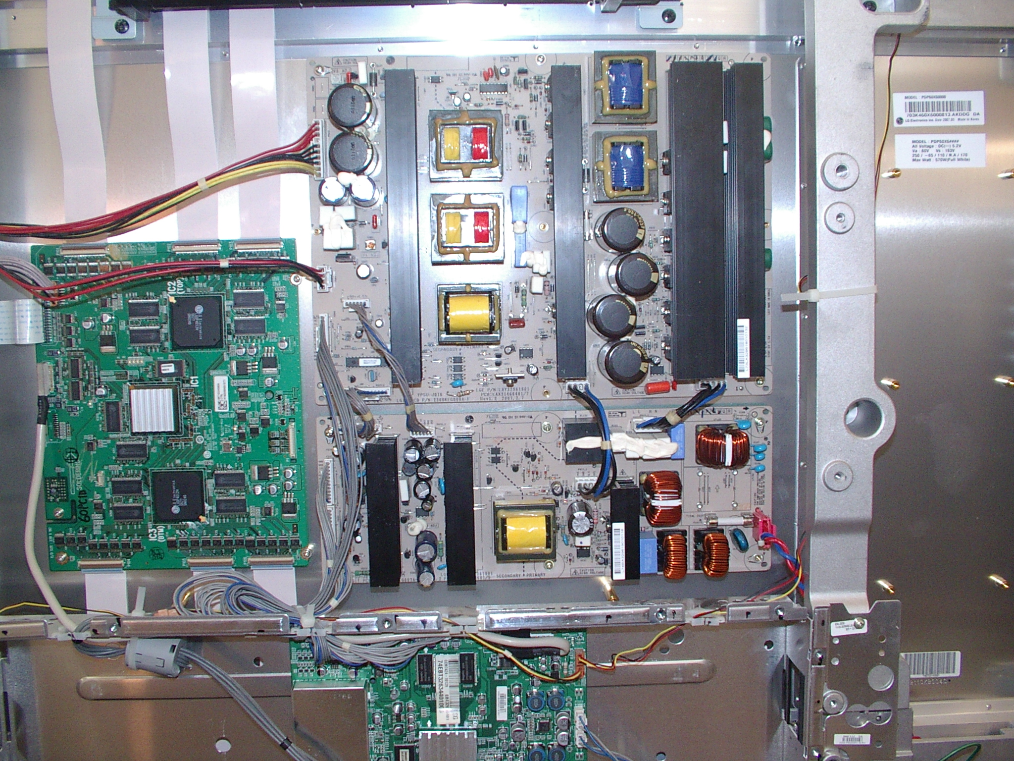

                                  #56
                                  i hope this works
                                    #57
                                    I still need clear pic of PSU, as close as possible to 2000x2000 pixels.

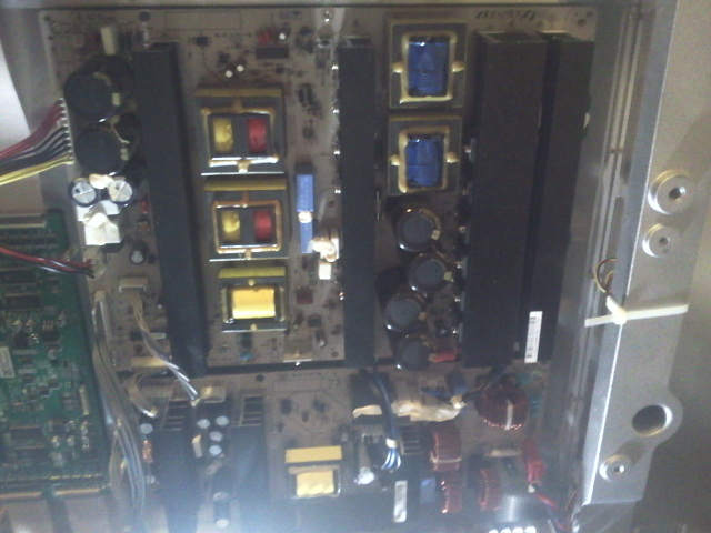

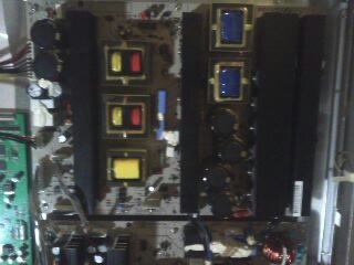

                                      #58
                                      these are 2000x1600 i can only load one at a time
                                        #59
                                        I need a pic of the PSU only. Remember your pictures are my eyes I do not have this chassis in front of me and have never worked on it myself.

                                          #60
                                          first pic
