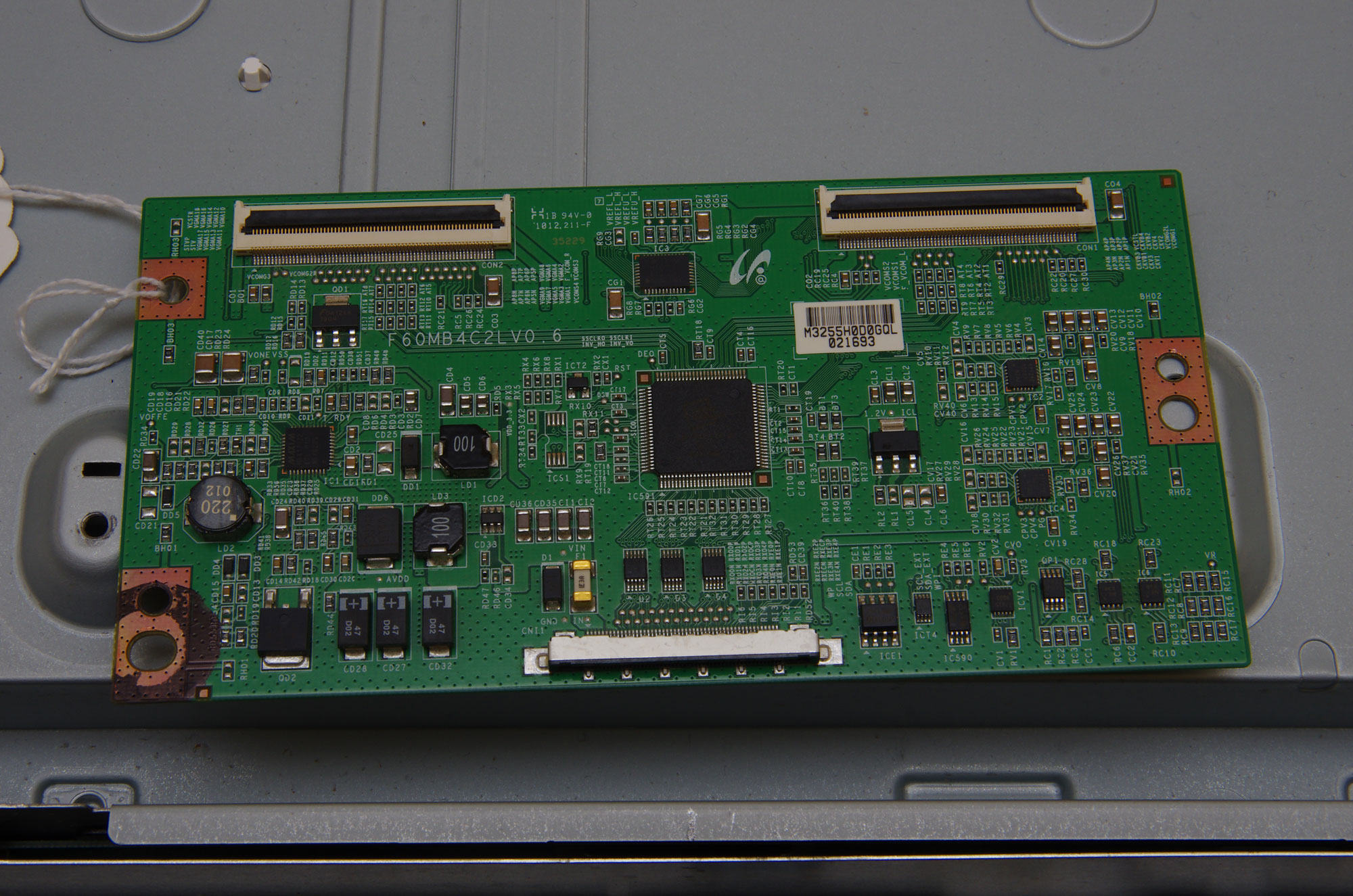

    It has been to a local TV repair shop who produced a repair report which I'm using to try to get original retailer to repair under EU law. Unfortunately, this is turning out to be a protracted battle and so I thought I would look at fixing it myself.
    The report said "faulty T-Con" so I have purchased a salvaged T-Con part, carefully matching the part numbers, and replaced this in the TV but it's exactly the same. I guess there is a chance the replacement T-Con is also faulty.

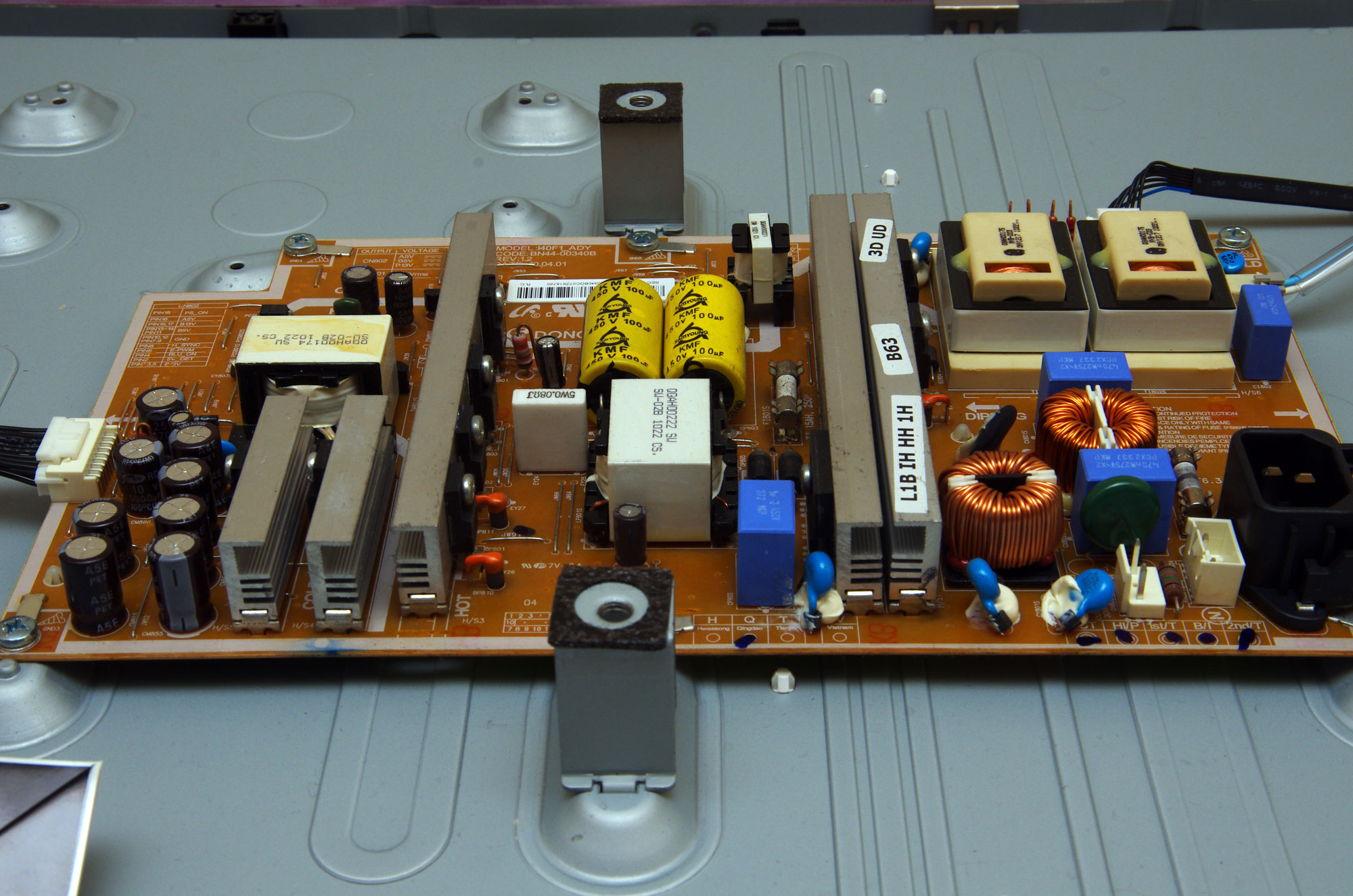

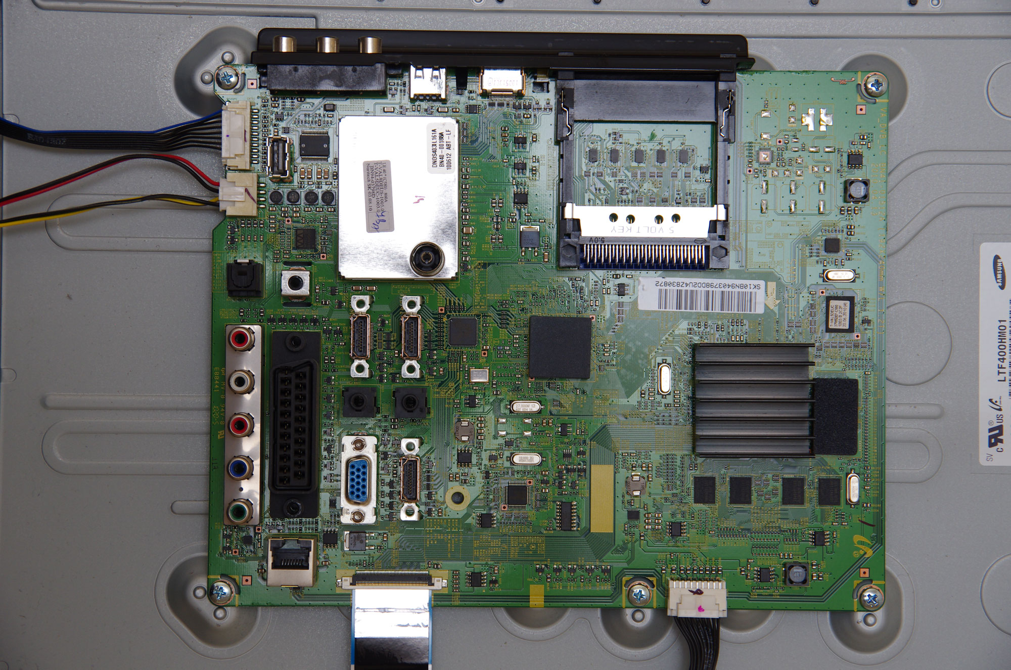

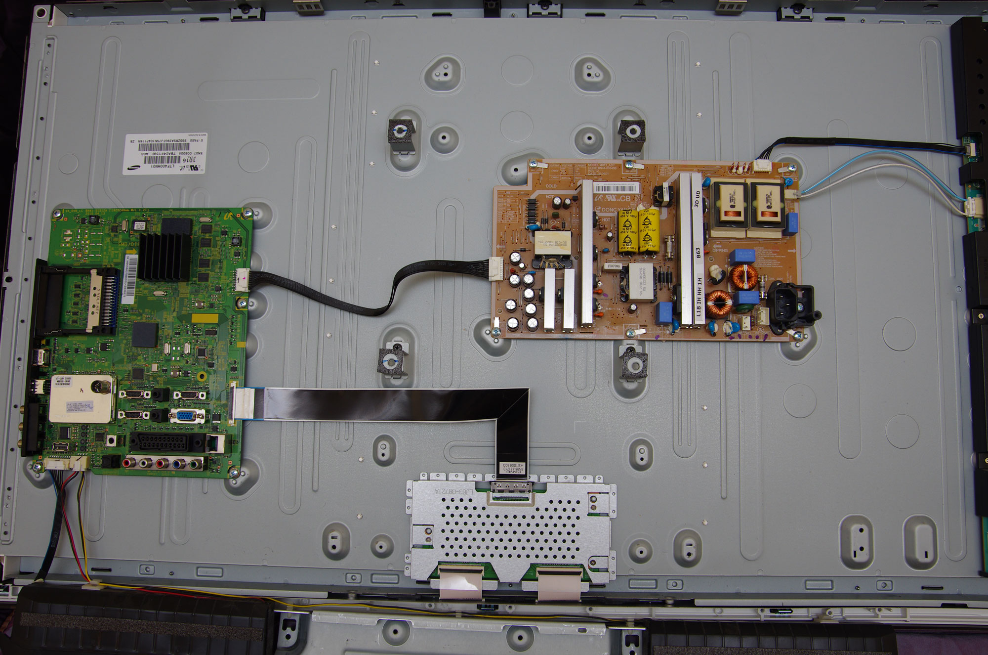

    We can often help a lot more if you please post good clear pictures of the whole chassis, and then pictures of each board, front and back (in the same orientation) and close up of connectors, (max resolution 2000x2000 and 2MB) using the manage attachments button, which is found by clicking "go advanced" under quick reply.
    Examples of what is needed
    https://www.badcaps.net/forum/attach...7&d=1280167246
    https://www.badcaps.net/forum/attach...6&d=1280167246
    https://www.badcaps.net/forum/attach...4&d=1280167246

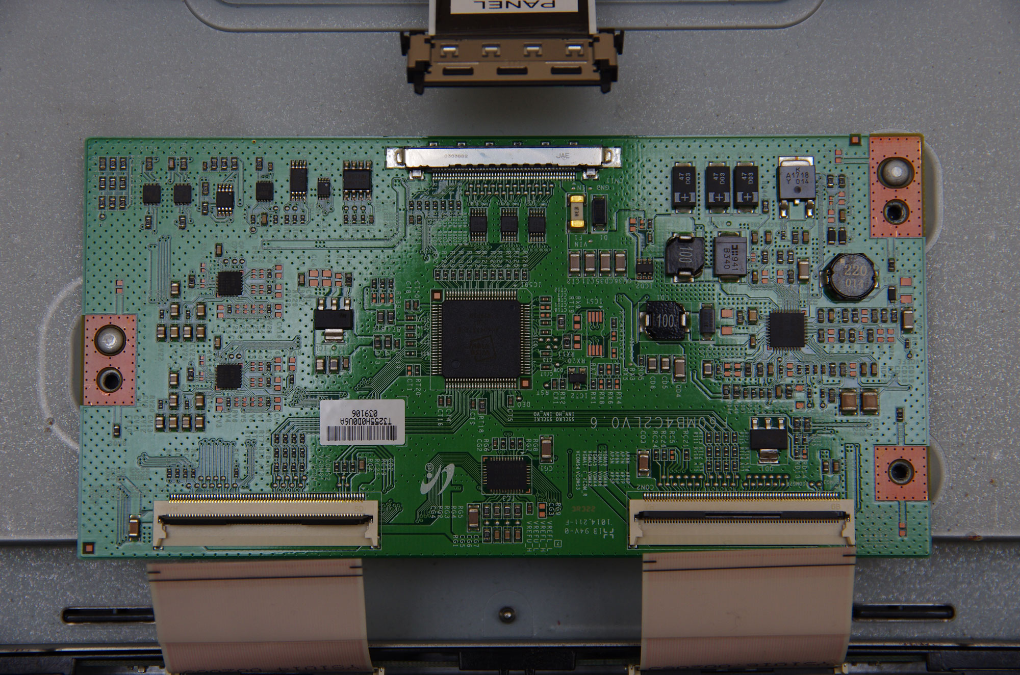

          I've checked the fuse with my DMM on both the original and replacement T-Con boards and it's fine. I'm impressed you found that thread, as I scoured these and other forums before posting here! It does seem to be a very similar problem, but I've no sound (but I guess that could depend whether it has a valid source).

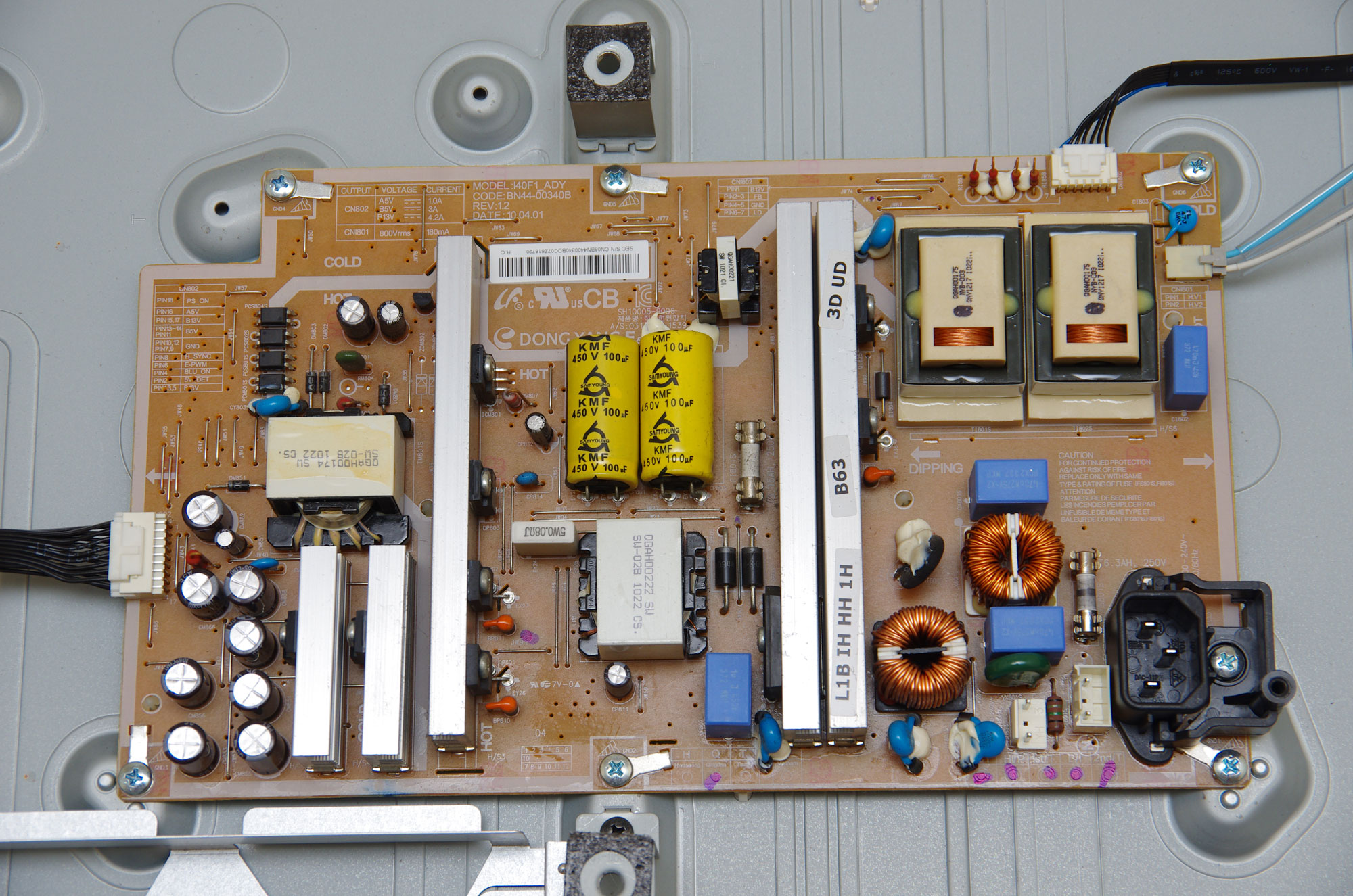

          I've taken pictures of the panel and boards as requested (PSU top view and side view - showing capacitors appear to be fine).
          Any suggestions welcome, I've really no idea how to fault find something like this.

            Oh, and this is the replacement TCon I got.
            I guess it could also be faulty or even the wrong part? But I did check the fuse.

                        I think tom may be referring to the fuse on the Tcon -With it all connected up and on
                        (as far as it will go on) Meter on 20vDC black lead on ground (metal part of the LVDS cable connector) probe each end of the fuse with the red probe.
                        Whilst wondering if that was the fuse tom meant I noticed a fuse on the power supply board - the one by the power cable must be ok but there is another by the yellow capacitors. WITH POWER OFF check it for resistance or better still remove it and check it - if it comes out easily.

                          With regard to checking those PSU fuses, do I need to discharge those yellow 450V caps or just be very careful? If I do need to, use something like this? http://lifehacker.com/5935955/diy-ca...discharge-tool
                          Cheers for help with this!
                          • selldoor
                            Slow Learner
                            • Dec 2010
                            • 7870
                            Re: Samsung LE40C580 no sound/picture, but backlight on
                            You are right to ask - working normally most caps will discharge themselves to a non lethal level in a few minutes but this set is not working normally.
                            You could use a discharge tool - personally I would wait a few minutes then
                            check the big caps with your meter on 600 vdc and see what voltage remains.
                            Equally you could check for a voltage from the negative leg of the big cap to each end of the fuse before doing the test.

                                  OK I've just tested the voltage and luckily for me there were no blue flashes or green smoke. I tested the voltage on the yellow caps one each leg and it was 0V (but it's been off a few days).
                                  So... I got a reading of 12.42V on the TCon fuse/chassis test (for both TCon boards I have). Both PSU fuses are fine, I took the one out that you mentioned to test. The voltage on the TCon fuse was the same before and after the backlight came on (which is does after about 7 seconds of being connected to the power, without touching the power button on the remote).
                                  Any ideas what next? Does it suggest TCon faulty or something else? (Always a chance I have two duff TCons!)

                                      12V is good.
                                      I'd be slow to say your t-con was at fault but let's check some other things.
                                      Capacitors CD27, CD28 store AVDD. I don't know what this will be; but I'd expect it's going to be 15~18V, given the output capacitor is rated "D", which codes for 20V. See this datasheet: https://www.badcaps.net/forum/attach...4&d=1357859920
                                      Capacitor CD32 looks to be the input voltage to the buck or boost converter. I'd expect 12.4V, i.e. VIN.
                                      Capacitors CD4, CD5 and CD6 look to be a 3.3V supply, is this correct?
                                      (Note: For all the above, measure the voltage across the device, and from each end to ground. The across-device and one end to ground should be the same, with the exception of a sign difference.)

                                        Thanks for the quick reply! Seems that datasheet link is to the picture I took of the T-Con board?
                                        Agree with T-Con not being prime suspect, since I've tried a replacement board. But I guess that could also be faulty!
                                        I'll check the voltages and come back. Are all these CD components on the TCon board? And to check, I test against +ve using the fuse, and for ground the cable connector chassis, right?
