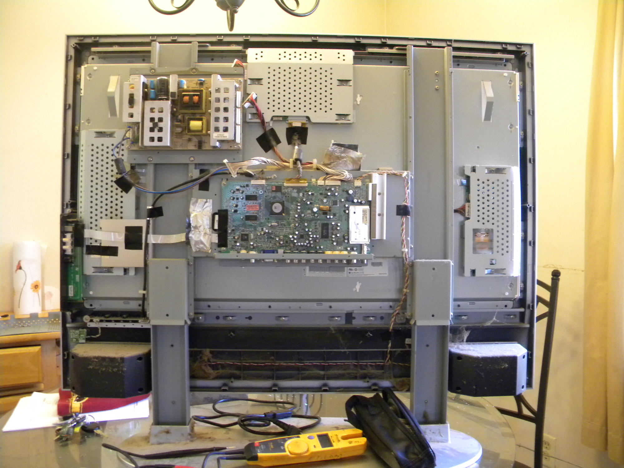

    Hi folks,
    First post, which is good and bad... Glad to be on board, but unfortunately this also means my TV took a hit.
    I'll post pictures as attachments.
    Okay so we had a BIG BOOM the other night and my VIZIO L37HDTV10A(LCD) died. It was $1,300 when I bought it in 2008(ouch!), but if I could fix it for less than $100 I think it's worth it.
    Symptoms:
    * Black screen
    * Status light "Green", but should be amber when in stand by
    * All buttons and remote are unresponsive
    I've been reading this thread, which has helped me get started troubleshooting. It would be great if I could get a bit of help in identifying the bad board. I'm leaning towards MAIN board but I'm new to TV repair.
    I've gotten as far as testing the power board somewhat, but that is where I have stopped.
    I have 5 volts on the standby pins of the board(there are two of them). I have zero on all other outputs.
    I believe that I would need to put 3.3 volts on the PSON pin to make the PS "turn on" the other outputs... is that correct? And if so, would I do all of this with all of the plugs removed? (besides main power of course)
    Also, should I ground the 3 volt supply to chassis?
    Any help would be GREATLY appreciated and thanks for having me on this very cool forum! I love fixing stuff!
    Thanks in advance!

    Couple other notes:
    I had HDMI from a Direct TV box hooked up and that is all
    Nothing else in the house was affected from the lightning, but it did hit about 500~ feet from my house.
    Previously, I was hearing the "clicking" noise when I turned it on, which I believe is a symptom of something going bad???

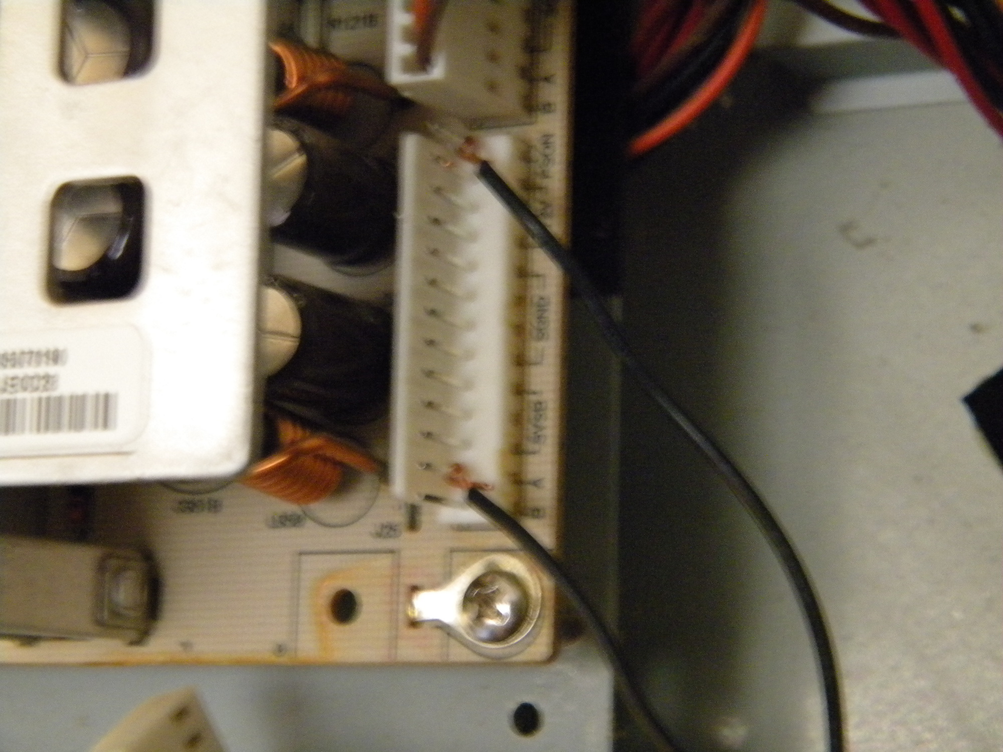

          Re: VIZIO L37HDTV10A: Lightning damage
          You can test the power supply and inverter board to see if they are OK or not by
          1) Disconnect the cable between the main board and the power supply.
          2) You will need external 3~4.5 V power (use two or three good batteries connected in series, I prefer 4.5V), the negative to the metal chassis, the positive will feed two 1K resistor, one end of each resistor will be joined together at the positive of the batteries.
          3) The other end of one resistor will be connected to the power supply board 'PS_ON' pin.
          4) The other end of the second resistor will be connected to 'A' first (we are not sure yet which one of the 'A' and 'B' is for the BL_ON. There are two signals (BL_ON, Dim) from the main board that are routed through the power supply board to the inverter board, this is done to keep the wiring simple) to see if the backlights will come on, if not then move the connection to 'B', one of these pins is for the BL_ON. You should see the backlights come on.
              Budm, thanks very much! I didn't realize I need to also put the voltage on the "A" or "B" as well. I thought I would just hit the PSON and then should get voltages across all outputs. I am about to do this now and will report findings.
              Ben, I am attaching a closeup pic here. I see what you mean, but I think that may just be how the cap is wrapped originally. If it expanded that much that is crazy!
              Again, I really appreciate this forum!!! Nice to see people out there take time to help others.

                    However, just tried testing the PS. Can you guys confirm that I am testing it properly? I've attached a closeup photo to show what I am doing.
                    Thanks!
                      I would connect PSON to 5V with resistor in between.
                      • martyparish
                        • Dec 2012
                        • 313
                        Thanks Tom!
                        I am using a variable power supply set at 4V for the two leads. They both have 1k resistor. Will that not work?
                        Thanks again for the help, it is appreciated!!!

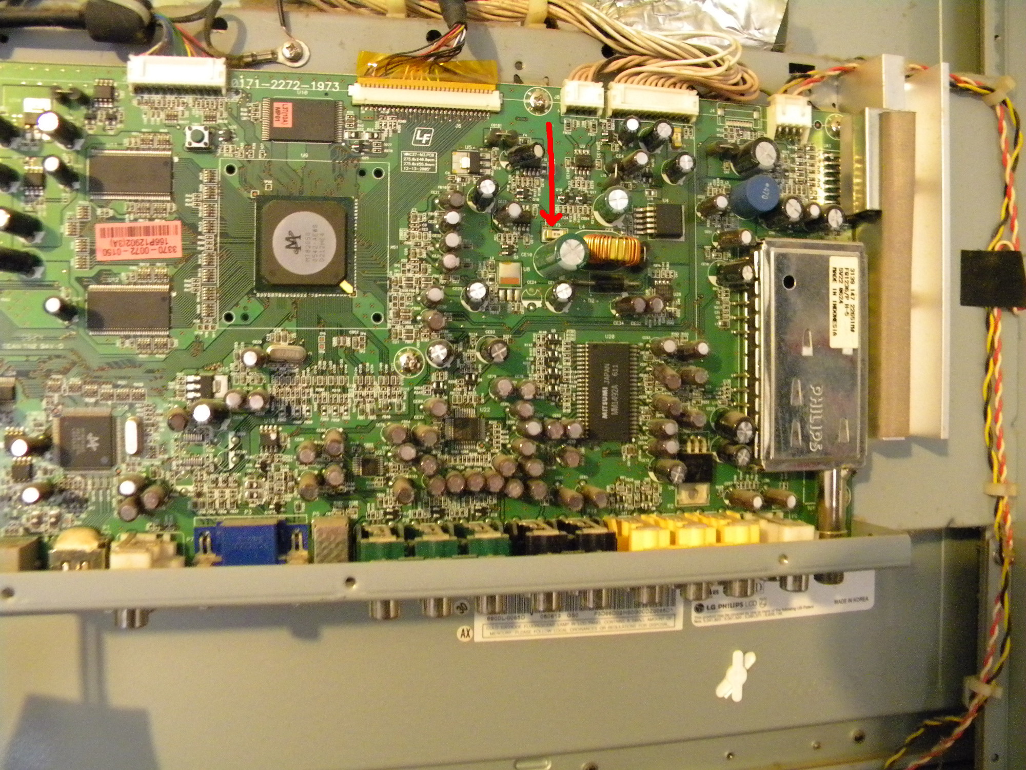

                          Hey guys,
                          Just wanted to check in and give status update. I'm not going to abandon this project until all hope is lost!
                          So, my good deal(main board $28) fell through... The ebay seller tells me "we don't have this item in stock..." wth? And they waited until around the damn thing was supposed to be at my doorstep.
                          Anyhow, I started looking closer at the main board, with the help of this site of course.
                          I found a bad fuse on the board. I was going to explore the voltage regulators that I keep hearing about on this site. When none of them had any voltage I then noticed a fuse that I missed previously.
                          Unfortunately, I did the dreaded taboo, I jumped the fuse temporarily. Hopefully I didn't make things worse...
                          When I did jump the fuse, my indicator light changed to flashing white. I didn't notice any particular number of flashes that would give me a code.
                          Would you guys mind taking a peek at the board and let me know if you have any thoughts?
                            The flashing white light could be the Capacitors in the standby circuit are discharging, I have a good working 42" Vizio that has a flashing white light every time you unplug it and plug it back in, I've seen the white light flash at least 30 some times up to 60 some times, since you have already jumped the fuse, what happens if you leave it plugged in and wait to see if the white Vizio Logo finally stops flashing and then see if it will power on?
                            Also, do you have any voltage at PSON now with the fuse jumped?
                            A little pricey but I ordered a main board for a 37" Vizio from this seller and it works fine now.I believe this is the same as yours.

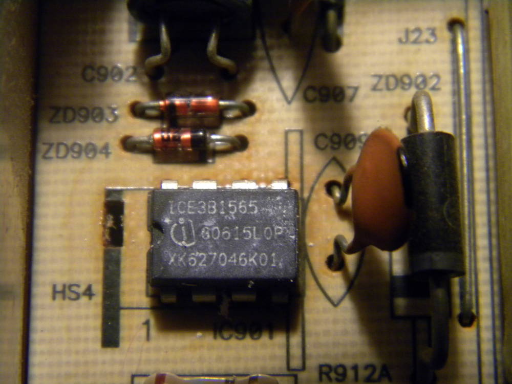

                                      Hey BadCappers I'm back on this VIZIO today. I believe I have at least found the problem on the PSU.
                                      Looks like this IC may have fried. Check out the attached image, it sure looks like there's been excessive heat. (I don't really know how to properly test this thing)
                                      The chip is:
                                      SMPS Evaluation Board with CoolSET TM F3 ICE3B1565
                                      Anyone have an idea how I could test it properly to confirm damage?
                                      * image note: I have already removed the odd "v shaped" heat sink that was atop the IC.
