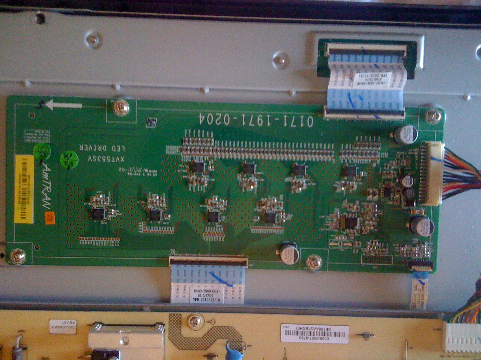

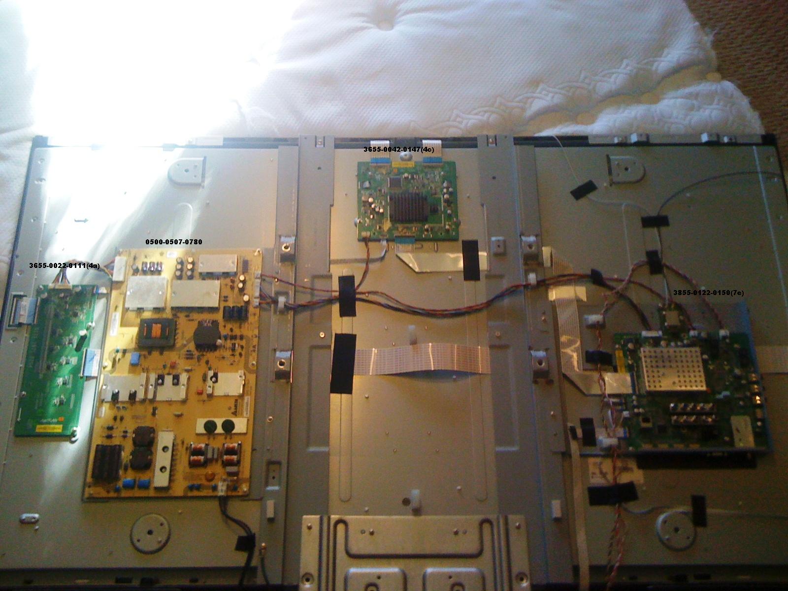

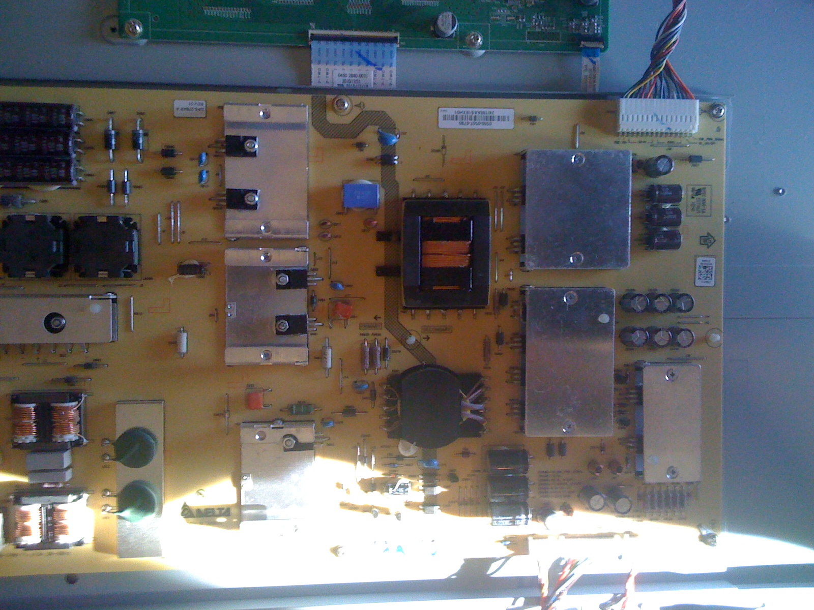

    Here is a pic of the open TV & the power supply. all board numbers are above them.
    Thank you & Happy Hollidays.

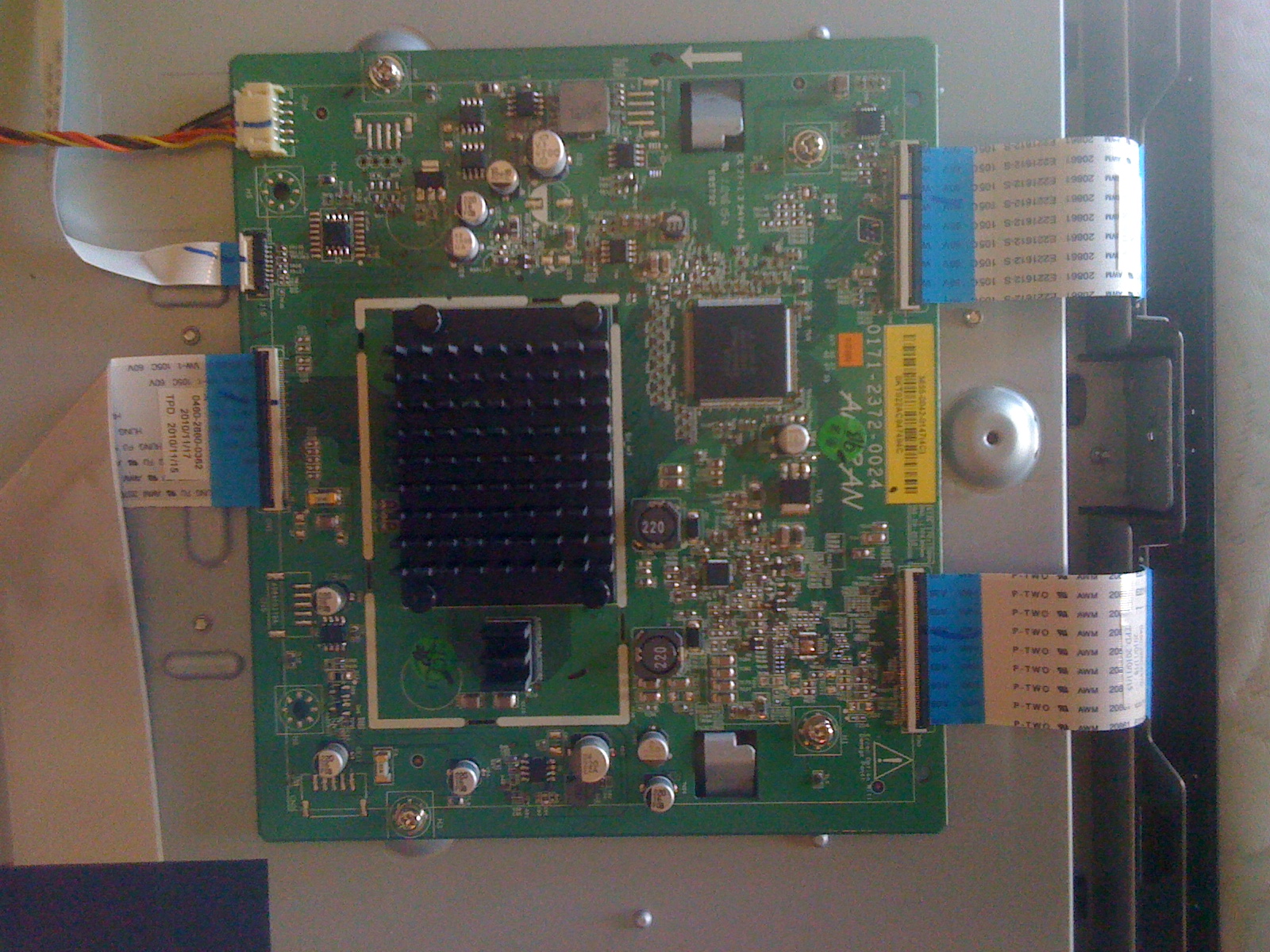

      Re: Vizio XVT553SV Powers up/audio/no vid.
      Include a close-up pic of the main and TCON.
      Check the fuses on those boards.
      We can point out the regulators with the pic.
      I'm guessing you know the channels change because of the change in audio?

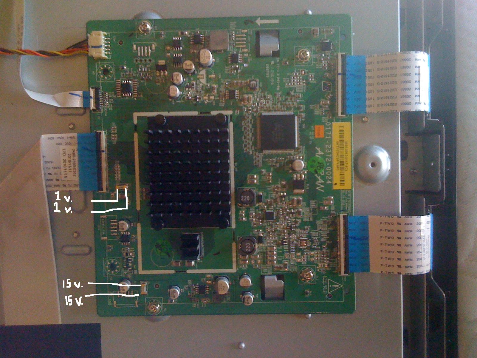

        Sorry for the crappy pics. cheepo cam.
        will this help?
        Thanx for the help.
          There's a white fuse, gold caps, on this image:
          https://www.badcaps.net/forum/attach...8&d=1356289078
          near the connector.
          Check what voltage you get on both ends relative to the chassis.
          There's another one a little further down the board.
          • Bob-62
            • Dec 2012
            • 26
            one volt on both sides of the one.
            fifteen volt on both sides of other.

                      OK got a meter.
                      the upper one in pic is .30v on both sides.
                      the other one is 5.9 on one side & 5.11 on the other
                        Somehow power isn't reaching that first fuse. Can you get a closer in focus shot around that area? I'm trying to see if that fuse is the main T-con power or just some other function on the t-con that isn't working.

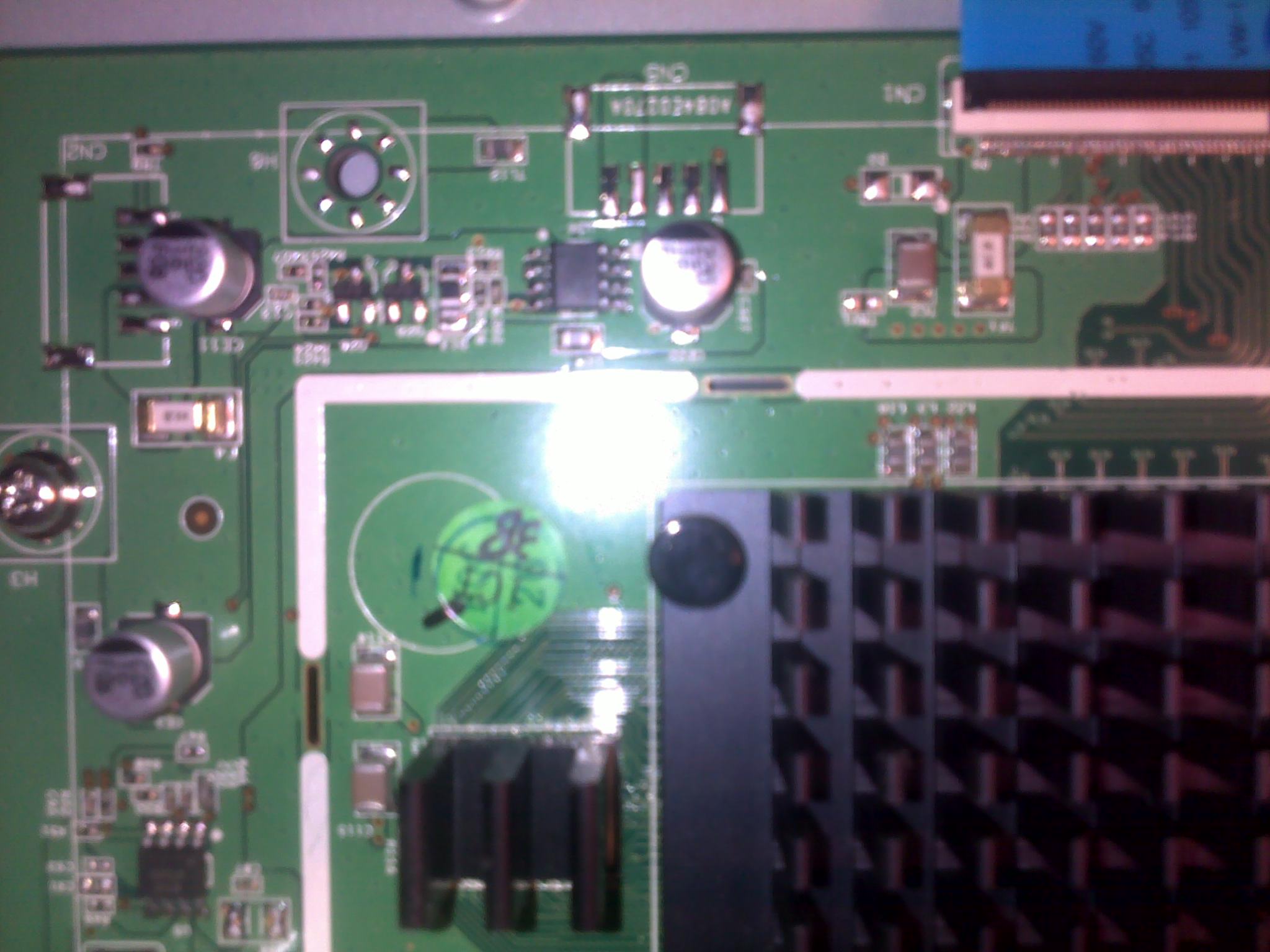

                          tryed several shots. unfortunately this is the best i can get.
                          USABLE ?
                            OK, that's fine for my purposes.
                            So the point VIN is next to one of the fuses, what does this measure? At the moment I think it measures 0.3V but if you have 5V elsewhere on the board that is not correct.
                            • Bob-62
                              • Dec 2012
                              • 26
                              Checked board with magnifying glass. couldnt find VIN
                                Here?
                                • Bob-62
                                  • Dec 2012
                                  • 26
                                  getting .30v

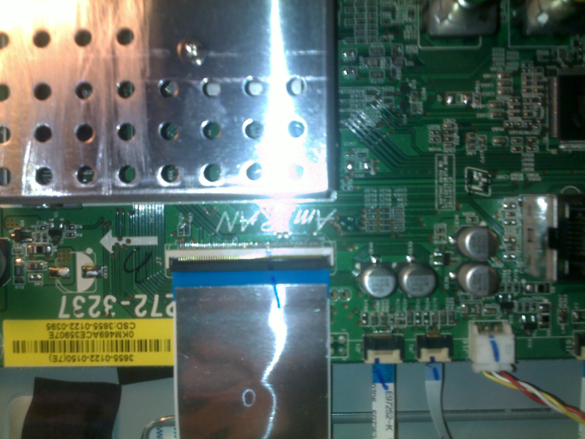

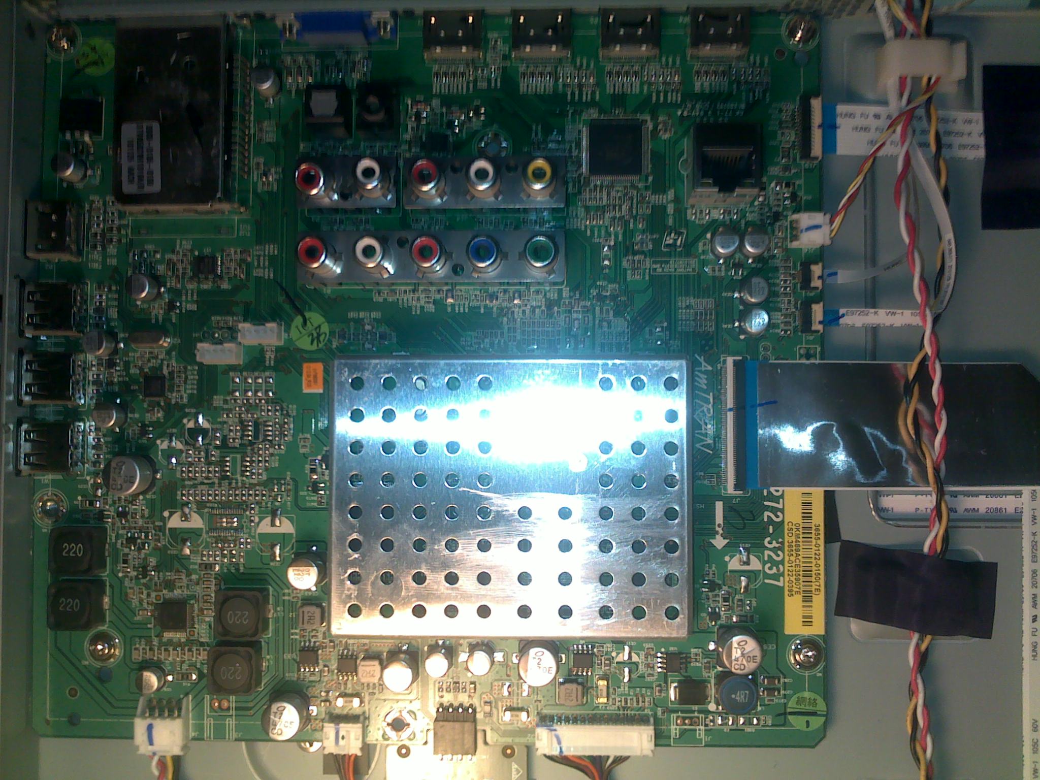

                                    OK, so it is the main board at fault, we need to figure out why. Can you post a clear shot around the main board area where that connector goes to.
                                    • Bob-62
                                      • Dec 2012
                                      • 26

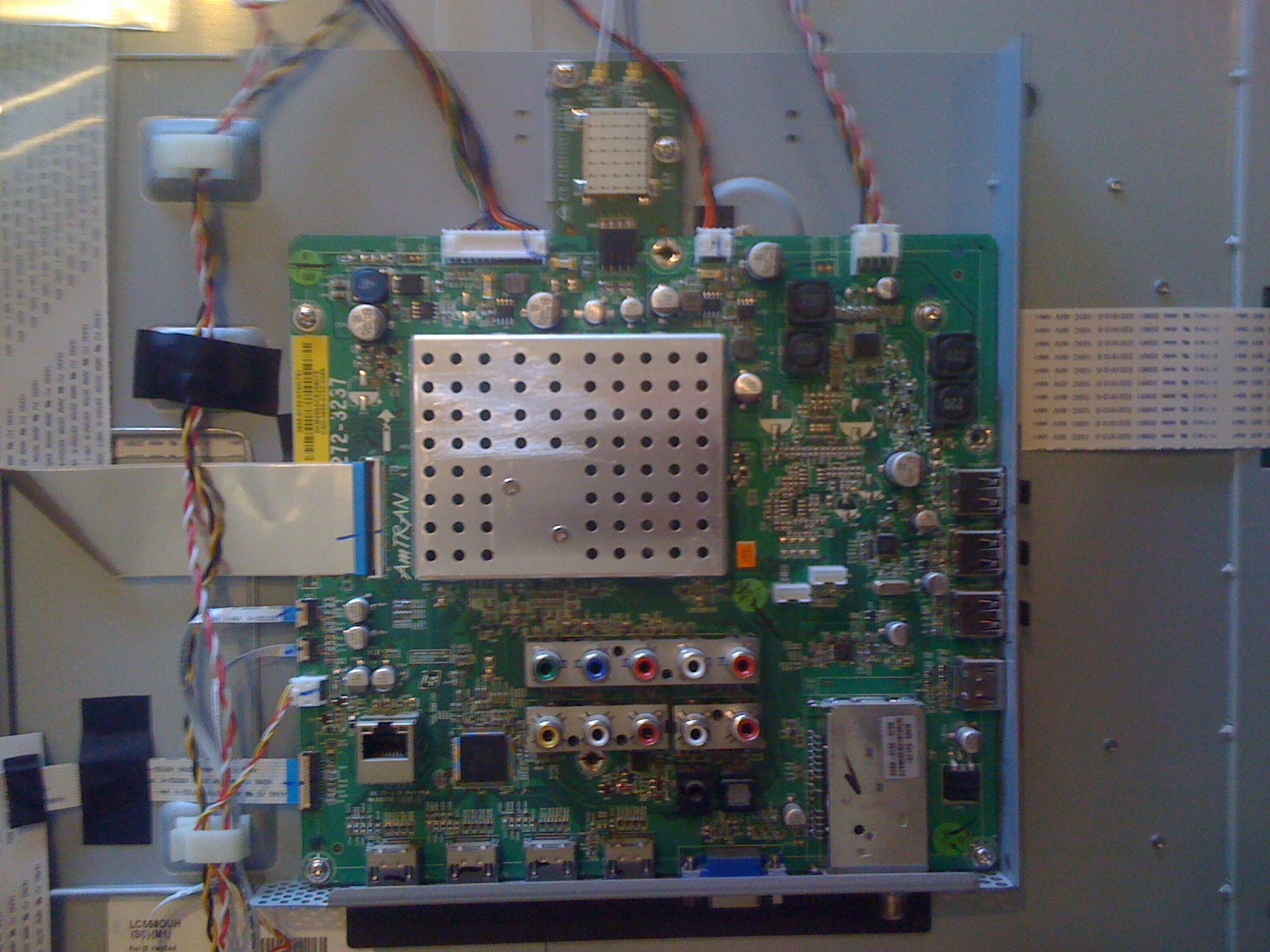

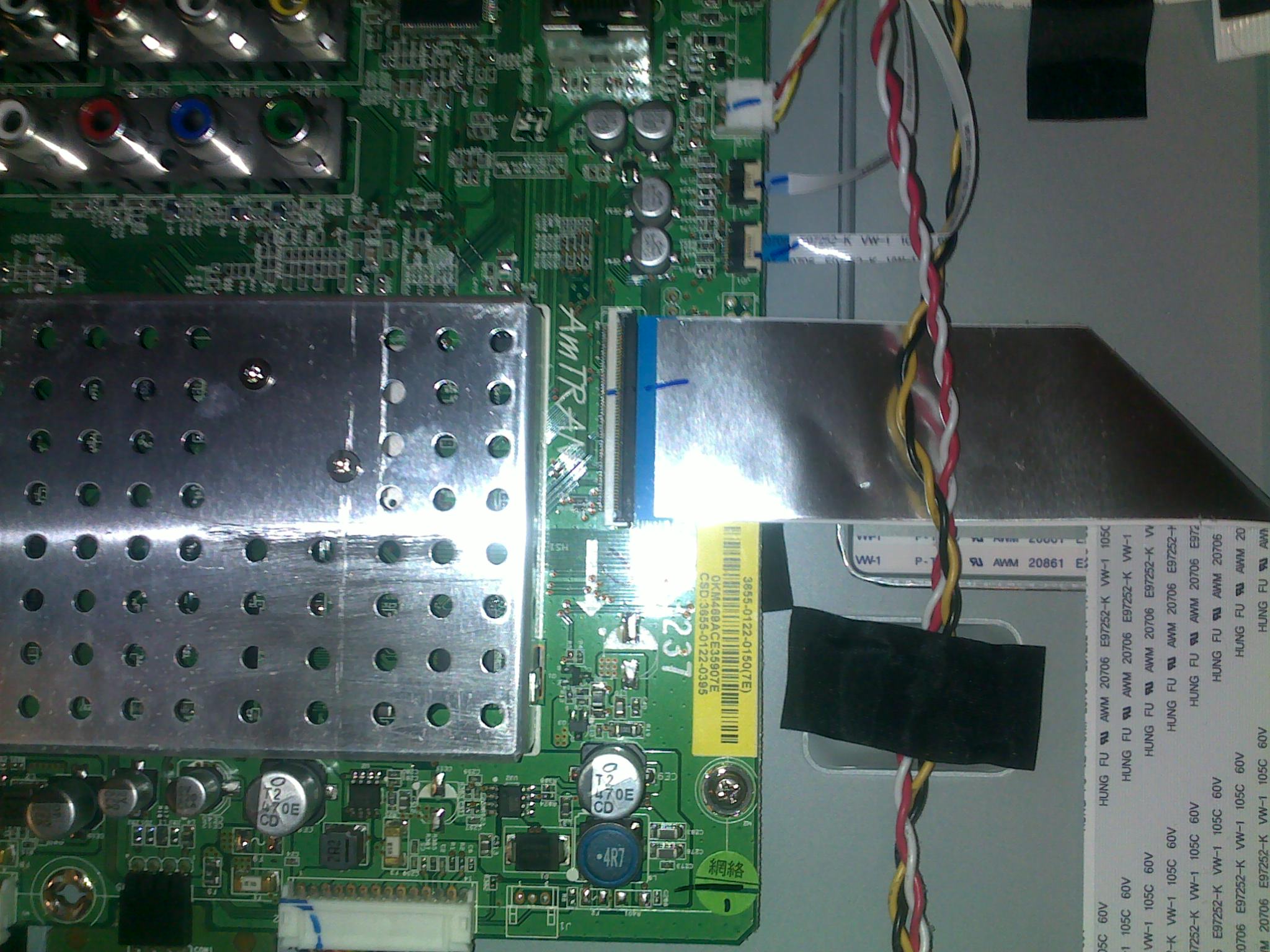

                                      OK here we go.
                                        need the LCD panel number on the sticker so I can look up the LCD panel spec sheet which will tell us the pinout of the T-CON connector.
