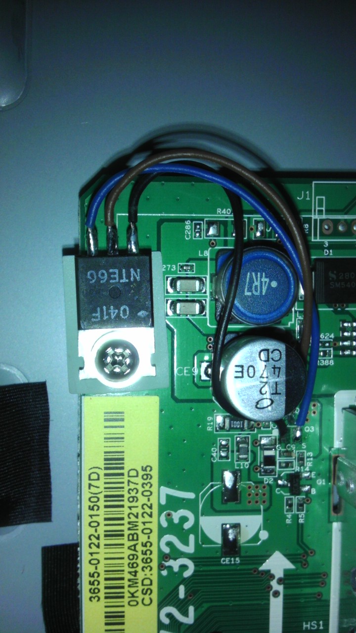

                              #54
                              Re: Vizio XVT553SV Powers up/audio/no vid.
                              I did this for my repair. I used an NTE 66 MosFET transistor and pigtailed it to the pads where the original 3403 SMT MosFET was attached, used insulating pad and bushing to attach it to the circuit board's existing mounting lug. So far, so good! My tv is back up and running!

                                #55
                                "On Q3
                                Drain .32 This is the output pin
                                Source 12.16 The B+ is fed to this pin
                                Gate 10.85"
                                The NTE66 is the N-Channel MOSFET, the Source then should not be connected to the B+, right now the B+ forcing the current to flow through the body Diode of the MOSFET. You cam verify if the MOSFET is switching on and off or not by disconnecting the Gate.

                                    #57
                                    I am sure it is still working because the MOSFET does not turn off since the replacement is N-CH instead of the original P-CH which might as well put the diode in its place and the 12V at the Drain will always be there instead of being shut down when it is needed too.

                                          #60
                                          The MOSFET is being used as a switch, when the wrong type is put in, the body diode will allow the current to flow all the time so the MOSFET does not do anything which you might as well bypass the MOSFET if you want to use N-CH MOSFET. The correct part is the P-CH MOSFET, but you need to find out first if the MOSFET is bad or the GATE drive signal is bad.
