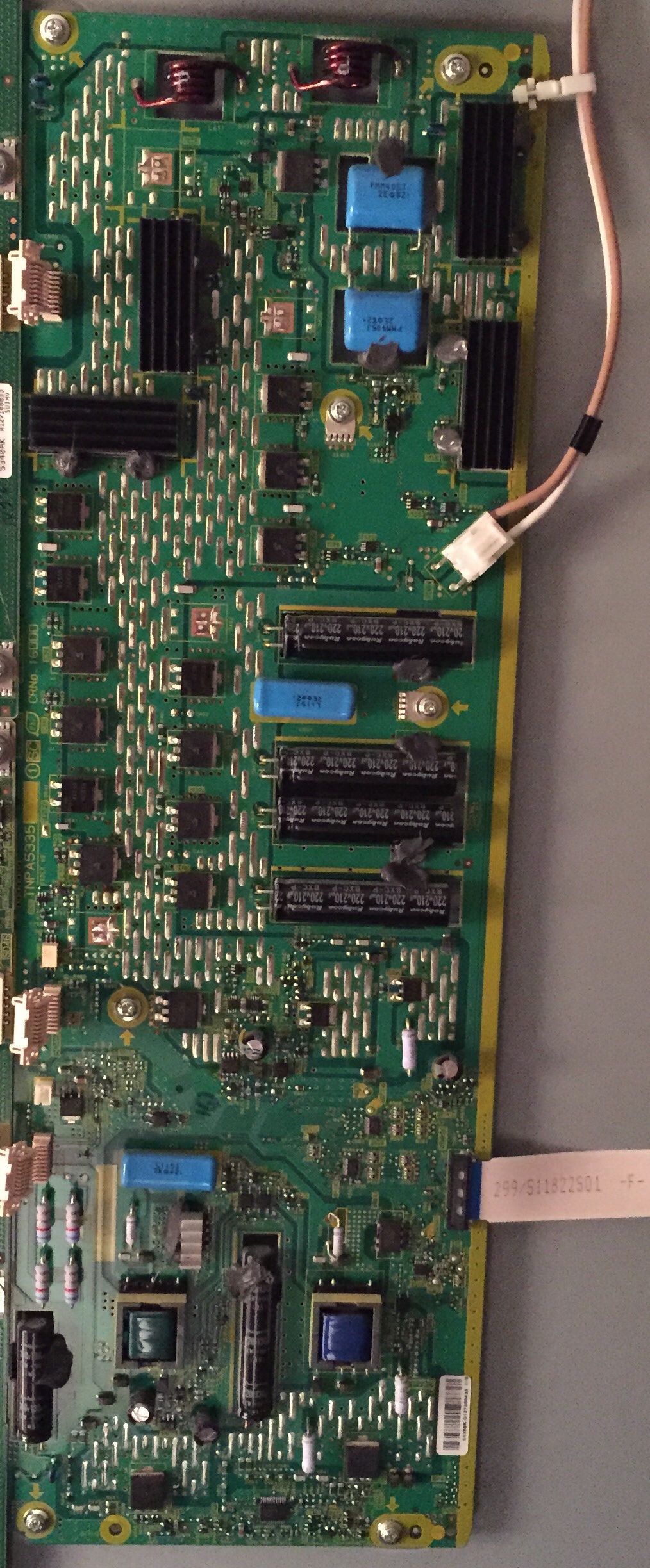

            Went and tested my SC board (SC20 2pin beeps) and found that the multimeter will beep on all of the ones that I've marked with silver, when probing pins 1+3 on the component.
            When ground is the High Voltage plate: D641, 642, 643 beeps as well
            With the normal ground, everything else that is marked beeps.
            That's 16 components that beep when tested, am I doing this right?

              #266
              Re: 55 inch Plasma Viera (VIERA TC-P55GT30) not turning on. 7 blinking red lights.
              Depends on the meter and what exactly it's doing and reading assuming we're talking diode mode. My fluke will give a short beep testing diodes and a reading.
              A constant beep and a low reading would be bad. i don't see Sc20 in the shot so I'm not sure what you're on about but there's probably 30 pins or so on that one so what exactly are you testing on that?
              What situation are you in? Is this a confirmed bad Sc board and you're trying to repair it or are you simply trying to establish if it's bad or not? what's your TV doing

                TPNA5335BK
                I am getting 7 blinks. Unplugged the SU + SD boards (no shorts noted at the buffers of SU/SD) and connected the jumper @ SC50? and still got 7 blinks. Figured the SC board is bad. Removed the SC board and upon checking for shorts, I am getting the constant beep at all of the marked components.
                I first test each component at pins 1 and 3 (out of the three pins), then I test it from ground to pin 1,2,3.
                When. I use the "Danger H.V." Plate as ground, D461,462,463 will constantly beep at all three pins on each.
                I am trying to figure out which components need to be replaced and if I am going about it correctly.

                  #268
                  I would keep it to simply this. on the SMD "D" devices the outer legs are the same connection . So outer -- outer will be short, center - outer should not be dead short.
                  probe center to both outer pins
                  Keep in mind this is in cct and other devices like the transistors are connected to it, so it may read short but a shorted transistor will also make the diode show short.
                  For the transistors "Q" . probe all 2 pin combinations of the 3 pins and see if dead short but watch out for low reading, may not go dead short . You could use resistance, I expect at least K ohms, 100's of ohms I would think is bad.
