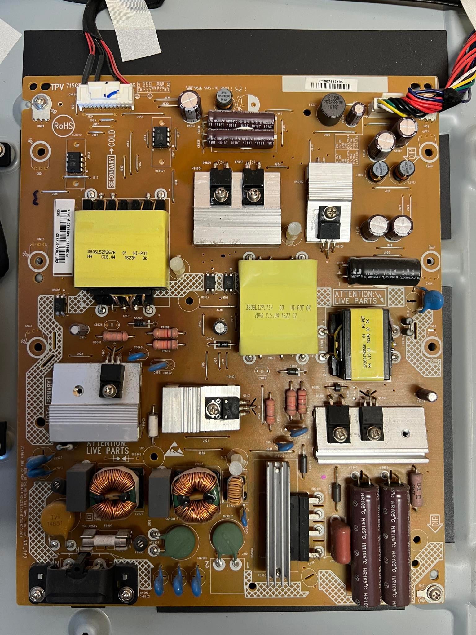

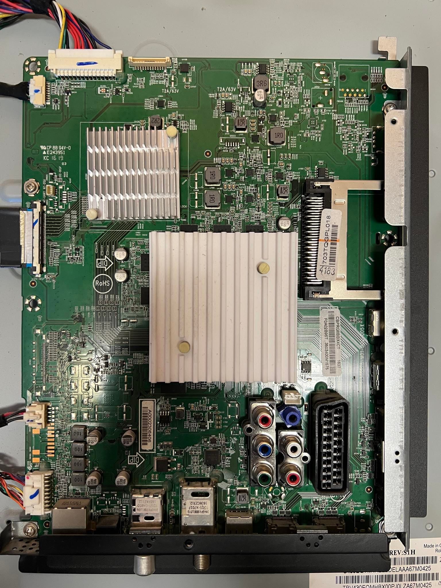

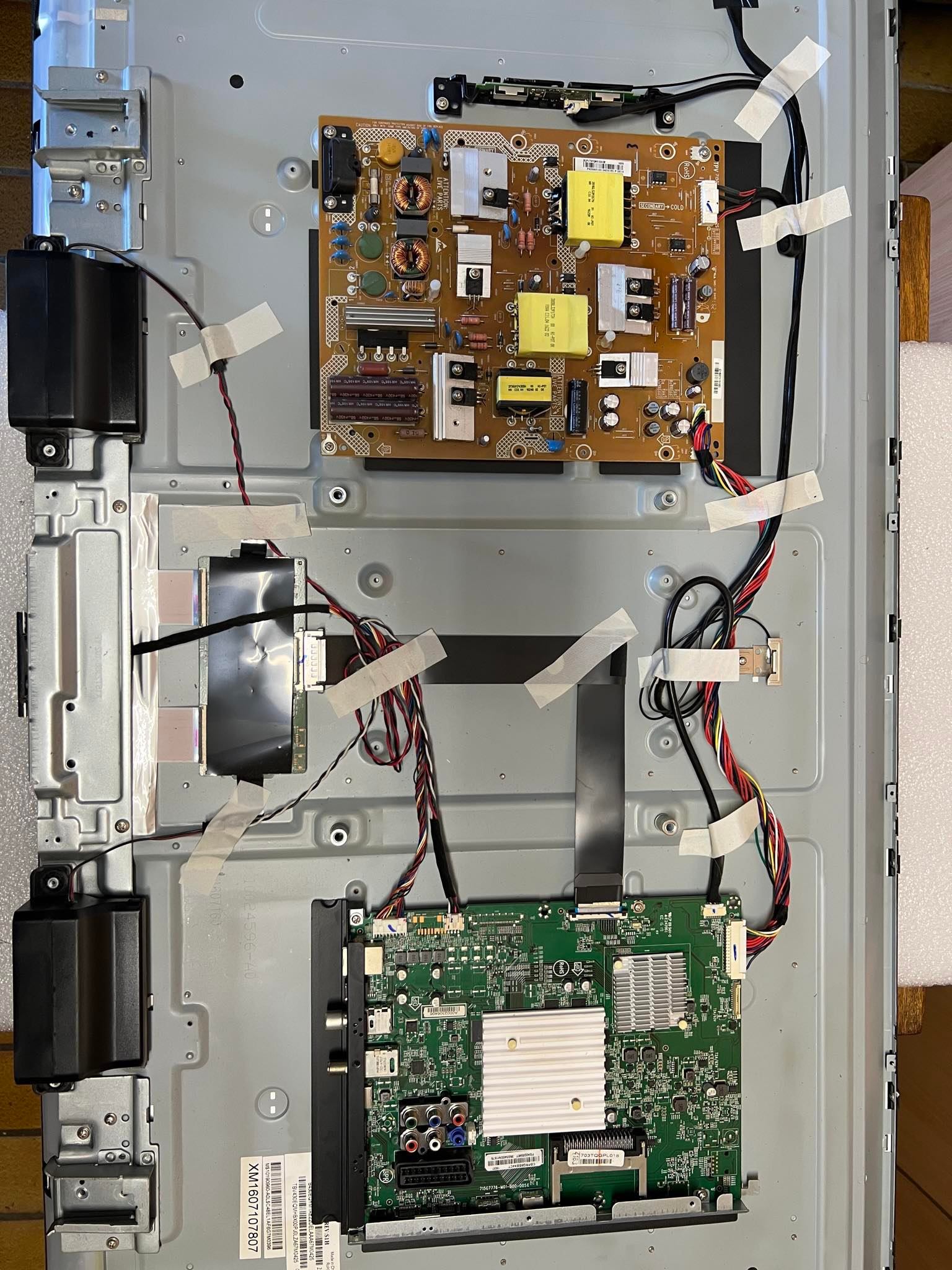

    Hello i have 43pus6401/12.
    After turn on red light slowly blinking and ambilight blinking randomly, different colors fadein/out, etc
    Screen is black, no backlight. Caps look normal. I didnt measure it, I forgot my multimeter in another car.
    Any common issue?

    Re: 43pus6401/12 - no picture, blinking ambi lights
    Vled pins shows all as it should be okey. What elae to check? Is mybe firmware?
      Firmware or cpu fault, these Phillips boards are trash.
        New working board from ebay will work ?
          Replace led strips when you have no backlight and there is ambilight. When you take a good look when the tv starts up you will see a dark Philips logo in the middle of the display.
