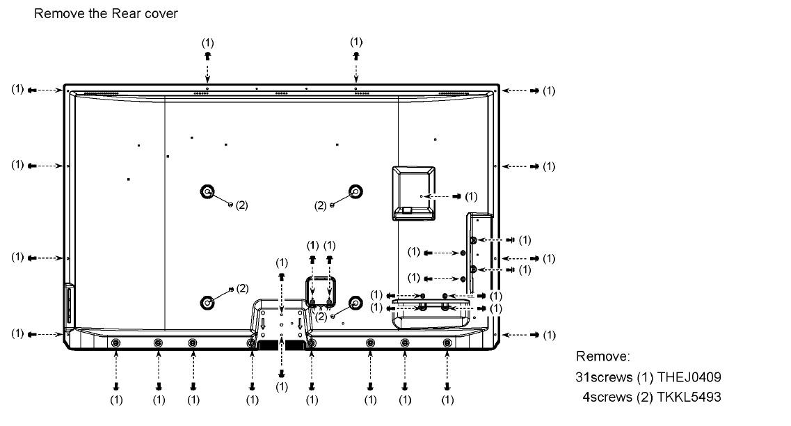

                    Is there a service manual showing how to take the rear off to get to the good bits?

                      Just take all the screws off.

                        Indeed. Don't need a service manual for that. Just remove all the screws on the back of the tv and remove the cover. Tv can stand on its foot when you remove the cover.
                        Your tv probably has the TNPA5335 with the separate buffer boards. If so , remove the buffer boards from the SC board. ( So the buffer boards don't touch the SC board )
                        Place a screw or harddisk jumper on the SC50 connector. Its a small connector on the bottom side of the sc board , close to the buffers. Turn on the tv , still 7 blinks then your SC board is dead. This can be just the SC board or also the power supply..... happens a lot on 42 inch.

                          If it's on a stand that will make it easier to work with you can remove all bolts.
                          simply that's all you do. every bolt you see remove including the stand bolts, the bolts in the power cord cover. There will be bolts around the mainboard area too.
                          I'd start around the mainboard, power cord, stand, then bottom u the sides and top last. If the cover does not just pop off then you've missed some.
                          Also be very careful handling the steel back, the edges are not finished and have a feather edge that can slice like a razor if it slides in your hand.
                          As for a manual, hard to find for our exact model but the chassis may be similar to other markets.
                          One tip, use the correct fitting screwdriver tip, the heads round out easily as they're a small and shallow bolt they used.
                          If I find a useful image I'll post it

                            3 white connectors and the 4 bolts

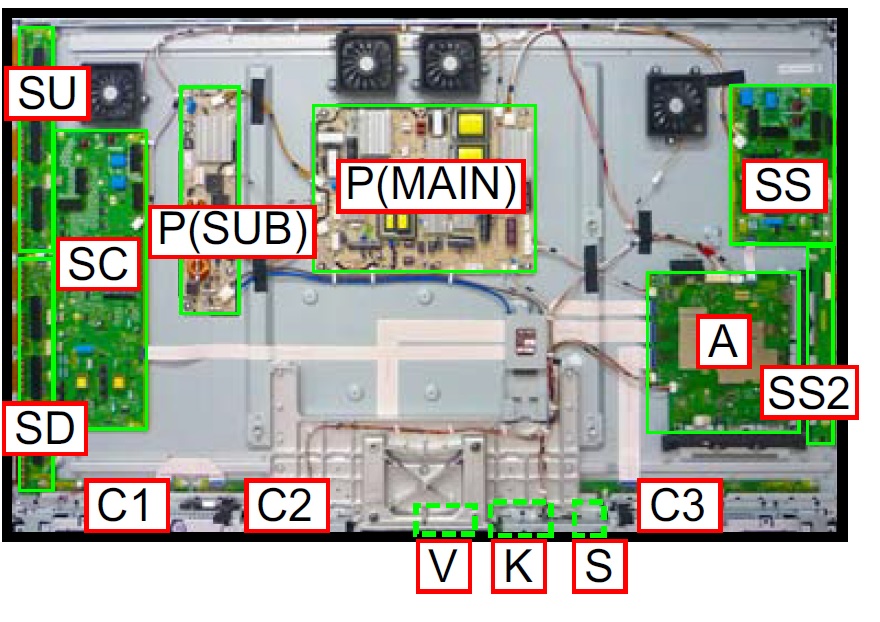

                                        When you have removed the back panel from the tv you will see the power supply in the middle. The SC board on your left hand side together with the buffer boards.
                                        The mainboard and the SS board are on your right hand side.
                                        Your focus should be on your left hand side.

                                          Re: 55 inch Plasma Viera (VIERA TC-P55GT30) not turning on. 7 blinking red lights.
                                          layout
