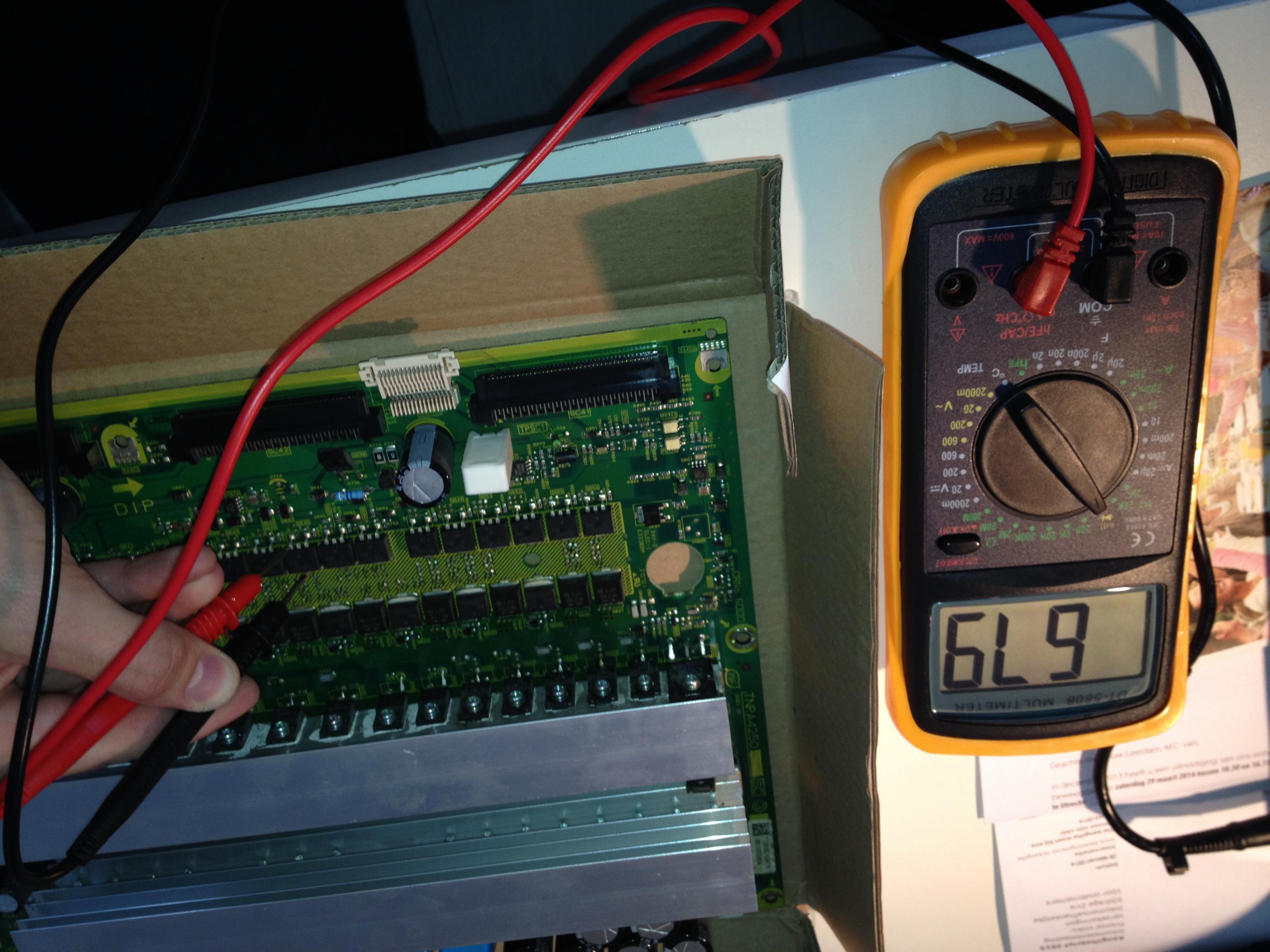

        I got a 42py70fa (comparable to a 42pz70) which has the same SC board as above. And after reading many topics and forums i chose the easy way out by buying a second hand SC board from an internet shop. However after installing it, and troubleshooting it, it looks like this one is broken as well!!
        Really bummed out and not really wanting to spent more money, i am now reading up on replacing the fets. However i have no experience measuring these things.
        So i tested all fets that are laying on the board, and i dont really know what to look for, since many people are experiencing problems with the fets Q641-Q646 i was hoping i would see a noticeable difference in readings, but i dont.
        I did however find shorts (is this good or bad?) in the fets Q648-Q654 from the Drain to Source, but not in the other fets. Please see the attached pictures. Does this mean one of these is broke? Because i get the same problem with the "new" board as well.
        Any help would be much appreciated!

          Short is bad. i don't know these well, how many shorted? Is it the whole bank? if the whole bank is short, you may have to somehow desolder and lift the legs up one ata time to see how many are bad.
          The other guys within in this thread should be able to help you more.
          try and get your money back for the other one of if you use paypal lodge a claim.
          too many flogging boards off they can't, won't or don't know how to test.

              For a quick test, you can fully cut the S and G pins, and the FET will be isolated so you can see if it will power up. I would use hot air to remove it. If you don't have equipment there are people offering a repair service.

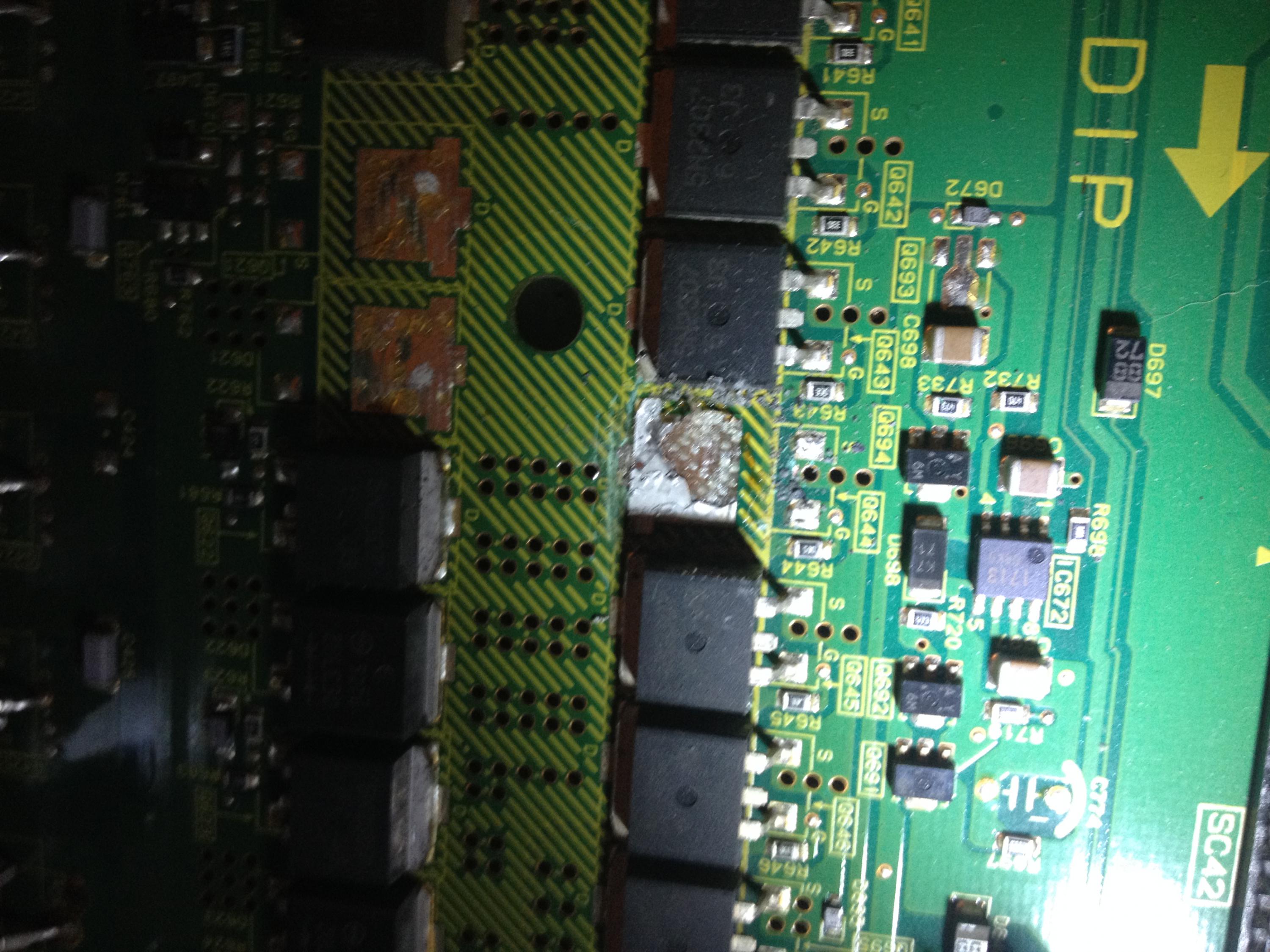

                Thanks tom, so i found the bad fet... tried to remove it, with another soldering iron from a friend. And started to wiggle it a little to get the fet off... unfortunately, the solder didnt melt, but the glue of the board did. With the result that i pulled a piece of the board with the fet.
                Now I am going to ask a silly question for some of you, but as you noticed i am pretty new to this...
                Is this repairable? or can i throw the board away?

                  You can recover it if you can track back the pins solder points , now even if you replace that fet it may short again , i would check that card very well . Capacitors specially

                    You should be a dentist, nice extraction.
                    I think one issue will be the fact that the copper pad is common to all the other FETs, acting as one whopping big heatsink which is why you're having trouble.
                    The only idea I have is to expose the mask around that, cut a piece copper sheet a little over size of the damaged area, epoxy it to the board but not to the exposed copper, then flow solder around the edges to make electricial contact with the exposed copper, and then hopefully solder the new FET to that.
                    It needs that pad for thermal relief.
                    That's my idea, never been faced with that big a pad torn. You're going to have to get the heat into it better.

                        It's normal for a FET to show only one reading from the drain to source, everything else should test open circuit.
