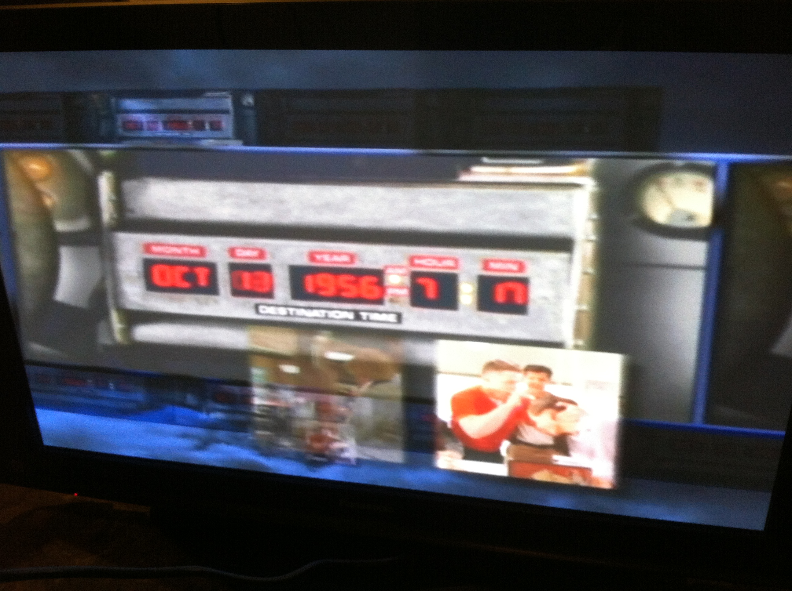

    Looks like it's working!
      #42
      Re: Panasonic TH-42PZ77U SC board repair 7 blinks
      Nice, another one fixed.

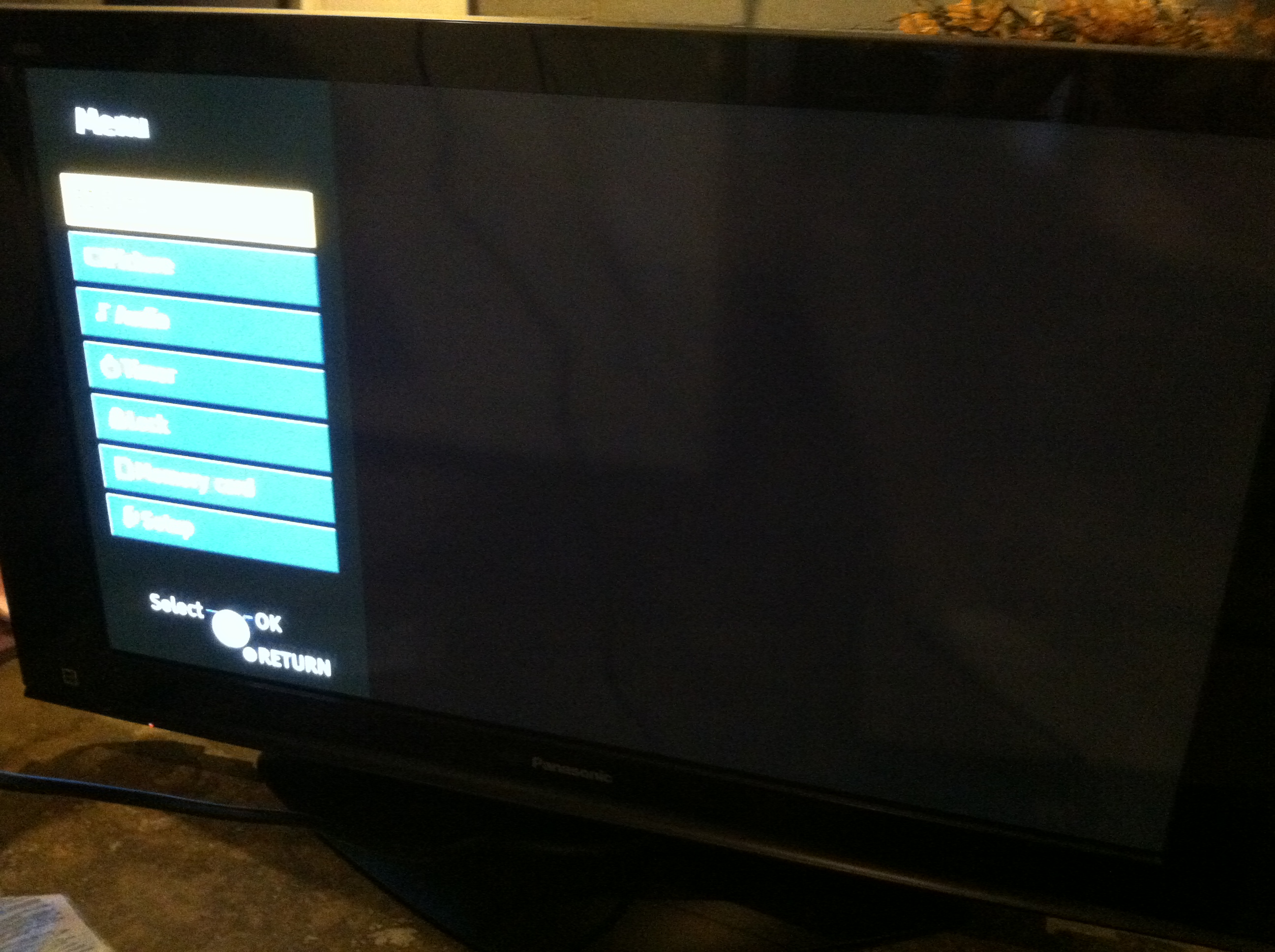

        Well, I got it all back together and the bottom half of the screen is dark again. Upon closer inspection, it looks like only half of the lines on the bottom half of the screen are being driven. I guess I'm in the market for a new SD board.
          #44
          No, you have a loose ribbon on the SD to panel connectors. A single loose ribbon on any connector causes the screen to interlace.

            #45
            I tried reseating the ribbons. No luck. It's like every other line of pixels is missing. One of the ribbons was in crooked last night and there were black bars across the screen. I noticed that the top pin on the sd board has come loose again. Now that I need it to, I can't get the plastic connector off of the board to try to fix it again.
            Will just swapping in an SD board from the auction site fry my SC board?
              #46
              I've had this exact same problem on the TH-42PZ70BA (basically the same board but UK version with digital TV etc.) Just make sure all the connectors are secure. It's not the SD board, it's the connection going to it.

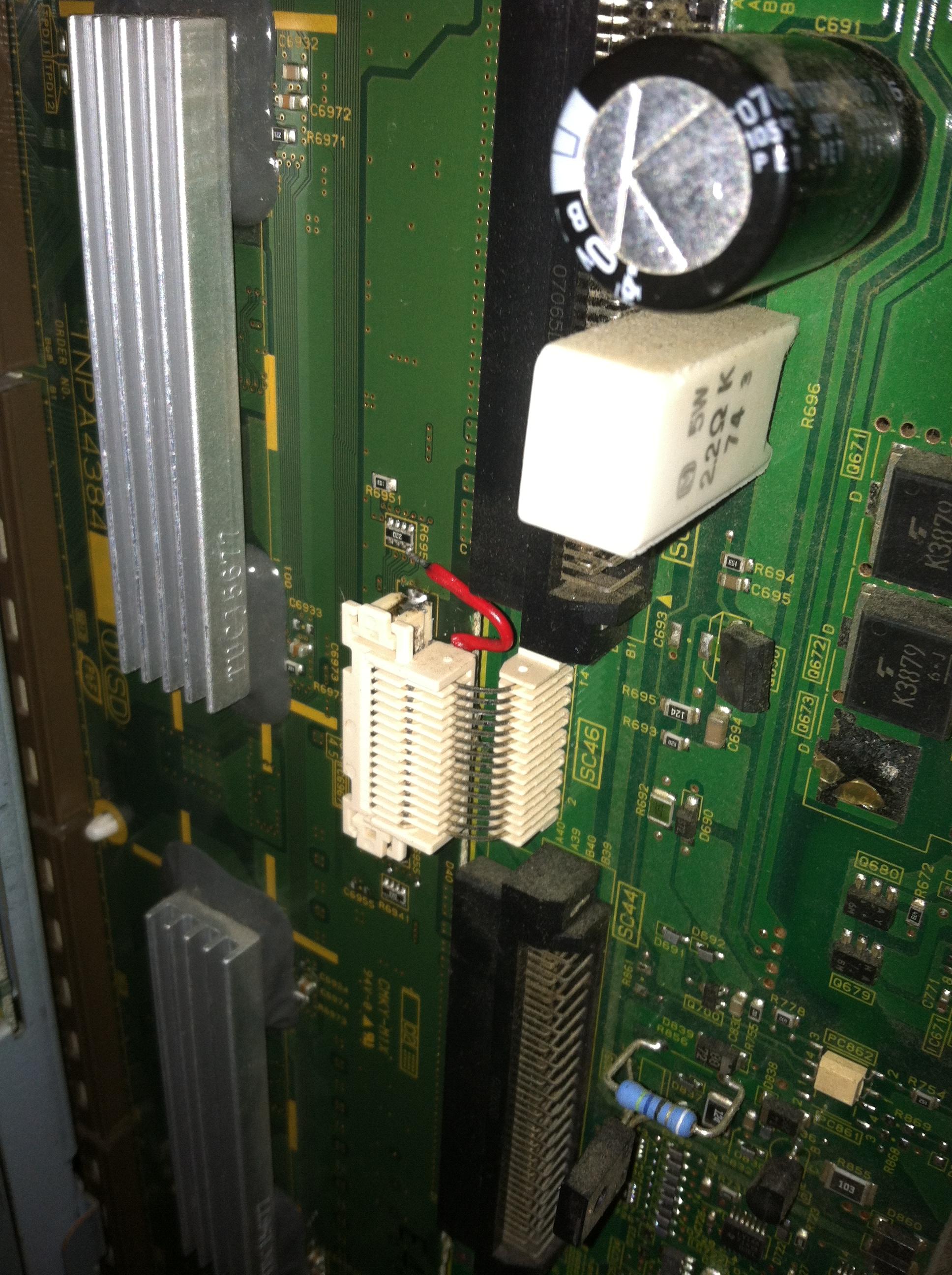

                #47
                Even with the top pin on the plastic connector no longer connected to the board? I will definitely keep trying to at with the connectors, but lets say for a second that the board is physically damaged. Can I swap in an SD board without damaging anything else?
                  #48
                  Yeah, I made that mistake too -- the connectors are easy to pull off the board. I secured it down with some glue which worked. Then, I fried the SD through entirely an unrelated accident (involved a small fried insect) so I replaced it. I can't see any risk in swapping the SD. I had no problem.

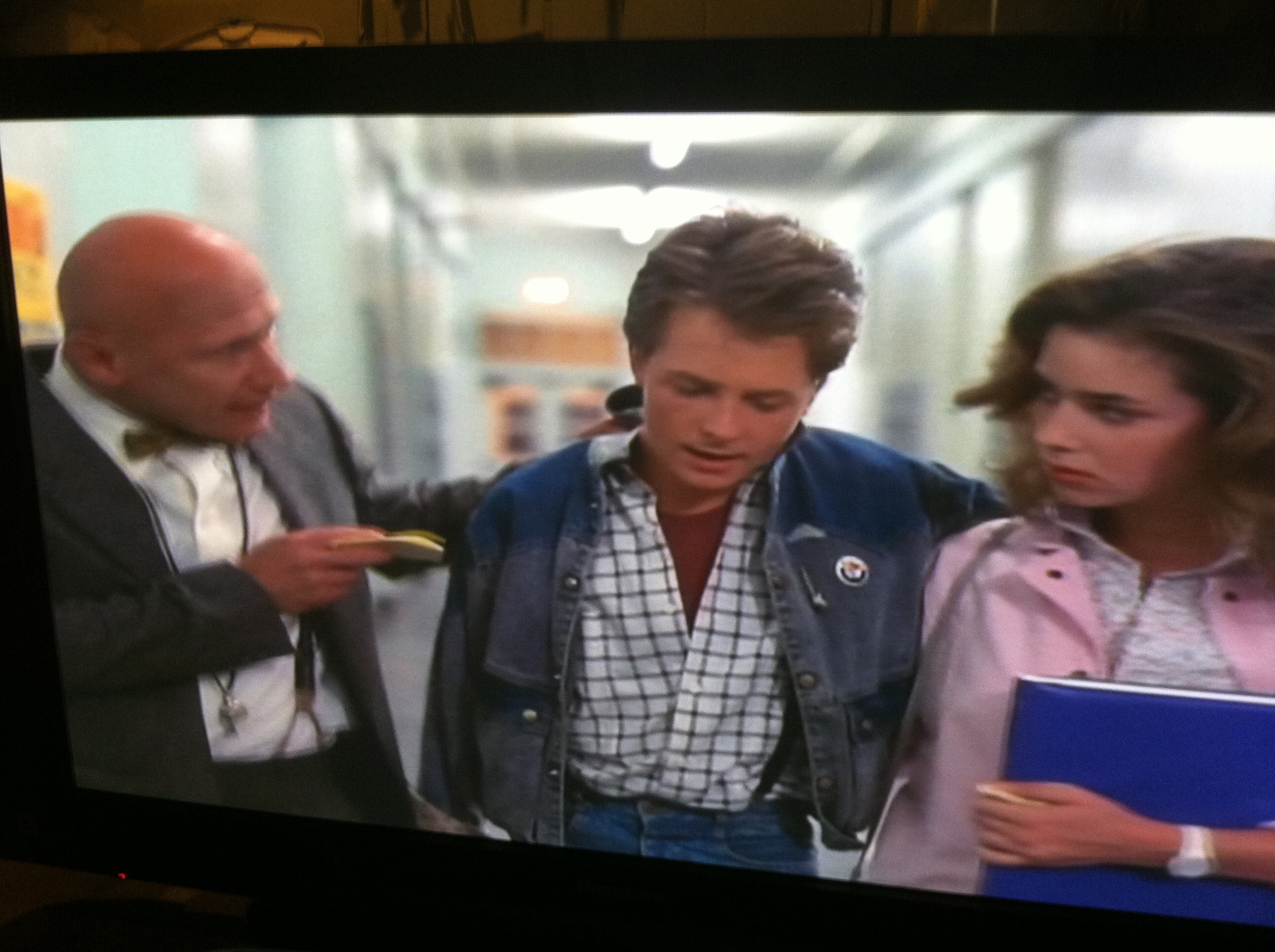

                      #50
                      I was never able to get the bottom half of the screen to look good so I went ahead and bought a used SD board via the auction site. Remember, I accidentally pulled a pin from the original board and couldn't get it reattached. I got the new board installed this morning and had black bars across the lower half of the screen that I couldn't fix no matter how many times I tried to re-seat the ribbons. I finally used my meter and the new board to find where the damaged pin on the old board would be connected. I ran a jumper from the damaged pin to that point on the old board, reinstalled the old board and powered the set up. The set seems to be working now. Should I put a dab of hot glue over the exposed end of the jumper or do you think it'll be OK?

                          #52
                          Originally posted by tom66
                          Back to the Future? nice taste.
                          One of my all time favorites.
                          Anyway, I would recommend it, but only to keep the wire in the right position.
                          That area of the board isn't isolated so perhaps it's not as critical.
                          I soldered the end of the jumper to one leg of an IC. I tinned the end of the jumper and used that little bit of solder to make the connection. There's really not much holding the wire on. It might be best to glue that thing down. Thanks for the input.

                            #53
                            Glued the jumper down and got the rear cover put back on.
