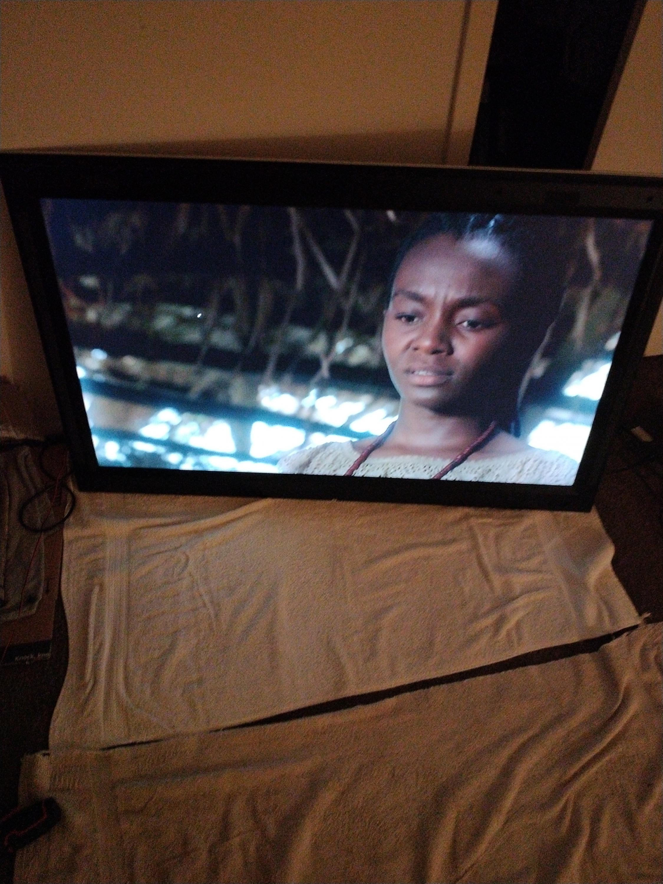

                              Re: Olevia 265FHD problems!
                              I'm currently having similar problems except it isn't my back lights. When switched on screen is stuck on Olevia logo circle.
                              I have red D1, red D2, and red D203.
                                #35
                                Update. I unconnected, cleaned connectors. And taaa daa. The Tv works but I still have 2 red led on main with one blinking green.
                                Future failure.
                                This thing is thrashed. The guy didn't even give me the front glass of speakers.
