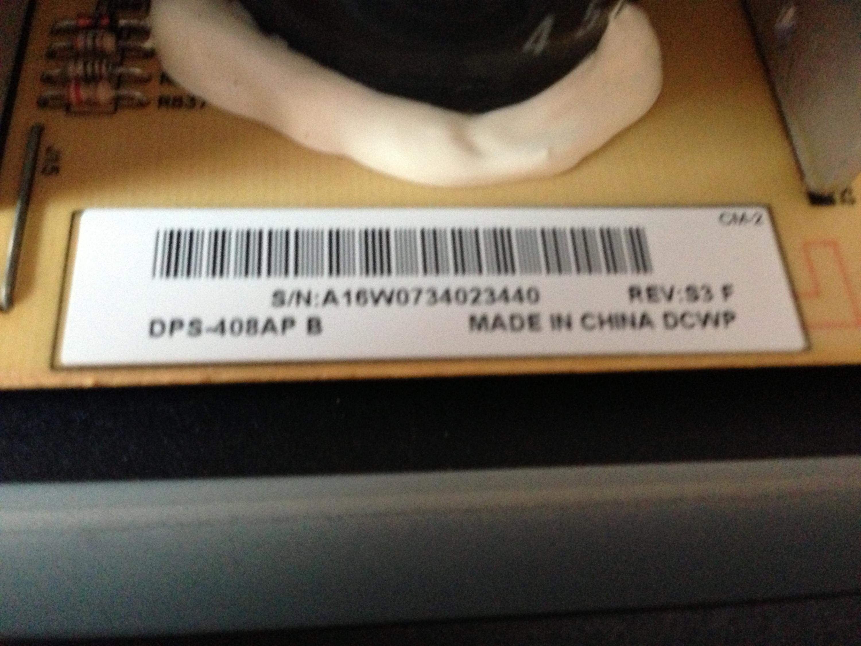

    I was just surfing around craigslist and picked up a 65 inch LCD the other day. I knew it was bad before getting it, but need some help with this one. Unlike every other TV I ever worked on, it has two power boards. When you try flipping the TV on the "Olevia" screen pops up and then the screen cuts off. However, the LEDs on the board with all the inputs remain lit. You can turn the TV "off" after this happens as well and when you turn it back on the process starts all over again. I examined both PSU's and I don't see any obvious bad caps. However, one of the power supply boards makes a weird winding winning sound before the TV cuts off unlike the identical board right next to it. Does anyone have any idea what this problem sounds like? As usual, any help would be much appreciated! Thanks

    Please up load the good clear pictures of the boards and how they are connected, that will be the starter. Make sure to use 'GO ADVANCED' to up load the pictures.

              Here are the pictures! I will take voltages tonight, but in what state should I take the voltages? Also I was reading and I think that the caps are original based on what others have said online as well as the person I got it from.
                Re: Olevia 265FHD problems!
                Those caps look original. They are Rubycon and United Chemicon, very good caps. Not typical RadioShack replacements, so they are most likely original.
