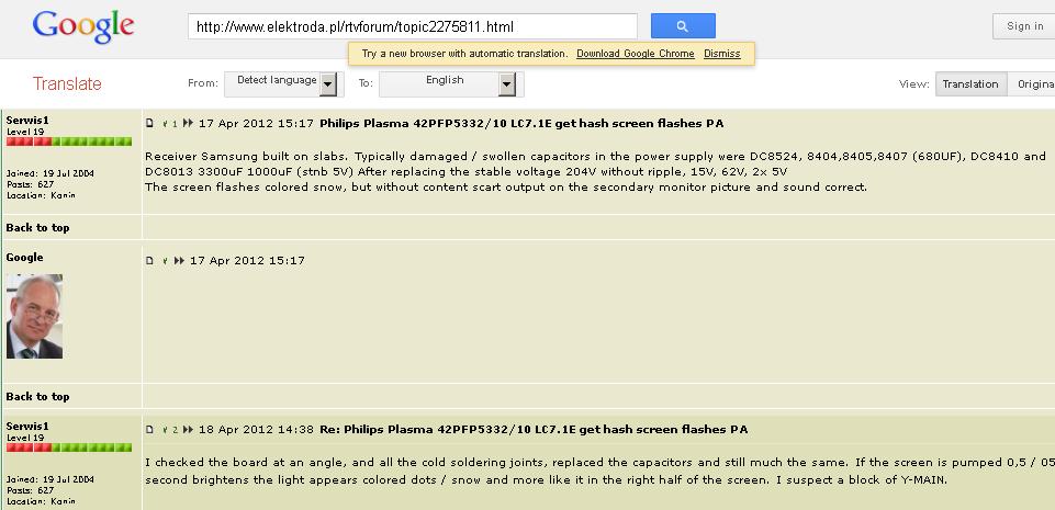

            Googling the last number on your board brings this up
            But its a bit sparce as to where the info is from.

                      Re: Samsung PS-507-phn
                      Well according to the download I posted they are 50v?? which would cover all eventualities.

                        The numbers in that document don't macth the numbers on the board I have. That is why I hesitate a bit. I truly appreciate everyone's input thus far.
                          They are all 680uF/50V

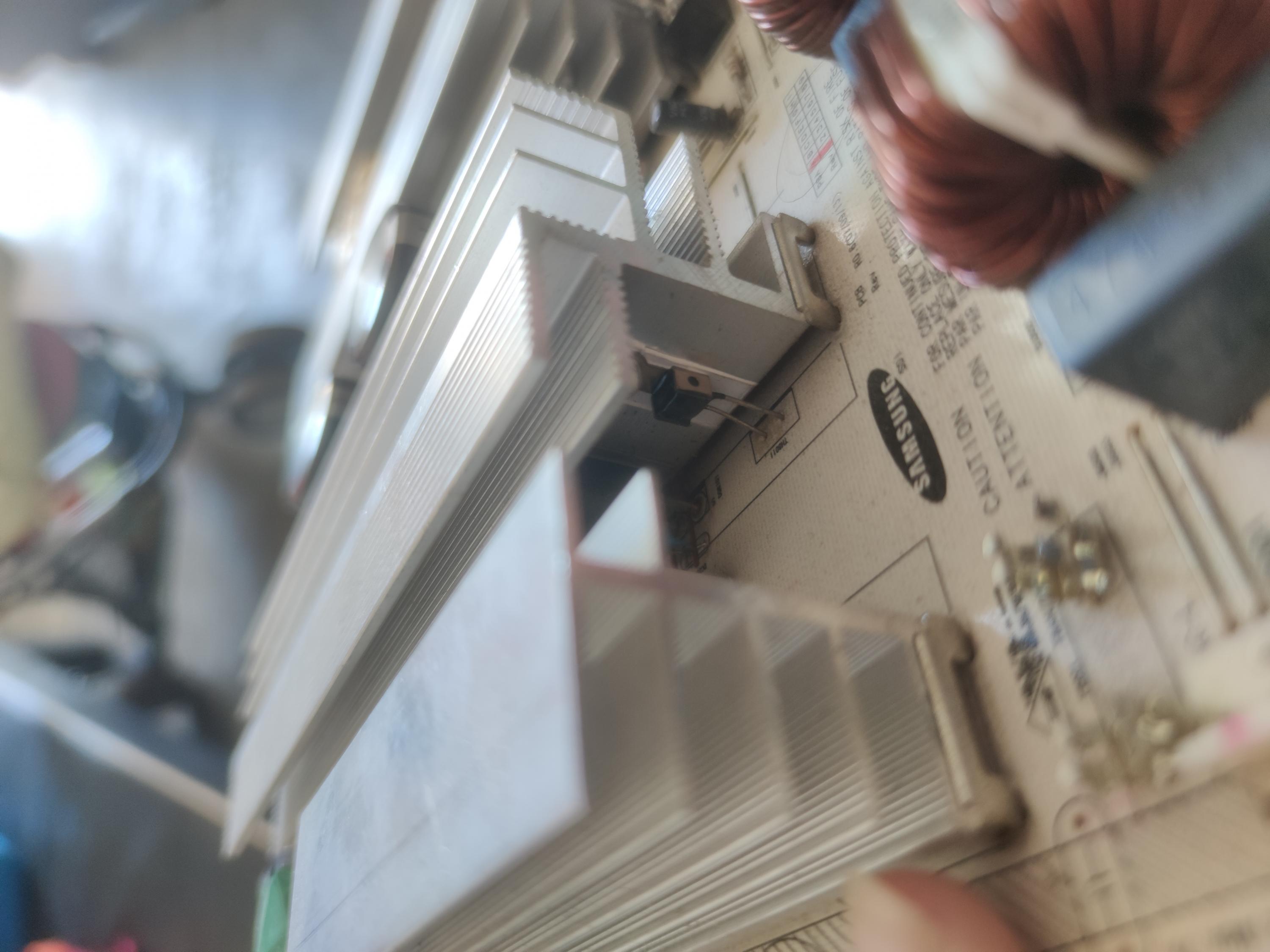

                                I am also in desperate need of a schematic for this PSU, i'm getting the 8 green blinks indicating a thermal error code. i dont have a clue where a thermistor is on the board, anyone?
                                  Here I am zombifying this thread but, for future reference. I believe that that's the thermistor.
                                    Thermistor will be labeled NTC.
                                    • lotas
                                      • Jan 2016
                                      • 4623
                                      • Russia
                                      This temperature sensor is a PTC thermistor.
                                      • nomoresonys
                                        • Jan 2013
                                        • 12206
                                        • U.S.
                                        oh, ok, couldn't tell with the blurry picture.
