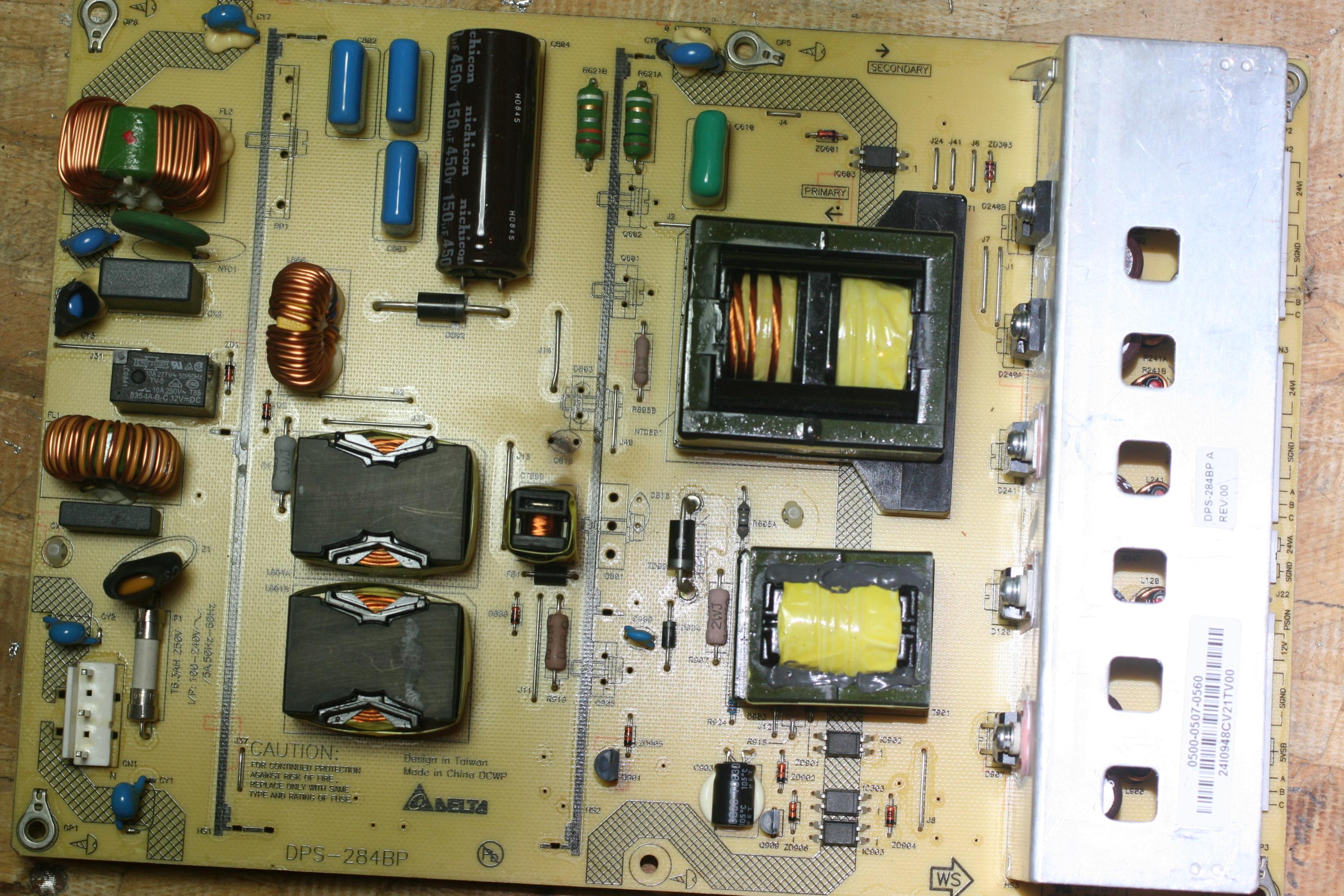

    hi all
    first off thanks in advance hopefully some one can help me
    i have a vizio 42" sv420xvt with bad powersupply for what i believe to be a burnt up cap all that was left is the two wires in the board power supply is dps-284bp or 0500-0507-0560 it looked like a smallish 1/4 -5/16 diameter x 1/2 tall cap as soon is it was exposed it incinerated on the board there is a oval circle with (c815) no idea what to replace it with everything else looks fine

    Re: vizio 42" bad ps need cap
    you should post some pictures and the model number of the TV.

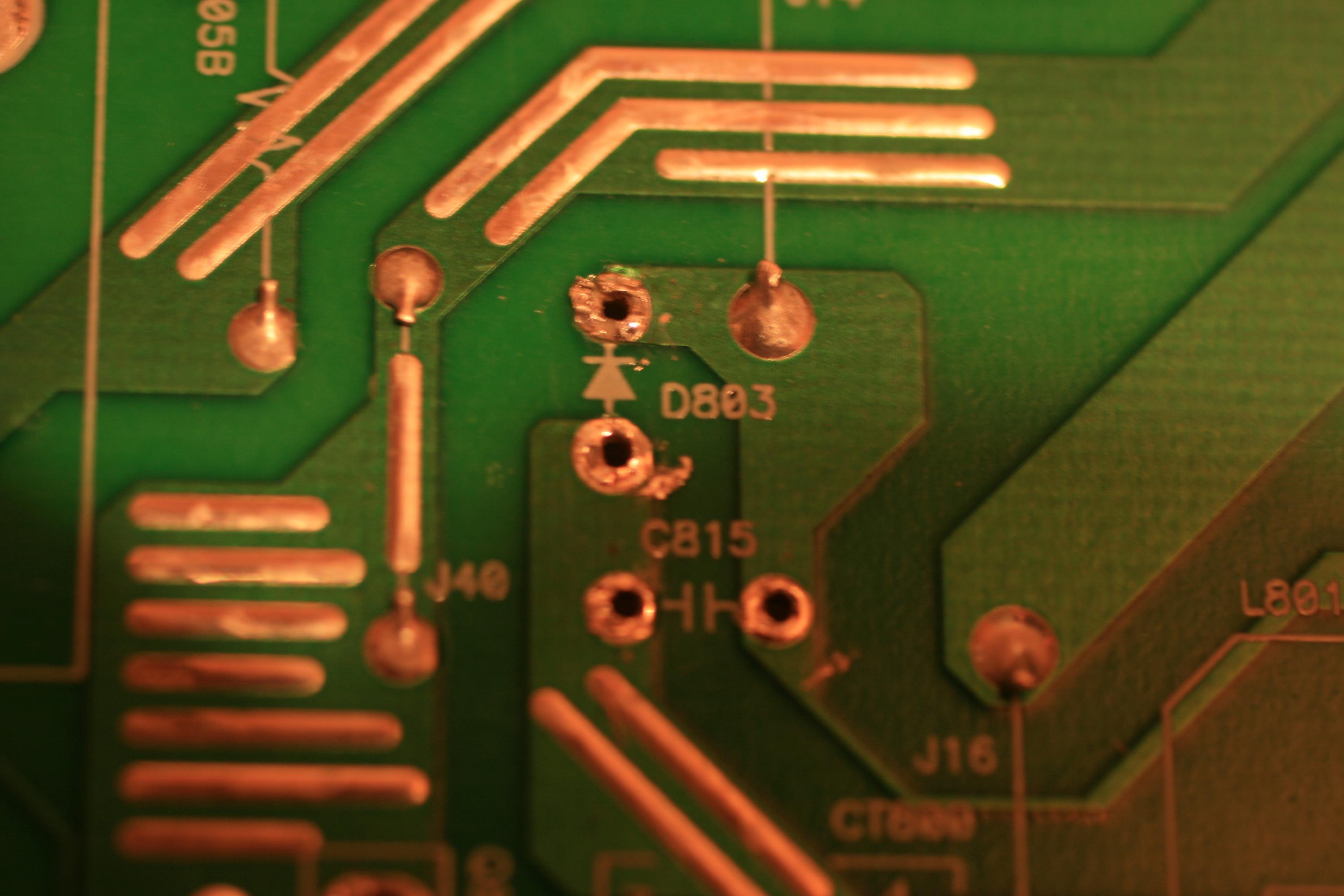

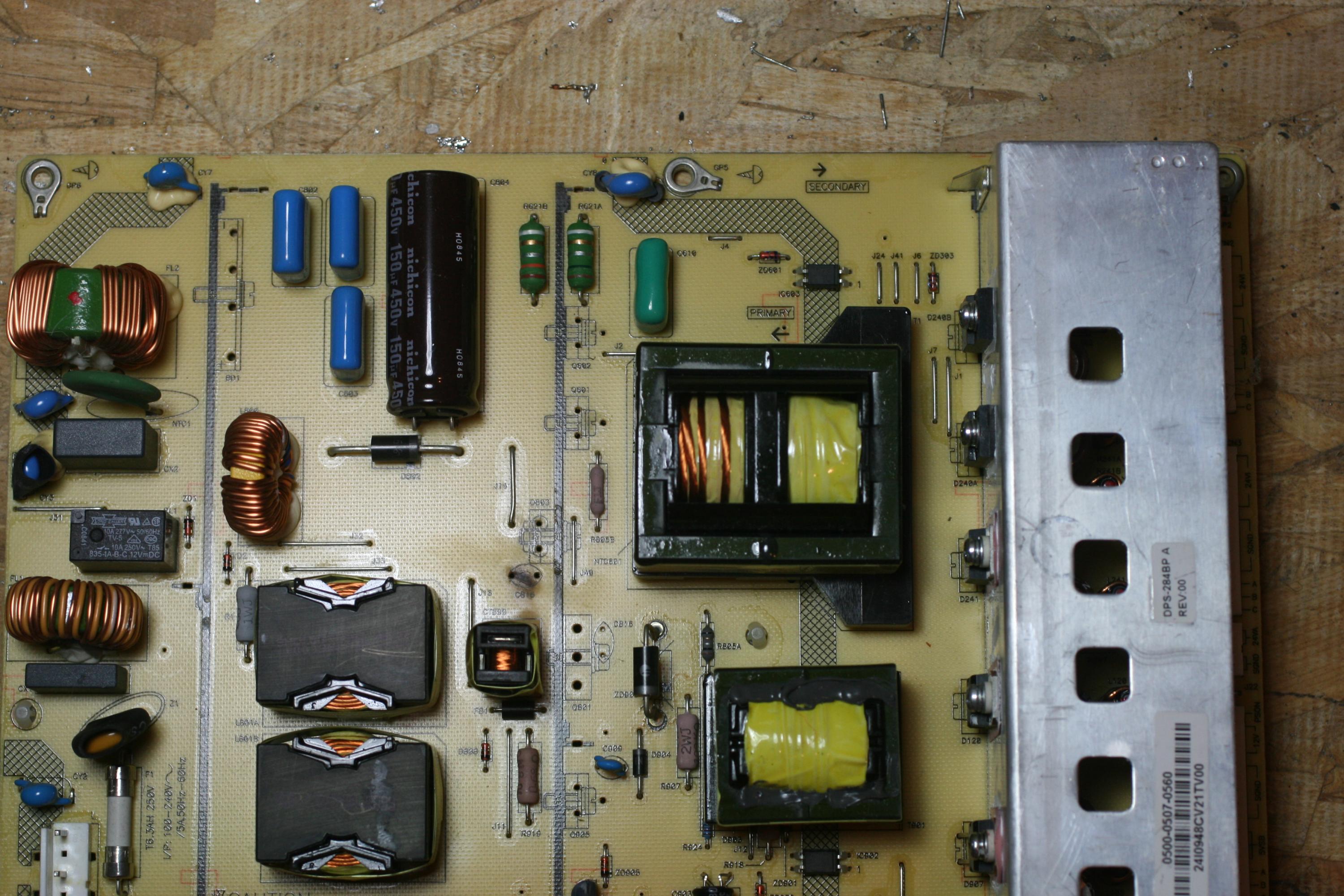

      the tv model is SV420XVT1A
      the thick black lines are for a heat sink i removed and left a couple items attached to it
      c815 is what i need to replace
        Not going to be easy - the other set worked on had another make of board.
        Have you any details for D803 - a datasheet for that might have reference to typical usage. including the cap. A less close up pic of the bottom of the board might help
        someone suggest a suitable one from the circuitry.
            @CATOWLOO: No.
            BTW, that cap is the snubber cap for diode D803.
              The code on cap "C815" is 221 1KV. I believe it's a 220pf 1000v capacitor.
