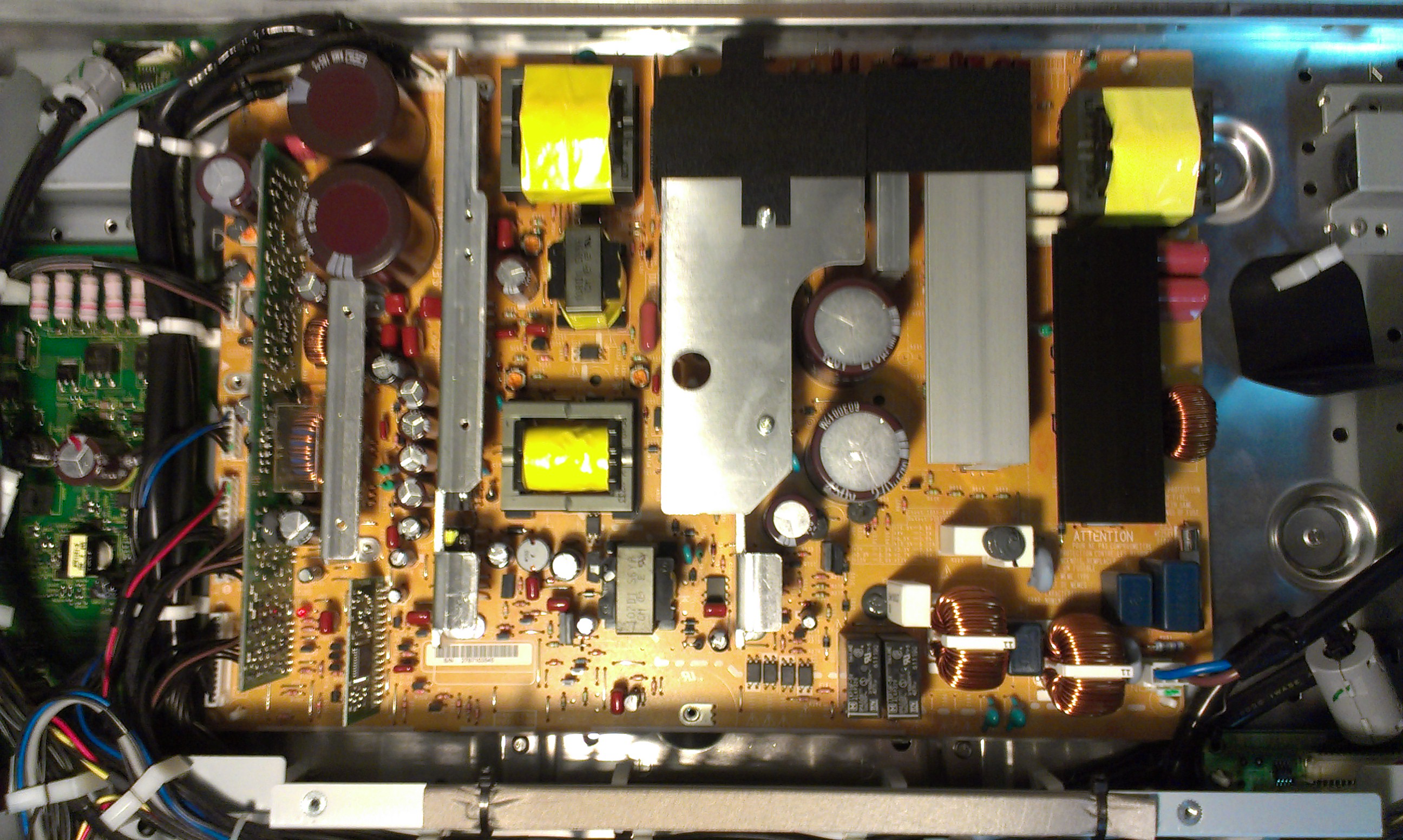

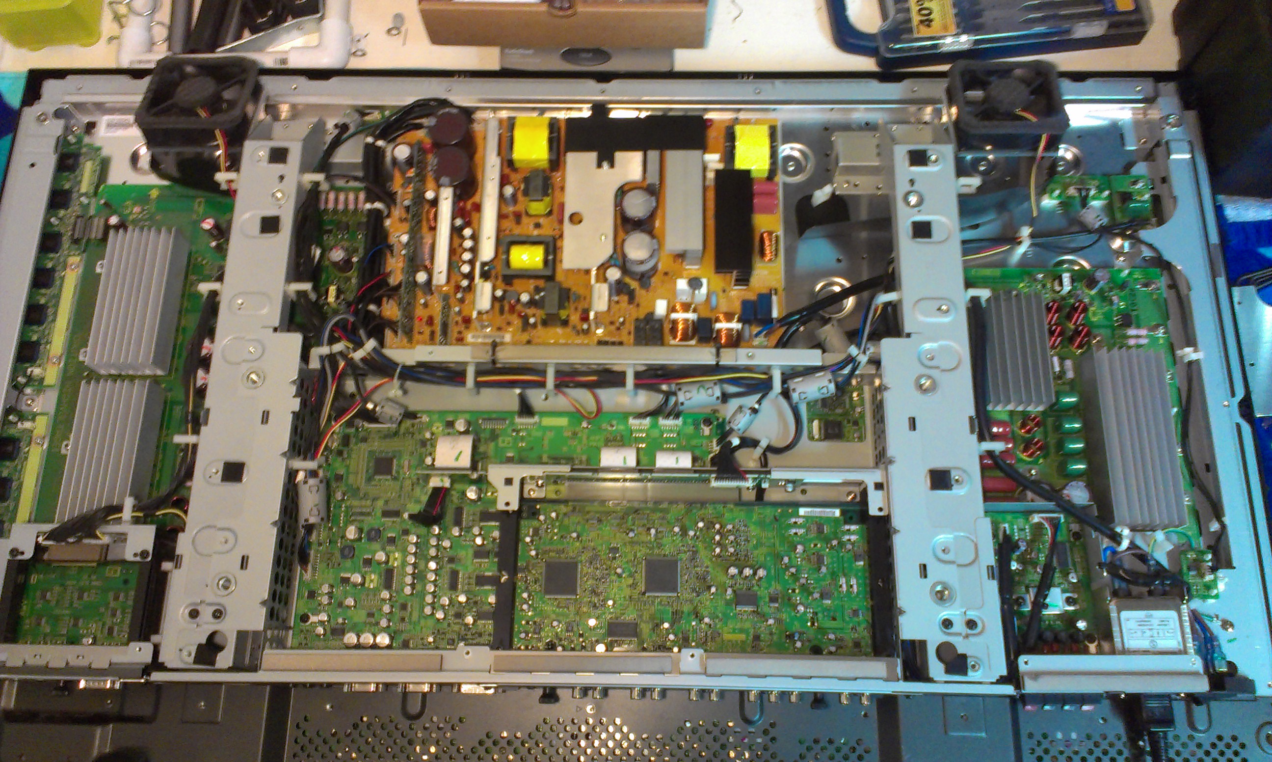

              Re: Pioneer Plasma TV on standby and won't power on
              here are a pics of the back panel and power supply, any way for me to check if the power supply is working properly? I have a multimeter. Thanks
                  Once that small LED on the board is on, does pressing the power button again turn it off?
                  • romanator
                    • Dec 2012
                    • 7
                    nope, doesn't seem to do anything
                      That generally points to either:
                      a) locked out (have you tried above method for unlocking?)
                      b) other mainboard problem
                      As you have power but main board is going no further once turned on.
