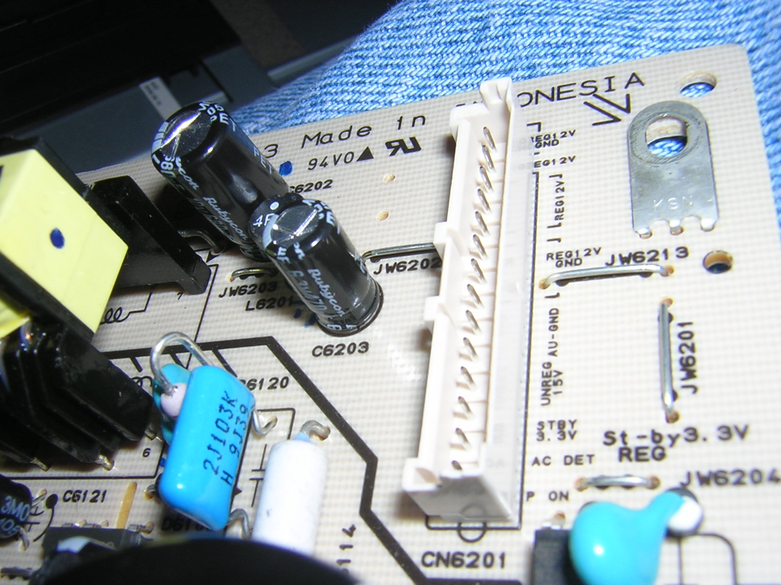

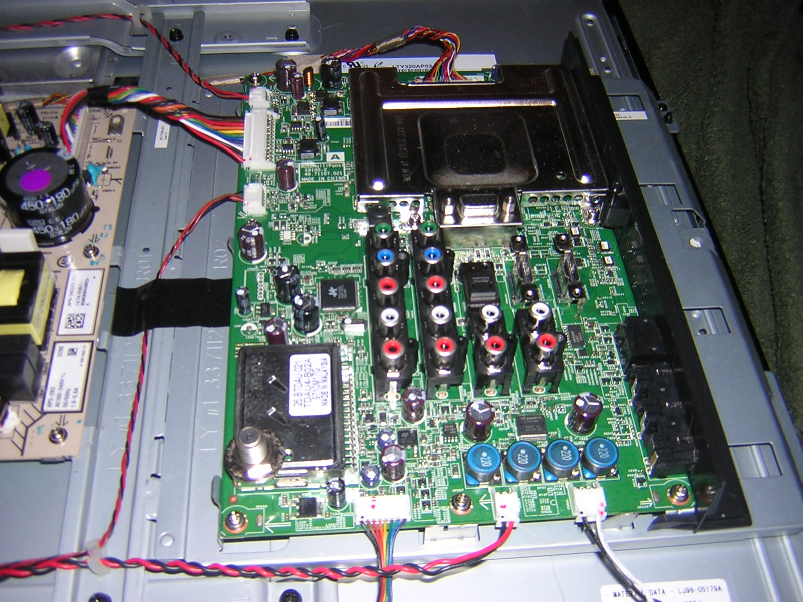

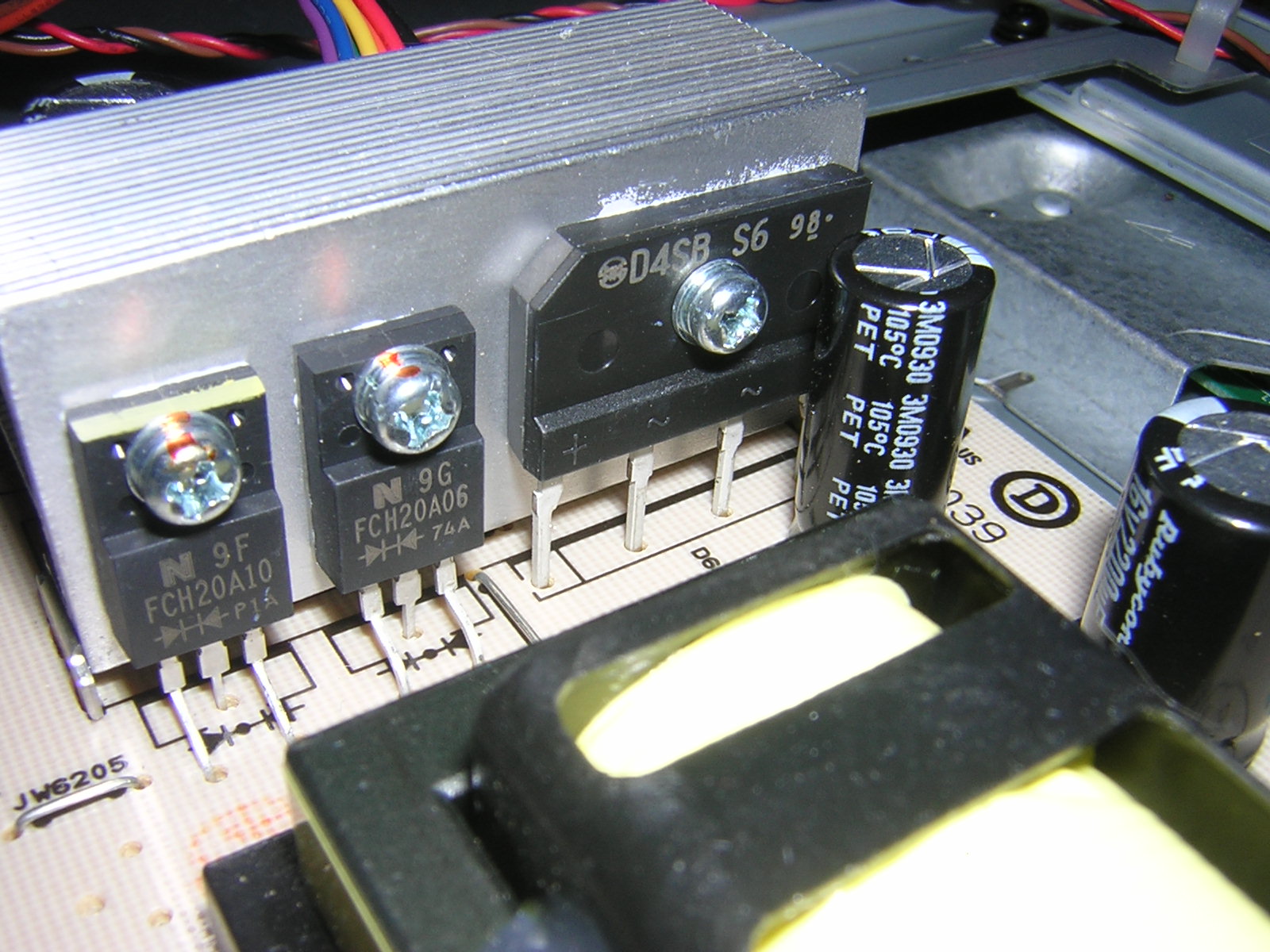

    Hi, a neighbor asked if i could help fix their LCD TV. I like to "tinker" so i thought i would give it a try.
    I am enclosing pics of the main power supply board and video board.
    What i know:
    When i plug in the power cord i do "hear" a click but TV does not come one. NO LED visible as well.
    Any ideas on what to check? i did check the "fuses" on the power supply board but they look ok.....measure around 0.4 to 0.6 ohms.

          Re: Sony KDL-32L504 No Power ....Dead
          OK. on the top right of the power supply board, there is a white connector with multi-wire on it, can you take good close up pictures so we can see the voltage labeling on it? We need to find out if that connector has any DC voltages on it.

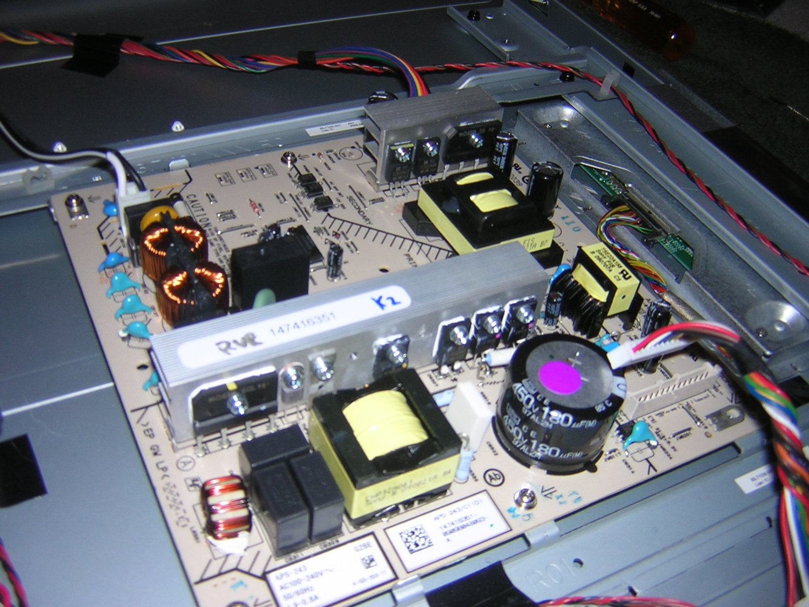

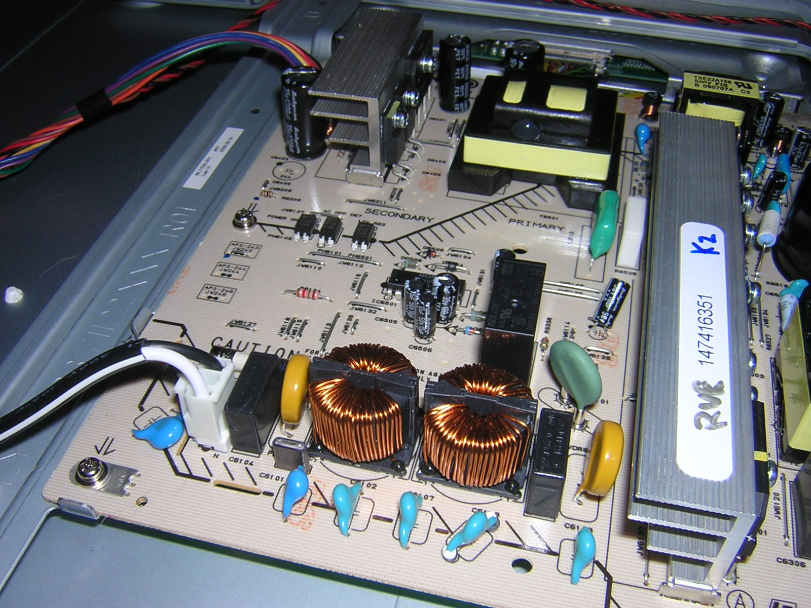

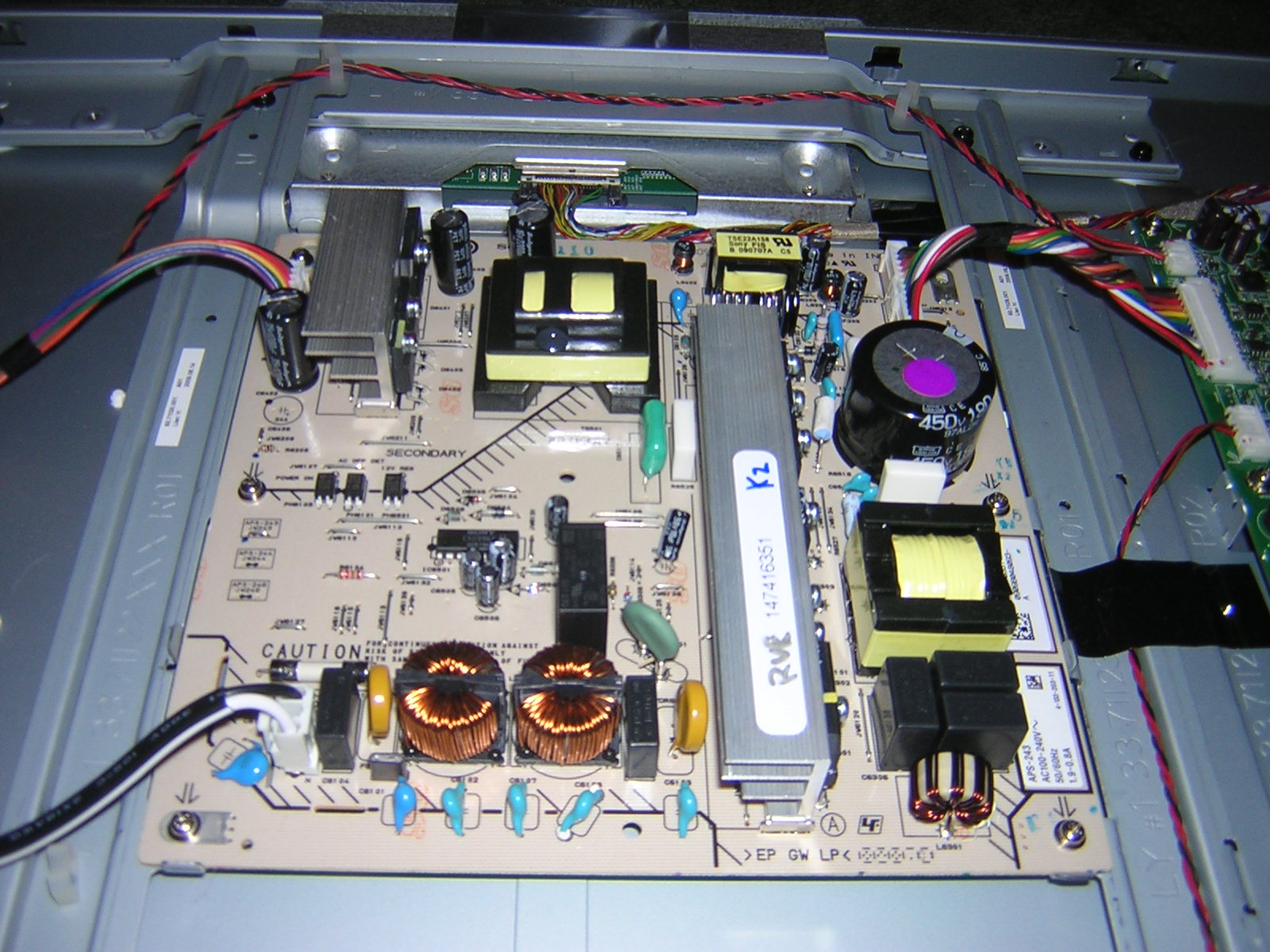

              i have not had time today to make any measurements but i will tomorrow. but i did take some pictures and i am posting them here.
              in one of the pictures i highlighted in yellow two similar type devices. i dont remember what they are called but i do recall that such devices are used to convert AC to DC.........i think.
              I did make a quick measurement of the resistance between the leads of each device...........on one device all the resistance measurements were in the MegaOhm range........for the other the two inner leads were shorted......is this a problem?
                They are bridge rectifier, the two inner pins (they should have something like 'AC' or ~ on them to indiacte AC) are usually where the AC will be applied to. If it read short then more likely will cause the fuse feeding it ti blow.

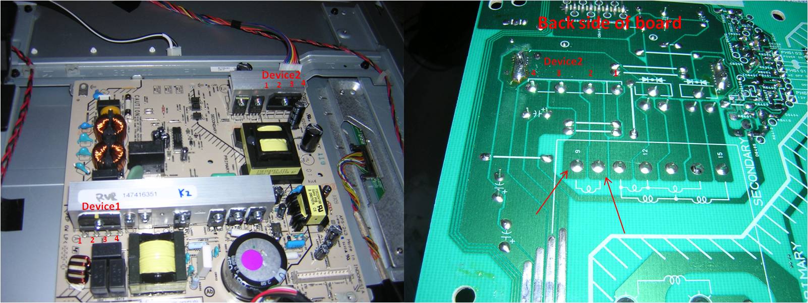

                    i did a quick ohms measurement of the two bridge-rectifier looking chips. See enclosed picture where i identify the two with labels which will correspond to the measurements below:
                    Device1:
                    Pin1 to 2: 1.2MegOhm
                    Pin2 to 3: 1.3MegOhm
                    Pin3 to 4: 0.9MegOhm
                    Device2:
                    Pin1 to 2: 7.6kiloOhm
                    Pin2 to 3: 0.5Ohm
                    Pin3 to 4: ~1KiloOhm
                    When you look on the back of the board.......pins 2 and 3 should be shorted as they have an inductor i guess between the pads.....makes me wonder if the other readings are ok as well............
                        Device 2 appears to be on the secondary side of the board so on Device 1 can you carefully test for high voltages.
                        Can you perhaps update your profile with country and mains voltage then we will know what we are dealing with.
                        First set your meter on 600 VAC or autorange and check that you get mains voltage at the mains in socket. Next test for mains voltage on both sides of the fuse. Next test the centre pins on device one for mains voltage.
                        Change your meter setting to 600VDC and check the voltage on the outer + and - pins on device1.
                          That device2 (bridge rectifier) is for secondary side power supply, pin 2 and 3 are connected to the output winding of the transformer, so the DC resistance will be REALLY LOW which is normal when read in circuits.

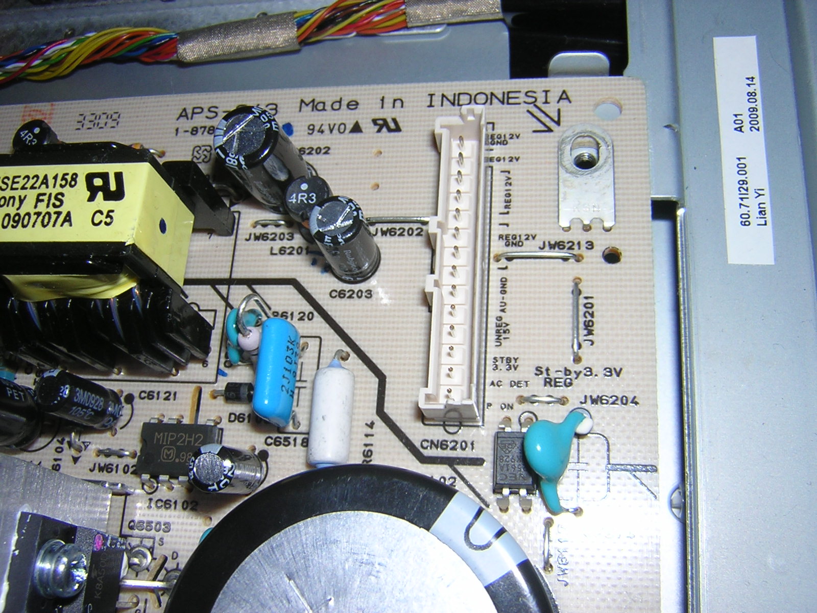

                              budm,
                              see post #7.........i took a picture of the white connector you asked for........does this answer you question?

                                Device1:
                                Pin1(red) to Pin2(black): 1.2MegOhm
                                Pin2(red) to Pin1(black): 0.6Megohm to 1.2MegOhm...started out at 0.6MegOhm and increased
                                Pin2(red) to Pin3(black): 1.3MegOhm
                                Pin3(red) to Pin2(black): 1.3MegOhm
                                Pin3(red) to Pin4(black): 0.9MegOhm
                                Pin4(red) to Pin3(black): ~0.9MegOhm
                                Device2:
                                Pin1(red) to Pin2(black): 7.6KiloOhm
                                Pin2(red) to Pin1(black): ~1KiloOhm
                                Pin2(red) to Pin3(black): 0.5ohm
                                Pin3(red) to Pin2(black): 0.5Ohm
                                Pin3(red) to Pin4(black): ~1kiloOhm
                                Pin4(red) to Pin3(black): ~1kiloOhm
                                  Sorry, but no, the picture of the connector with wires in the way to be able to read the printing on the board.
                                    Neither of the them seem right outer pairs should be off scale one way and less than 2000
                                    the other ( at least that is what I believe)
                                    Can you do the voltage test
                                      i am enclosing pics of the connectors. the pics are at an angle so if you need me to retake them just let me know.
                                      i also measure the line voltage (prior to the fuse) and it was 122.5VAC
                                      Then i measured the AC voltage on the center two pins of the bridge recitifier labeled in a previous pic as device 1.........and its voltage was 122.5VAC.
                                      Was not sure what to measure "Change your meter setting to 600VDC and check the voltage on the outer + and - pins on device1. ".......which one is the + and which one the -
