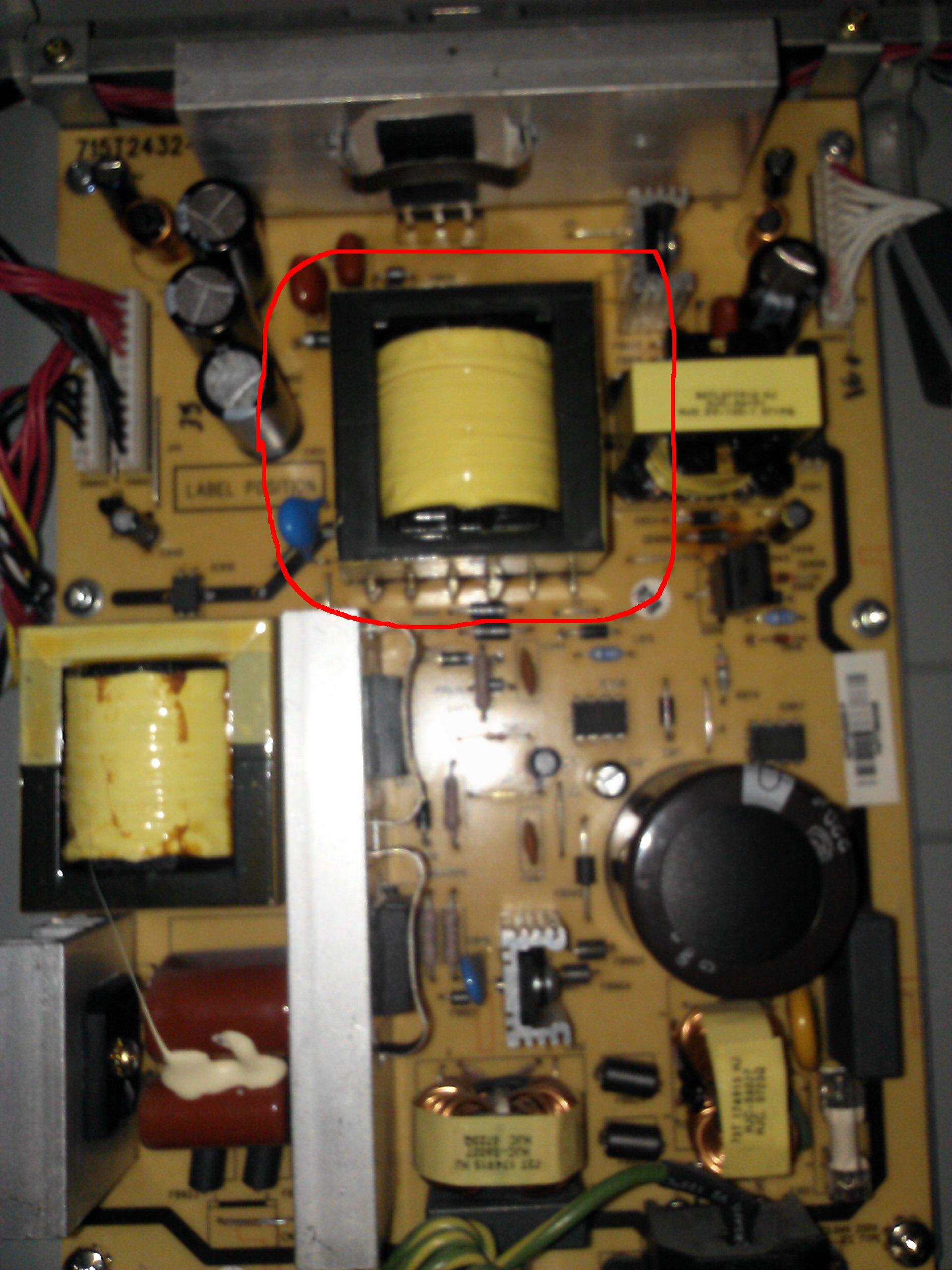

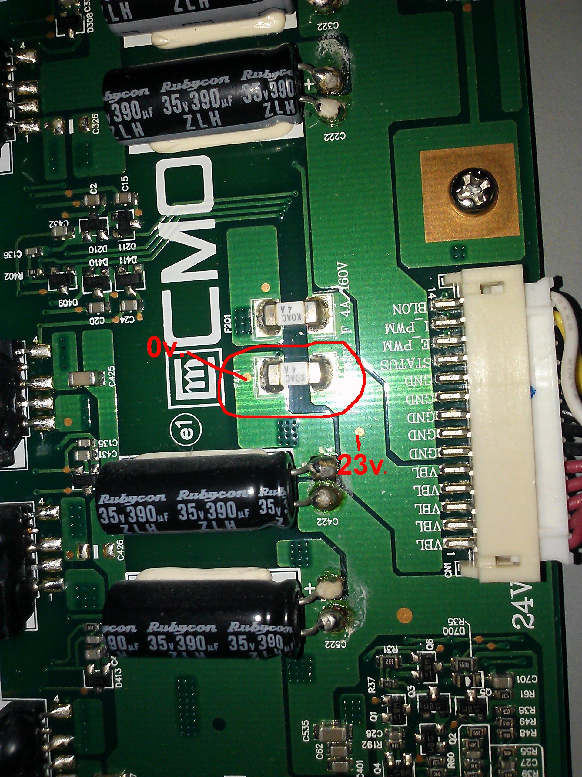

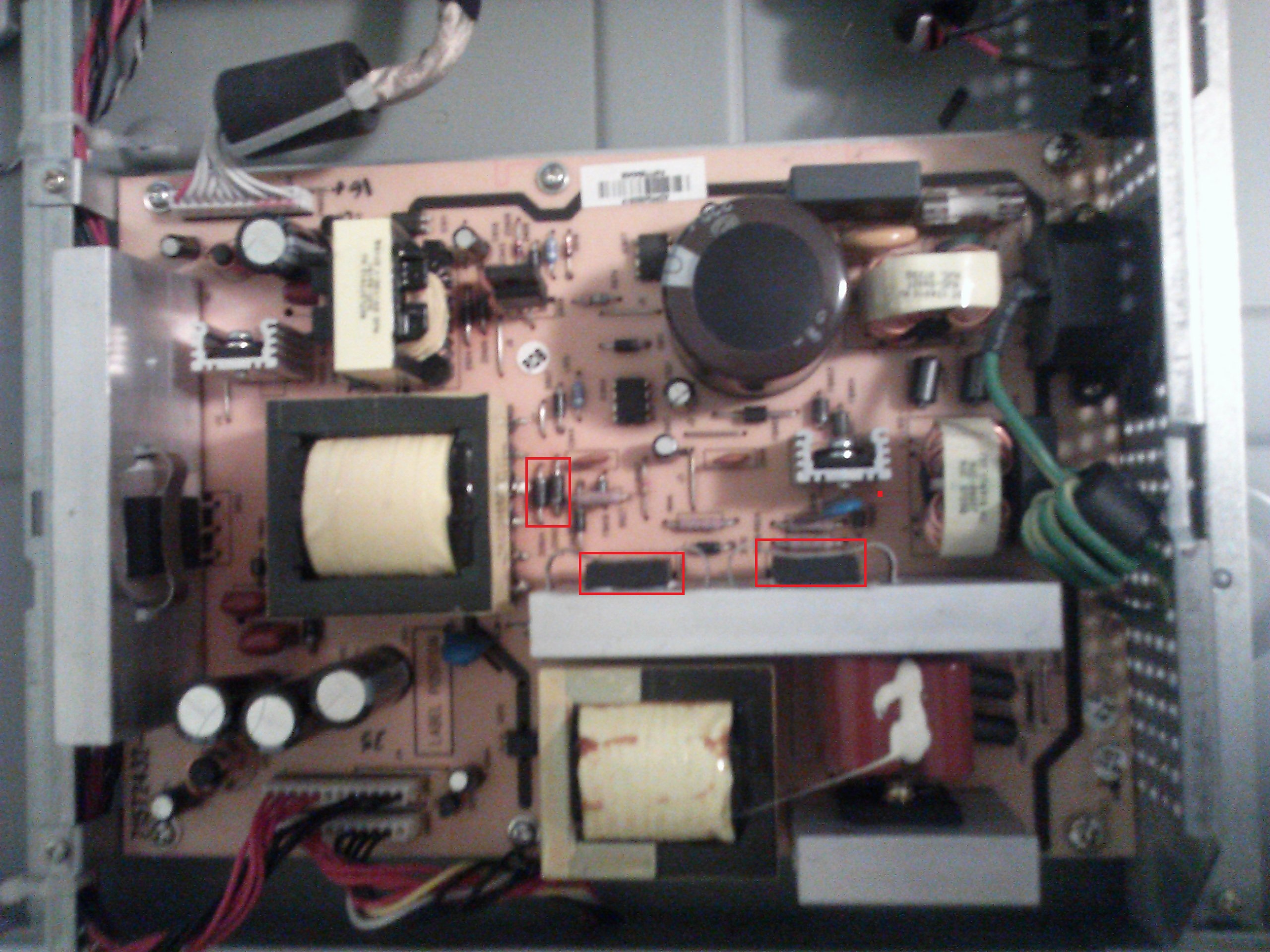

this tv was dead when i got it and noticed bad caps so i ordered and replaced all power board caps.
now it powers on ok, no blink codes and red led turns to solid green.
backlight comes on and it starts to flicker on and off fast.
I hear squeeking from power board, sounds like its from transformer in picture.
bl_on is 3v
vbl is 17-18v seems to pulse a little with backlights flickering.
i havent downloaded a service manual yet but i assume the blv should be 24v.

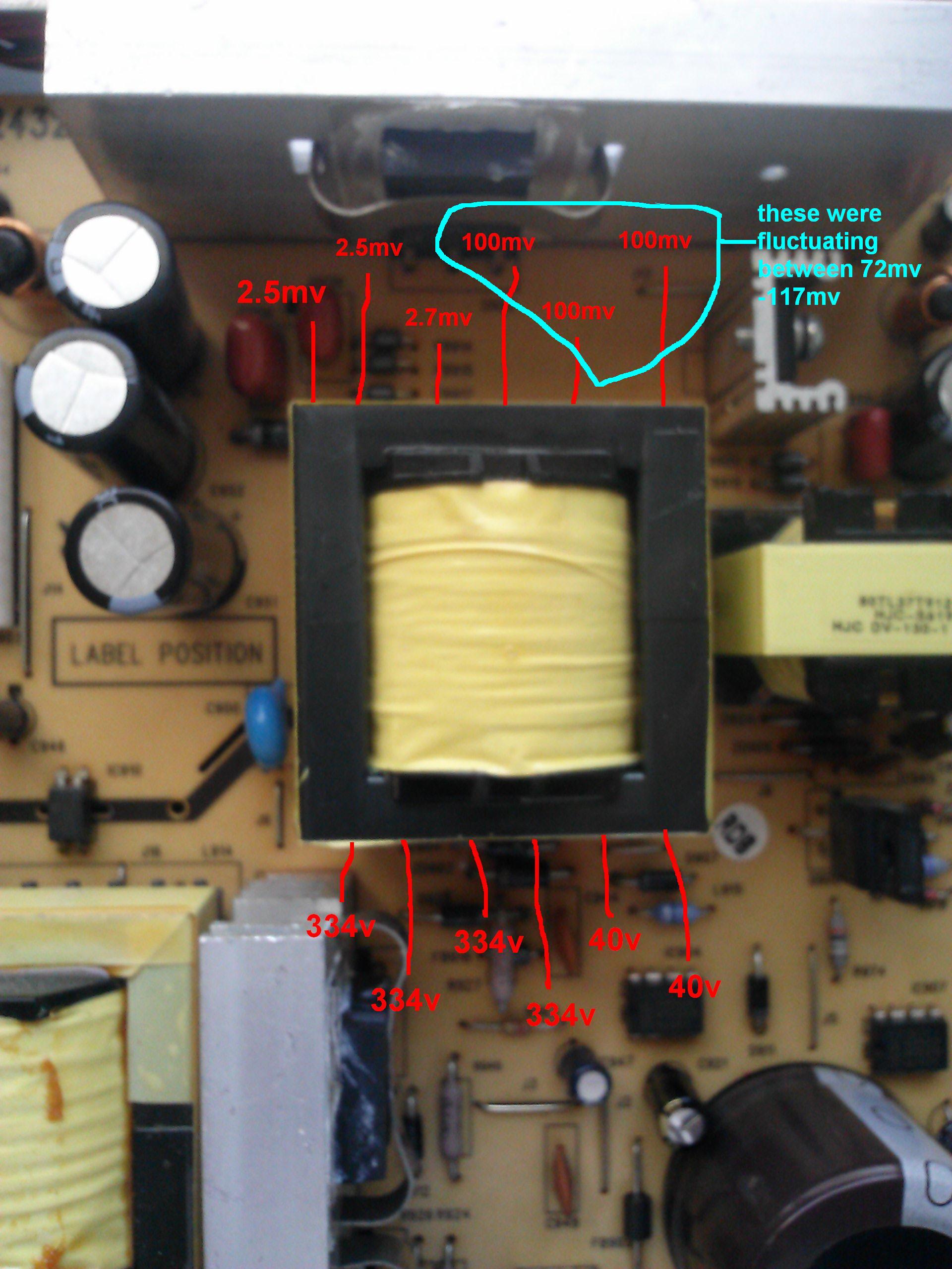

it is difficult to get underneath to check voltages on transformer but i will see what i can do. if i cant get to all the leads can i remove and test it somehow? all i have is a dmm.
