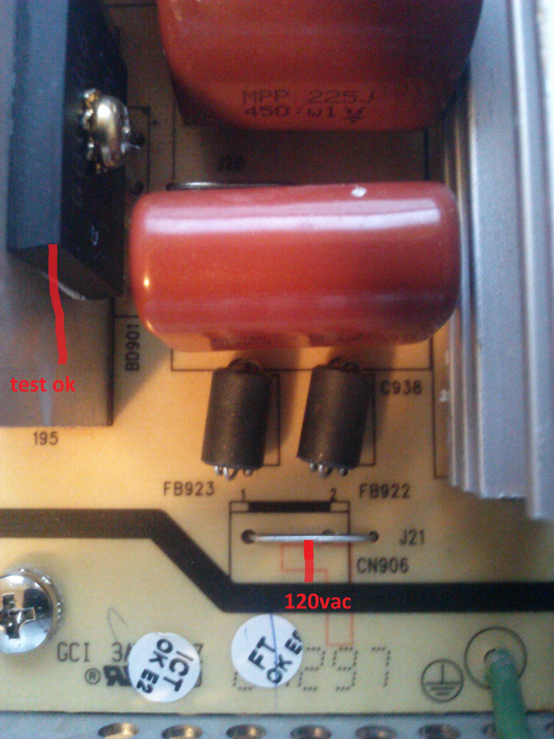

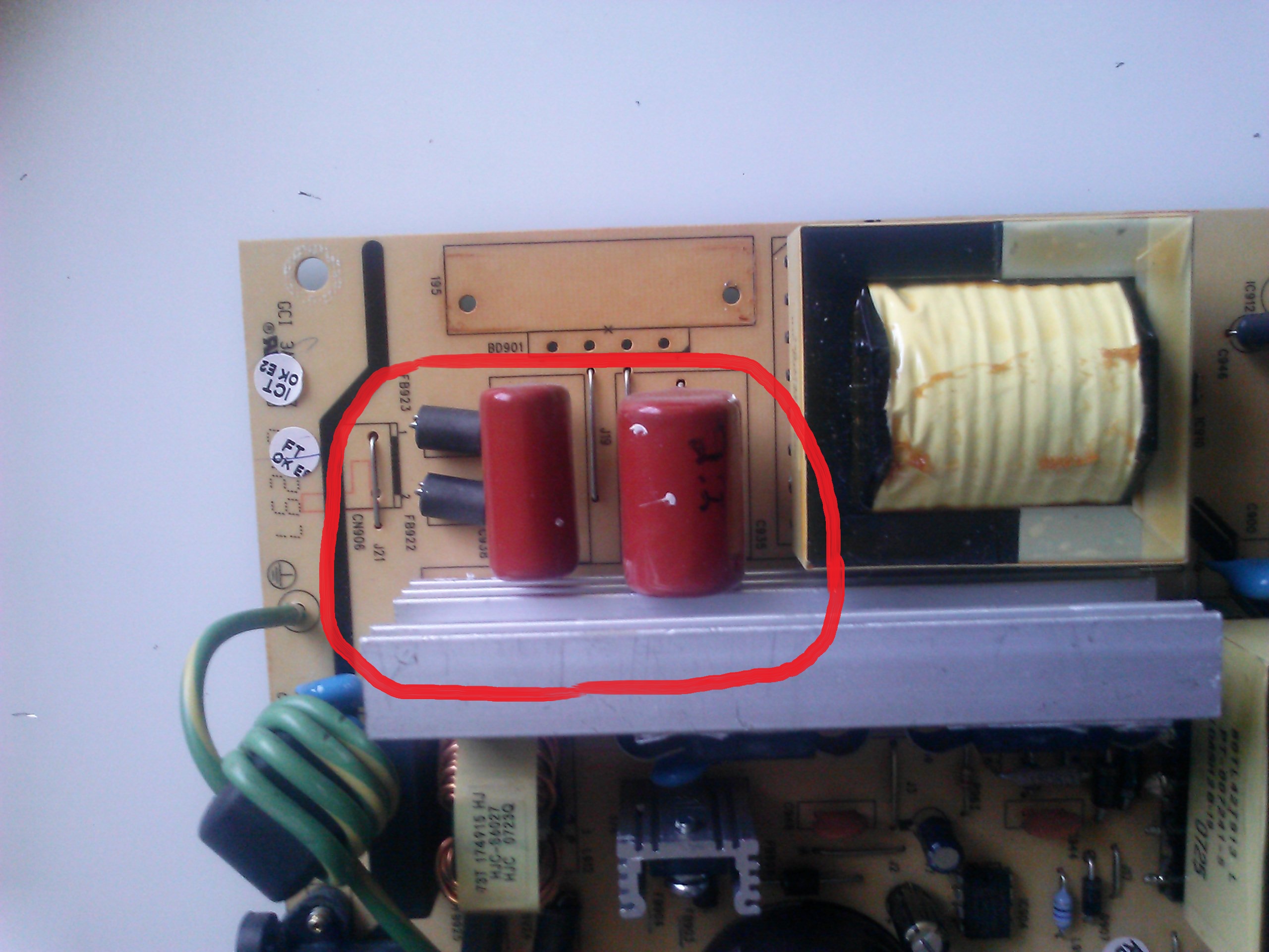

      Re: Philips 42pfl5432d backlight
      Did you check the startup cap? It's different to the main cap.
      • ryan74
        • Oct 2012
        • 471
        • usa
        not sure which one that is but all caps(except the big one) were replaced when i started working on this.
          I think the 325vdc on the cap is too low.
          See the sch of the power supply.

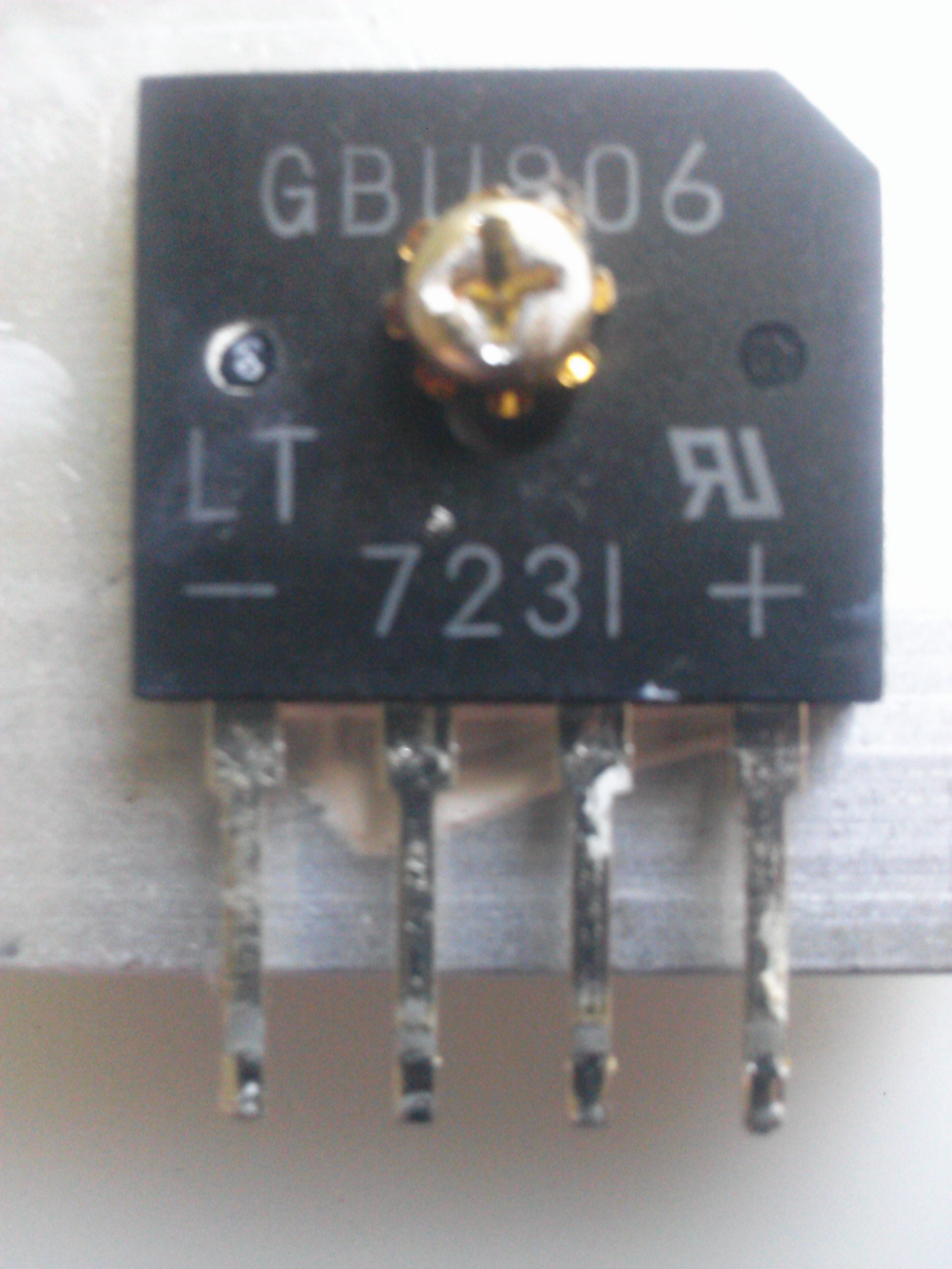

              schematic didnt help too much but it looked like the problem could be around BD901 or ic902
              im about to give up on this tv and junk it just because i have over 6 hrs of reading and looking at schematics invested (and 1 headache) it hasnt helped because i have such a limited understanding of component lvl repair. everything i read leads me to bad caps or diods(fets). im not paying over $100 for a replacement power supply.
              At this point i would consider sending it out for repair if anyone is interested.
              Are the parts circled capacitors? do these test any different?
              I want to check BD901(one of a few i havent tested yet) but it has 4pins and 2 are marked +-. im not sure if i test the usual way with black probe on pin1 then red on 2-3-4 and report all readings then continue with black probe on pin2, red on p1,3,4 and so on.
              • selldoor
                Slow Learner
                • Dec 2010
                • 7870
                Not sure about the caps - dont think you can test except perhaps for being short or open
                The BD is the bridge rectifier if that was not working you would get no voltage on the big cap. Here is one way of testing
                Pins 0 0 0 0
                ..... 1 2 3 4
                Mains power OFF
                Set your meter to measure 2000 ohms.
                Place positive (red) probe on the + pin. 1 above
                Place negative (black) probe on the ac pin 2 above.
                Write down the result. ohms
                Place positive (red) probe on the ac pin. 2 above
                Place negative (black) probe on the + pin 1 above.
                Write down the result ohms
                Place negative (black) probe on the ac pin 3 above.
                Place positive (red) probe on the ac pin. 3 above
                Place negative (black) probe on the - pin 4 above.
                Place positive (red) probe on the - pin. 4 above
                You can cut and past the above and write in your results
                It is like a double diode
                  i think my meter only has autorange
                  Pins 0 0 0 0
                  ..... 1 2 3 4
                  Mains power OFF
                  Write down the result. ohms = 3.75mohm
                  Write down the result ohms = .0L
                  Write down the result ohms = 37.21mohm
                  Write down the result ohms = 35.72mohm
                  Write down the result ohms = 0.746mohm
                  Write down the result. ohms = 37.52mohm
                  testing the same pins in diode mode i got:
                  p1-2 =.496
                  p2-1 = .0L
                  p2-3 = .0L
                  p3-2 = .0L
                  p3-4 = .477
                  p4-3 = .0L
                  • selldoor
                    Slow Learner
                    • Dec 2010
                    • 7870
                    #29
                    Yes it is ok

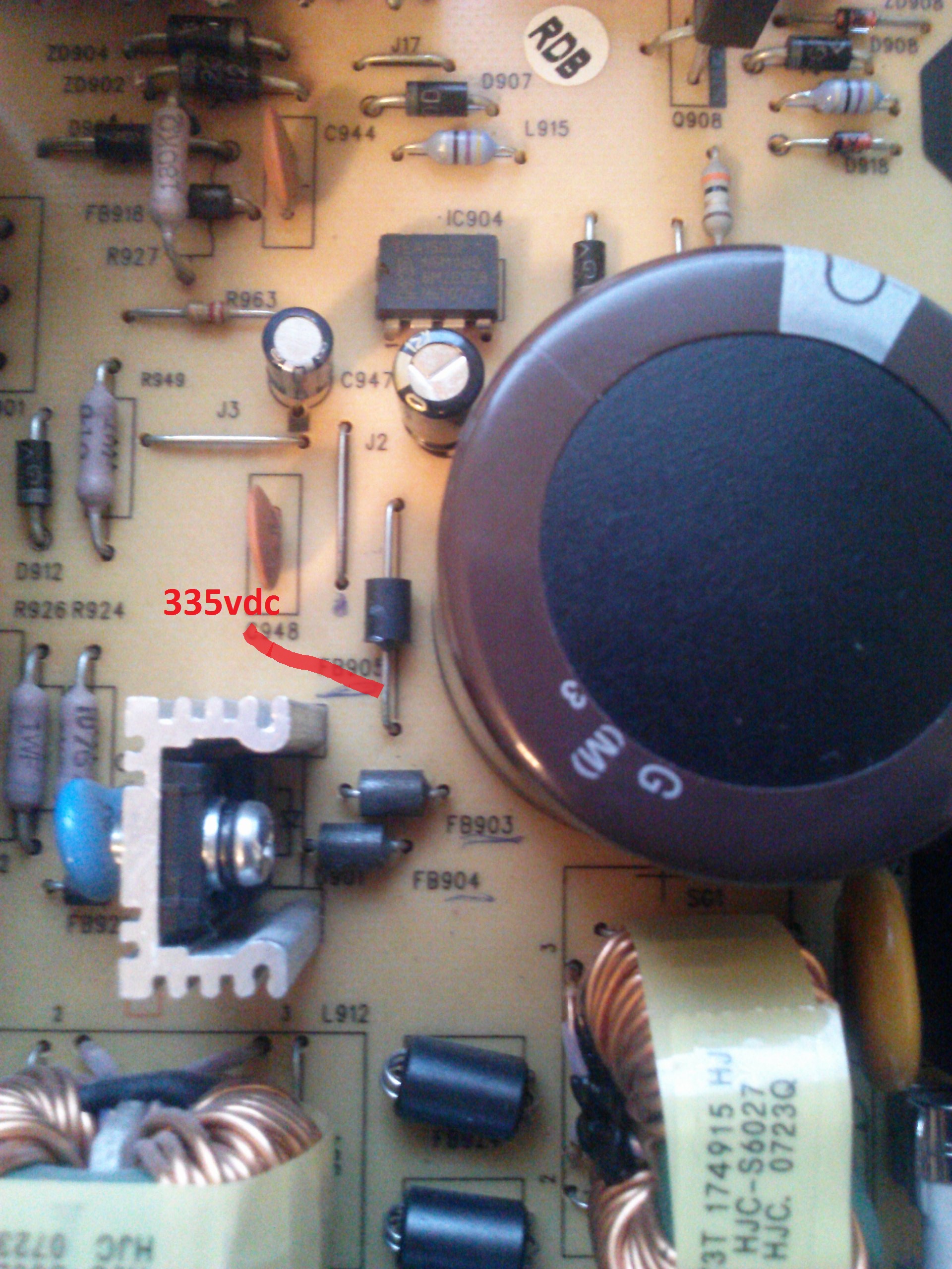

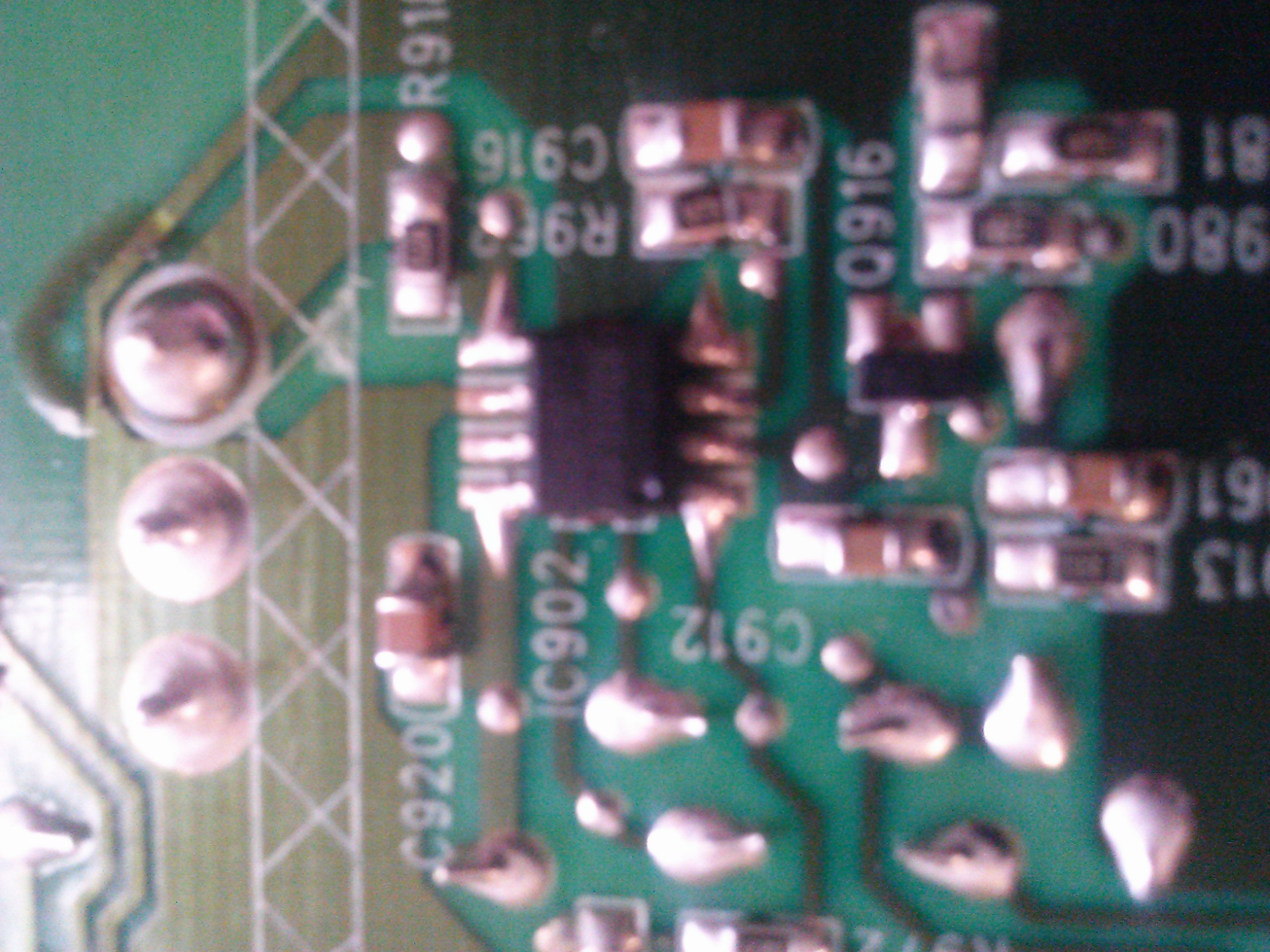

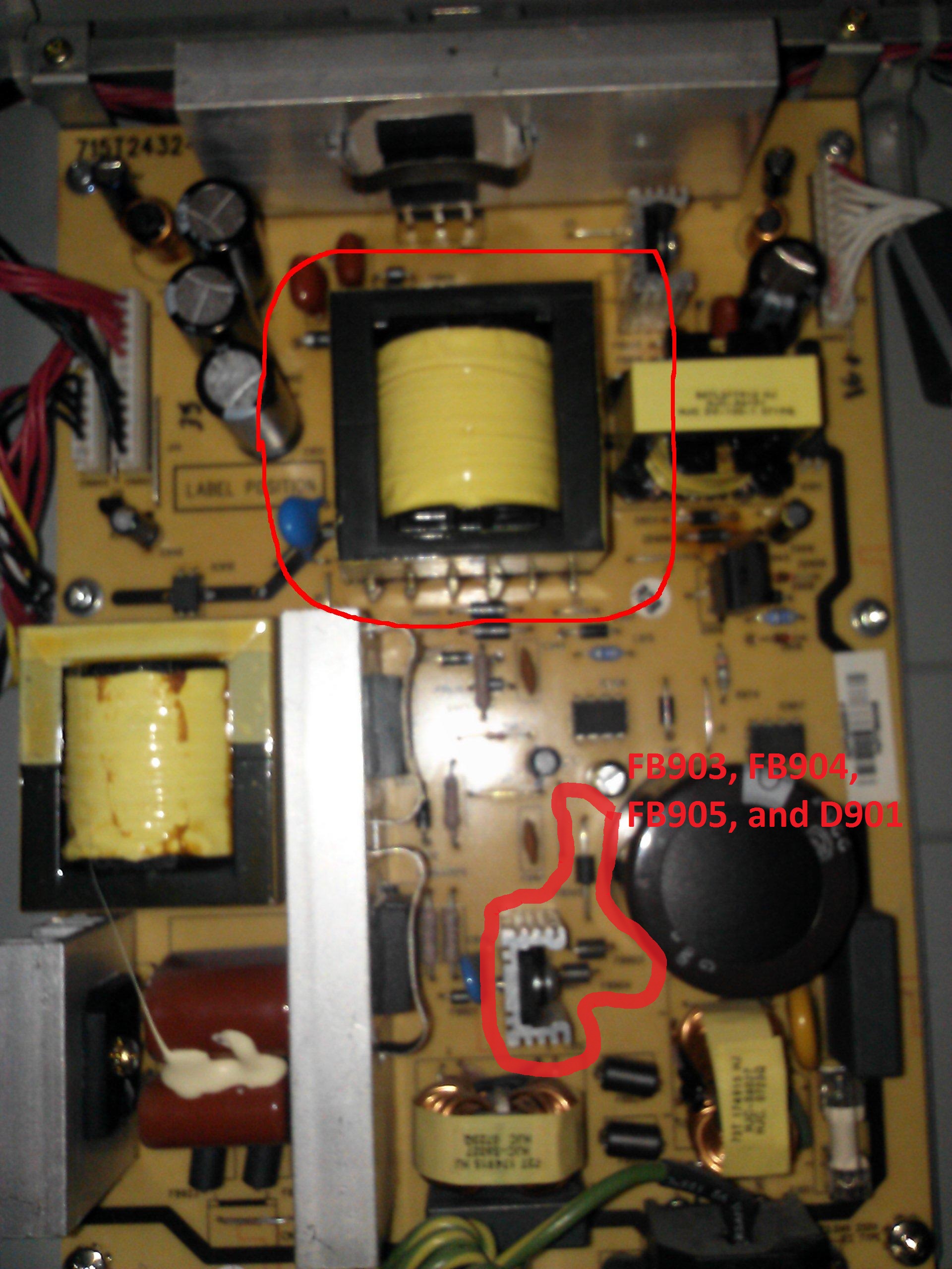

                        #31
                        D901
                        STTH8L06FP
                        GK2E9 VU
                        CHN 725
                        black probe on p1
                        p1-2 = 6.95mohms
                        black probe on p2
                        p2-1 = 0.L
                        i also tested in diode mode
                        p1-2 = 0.439v
                        p2-1 = .0L
                        im not sure how to test FB903, FB904, FB905
                        they look like diodes but no grey line
                        also theres resistors R969,R970,R971 on the bottom of board.
                        should i test these and how
                        i read ic902 on the back could cause problems but not sure how to test it either.

                            #33
                            FBxxx are ferrite beads you jsut need to test for continuity
                            Resistors - you check on ohms - need to lift one end for accuracy /continuity
                            I dont know how to test IC - if you get the part number off it you might find a datasheet which would help

                              #34
                              I think I fixed it. Backlights turn on now.
                              I Think someone attempted to repair it before.
                              I found a bad trace on bottom of board after I went and bought a magnifying lamp.
                              After repairing it the backlights stay on.
                              I'm sooo happy I don't have to send it out.
                              Thanks for the help. At least I learned something.
