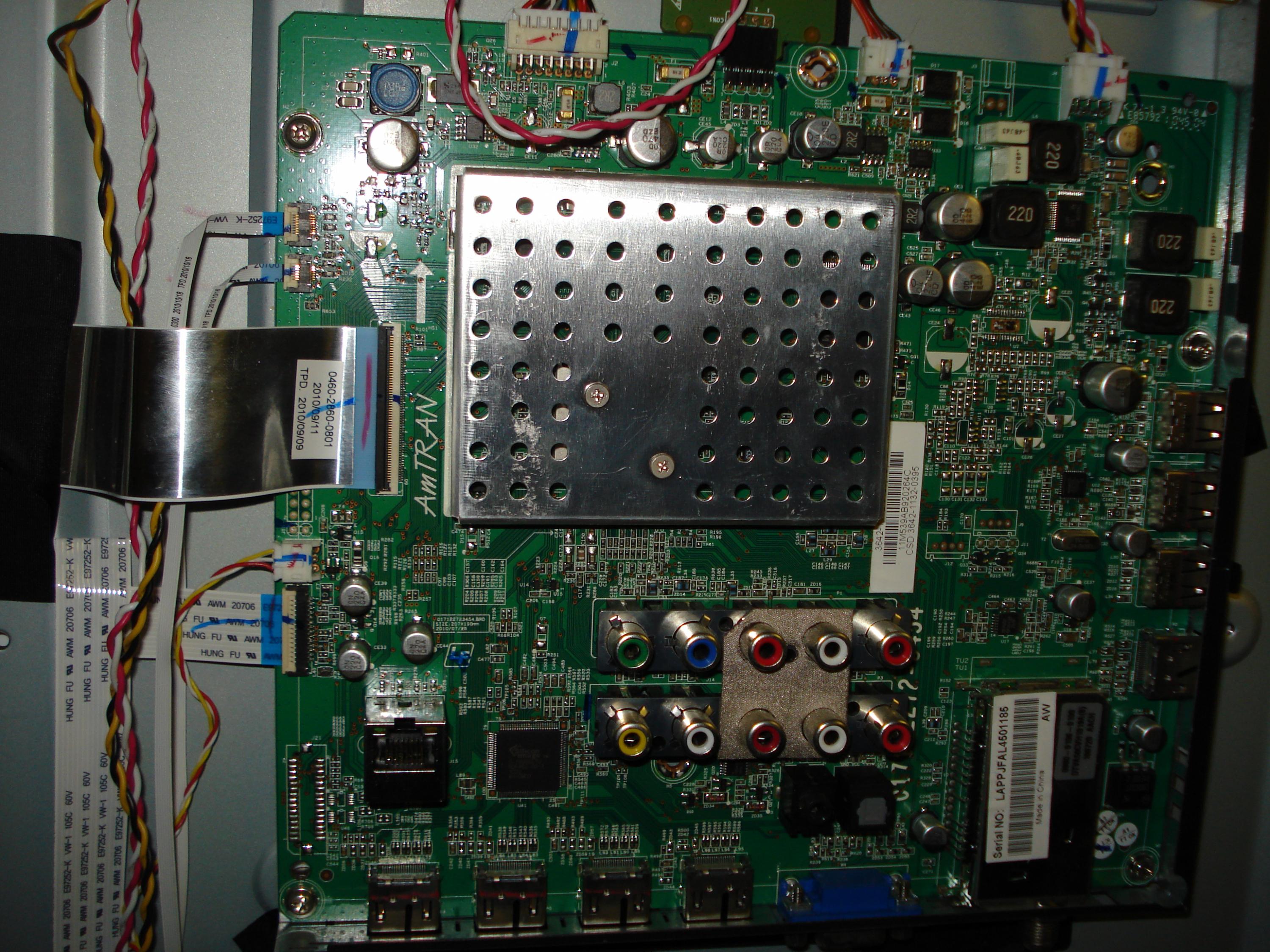

    This is a newer LED/LCD TV, has LED for Backlighting and an LCD Display Panel.
    It does power on but has no display, has only a blank grayish screen with no video, I tried hooking up a dvd player as a source but since I can not see any images on the tv screen I can't tell what input mode is selected. with this set is was easier to measure voltages on the small fuses on both the Mainboard and T-Con Board. instead of measuring at the power supply connectors and taking a chance on the meter probe slipping and shorting out.
    It has all dc voltages present, 5 volts, 12 volts and 18 volts. I measured these on both sides of the fuses to ensure the fuses are good as well as voltages being present. I noticed that the processor under the metal shield on the mainboard is generating some heat so hopefully it is working, but the heat sink on the T-Con stays cool even after leaving the set on for over 1 hour. I removed and reinstalled the T-Con board therefore re-seated attached ribbon cables and visually inspected the board. At this point I think the T-Con board has failed and is causing the problem, I do have another posting on this set but could not edit the heading or delete the post and I felt like the heading was misleading. Model Vizio XVT3D424SV. please reply back, your help is appreciated. Thanks!

    Re: 42" Vizio No Picture has Backlight
    Pictures of the main board? Also have you checked the Voltage regulators on the main board?
      Being a newer set this main board does not have the typical AMC1117 Voltage regulators, here's some pictures I found on the net of the same exact boards this set uses. I have only checked the voltages on the fuses.

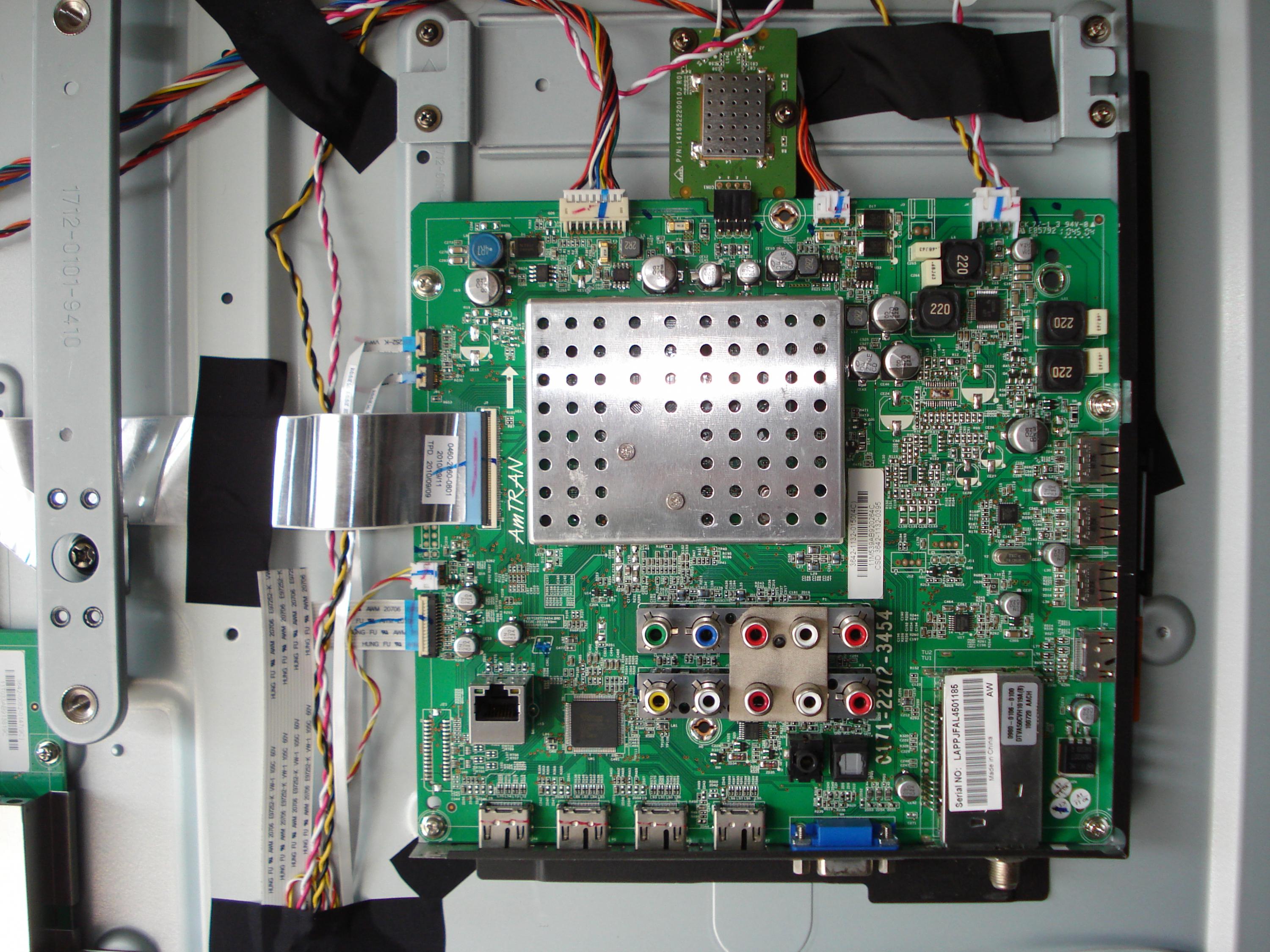

        More Main Board Pictures

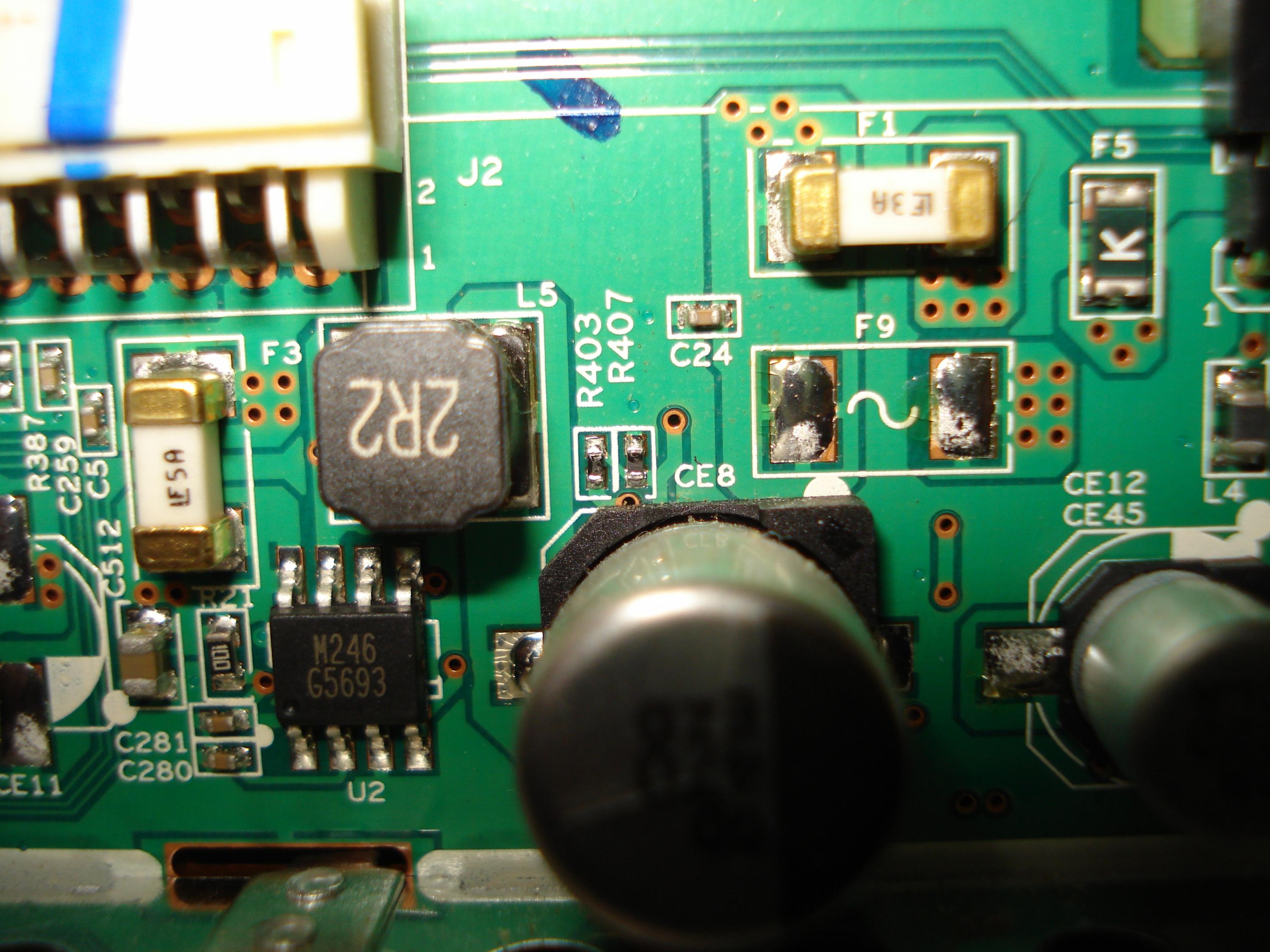

          Sorry to ask, but can I get a close up picture of the area where the back light cable plugs in. Like a 2 inches perimeter around the connector. Also are all your surface mounted fuses good?
            The backlights are working and they are LED, they are powered directly from the power supply board therefore there's no need for inverter boards. Do you still want a close up picture of where the back light cables plugs in?

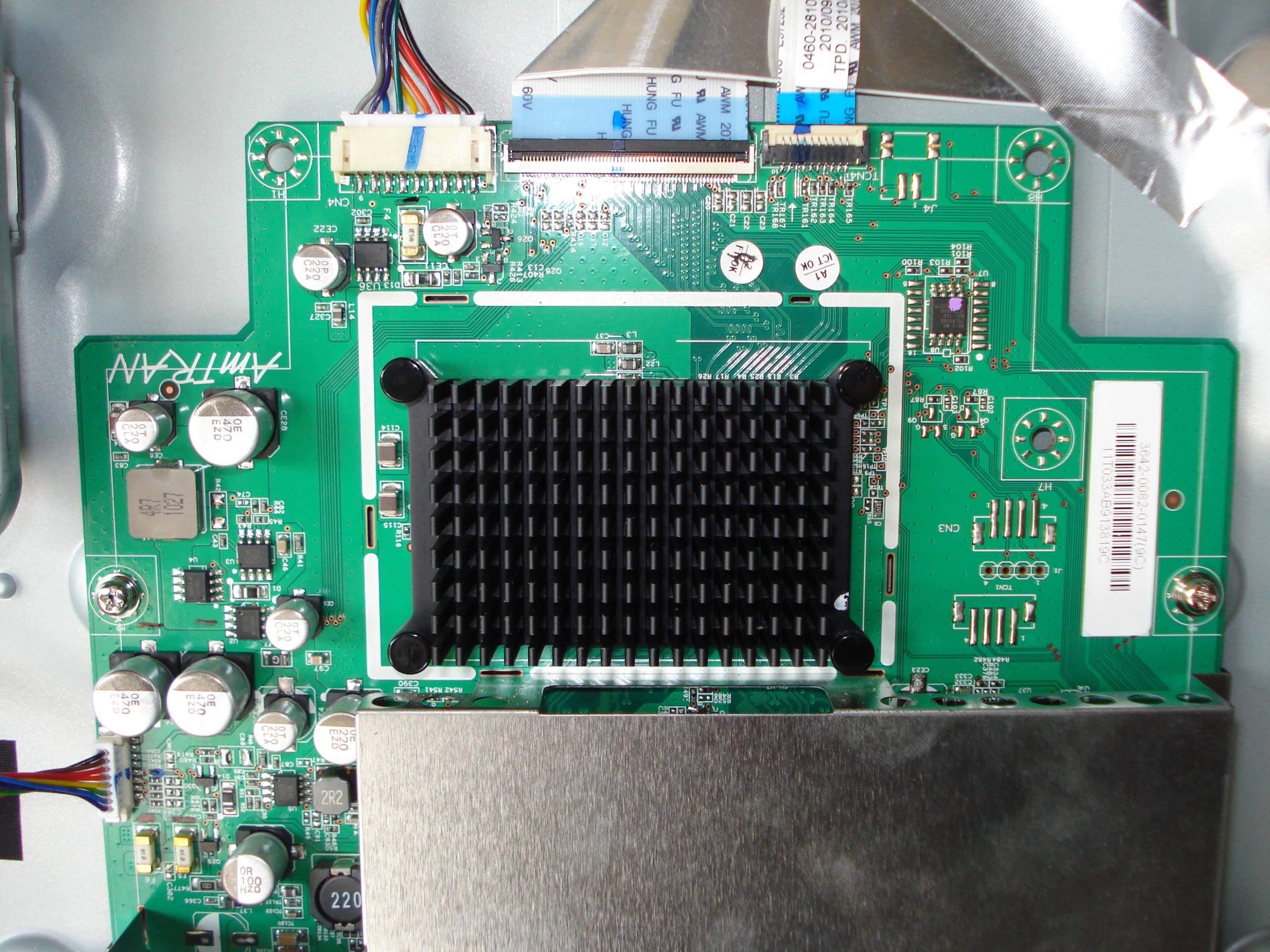

                    bud, can you tell me which cable or cables to disconnect from the T-Con ? here are more pictures from my actual tv I'm working on. Thanks.
                      Not sure if the backlights will still come on if you remove the LVDS cable and the power cables.
