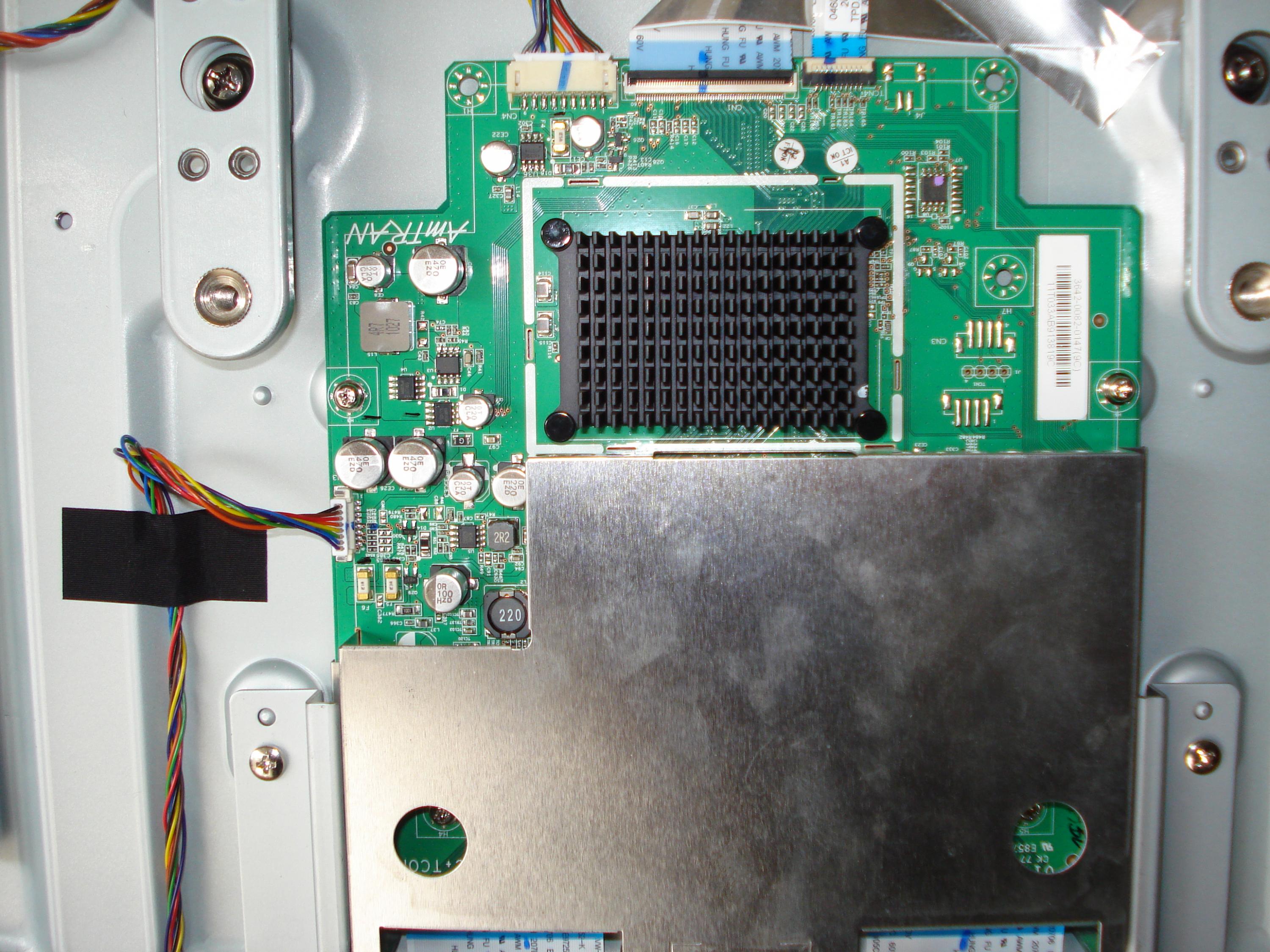

    Got the new/used T-Con board today, got it installed and everything works good...on High Definition Cable TV using HDMI input. I'm So happy to get it going.

      Whew! I am glad you got it fixed, $55 for 42" 3D TV, not bad. I hope the EEPROM does not go out next!
      By the way, can I get good picture shot of the T-CON board, and do you mind if I post your pictures on my Photobucket so it may help other people also?

        I actually bought this tv not working for $150 paid $55 for T-CON = $205 total investment.still a great deal. Attached is a picture of the T-CON Board, I guess I could have removed the metal shielding to try and troubleshoot but It may have been a bad processor IC that I wouldn't have been able to replace anyway, hard to tell what failed on this board. one guy posted he did a re-flow with a heat gun on a few TV's he fixed. I think I will hang on to the old board anyway. Bud yes please post in your photo bucket to help others. Thanks!

          OK, will do, thanks.
