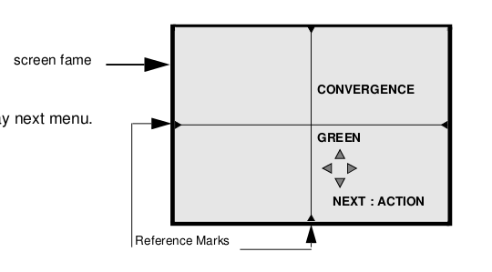

    Today I was gifted a Panasonic PT-47WX42 Projection TV.
    It is a 1080i CRT based unit.
    It was given to me with the notion that "we got it free from an estate, it doesn't work". However, I powered it on... but the convergance was really dicked up to say the least.
    Step 1 of the convergance adjustment is to line up lines produced by the green CRT with marks on the TV frame:
    (Engrish fail! )
    However, the vertical line never makes it to the mark no matter how far I try to shift it. Also, the right side of the horizontal line never makes it to the screen edge.
    It seems like the entire green tube is off balance...
    Any suggestions on how to fix that? Since it is HD I'd kinda like to fix it so I can use with with a HTPC (via component inputs).
