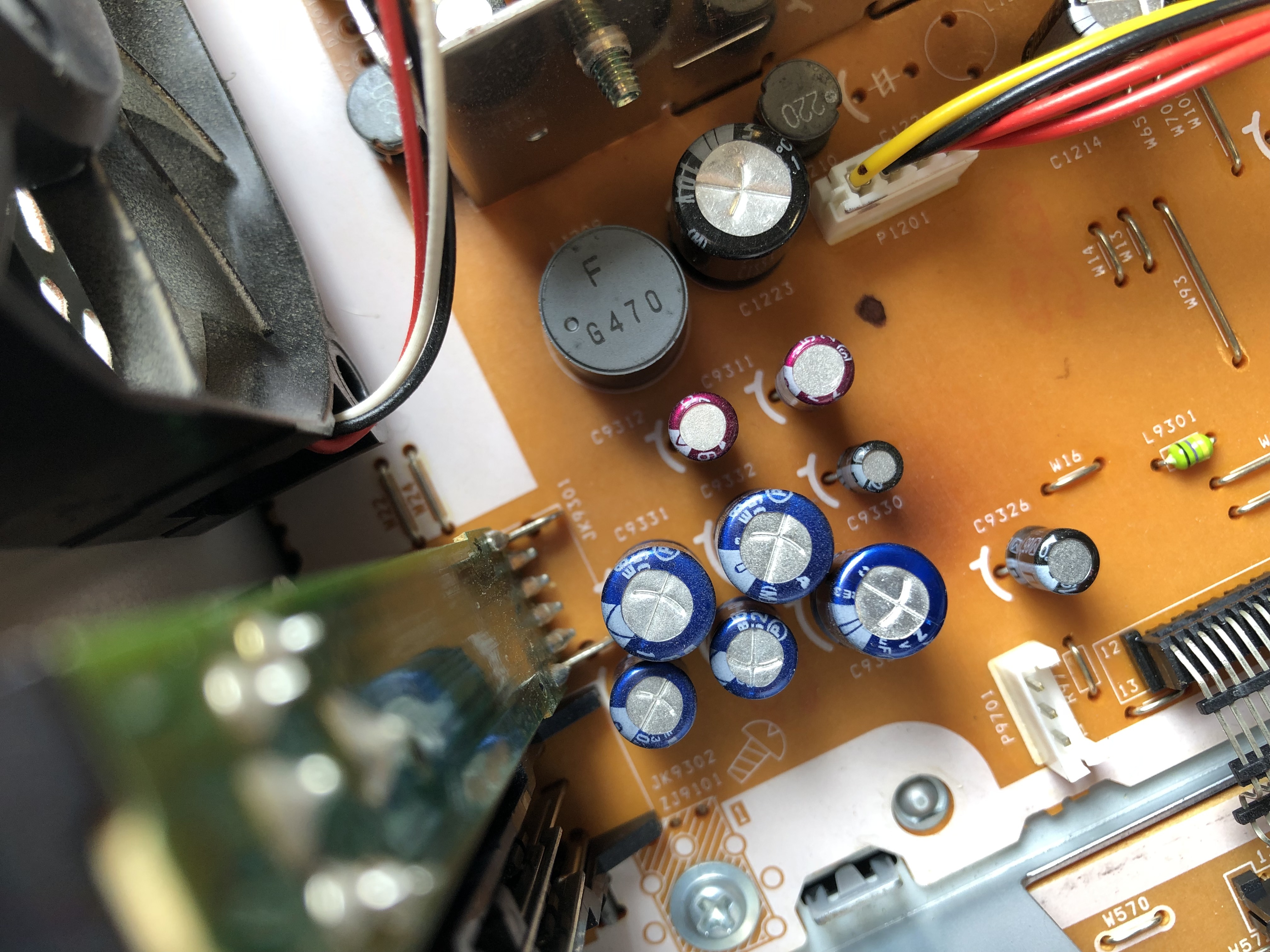

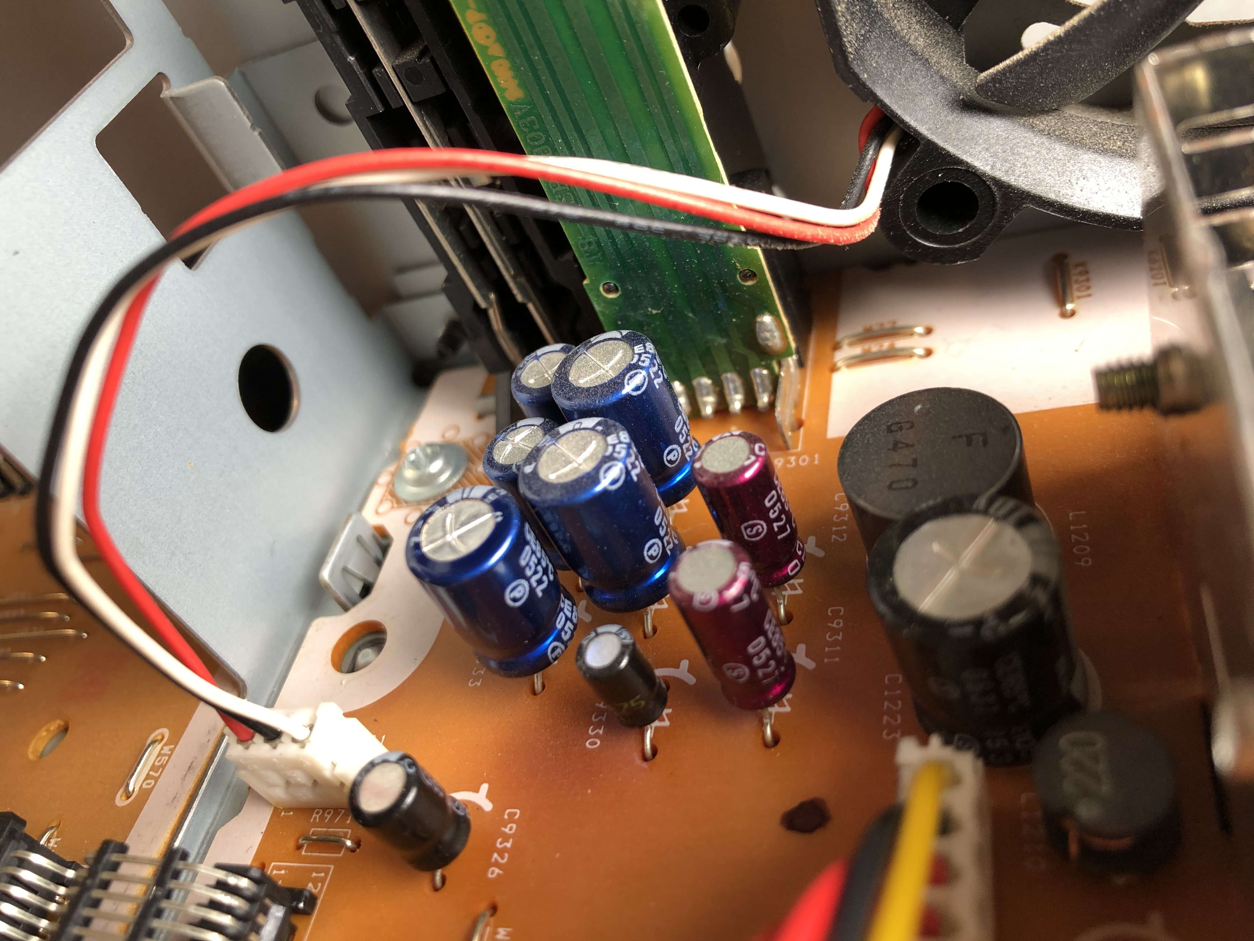

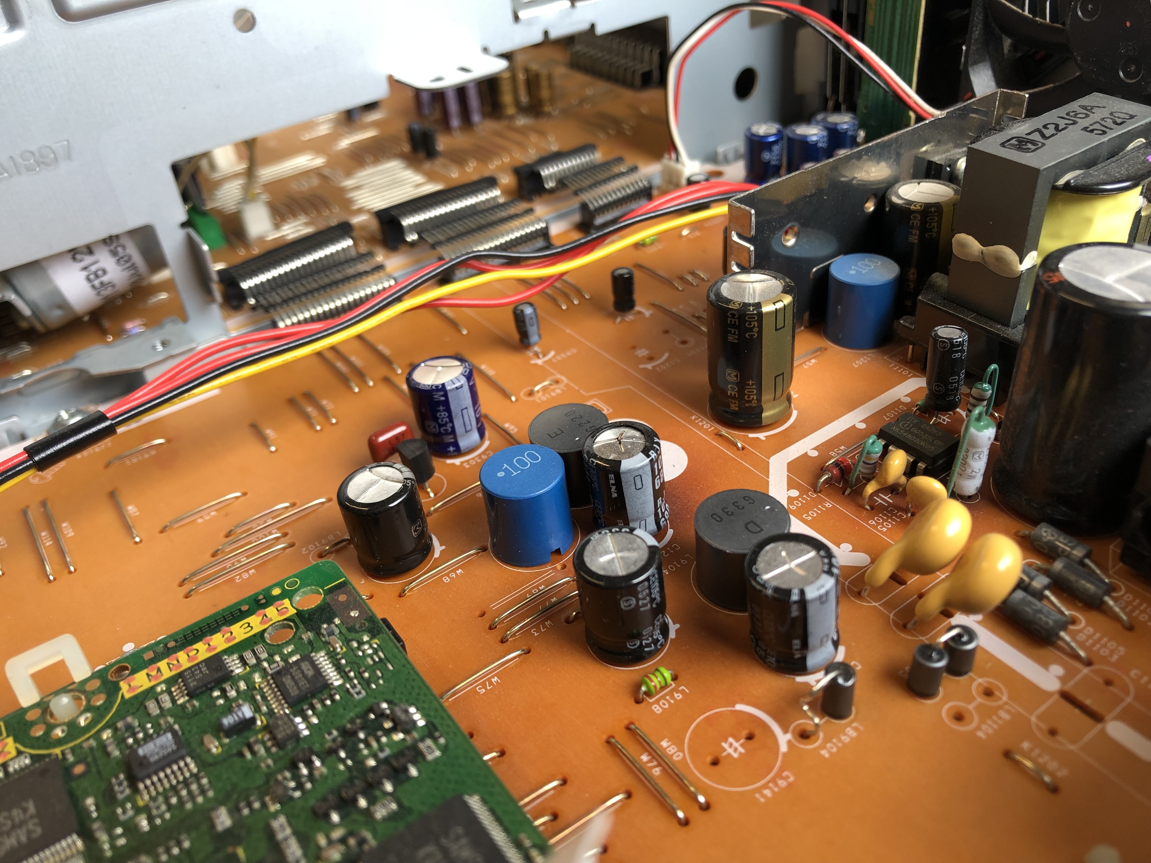

    I picked up a Panasonic DMR-ES30V (UK). When I first plugged in there was nothing, appeared completely dead, I then turned it on and off a couple of times at the mains supply and it came on. It accepts a cassette but then spits it out straight away, the DVD drive functions sometimes but then the unit turns off with nothing on the display. I took the back off and noticed the fan does not spin. The display for the DVD side does seem a little dim when it is working.
    I have looked on google and people say it is most likely a capacitor/s.
    Just looking for some advice on which capacitors might need replacing. I am new to this so please excuse my ignorance
    Thanks.

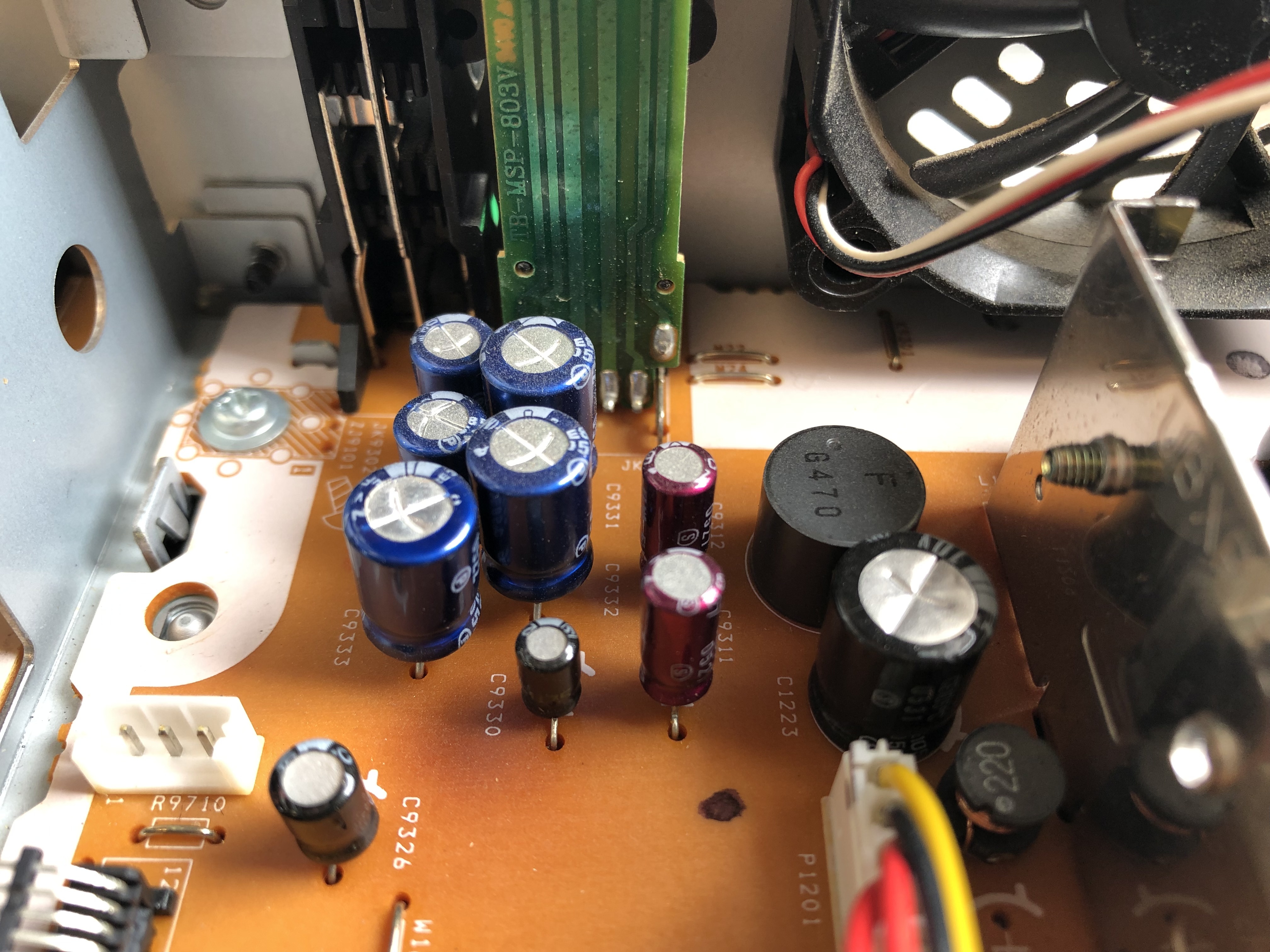

    Take a clearer picture of those blue caps, they look collapsed or swollen from the picture, but the picture may just be off focus

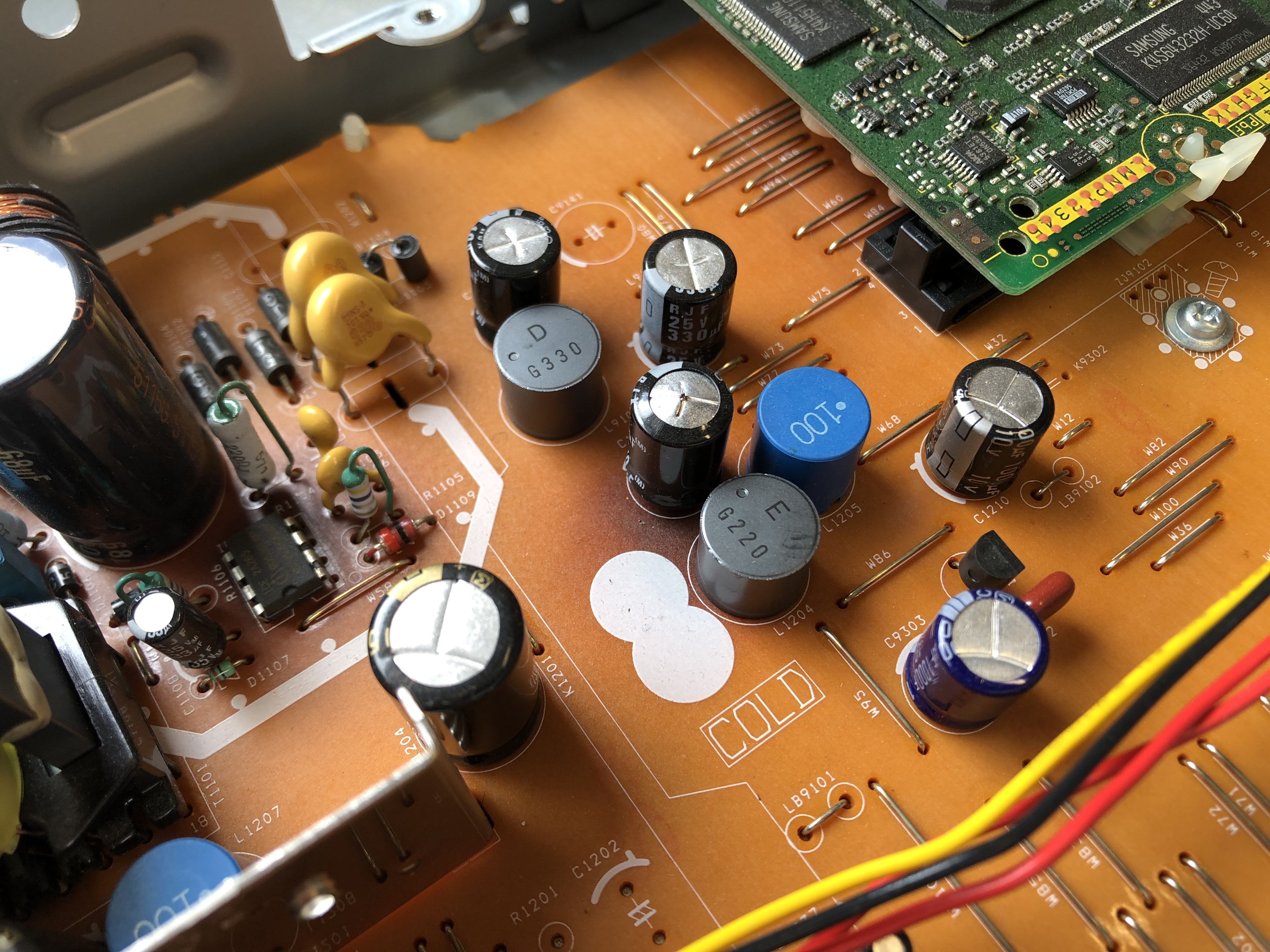

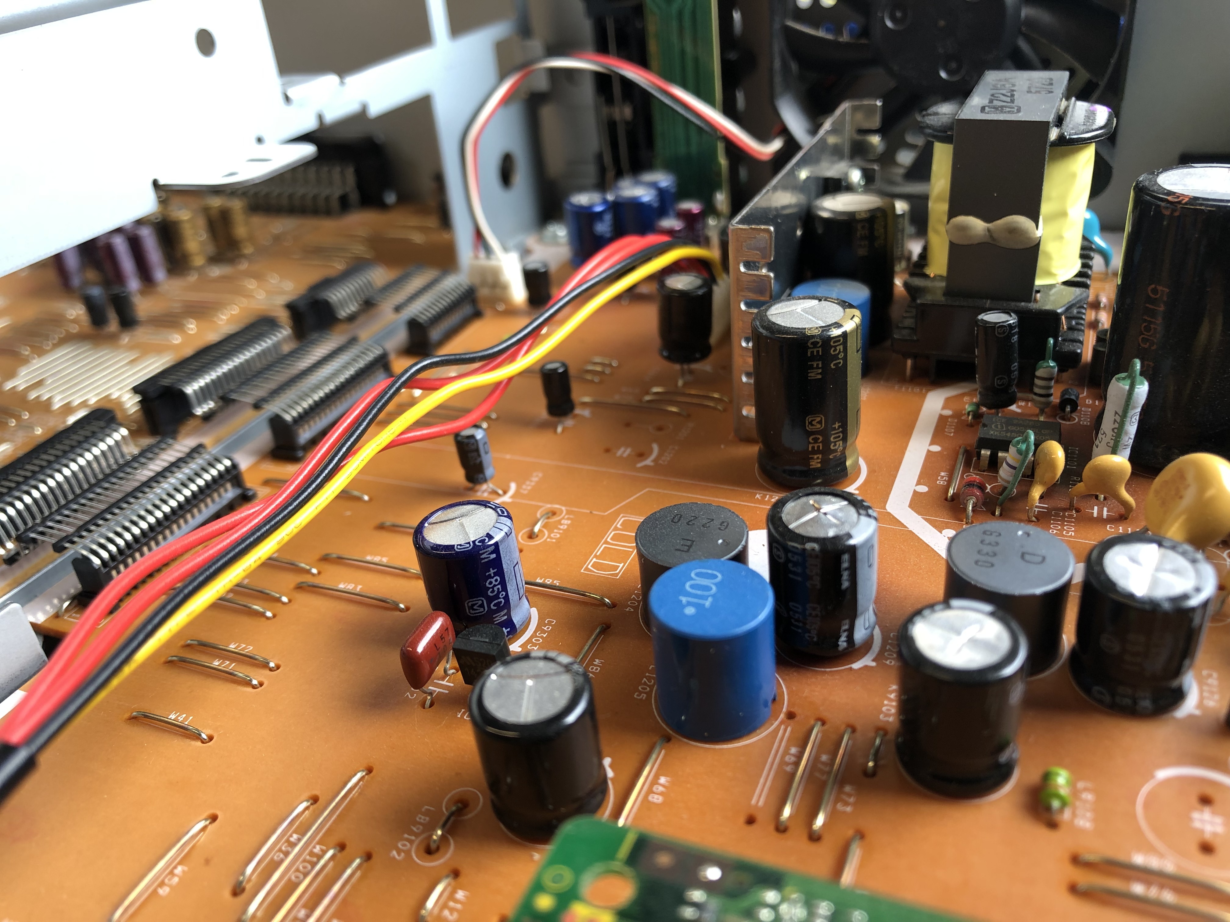

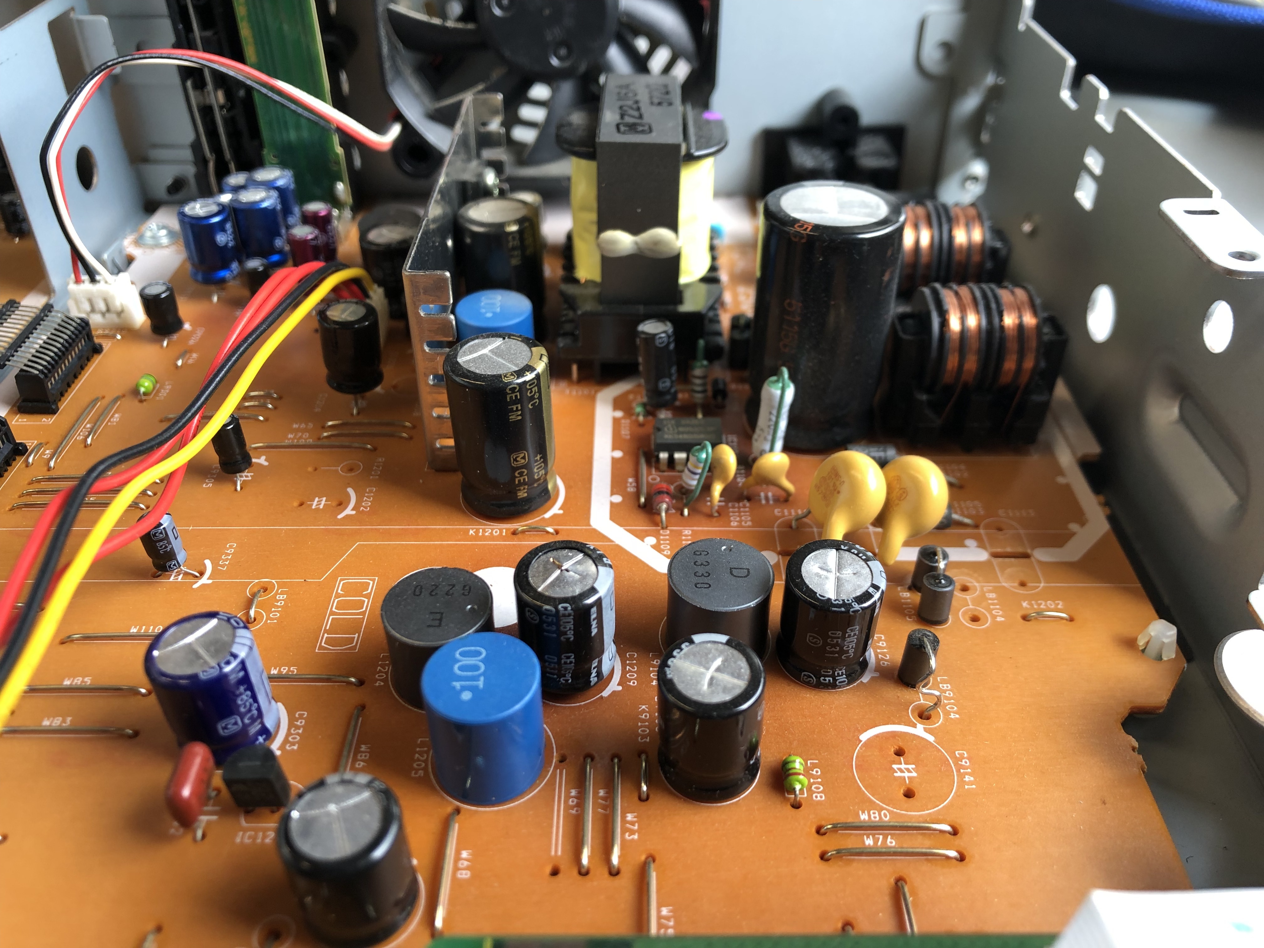

      Are these any good?

        These are the ones, but it’s better to check all the others using an ESR meter.

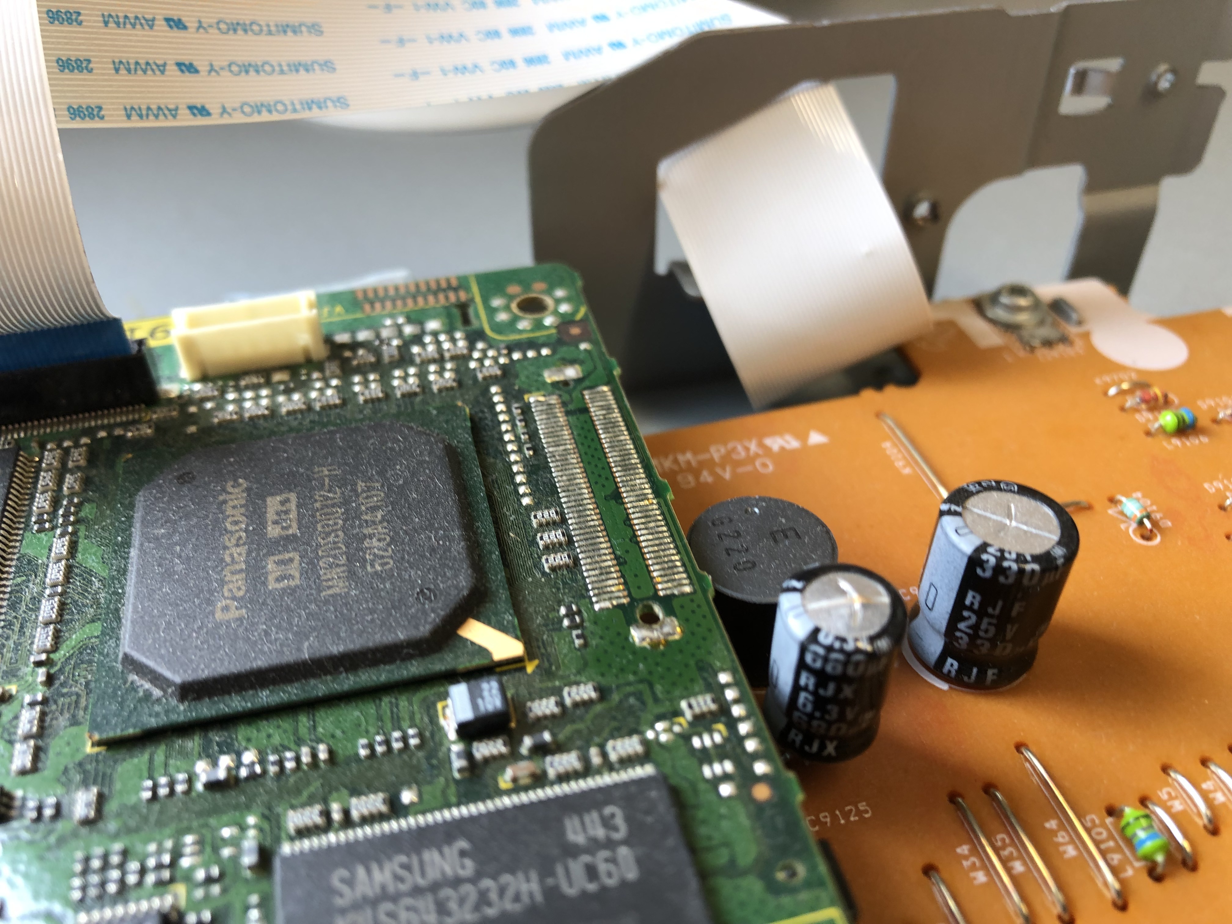

          Yup, several that are rounded up as lotas pointed out. Any that are rounded need replacing and then any that are imploded also. But as lotas said best to check with esr meter. Probably fixable

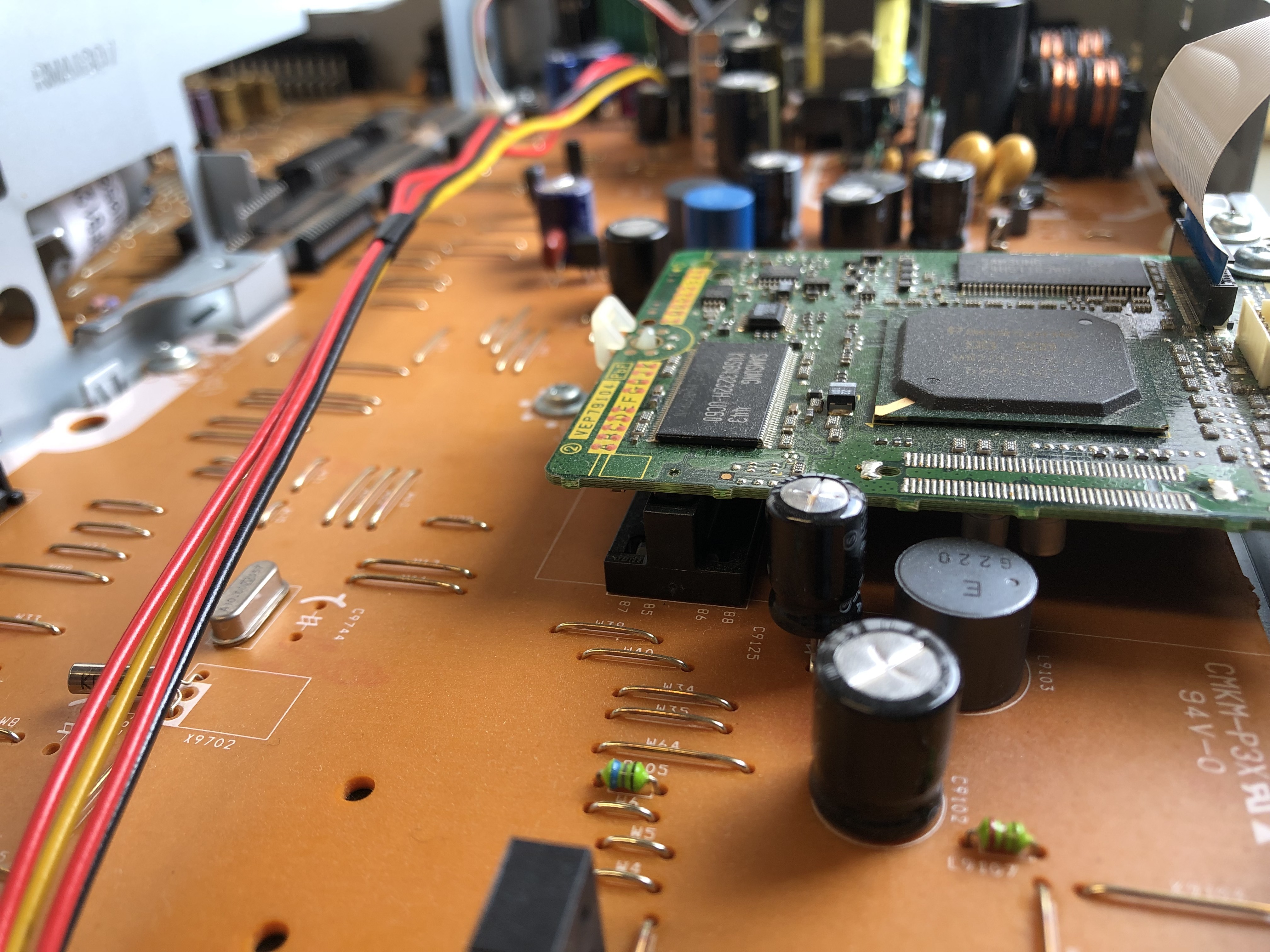

            This one also looks imploded, at least from the pic

              Thank you. How can I make sure there is no voltage left on the board before I start removing it? Am I correct in thinking you can get an electric shock when working on PSU's?

                Generally you can take a resistor and put them onto each leg of the capacitor. I don't know which rating, maybe a 10k resistor, Google can help, and it will slowly drain it. Or just wait several hours to a day and check with your multimeter for any voltage left. If you can't check with multimeter because the connector on bottom side, you can just wait a day or 2 should be discharged
