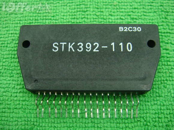

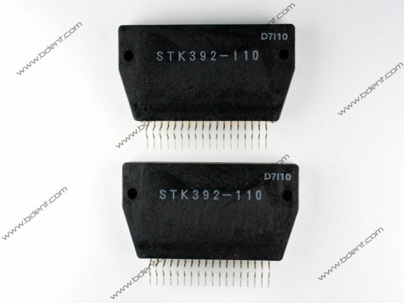

                After looking around online, I see people mentioning failed jobs due to fake parts.
                Here's the link I bought from:
                http://www.ebay.com/itm/270750562673...84.m1439.l2649
                Whose pic matches what I bought:
                The ones that came out looked more like this IIRC:
                Fakes?
                I'm suspecting I got screwed... if they are indeed fakes, then its a good thing I have yet to give feedback.
                  Fake IC?
                  Real IC?
                  Fakes?
                  The 'real' ones seem to have different 'K's and different '-' than the 'fake' one.
                  The only way we might be able to tell is the back, the heatsink pad. Copycat parts sometimes look ok, but (just like the fake caps) there is almost always one little detail they missed! (Ok, maybe two, counting the incorrect font!)

                    Re: Panasonic PT-47WX42 Convergence Issues
                    Yeah, I think I got %^&*ed by fakes this time. I'll order some known legit ones and try again.
                    edit- Anybody know where I can get reliable parts from? Newark has NTE ones but they want $15 a pop plus shipping (I had a x% coupon from them, but I may have used it).
                    edit- found the 15% off code, buying them there.
