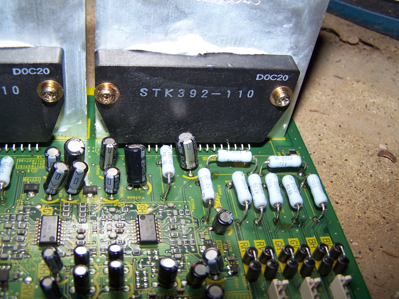

                      #70
                      Re: Panasonic PT-47WX42 Convergence Issues

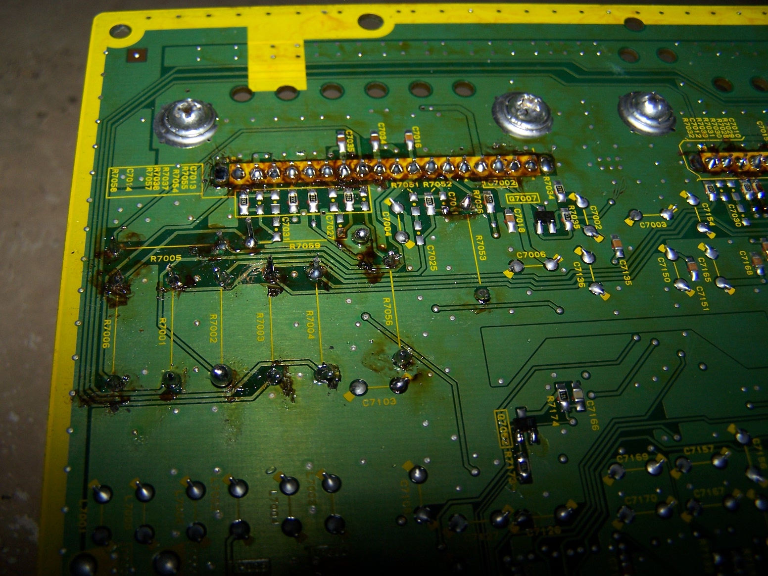

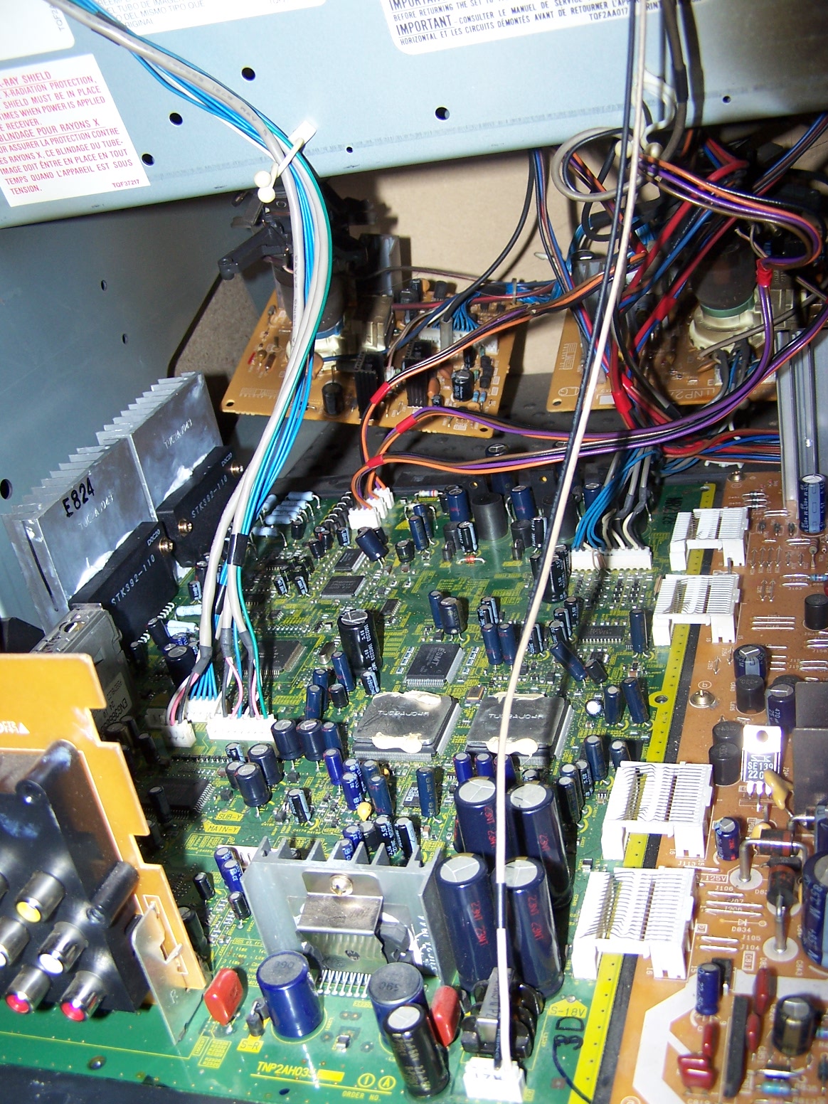

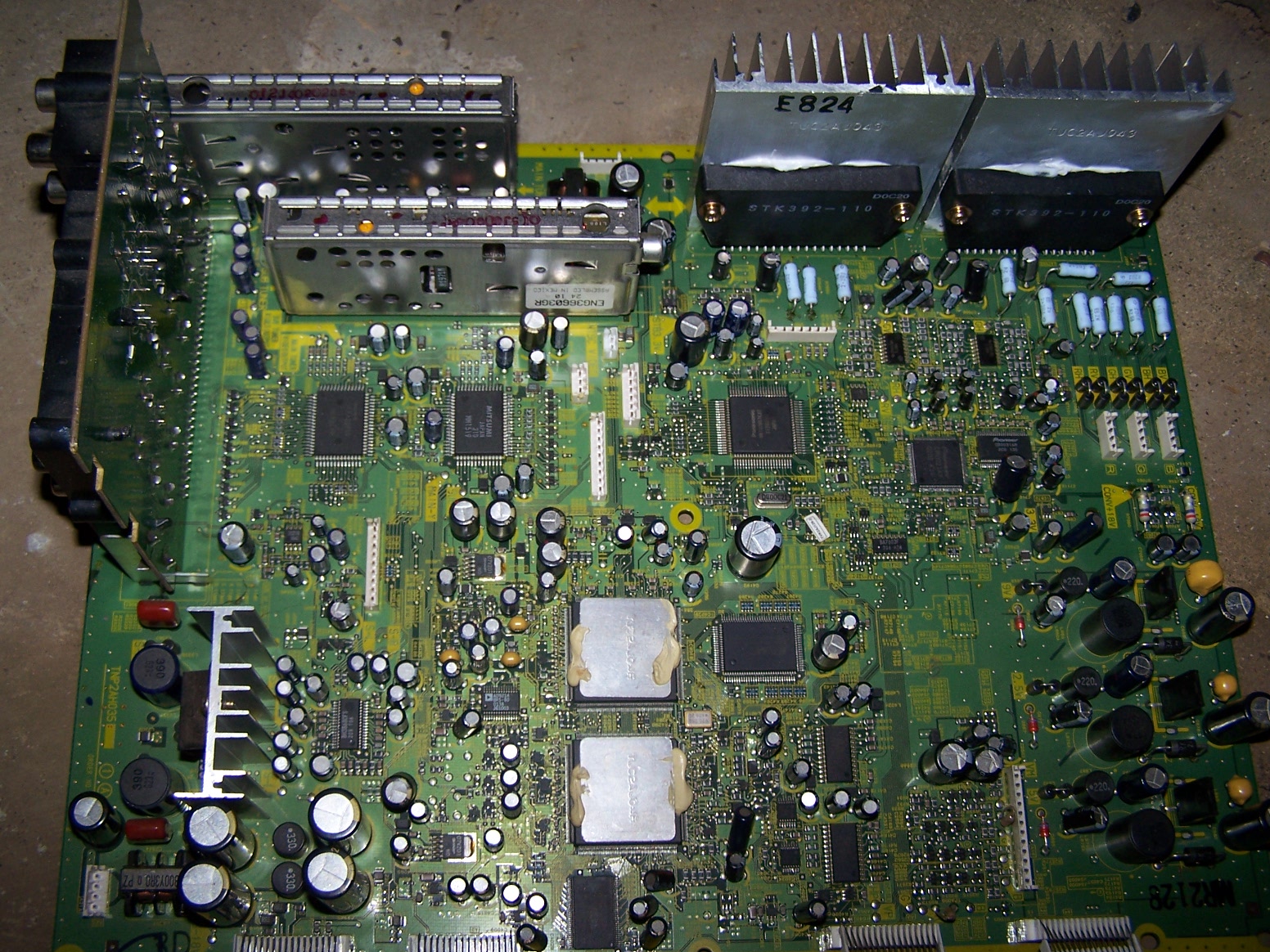

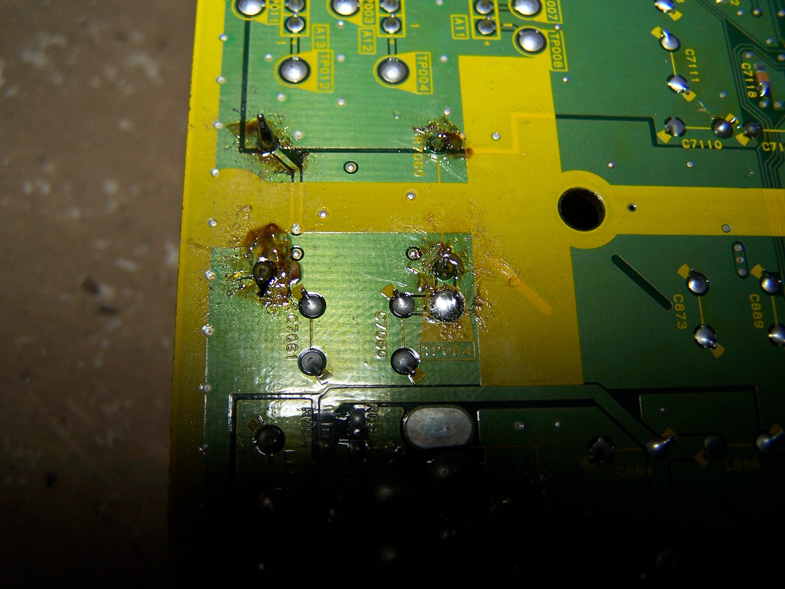

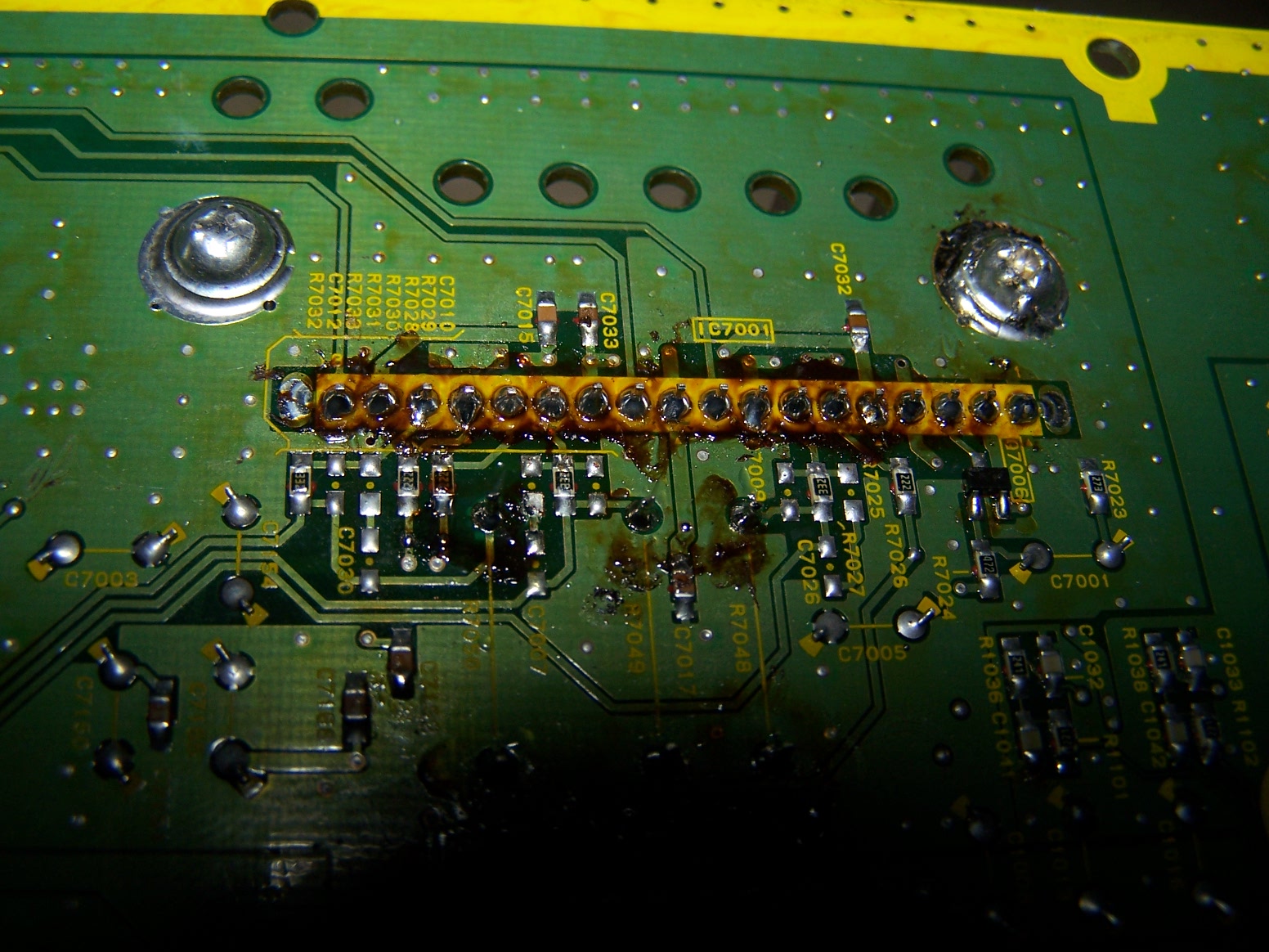

                      Youtube link was a fail... I thought they did away with the 10min rule... f**kers.
                      In the mean time, I took a few pics. They're attached for now, I'll edit in any commentary I see necessary.
                      sigpic
                      (Insert witty quote here)
                        #71
                        Minor critique: Your soldering here could do with improvement. You want it look like a small volcano not a bubble on your lead. This is just for long term reliability. Do not heat and melt the solder onto the iron then put it on the lead, it leads to cold joints like in the picture.
                        Flux cleaner would be a good idea, some of that stuff is conductive!

                          #72
                          Buddy, Mysoldering DOES look like volanoes... I do know how to solder!
                          See this video I made awhile back... yeah, I was a little heavy on the solder, but look how old that video is... I've had mauch more practice since and I know my soldering is better than that.
                          I'll get a better shot later to show what I mean.
                          And that flux is no clean... Most is from the desoldering braid, some from my solder. This isn't a glamor contest so I don't care (plus it helps if I ever need to desolder again).
                          sigpic

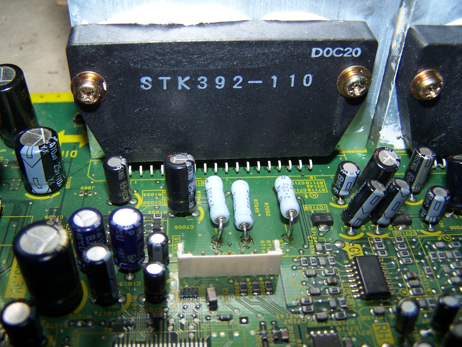

                            #73
                            What about R7002? It has a clear bulb. R7004 looks a little iffy, but I can't tell.
                            I know you can solder...! Your soldering technique looks fine. I prefer to heat a little further along the lead if I've got a more powerful iron as it leads to very easy and reliable joints, but your method is fine. Most of the joints are fine, it's just you should clean them up in case it's the problem, or for reliability anyway.
                            No problem about the flux then.

                              #74
                              That video was shot back when I only had 30W... I now have 60W.
                              I checked already, yeah, that joint is a bit bubbly, but I checked and it was well bonded to the pad.
                                There appears to be a current sensing circuit for STK each amp chip.
                                In the circuit on page 78, it shows that there is a +18 and -18 power input. The 0.27 ohm resistors are probably for the current sensing. Then, there is a 'CONV +18v' and a 'CONV -18v' bus. Those are current sensed. What are the CONV rail voltages at, compared to the main 18v rail input?

                                    #77
                                    The board and soldering look good to me.

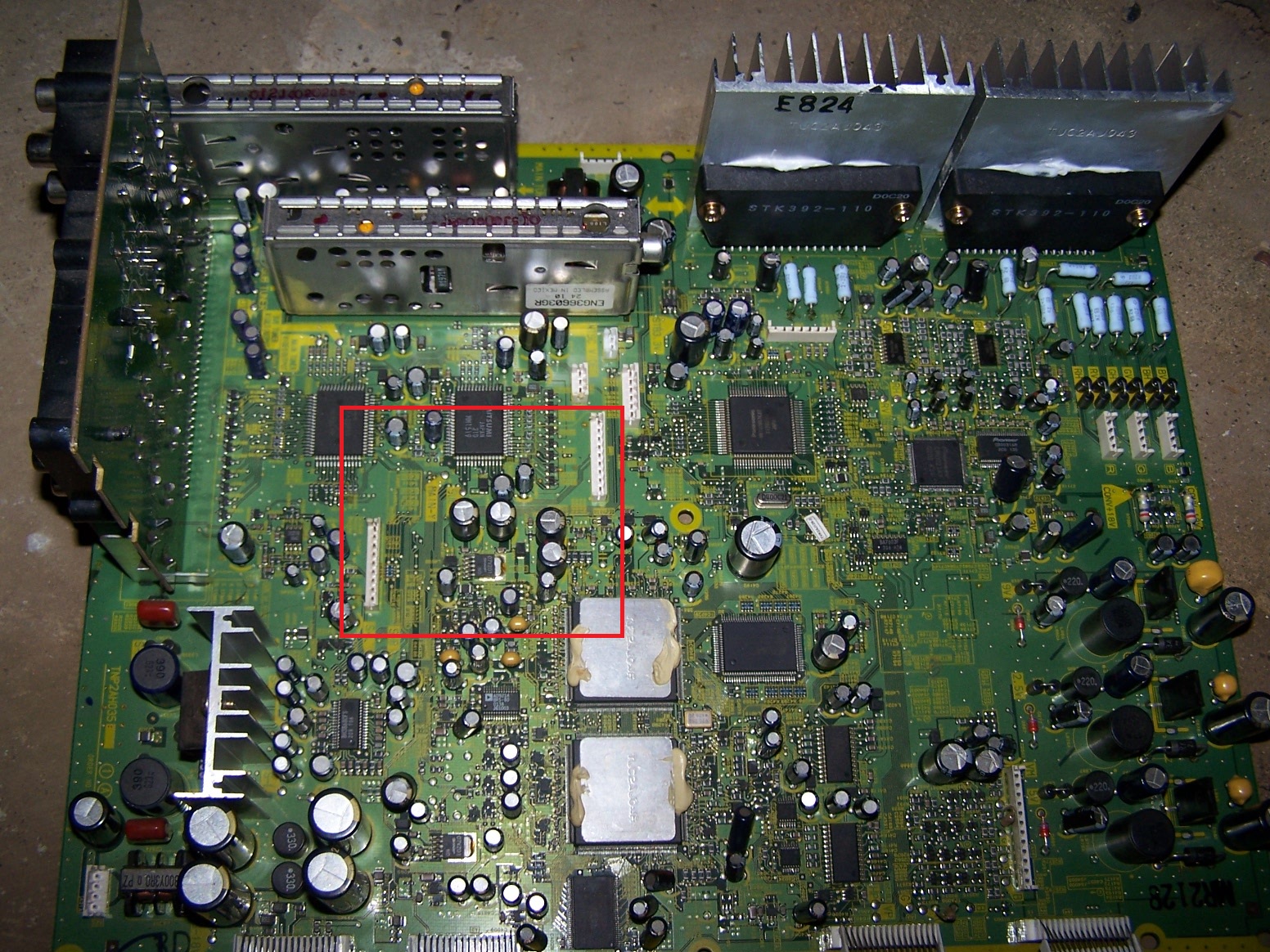

                                        Did you label the 2 connectors i put a square around? When i replaced the convergence chips on a 50" toshiba i forgot to label them. When i first turned on the tv it was bad blurry and you couldn't adjust it at all. I had the connectors that i put a square around in the wrong locations. It looks like the 2 connectors are about the same number of pins and within a reasonable distance they could get switched.
