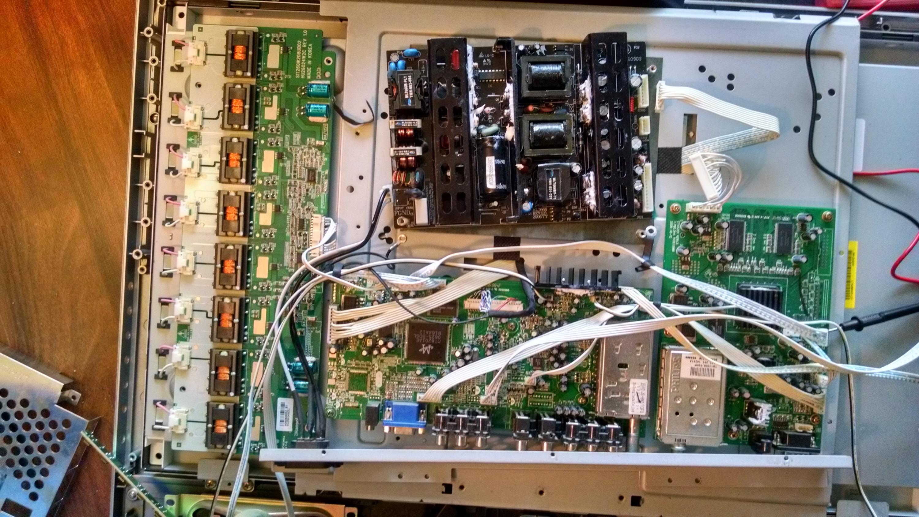

                It is best to upload good clear pictures of YOUR boards and the whole backside of the TV so we can see all the boards.

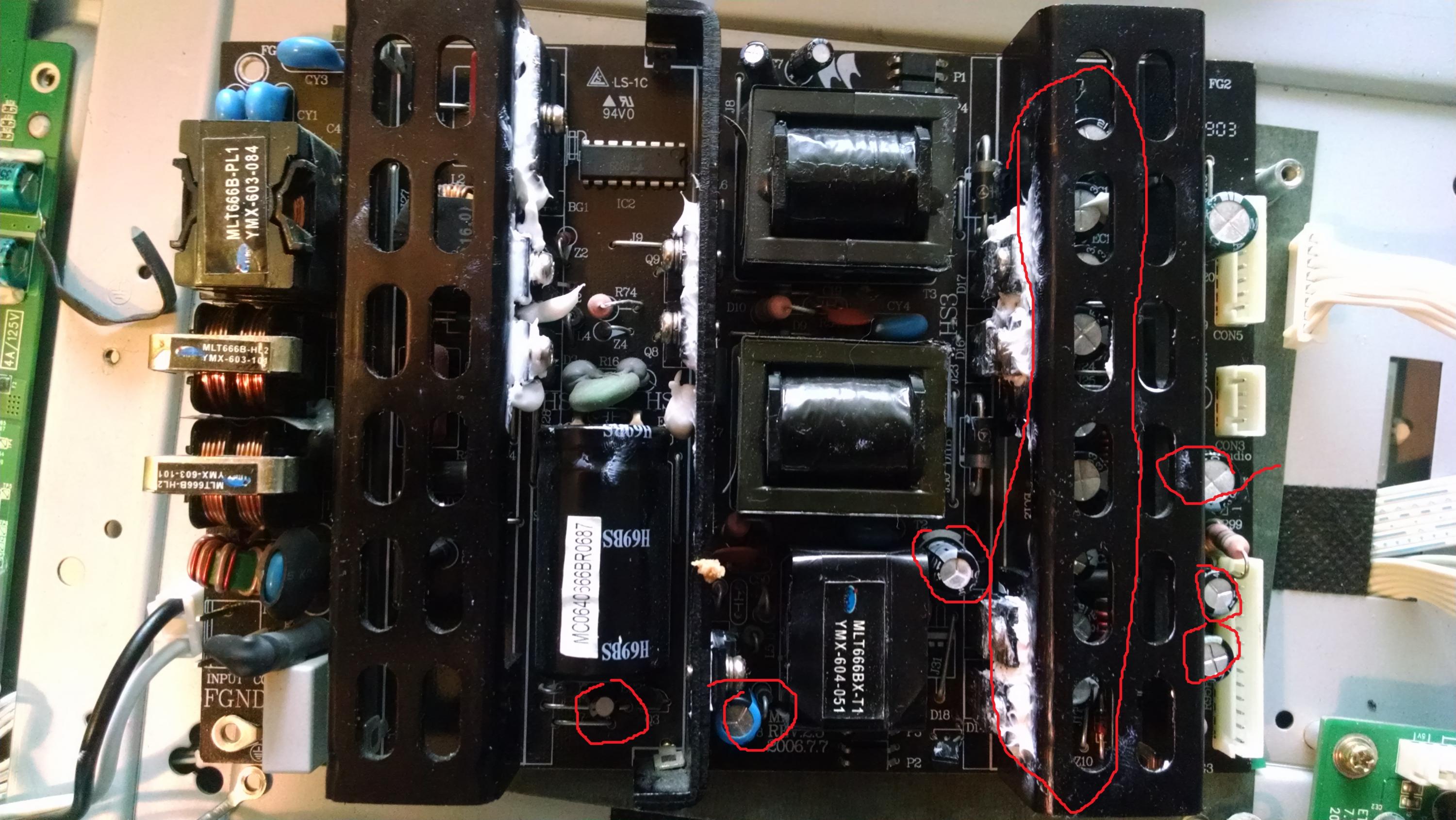

                  sure thing. different brand of TV (GFM) but identical power board as far as I can tell. I've attached pics

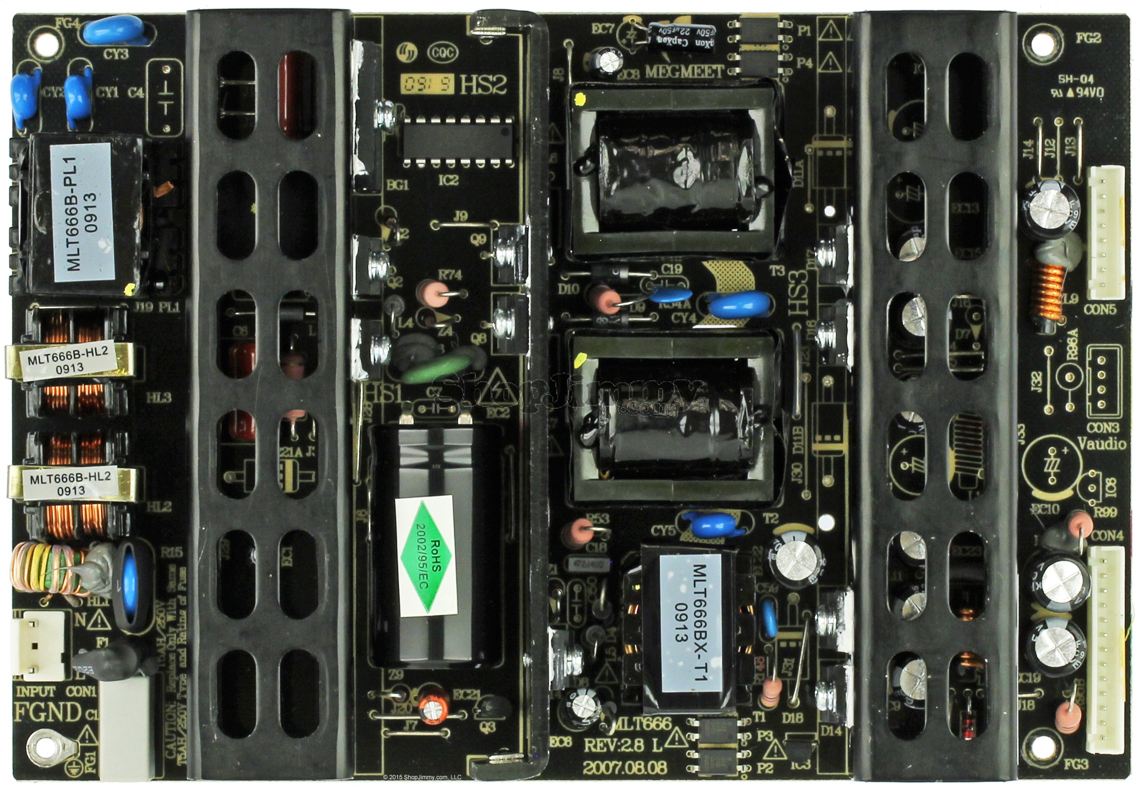

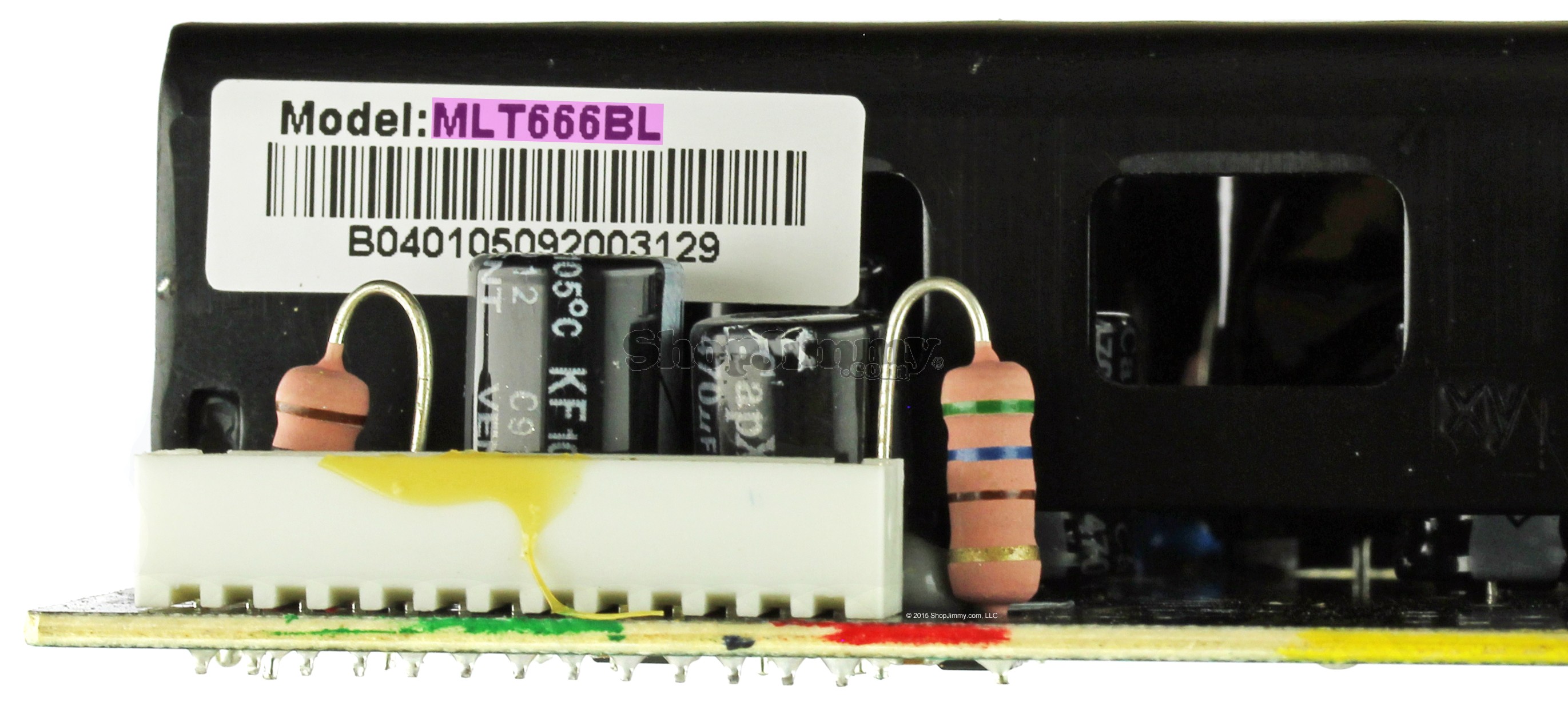

                      Which one of these is your power supply board? You need to look at the barcode sticker as shown in SJ site.
                      http://www.shopjimmy.com/catalogsear...ult/?q=MLT666B
                      Unless you want to learn about repairing, the 26" off brand is not really worth anything if it will need lots of parts to get it going.

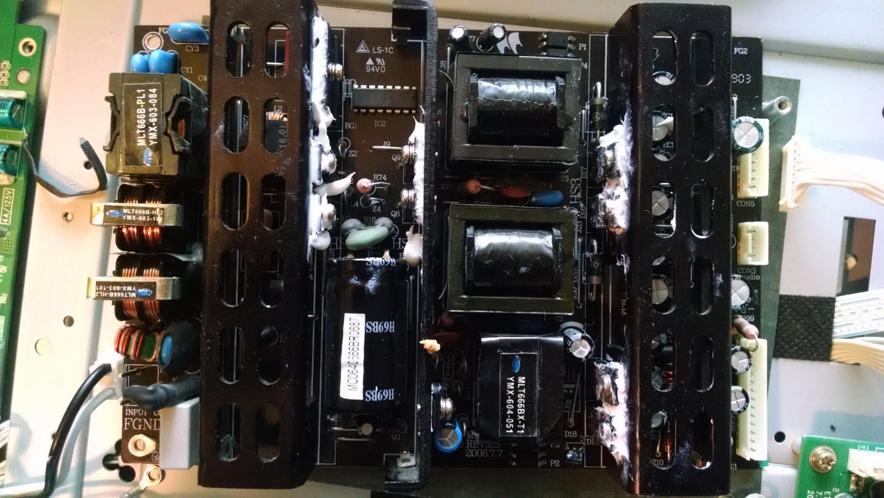

                        I have currently replaced the circled caps in red, including the ones under the heat sink (which i took off and put back on) with identical or higher spec (the blue one was the only one in which i didn't replace it with the exact same. same uf, but higher voltage, which research led to believe was OK) . I am not sure how to test if i have "5vsb" - but I do have a multimeter, so if you can describe how to test I will follow instruction. When i connect everything together, I get power to the led "on light" (red, standby light. when the tv used to work, it would turn on and the light would go green)
                        re: the board is a megmeet MLT666 rev. 2.5.
                        it shares the same code as below
                        http://www.shopjimmy.com/megmeet-mlt...pply-unit.htm#
                        but the pictured one has rev. 2.8.
                        I actually am interested in learning to repair, but if it is not even close to cost effective /extremely time consuming i can figure something else out. However, I am enjoying the learning experience, so i'm willing to sink another 20$ and/or 3-4 hours into it.

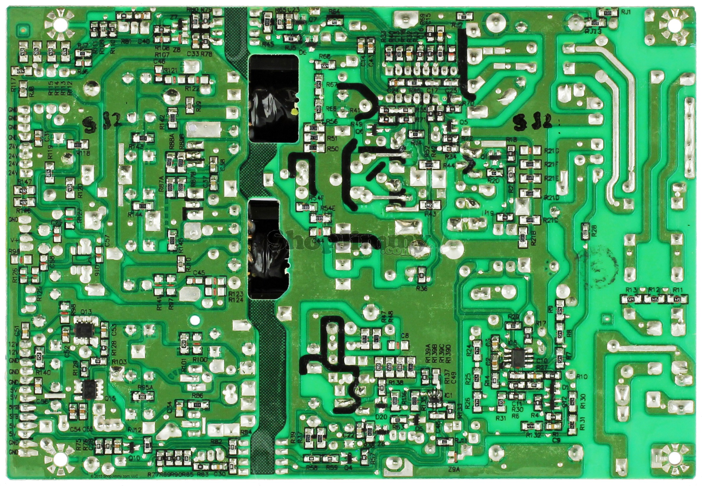

                          If you look at the bottom side of the connectors you will see the 5VSB pin, so check that against GND pin.
                          Pictures provided by shopjimmy.
