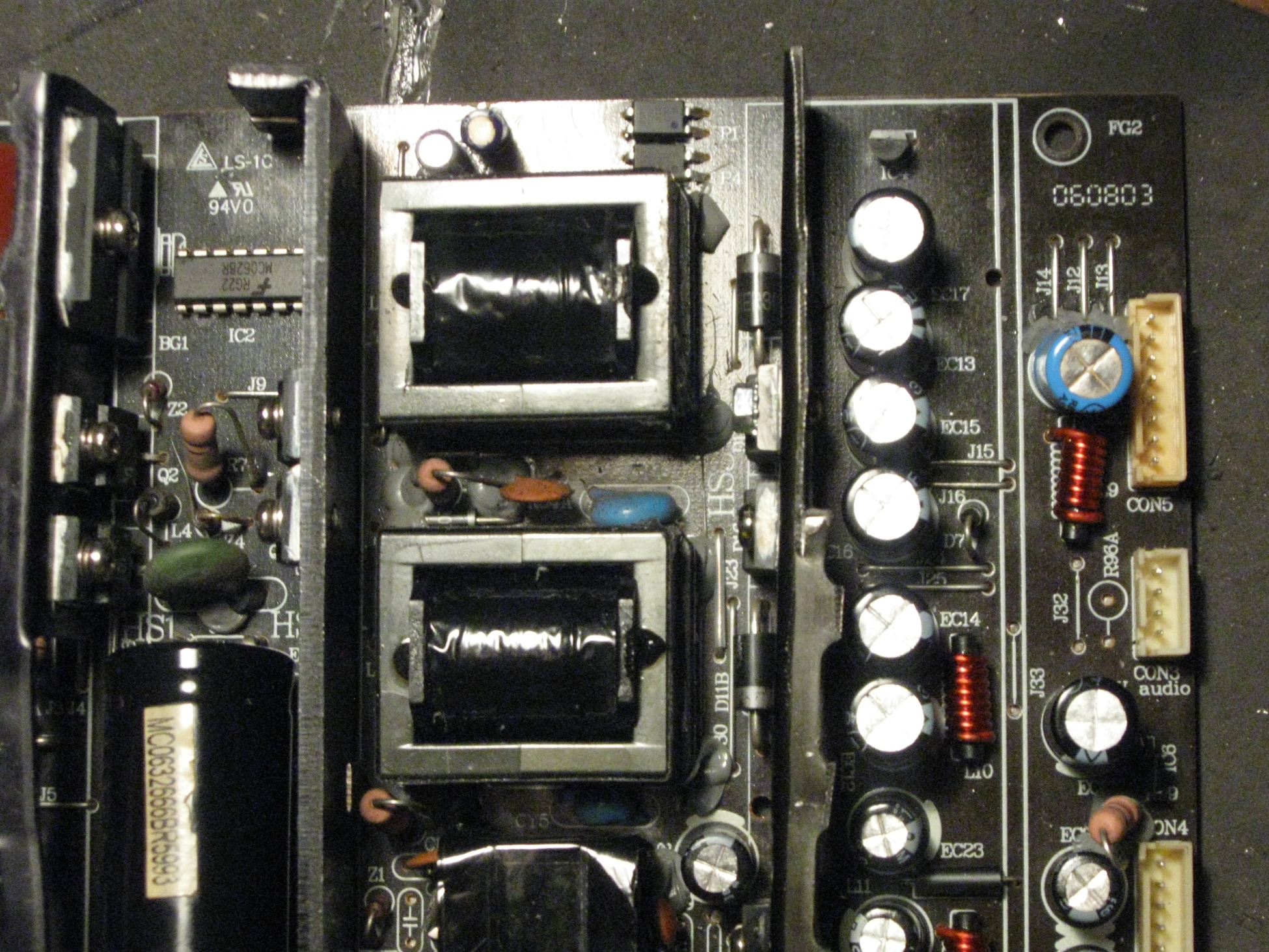

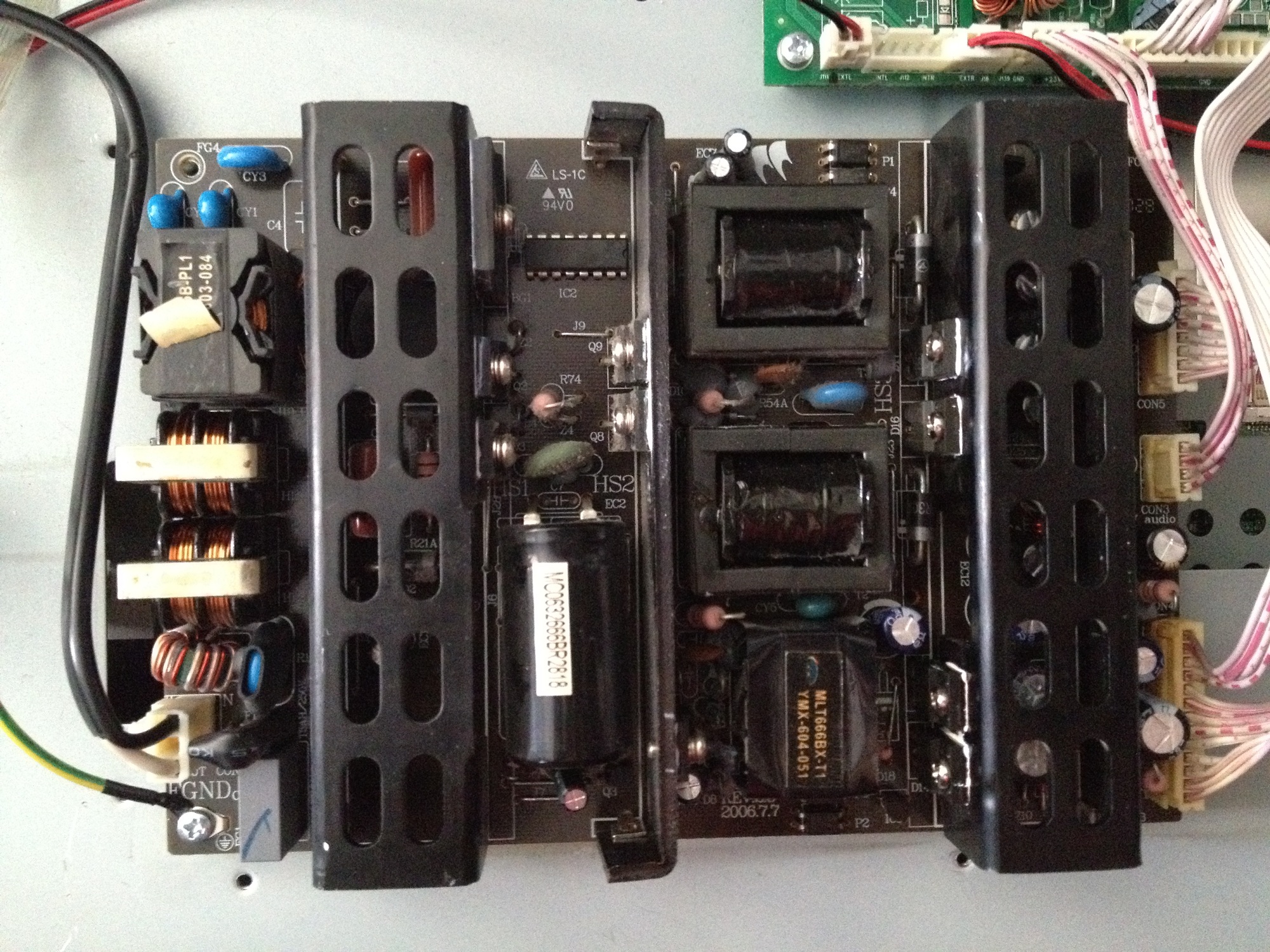

    I have a 26" Sabre LCD TV. Once plugged in, the TV does not turn on at all. No response to the power button. The guy who gave it to me said it was just a fuse but I checked the fuse on near the AC input and it seems good.
    Initial observations:

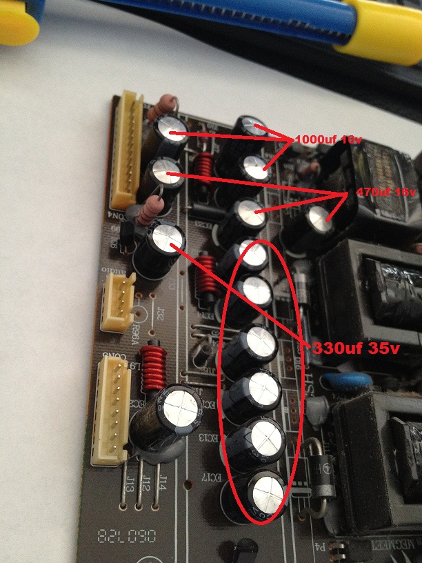

    Opened it up, I found many bulging capacitors on the secondary side of the PSU. And I just replaced every capacitor as shown in the photo.
    Once replaced I still have no change in the problem.
    Checking across the biggest capacitor I have a reading of 162.5V
    I'm checking voltages on components on the secondary side of the PSU but I measure almost all zero voltages.
    There is no 5V standby voltage or any voltages on the outputs.
    Looking for other fuses but dont seem to see any.
    So what should I check next?
    Re: No Standby voltage 26" Sabre LCT260BKA

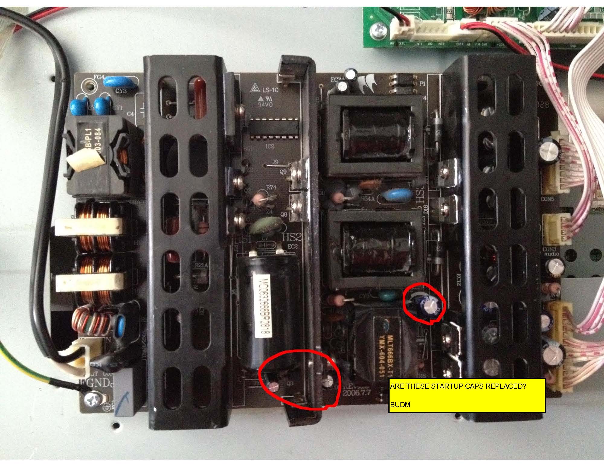

    Did you replace the start-up caps in the primary side for the standby 5V power supply?
      Oh your right! I just checked the smaller caps you circled on the right with my esr meter The smallest one gave me a reading of greater than 40 ohms and the other cap was open circuit.
      I thought the smaller caps usually rarely fail?
      I'm pretty sure this TV was very heavily used though, the plastic for the connectors are starting to chip off due to heat wear. (Like when trying to remove ccfl lamps and the plastic piece easily snaps off with just a touch.)
        Success! I replaced those two other start up caps you suggested and now the TV turns on fine!
        Just wondering does the voltage rating of the start up caps affect how long it takes the TV to turn on. For a minute I thought the TV wouldn't turn on but it just took awhile. Because I replaced the start up cap rated 100uf 35V with one that was rated 100uf 50V. The TV does take a couple of seconds for TV to come on after the red standby light turns green.

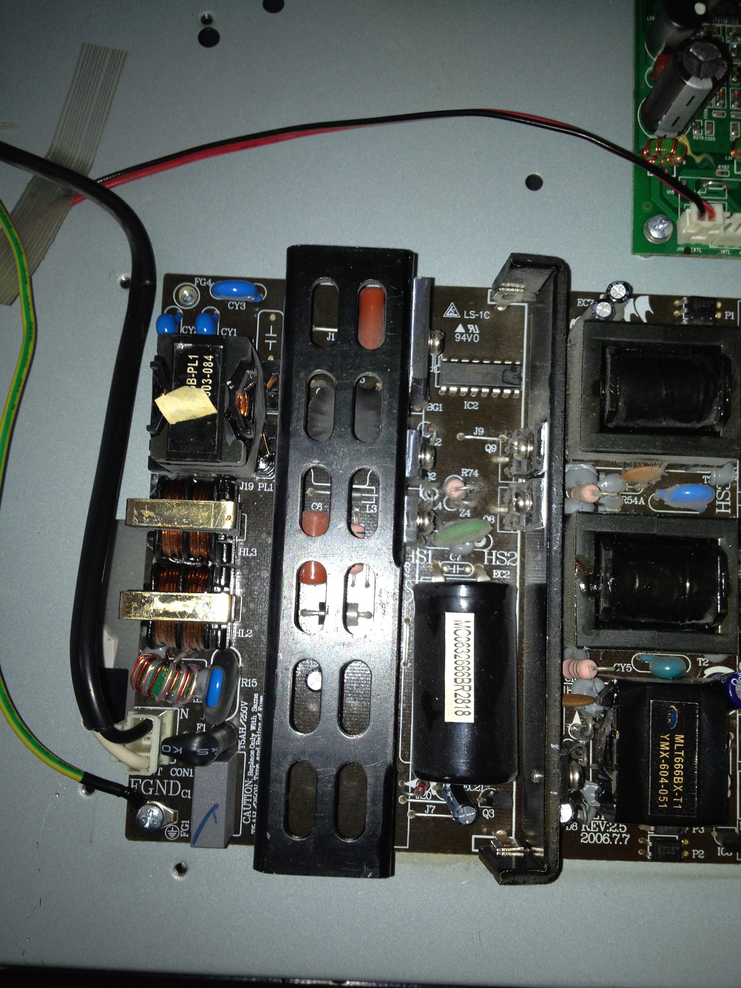

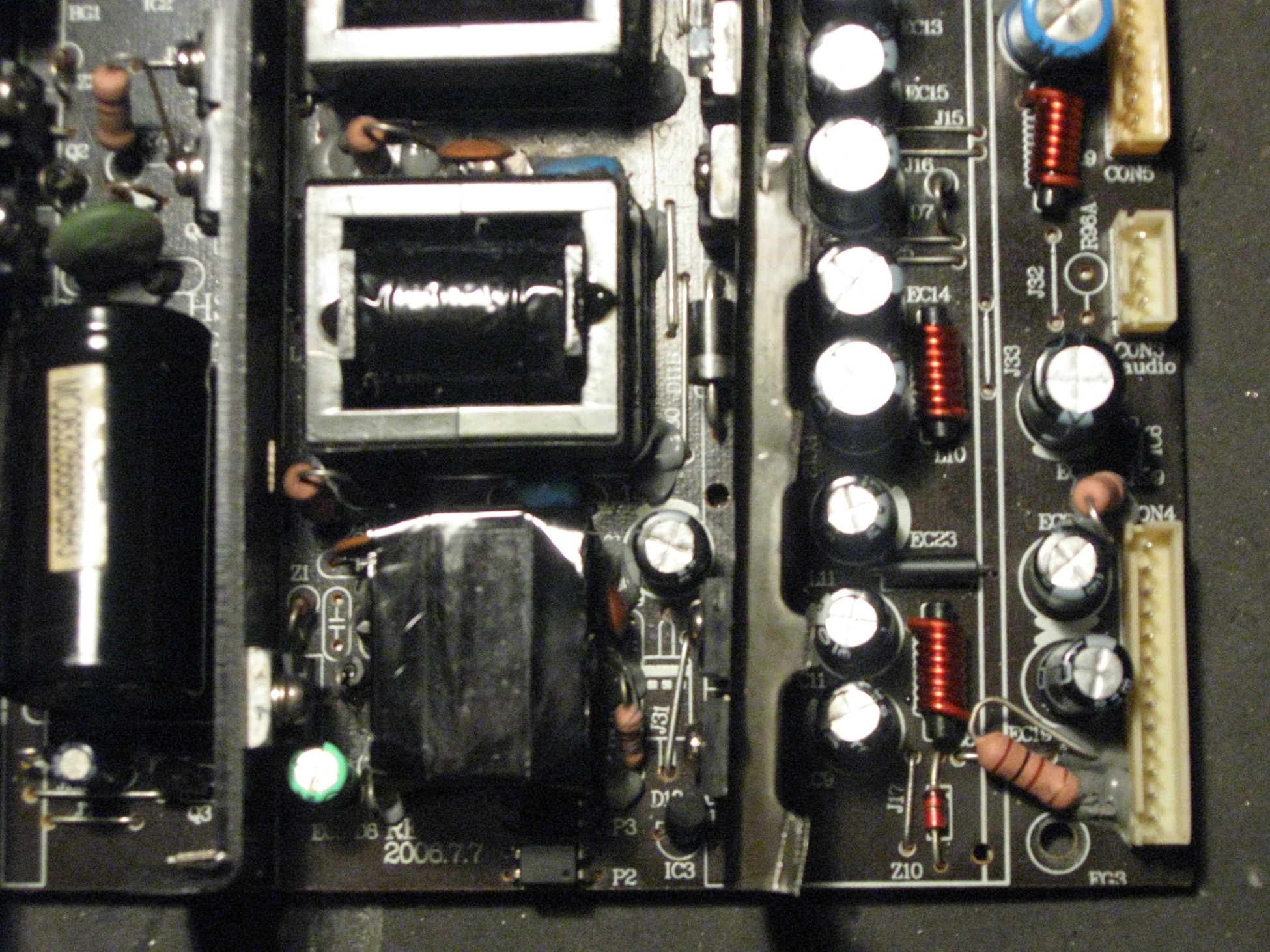

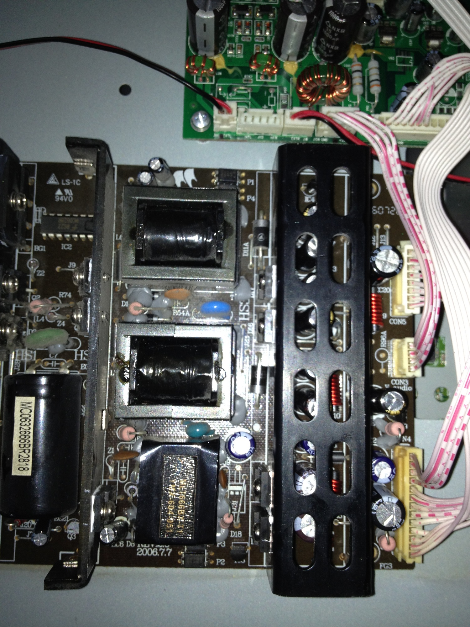

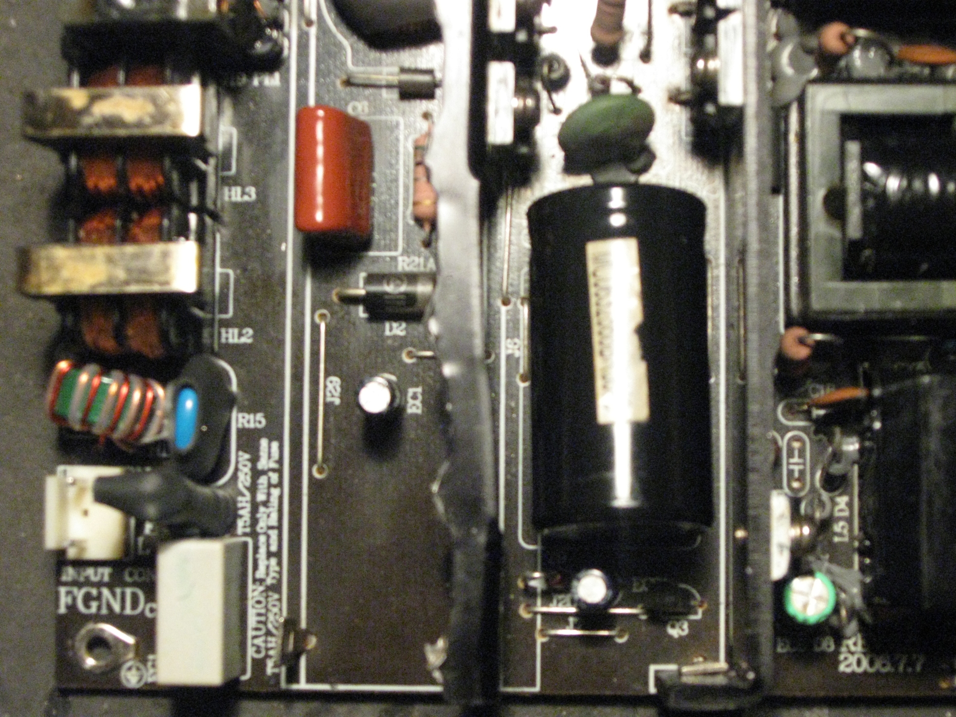

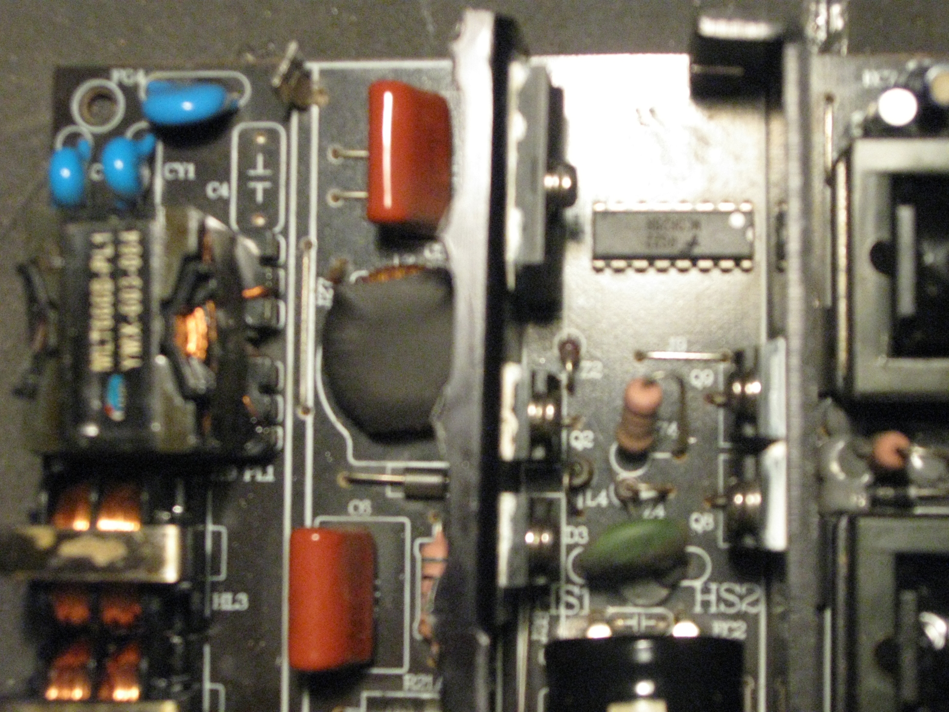

                                Here are some pics of the PS board.
                                ETA: FYI, I removed one side of both heat sink cages for easier access.
