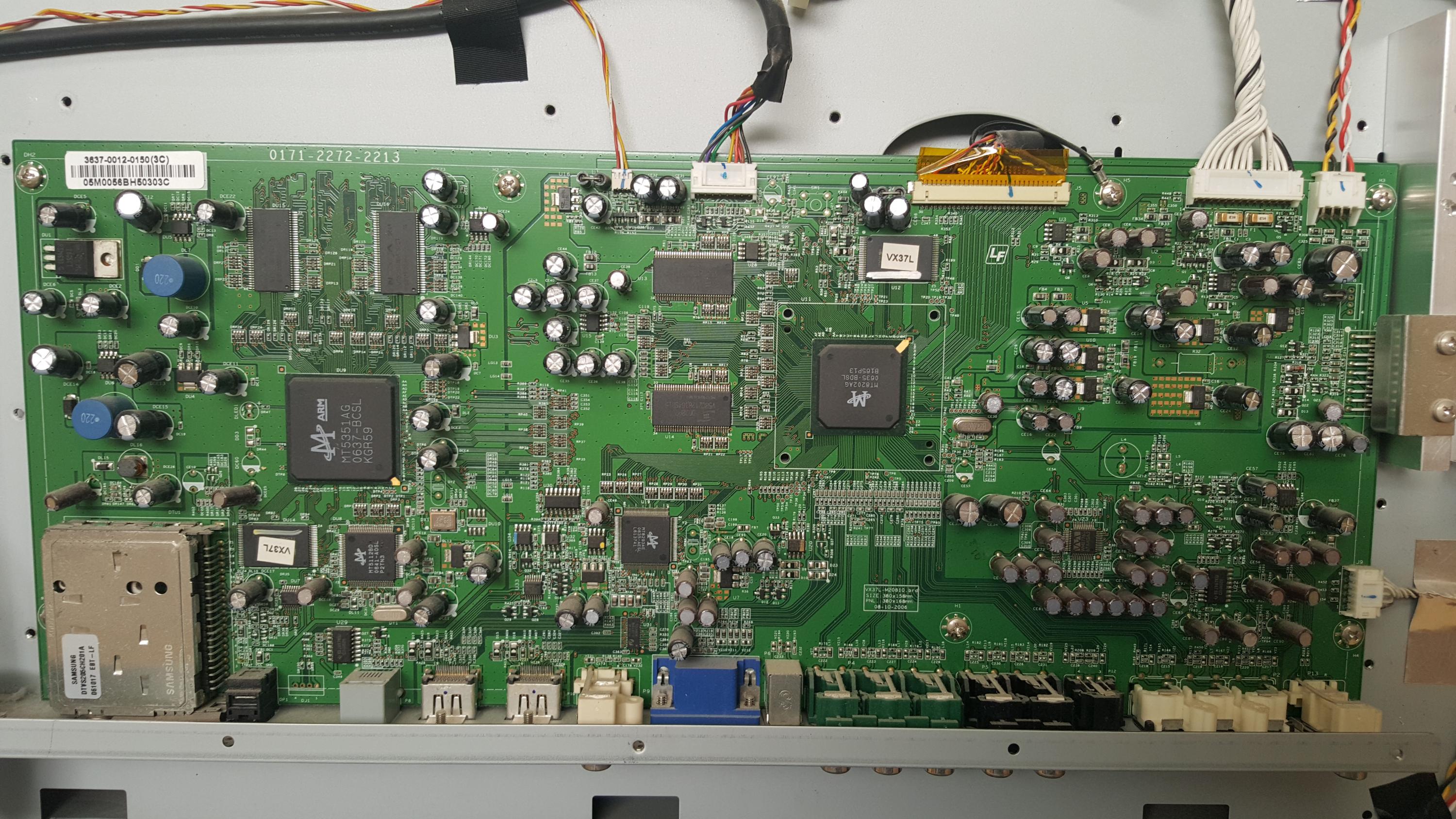

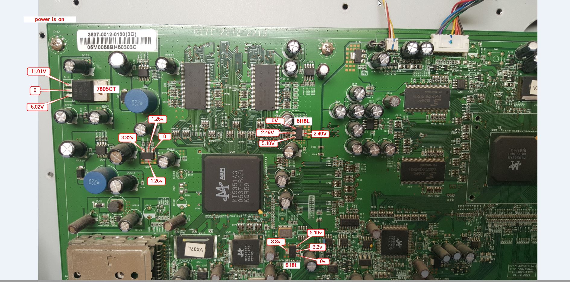

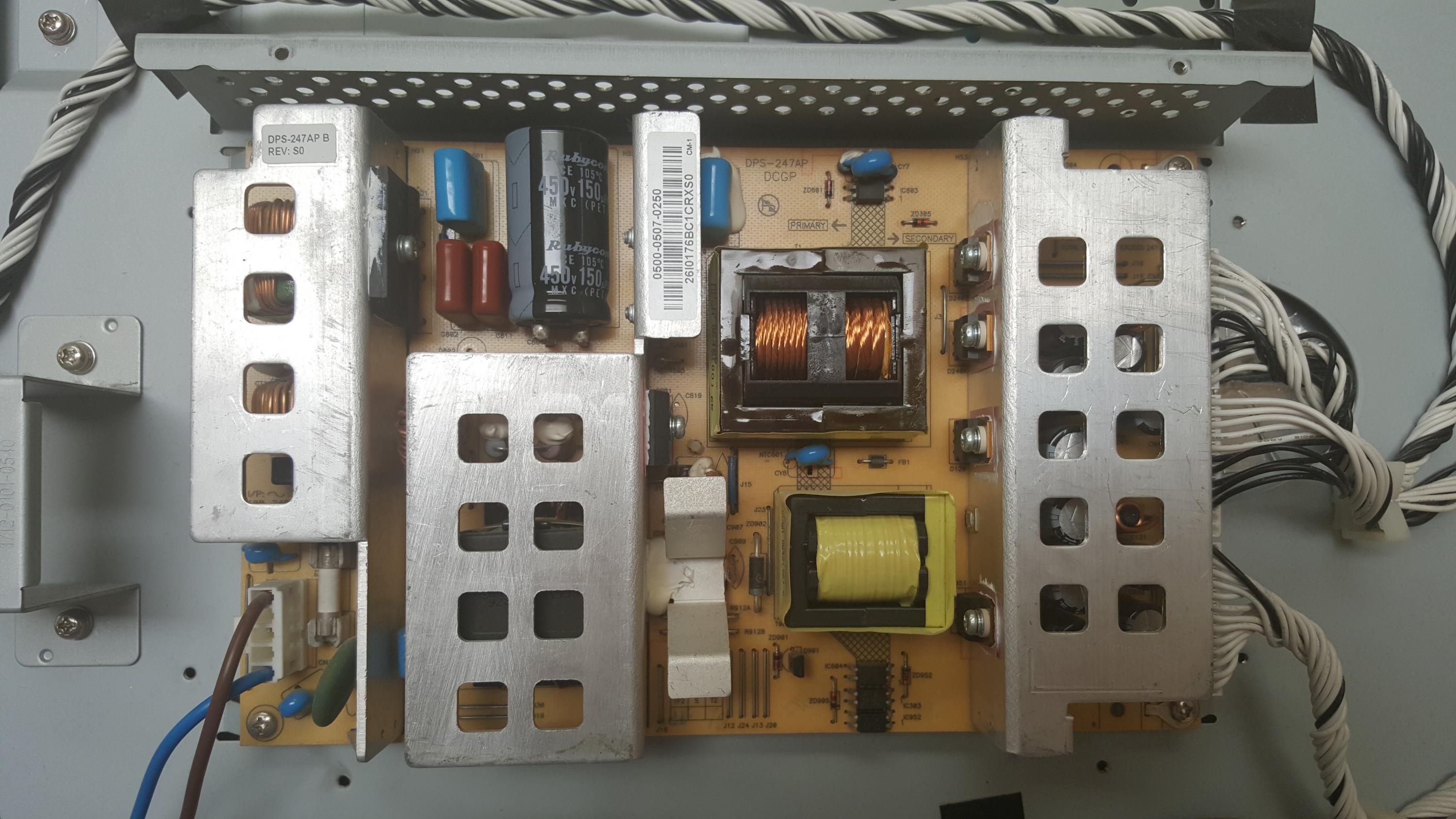

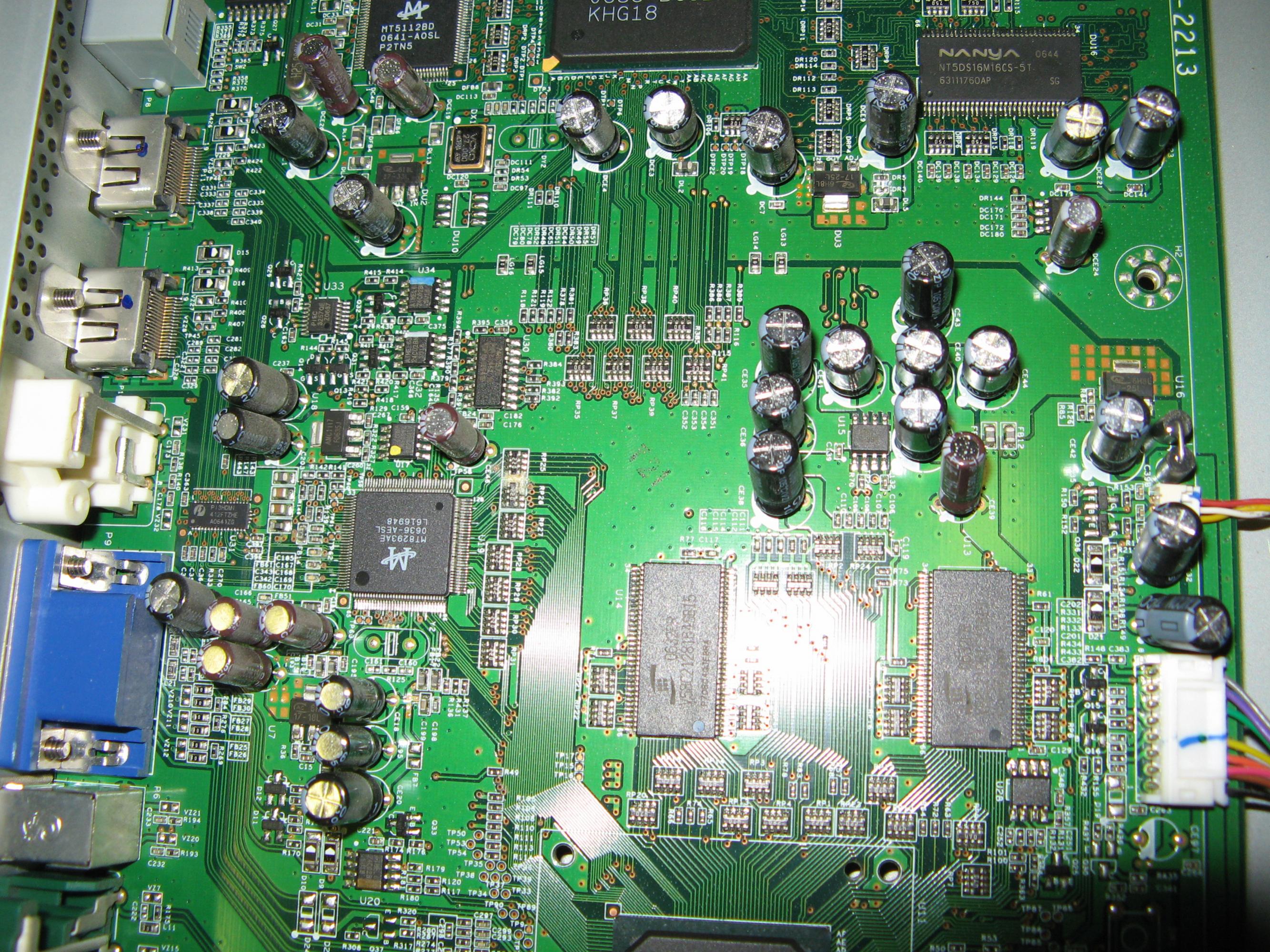

    Hi Folks!
    I acquired this Vizio unit from a friend who was about to toss this unit into the recycle bin. I adopted it hoping to bring it back to life with the help of this wonderful forum.
    It only shows a black screen, no sound after I push the power button.
    I hear a slight buzzing sound from the power supply.
    The main Board # is 3637-0012-0150(3C)

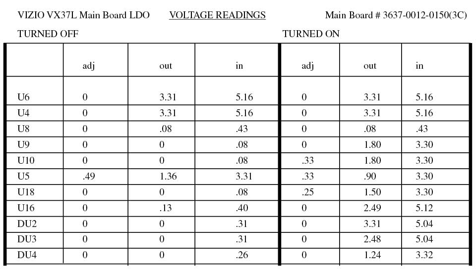

    Here are the LDO regulator readings (turned off and on) and a few pictures.
    Thank you!

    Do you have a DVOM and can you list model # and some pics of power supply and any other board on TV. Is there any light on? Power light?
    • Amuyamula
      • 22
      Re: VIZIO VX37L-Black screen
      I plug it in, amber light turns white and stays that way. Will take more pics tomorrow.
              That youtube link tom66 referenced is from the how to test a voltage regulator link below in my sig file. So you get a text and video explanation of how it works.
              U5 and U8 look suspicious.

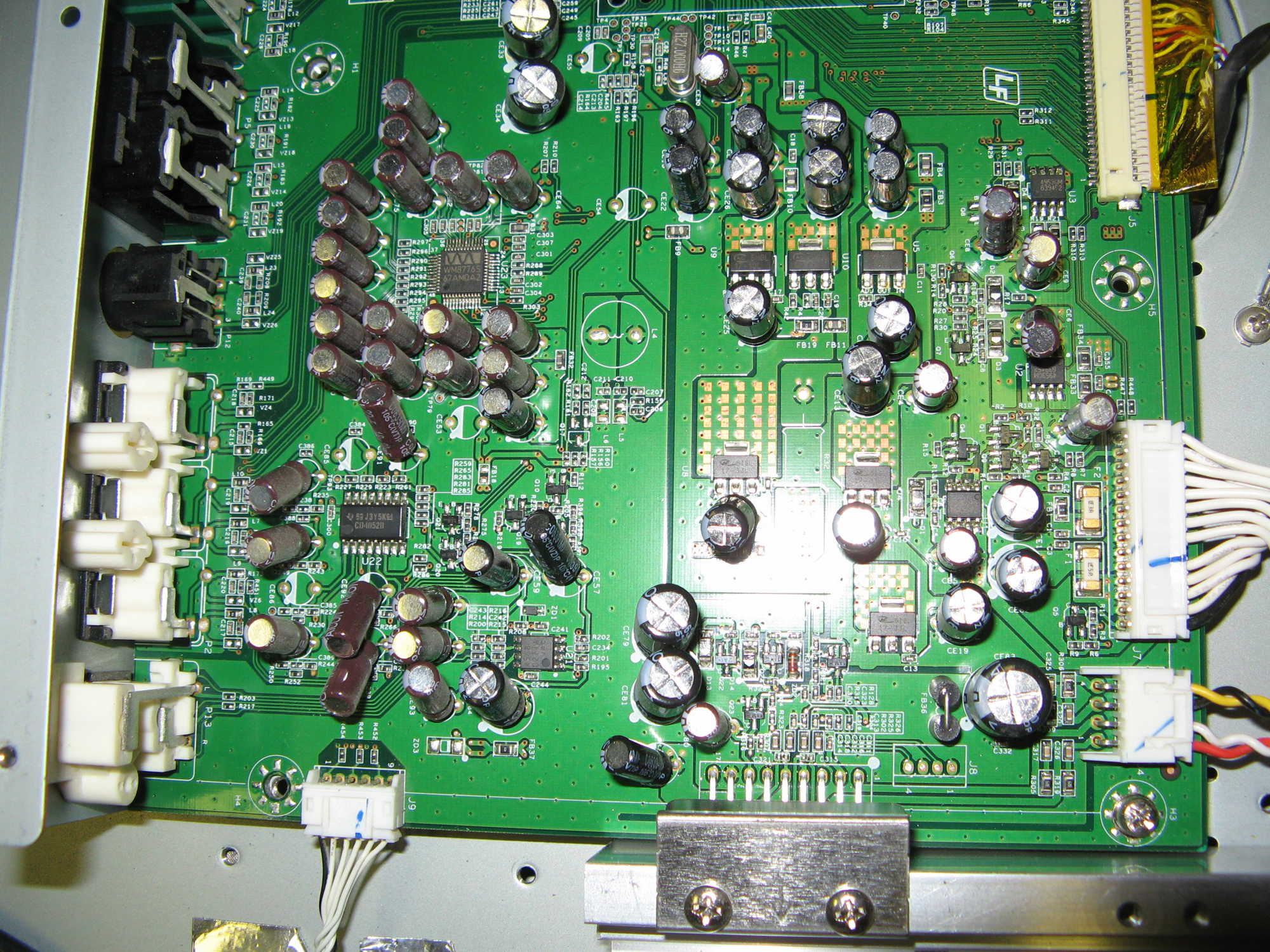

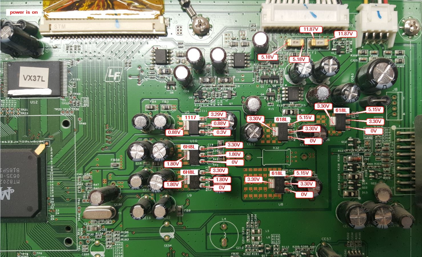

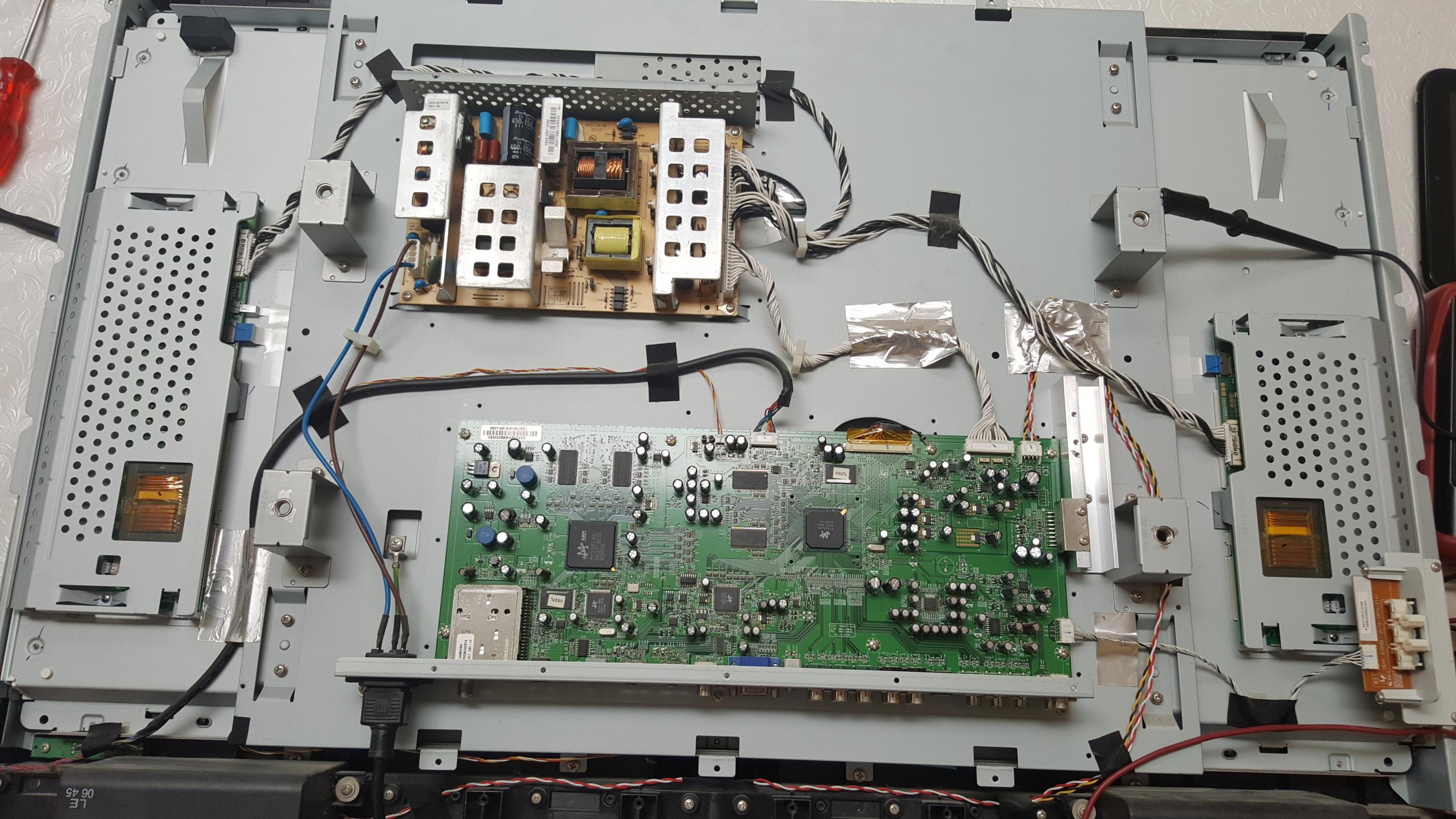

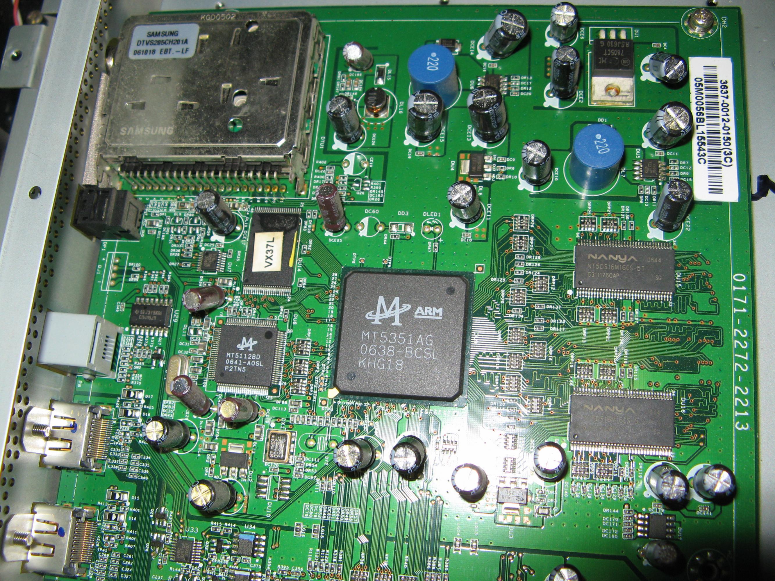

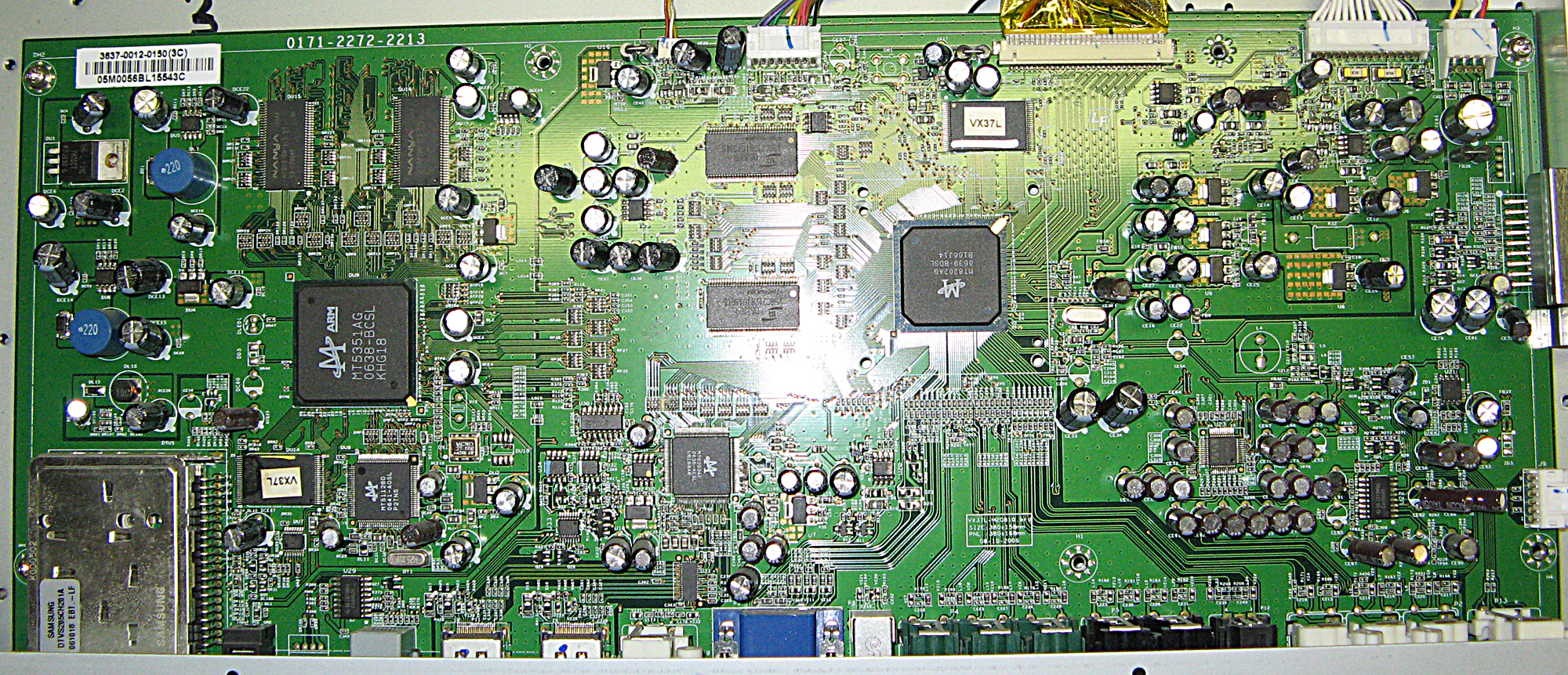

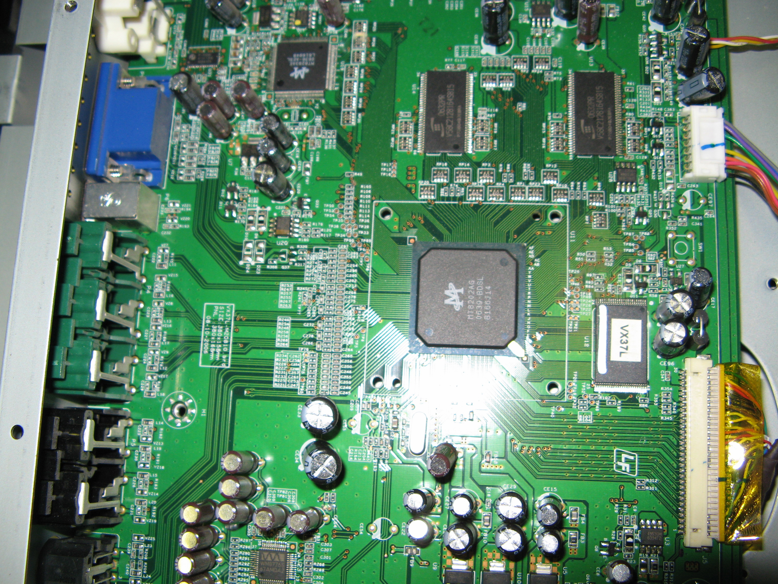

                        I have a Vizio VX37L with a popular problem: Vizio LCD Powers on with backlight, Wont power off, No video https://www.youtube.com/watch?v=cNFzBJELFoU ) .
                        I have followed the troubleshooting steps in this video and attached are pics of the board along with voltage measurements. I didn't see a resolution for this thread.....however, I am hoping someone can help with identifying the problem part (parts).
                        Thank you in advance!
                        Lee
