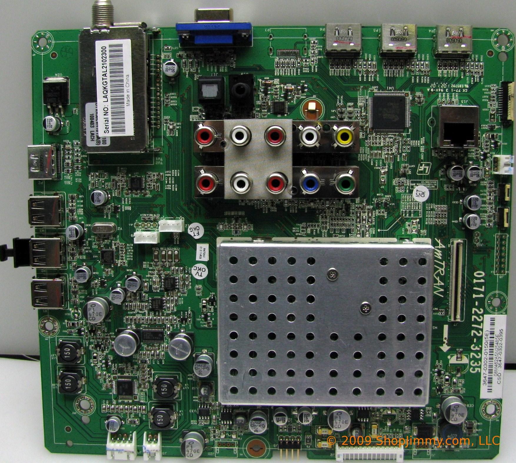

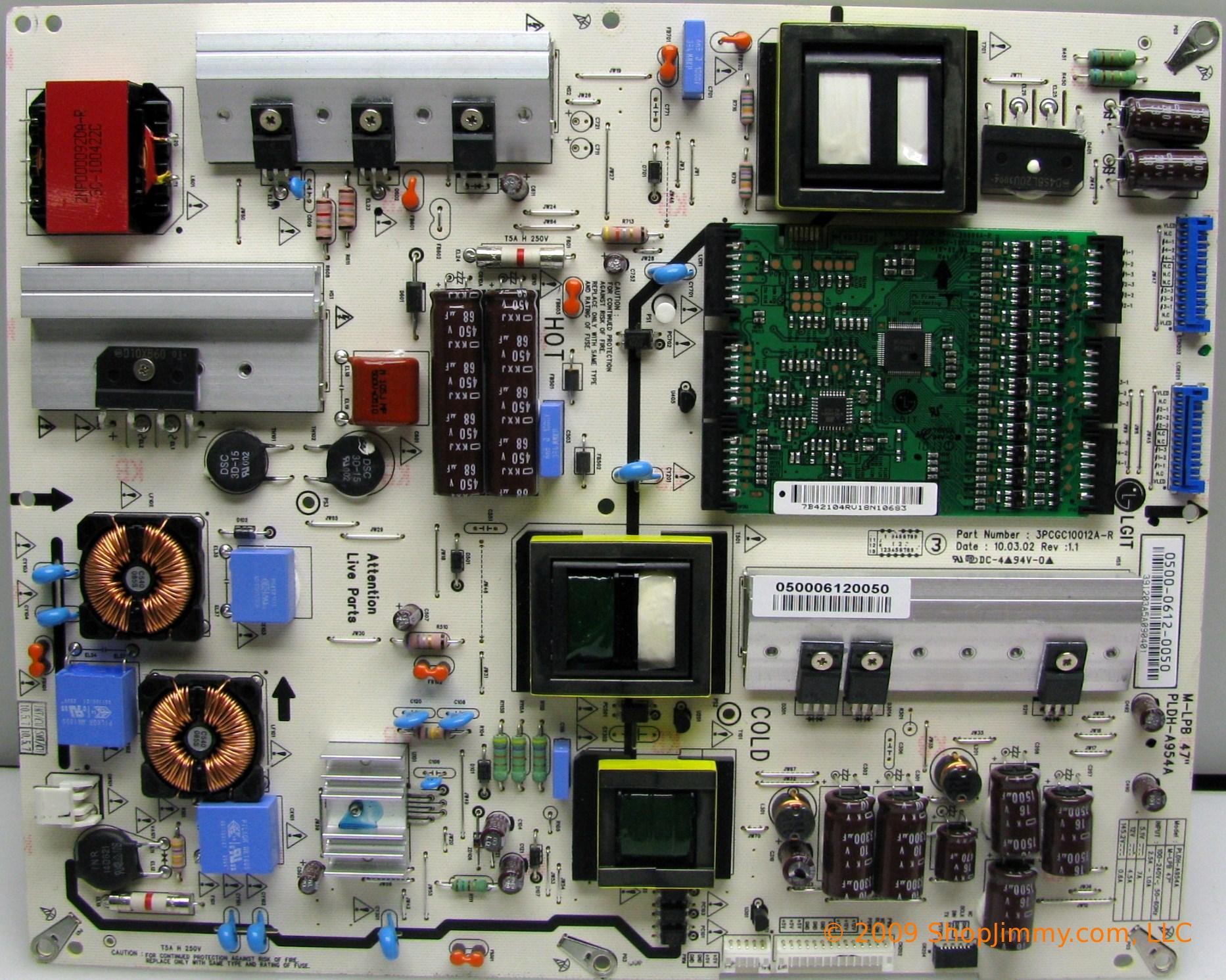

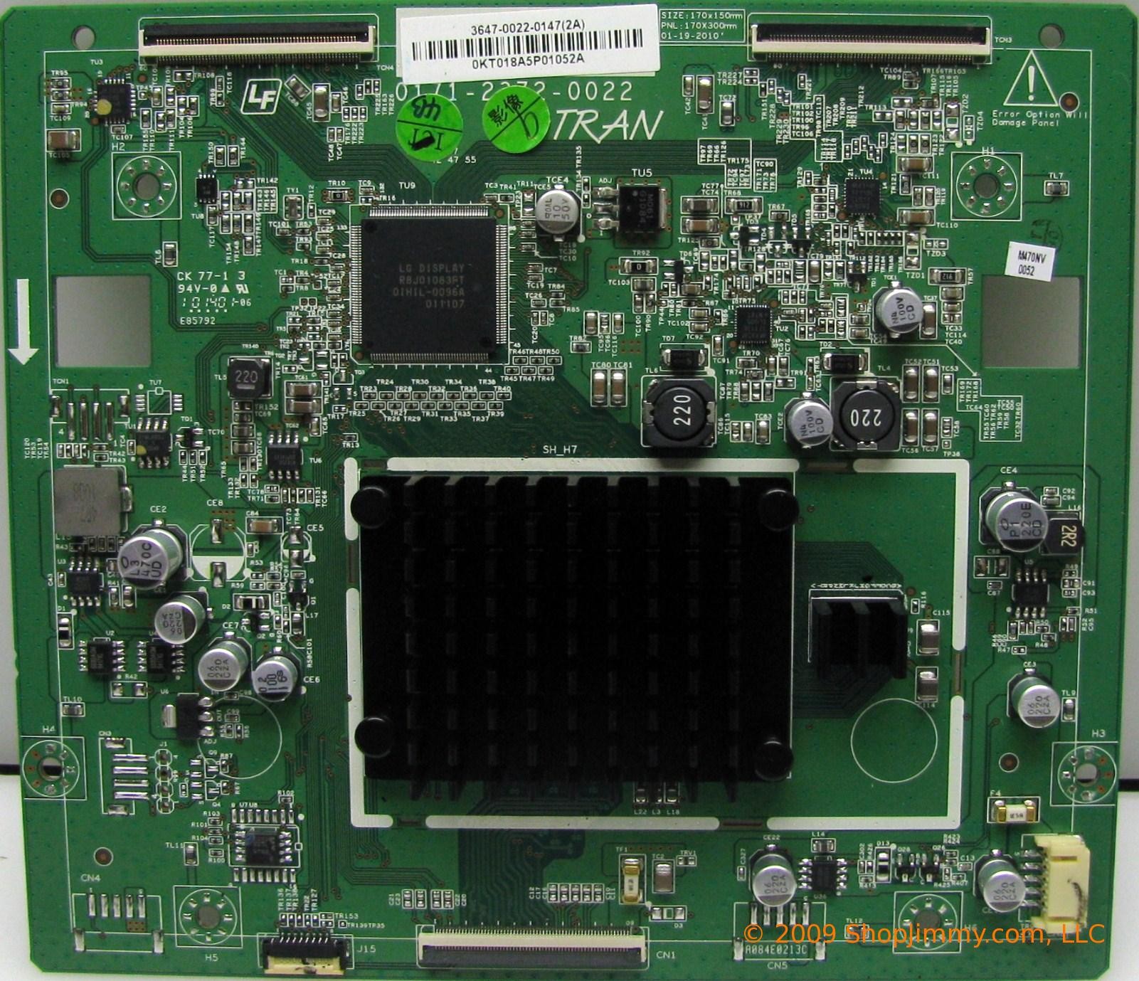

                Re: Vizio M470NV - Blinking logo
                HEre are the pictures of the boards. The 12V/5v Combo head to the mainboard.
                The bottom 5v connector heads to the daughter card.
                The 2 blue connectors head into the actual screen.
                    Wow so I just noticed the voltag parameters are right there on the card. 12V for the 12V rails, 5.1 for those, and 145.2 headed fro the LCD/LED section right?
                    So the next question is which ones should be on when?

                      At the bottom right of the board where the white connectors are, I cannot see the text clearly and some of them are blocked by the @2009 printing on the pictures.
                      Can you tell me what the labels are? I am looking for PS_ON, BL_ON or something like that. Right now your standby 5v power supply is working, the 12v should come on when you turn on the TV.

                              Also the text covered by the 2009 logo is
                              PWM
                              NC
                              BL_ON
                              Power
                              _ON
                              They are the top pins indicated on the cable
                              I assume the power on is the power on impulse switch from the mainboard to the supply?
                                OK, POWER ON (ON = >3VDC) is the signal from the main board to turn on the PFC Voltage booster circuit, BL_ON (ON = >3VDC) will turn on the LED backlights on, you should see 145V at the connectors (Blue) which feed the LED strings.
                                PWM is for backlights Dimming.
                                  I get 3.3 long pulse from the board and then it supplies 12.35 volts on all three 12v lines to the motherboard. After about 15 seconds the board decides that something is wrong and I get the pulse again and power shuts off. I will check the LCD voltages now.
                                    You should see the BL_ON goes high also.
                                    Also try removing the two cables (from LED ) from the two blues connectors and see if it still goes into shutdown.
