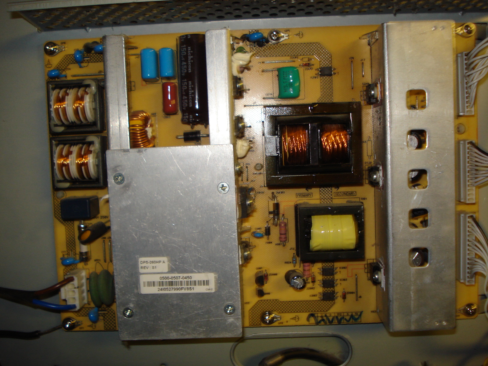

    The Standby Vizio Light is on but the TV will not turn on, I have checked voltages on the power supply board pin connectors and only have the 5v Standby Voltage, When holding down the power on button I have checked Pin 1 which is the PSON and the 3.3 volts is Not present, so the Power Supply will not turn on, which means the 12v and 24v are also not present. I have checked both small fuses on the Main Board and they are both good. Now I need to know the next step in troubleshooting, I read about the dummy load test for the PS Board but I don't think that will work without the 3.3v at PSON. Any help is appreciated.

    This video may be applicable to your problem:
    http://www.youtube.com/watch?v=cNFzBJELFoU&feature=plcp
    Test ALL regulators, not just the one in the video.
      Re: Vizio 42" LCD VW42LHDTV10A Will Not Turn On
      That was helpful and interesting and could possibly lead in the right direction, although my problem is different than what he had going on, I need to find out where the 3.3 v for PSON is supplied from and why I don't have it. Thanks!

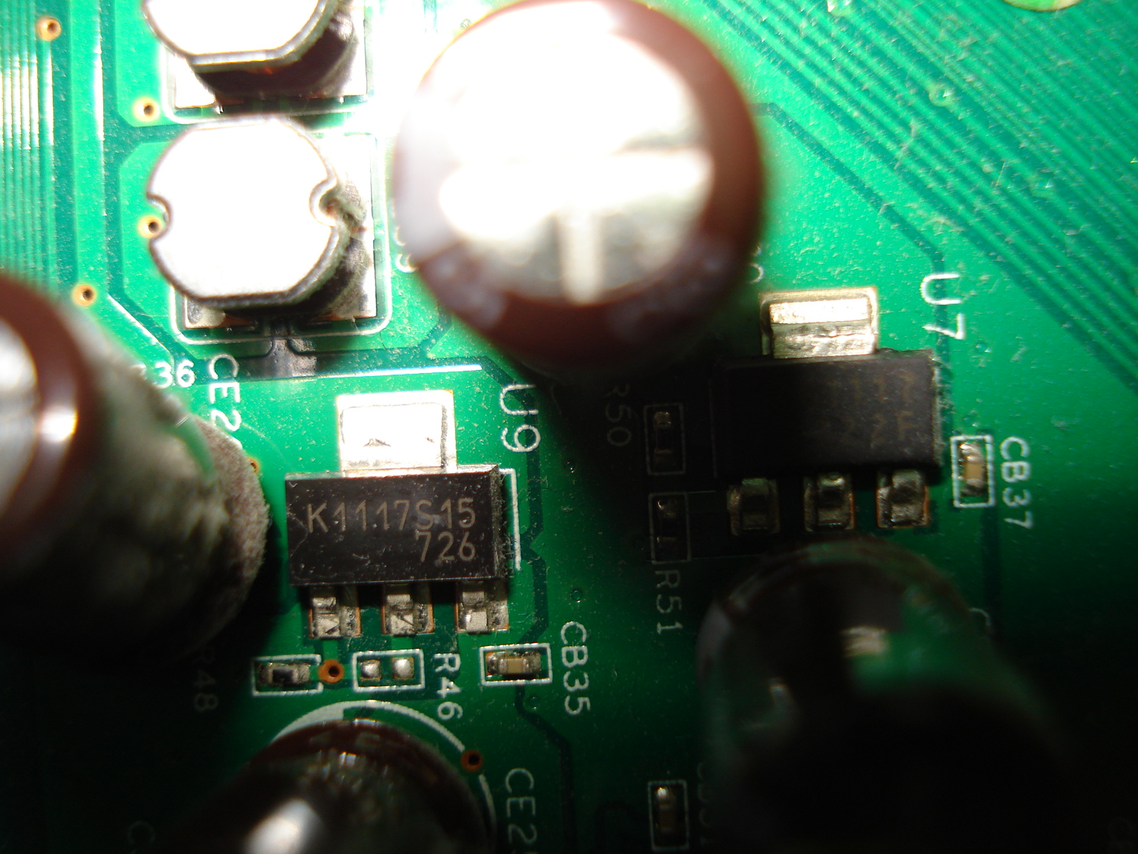

            I checked voltages on some LDO's although the set will not power on, On the Mainboard U33, U8, and U2 all have normal input output voltages but U7 and U9 have 3.3 v input but zero v output on one and only .01v output on the other. does anyone know if all these regulators should have normal working voltages with tv plugged in and the power off?

                "but U7 and U9 have 3.3 v input but zero v output on one and only .01v output " Can we see the pictures and the P/N?
                  Here's both U7 and U9 U7 is AMC1117 F0722F and U9 is K1117S15 726

                    So the voltage on the rightmost pin is 3.3V?

                      Yes, The rightmost pin is 3.3v, middle pin is 2.01v, left pin is 0v and larger pin is 2.01v that's on U9
                      0n U7 rightmost pin is 3.3v, middle pin is .8v, left pin is .01 v and larger pin is also.8 v

                        It is very unusual for both regulators to fail so there might be another fault.
                        Do they get hot at all after 5-10 mins in the not turning on mode? Just lightly touch them with your finger and if it is hot enough to be painful, there is a problem. If they're just warm, probably OK.
                        Then turn the set off and test the resistance across the middle pin to the chassis of the TV. You should read a few hundred ohms, maybe more.

                          The output pin is the middle pin.
                          "0n U7 (AMC1117 F0722F) rightmost pin is 3.3v, middle pin is .8v, left pin is .01 v and larger pin is also.8 v"
                          This one does not look right. Check the resistance reading between middle pin an ground.
                          U9 is K1117S15 726 looks like a 1.5V regulator, so middle pin is at 2V. Does not look right.
                          I will look up the spec.

                            Set unplugged, U7 middle pin to chassis ground is 97.3 ohms and U9 middle pin to chassis ground is 337 ohms. touched both regulators lightly after set plugged in 5-10 minutes they are both cool.
                              OK from looking at the picture, U9 has a resistor between Left pin (Ground pin) and circuit ground to raise the output voltage from 1.5V to 2V.
                              U7 has resistor betwenn the ADJ pin and circuit ground and another resistor between ADJ pin and the output pin. Can you tell me the value as printed on those two resistors, I cannot see them clearly due to the dark shadow. They look like R50, R51. I need to know the value an which one is connected to the left pin and the circuit ground.

                                I don't think they have a value printed. They are 0402 size and only 0603 upwards are printed.
                                  If not, he will just have to measure them so Ican calculate the output voltage.
                                  "0n U7 rightmost pin is 3.3v, middle pin is .8v, left pin is .01 v and larger pin is also.8 v"
                                  Base on this reading, it does not look good since minimum out put will be 1.25V. U7 is an adjustable 1117 LDO, you canot have output less than the ref voltage.

                                    Sorry but there is nothing printed on those very small resistors.
                                      That is OK, at this point I think it is pretty safe to say that U7 is bad since the output voltage cannot not be less than 1.25V.

                                        as measured in circuit R50=95 Ohms and R51=2.3 Ohms, I can't tell which one goes to the left pin but could be R50, I'm not sure.
