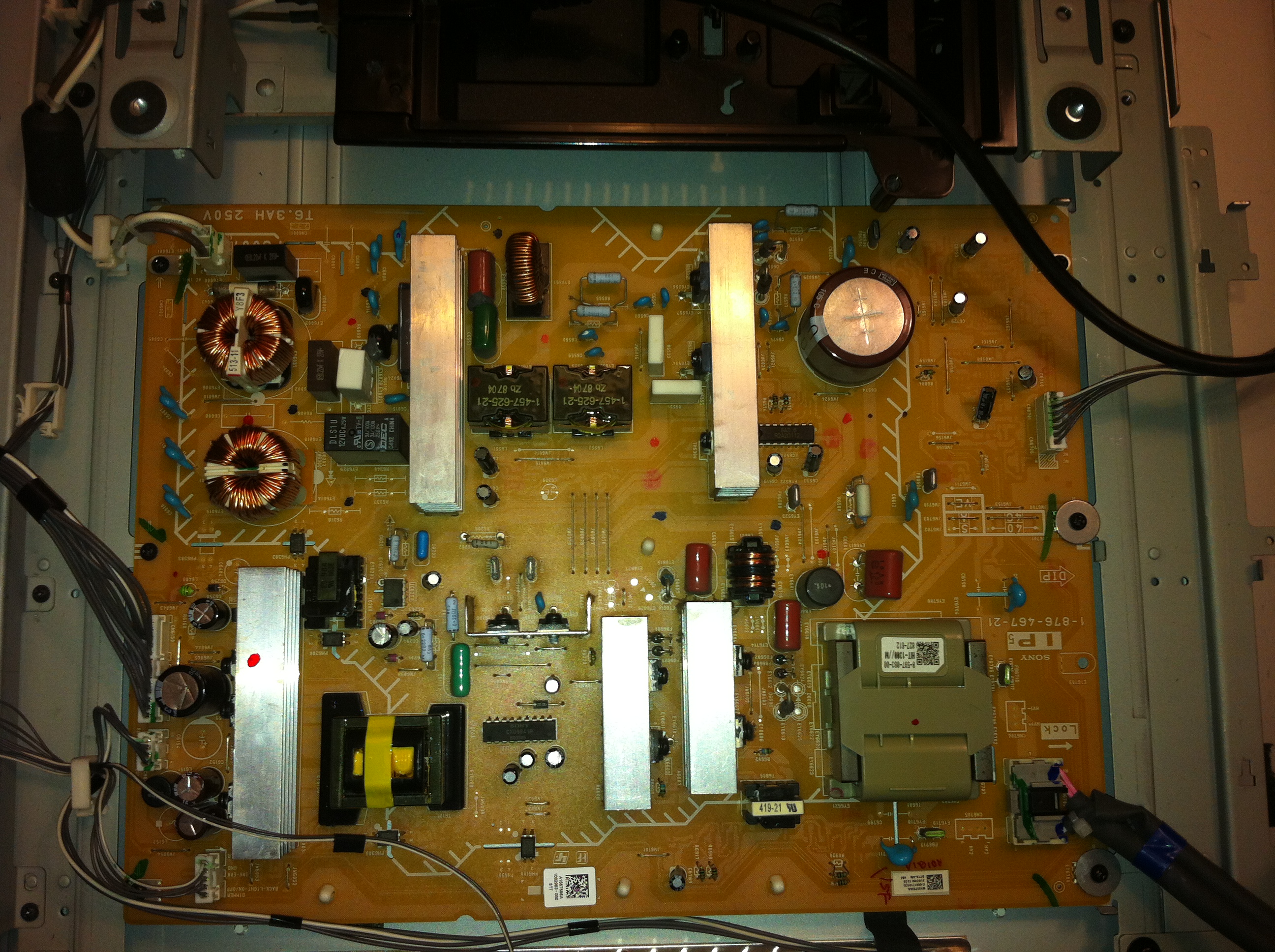

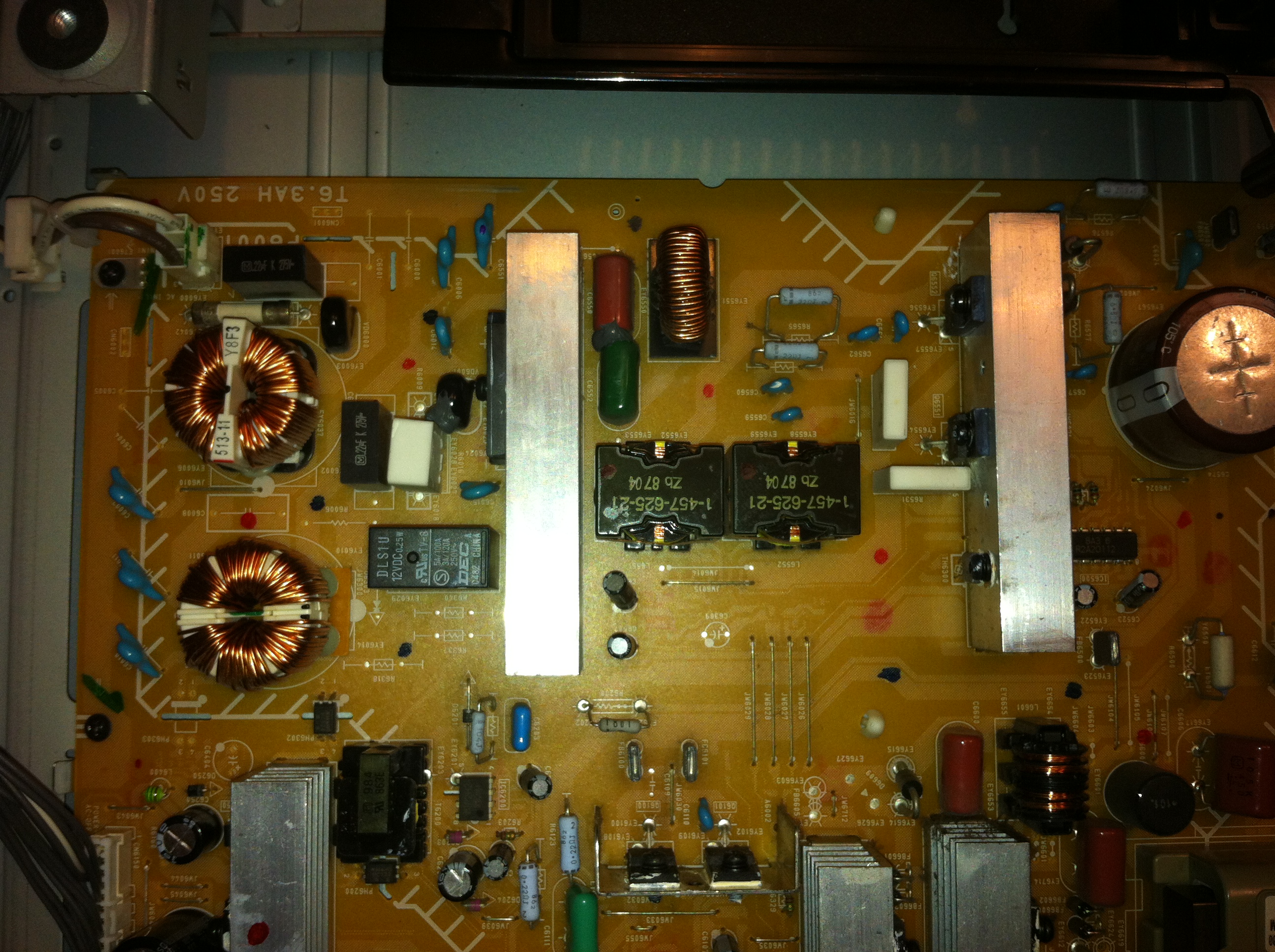

    I obtained a Sony KDL 40W4500 which blinks twice when turned on.
    So no screen, menu etc.
    Attached the pictures. Any idea what could be it? Caps seem ok to me..

    Ive read its a short in the psu.

      Re: Sony KDL 40W4500 - Blinks Twice
      http://www.scribd.com/doc/44214062/S...Service-Manual

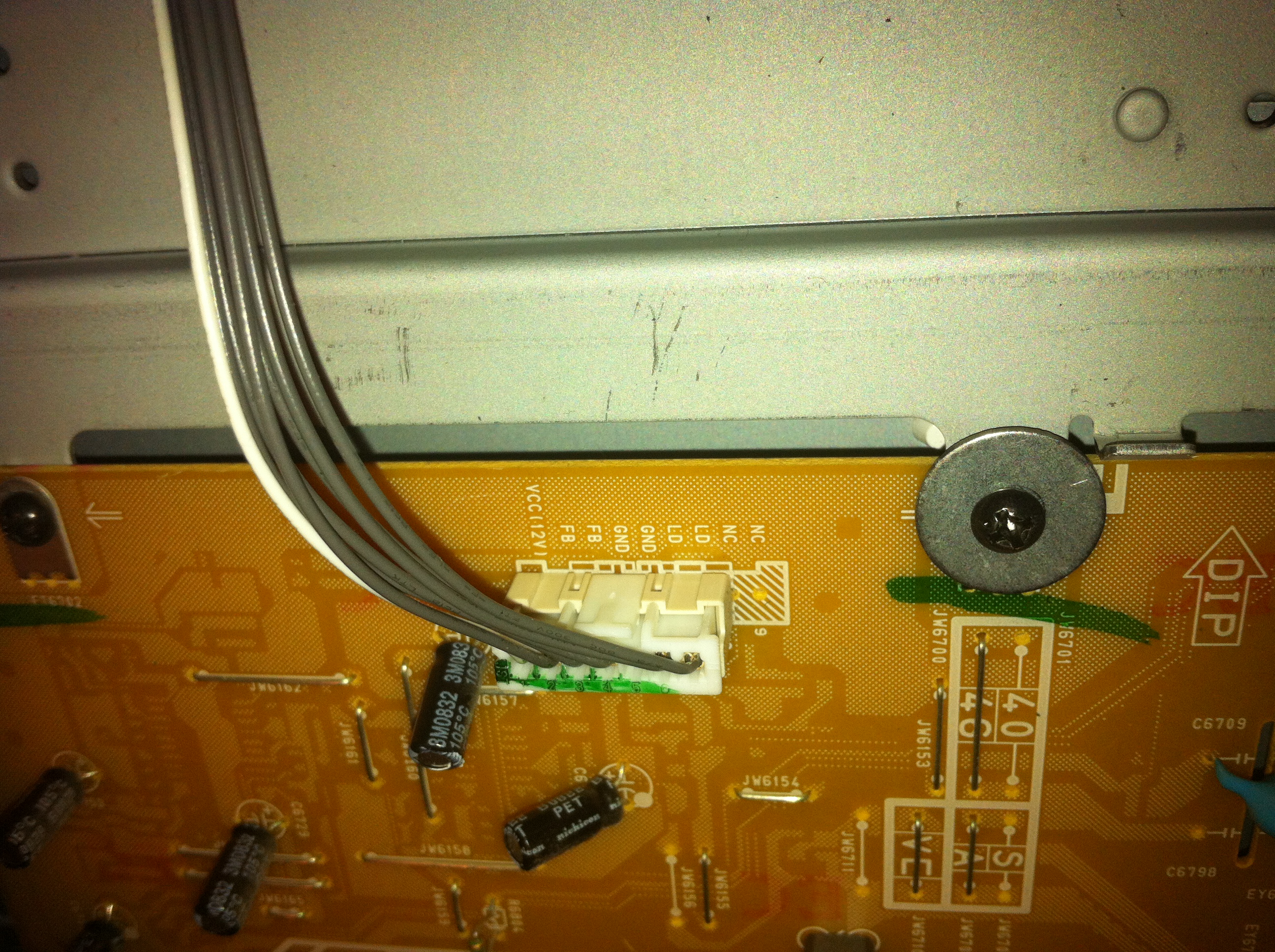

        It says:
        02DC_DET (12V main voltage).VERDIn normal mode.Goes into standby and LED flashes.
        So it should be something with the PS. Any tips on how to troubleshoot? Or should I replace the whole PS?

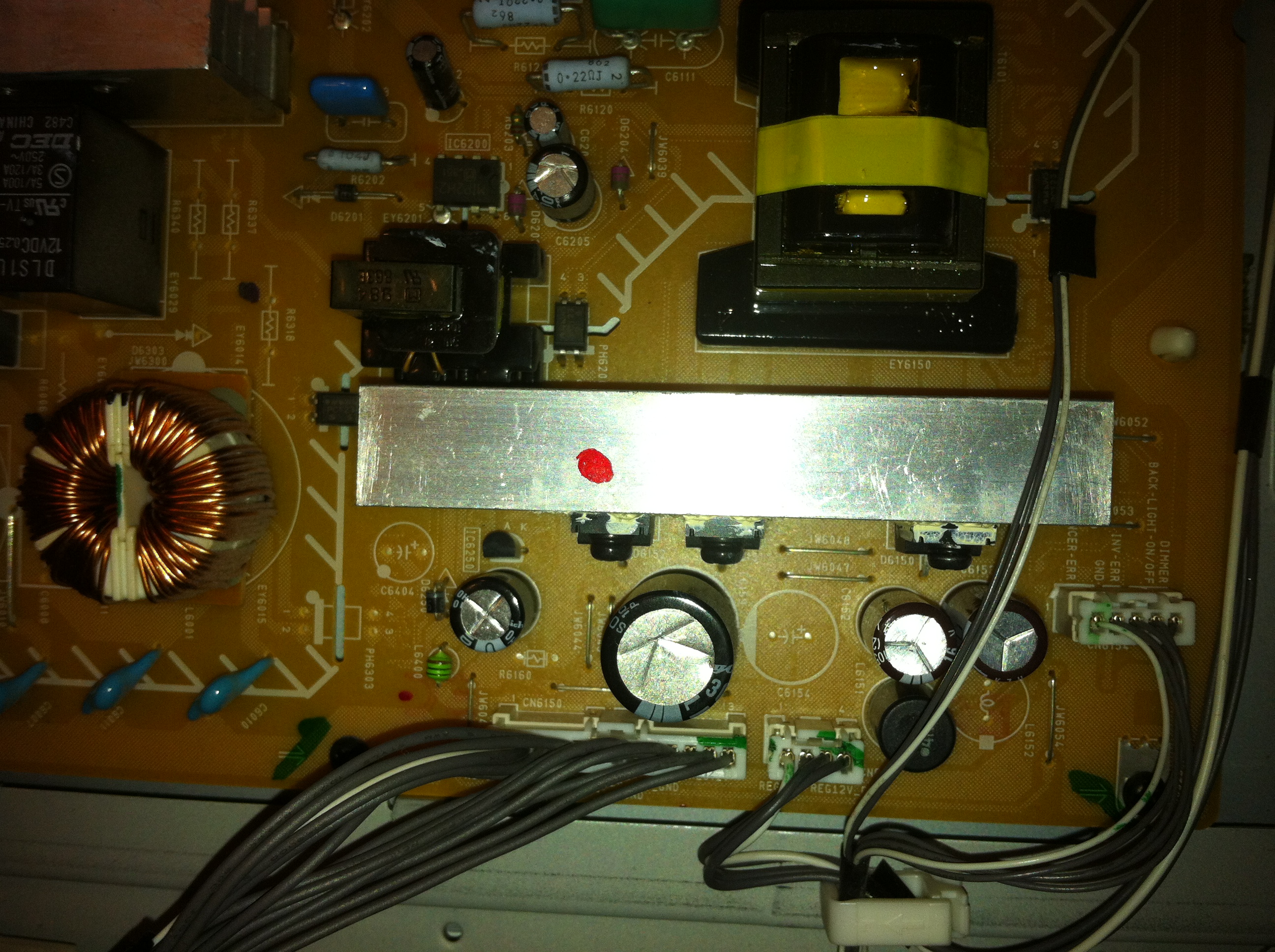

          have you got a multi meter you can check the voltages on the connectors usually there marked with what they should be. its hard to see in your pics maybe some good pics of the connectors and writing by them could help us.

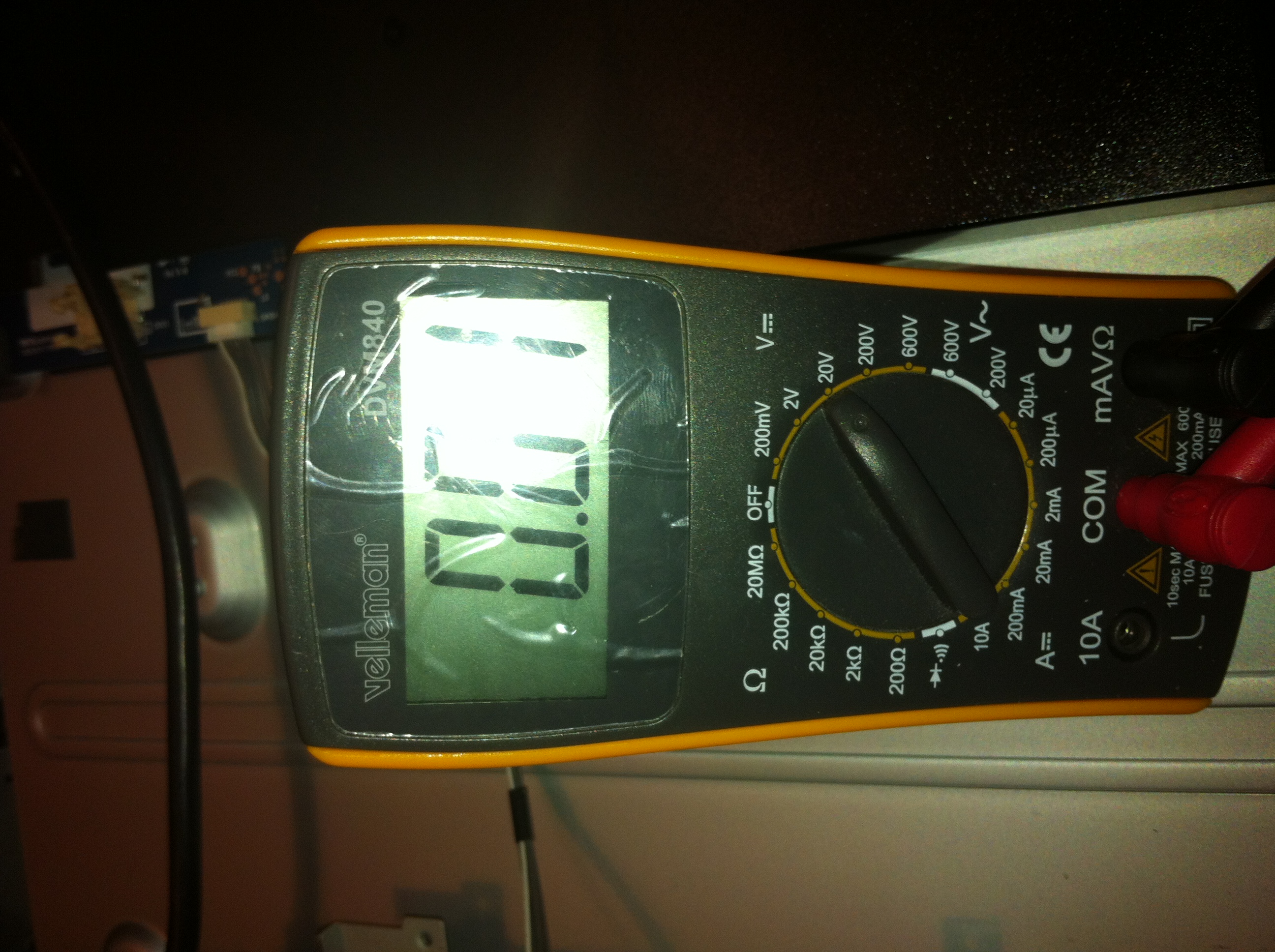

            I measured the plug in the image. It says 12v but gives 0v (If i measured right..)
              are the rest of the voltages ok ie 5 volt ones

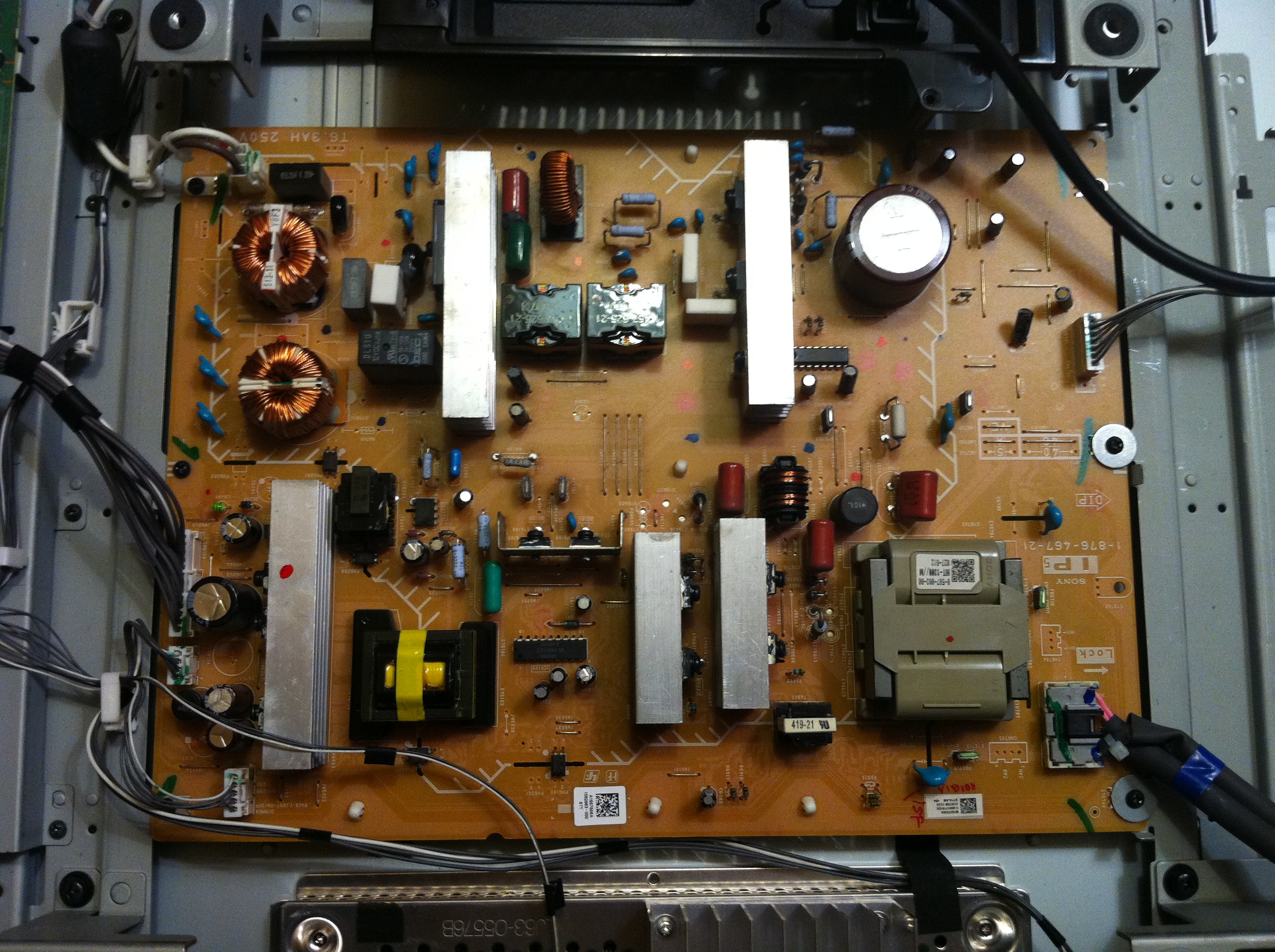

                              Any other tips on how to fix the PS? I can get a new one for about 30 pounds shipped. I'll do that if there is no other fix.
                                Any other tips. A new PS did not solve the issue.
                                  New main board then I would guess, unlikely to be t-con. You can contact sienoki as he has all boards for this TV.
