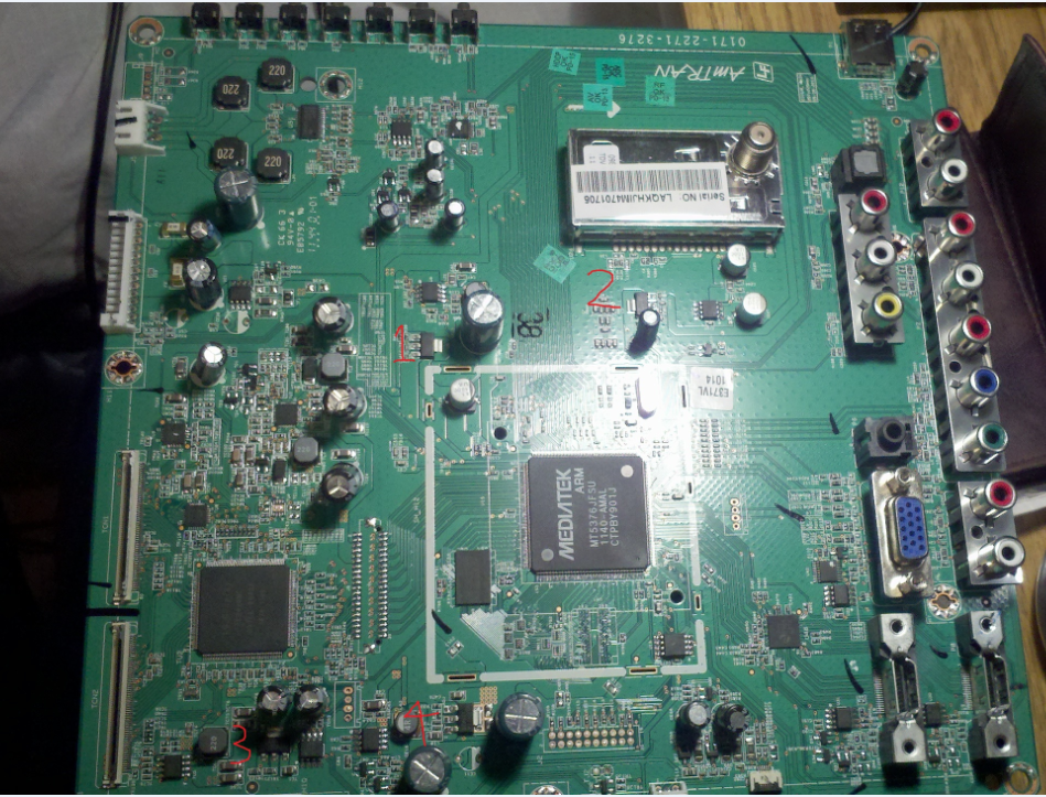

    So I got this thing broken. When I go to test it, it will turn on and function as a completely normal TV. When I hit the power button when it's cold, it will turn back on when I hit the power button. It will not after being turned on for a long time. And it will run for as long as you want until you turn it off. I brought it to my apartment to temporarily use and now it won't even turn on...All the caps look good on both the main board and the power board although not a fan of the cap choice. Is it probably the voltage regulators on the main board? I'll get my multimeter back tomorrow. In the meantime, is there any ideas to what it could be?

            Okay so I got around to testing this thing. Let me know if there are more I need to test if I missed any. Looks like I have at least 1 bad voltage regulator...Here are the results:
            Pin 1 = 0.000
            Pin 2 = 1.252
            Pin 3 = 3.326
            Pin 1 = 2.056
            Pin 2 = 3.306
            Pin 3 = 5.050
            Pin 1 = 0.000
            Pin 2 = 0.000
            Pin 3 = 0.000
            Pin 1 = 0.559
            Pin 2 = 1.816
            Pin 3 = 3.333

              Originally posted by Pentium4 View Post
              Pin 1 = 0.000
              Pin 2 = 0.000
              Pin 3 = 0.000
              1) What is the part number for #3?
              2) Are there any DC voltages on the caps around the #3 regulator?
              3) Are there any DC voltages on the resistors around that #3 regulator?
              4) Can we get a close up shot of that area?

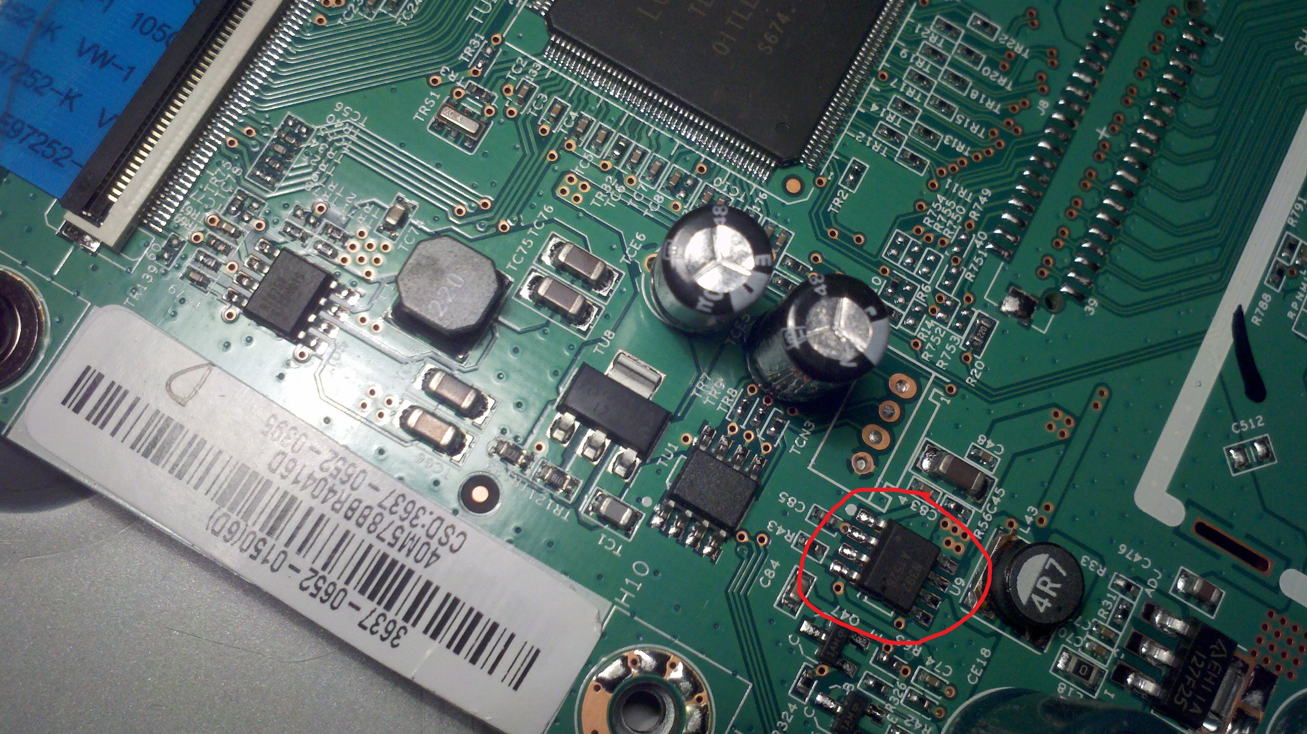

                Thanks for the reply! Part # is: EH11A 127F25. Circled is the closest thing that gets DC power (I didn't test the caps though)

                  What is part number TU1? Post a link to its datasheet as well.

                    Re: Vizio 37" having intermittent issues
                    On pin 3 of TU8 (regulator #3), see what it has continuity to. Namely, does it have continuity to any pins on TU1 or the caps TCE5 and TCE6?
                      All 4 of them have the same Part # on them.
                      thank you for your help so far!
                      Pin 3 of #3 has continuity to only cap TCE5

                        I mean the datasheet for TU1 (8 pin IC).
                          Ohhh okay. I can't find anything on it. It reads:
                            1) See if there is DC voltage across the TCE5 cap.
                            2) See what else is the + leg of TCE5 is connected to.
                              432N
                              It could be
                              https://cdn.badcaps-static.com/pdfs/...a5f3eed1f1.pdf
                              See if pin 3 (VCC) has any voltage wrt to chassis ground.
