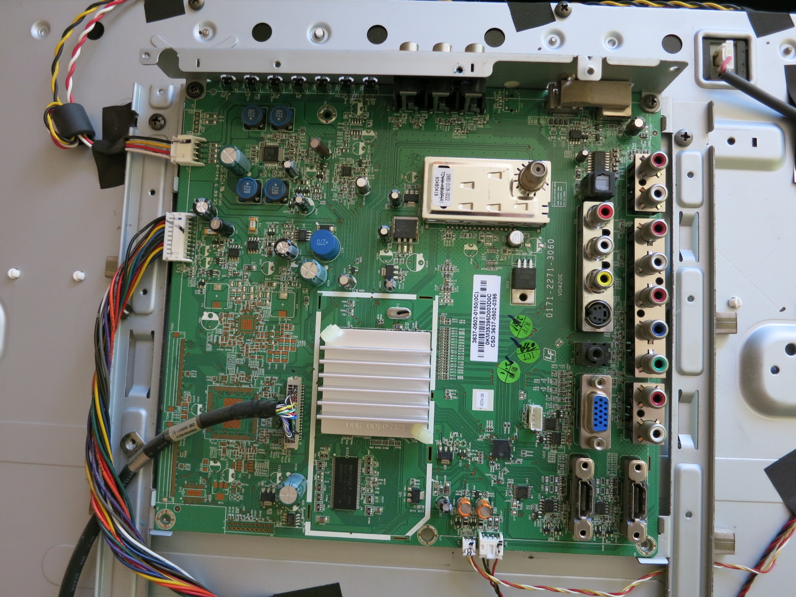

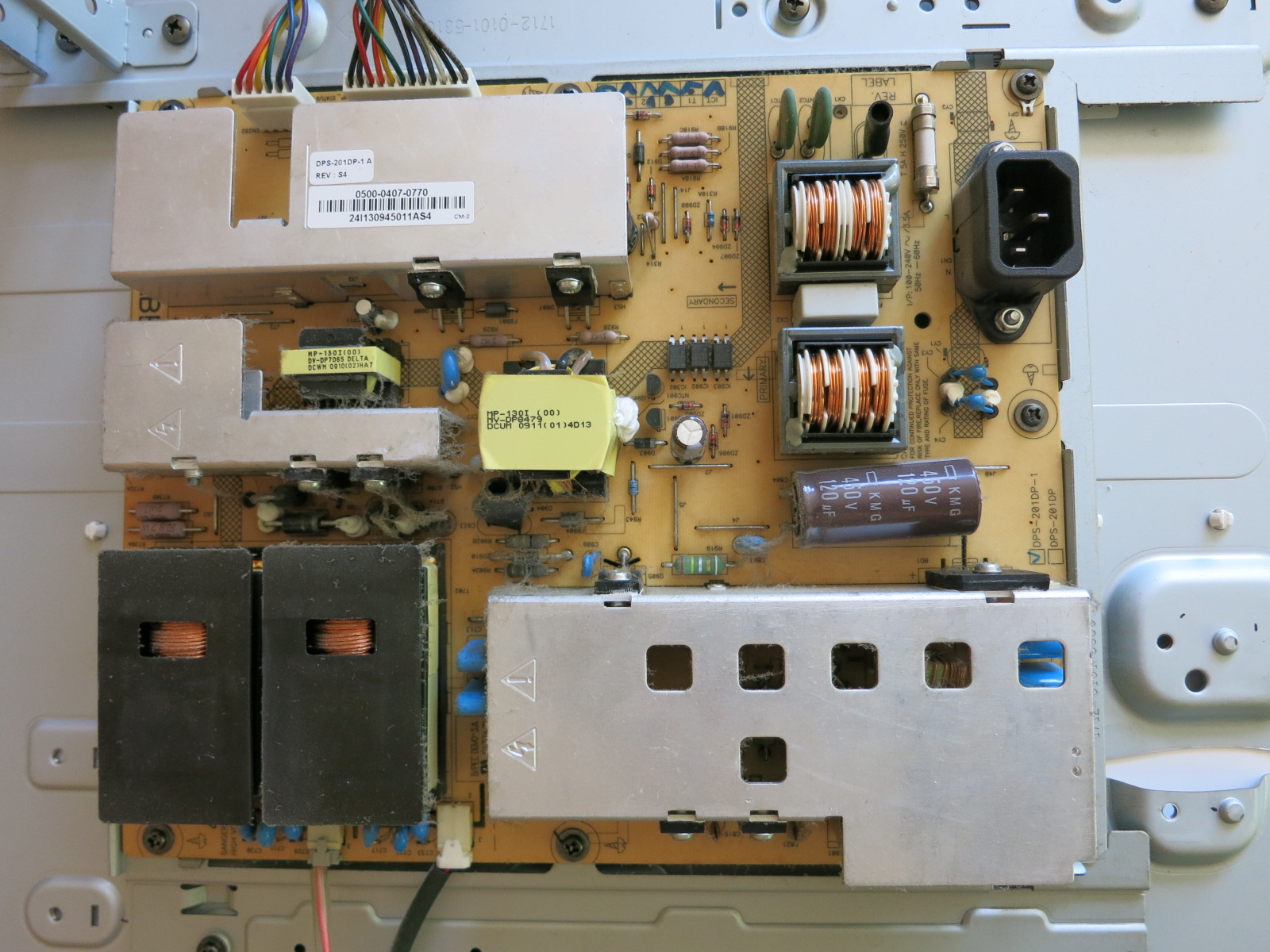

    Re: 10 year old Vizio VO370M has intermittent flickering backlight
    power and mainboard attached.
      Take a look at all the capacitors on the power supply, especially the ones under the metal heatsinks for any signs of bowing.
      Also take a look at the solder joints underneath the power supply and make good any that look poor or cracked especially around the transformers.
      Is the voltage when measured between the two legs of the 120uF, 450V cap steady or does that flicker when the screen flickers?

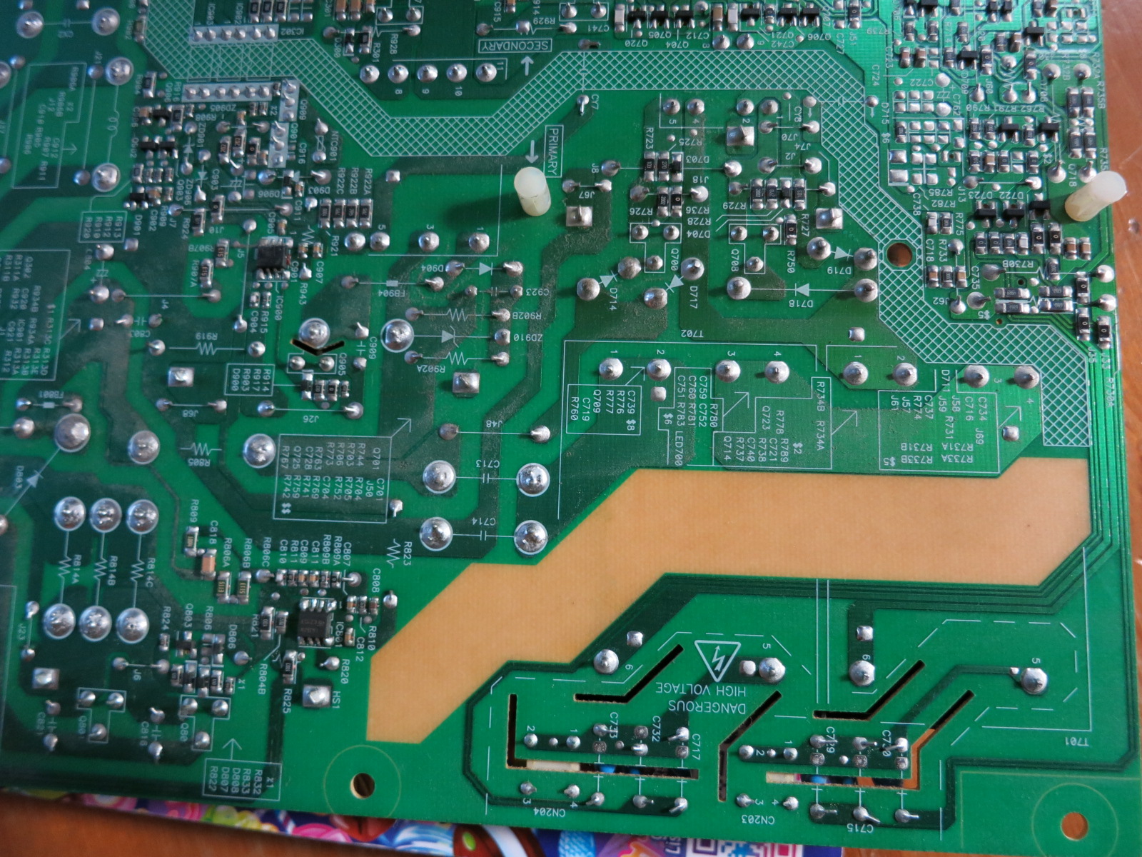

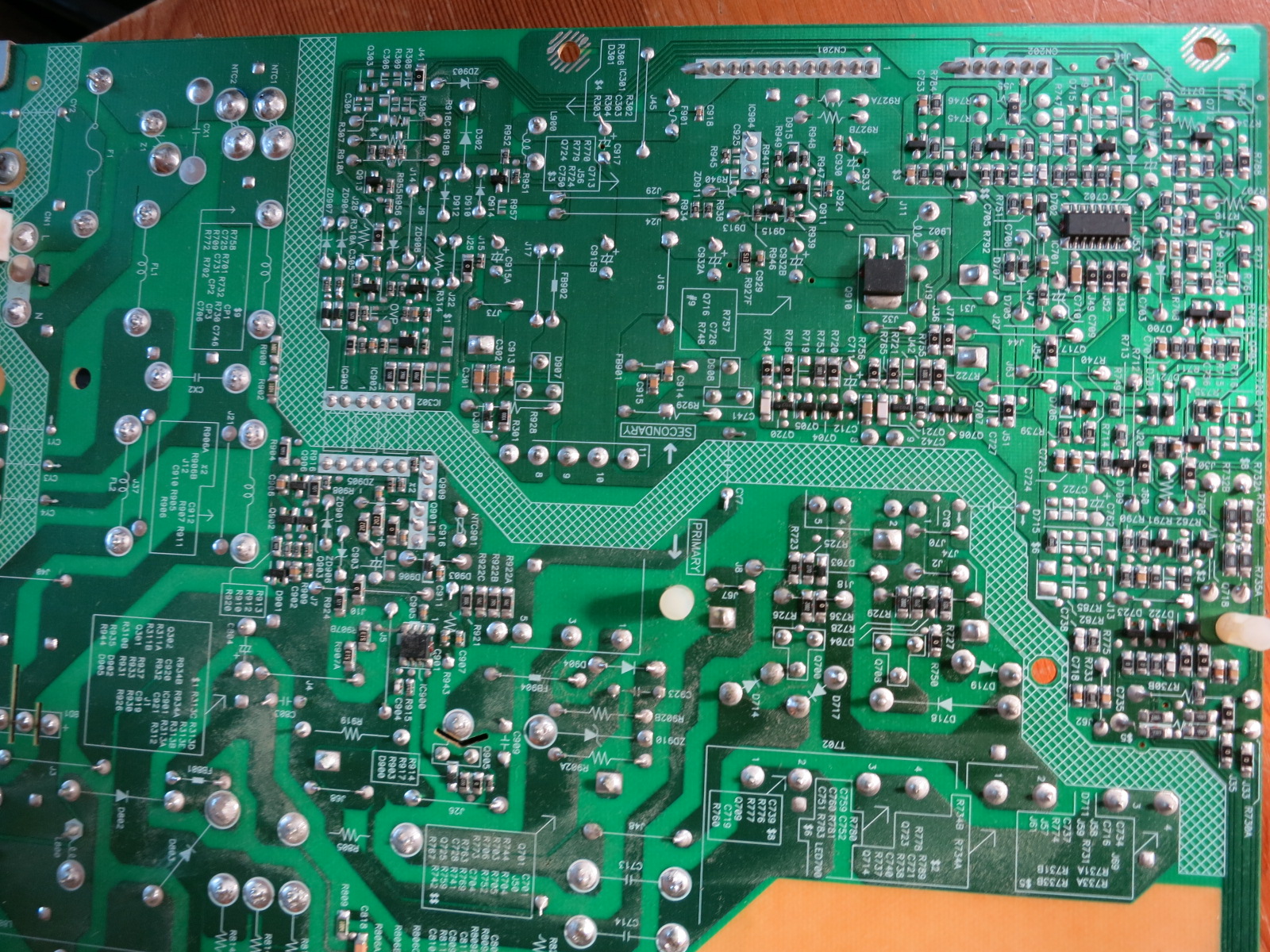

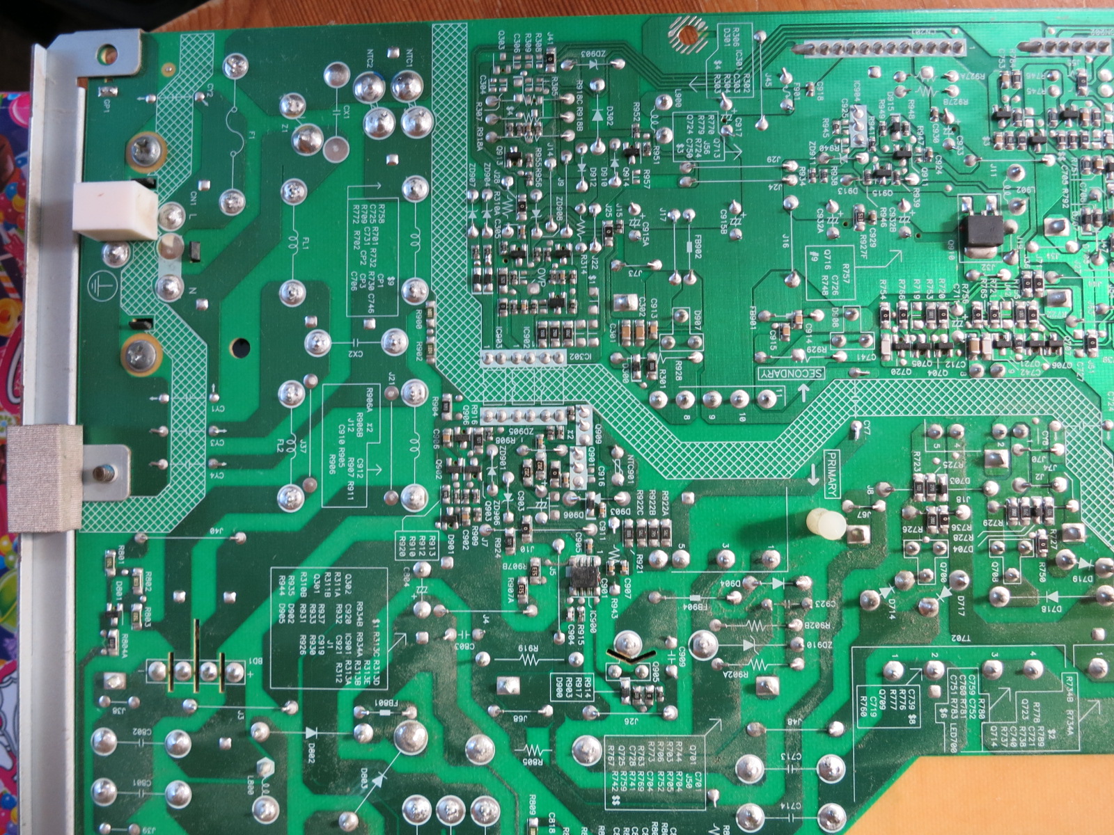

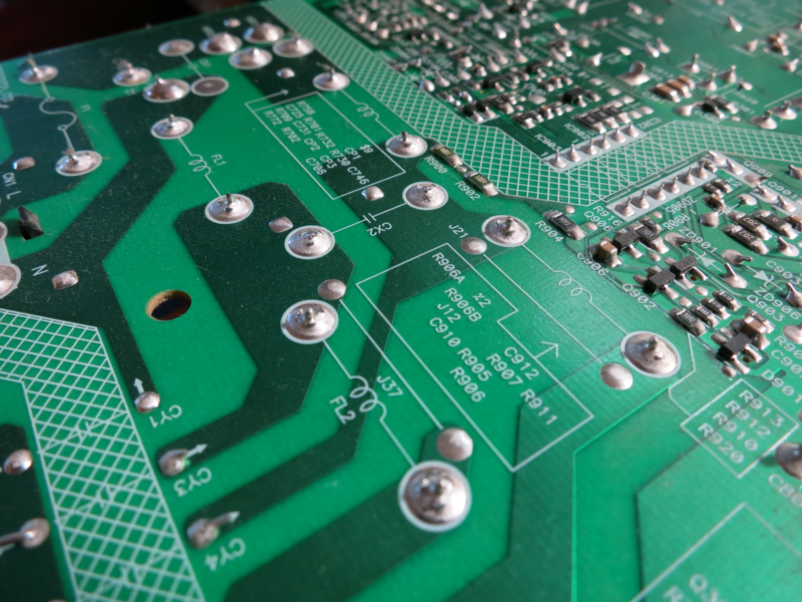

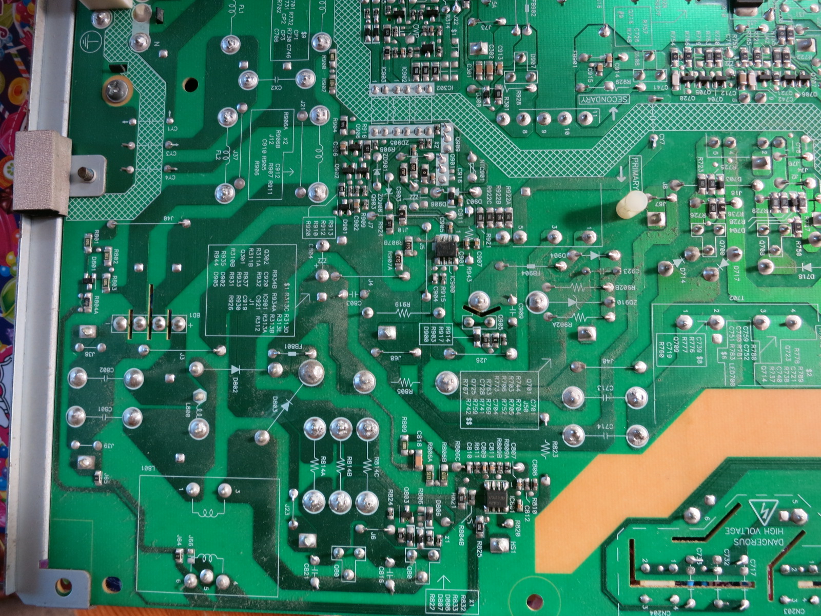

                              Take some close-up pictures of the backside of the power supply board, especially in the area of the two transformers (lower left corner in your top side photo). Also, try to clean all the dust and cobwebs off the top side of the PS so that we can get a better view. A blast from a compressed air line will do just fine.
                              As for measurements, start at the tubes themselves, then at the tube end of the supply lines, then at the PS end of the supply lines, then at the output of the Schottky diode for the tube supply. Somewhere along this chain, you will find either a broken solder joint, a bad wire crimp, or a bad component. My bet would be one of the first two options.
                              • xeos
                                • Apr 2014
                                • 38
                                • usa

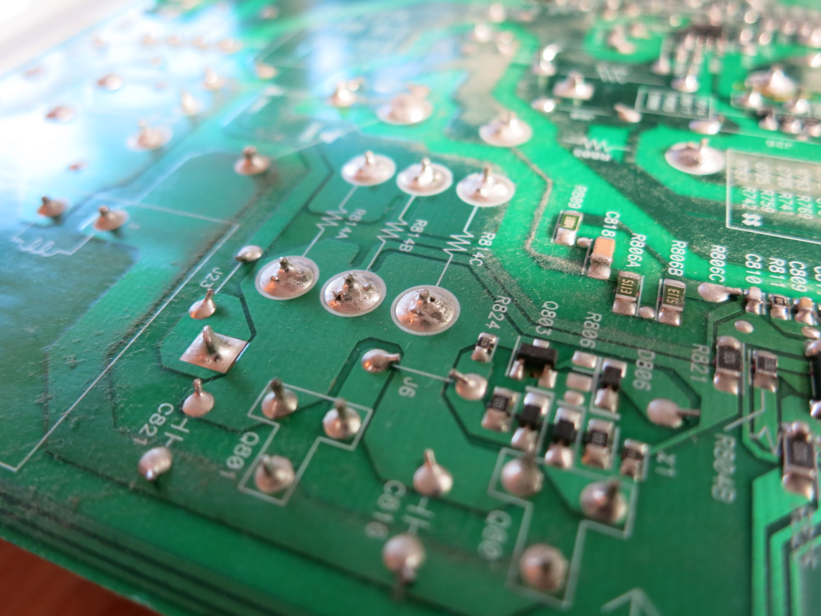

                                I took photos by quadrants starting where you requested. In doing so I noticed something that might be an issue: some of the joints looks pitted almost like the solder didn't melt completely? see last two photos for closeup. There's no evidence that these joints are loose and the holes are tiny so I'd be surprised that they don't work, or that they would only work intermittently, but it's a place to start. See anything else worth touching up at the same time? The area with the transformers looks perfect, none of the odd pits.
                                  I can't see any problems with any of the joints. See if you can induce the problem by wiggling the cables to the tubes.
                                  As a last resort, you could buy a single replacement tube and replace the ones in the TV one at a time to see if you have a single bad tube. Watch the TV with the screen removed (just the backlights) and see if a single tube flashes first. You can film it with your camera and slow the playback to better visualize what is happening.
