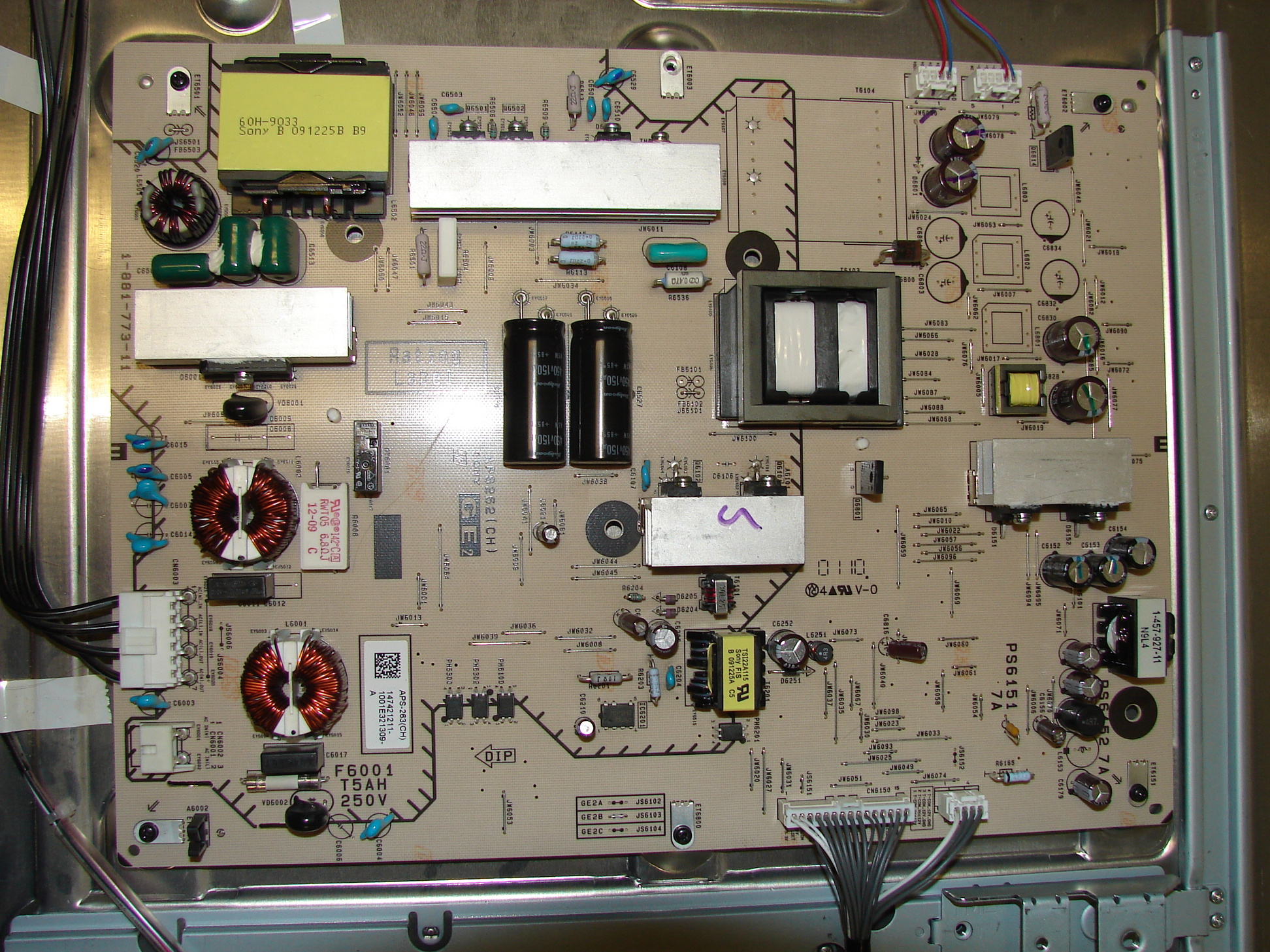

          Ok so here are the voltages I found.

            Re: Sony KDL-46EX700 - No Screen
            OK, the main board is sending out the PS_ON signal of 3.3V which is enough, so you need to check the DC voltages on those two large DC filter caps to see if the PFC is working or not, when the TV is plugged in, the voltage on the caps should be around 165~170Vdc, when you hit the power switch, the main board will send out the PS_ON, that should start the PFC voltage booster that should bring the voltage on the caps to be about 400Vdc.
            The BL_ON and T-CON on signals are generated by the Main board. Since this an edge lit LED, there should be some small boards for the LED's power supply some where. Can we see the whole back of the TV?
            So check and see if the PFC is working first.
            The BL_ERR (backlights error) of 3V, I am not sure if 3V= good, 3V = bad.

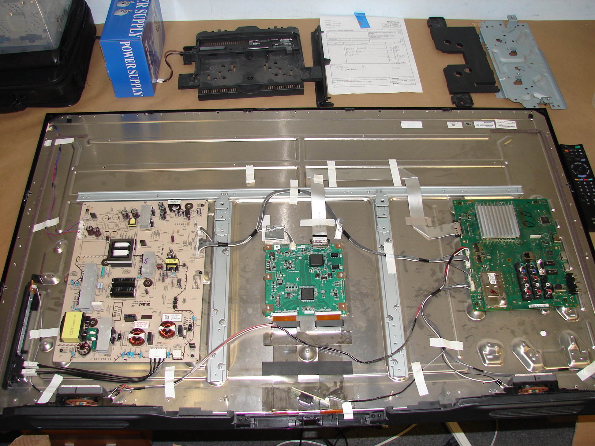

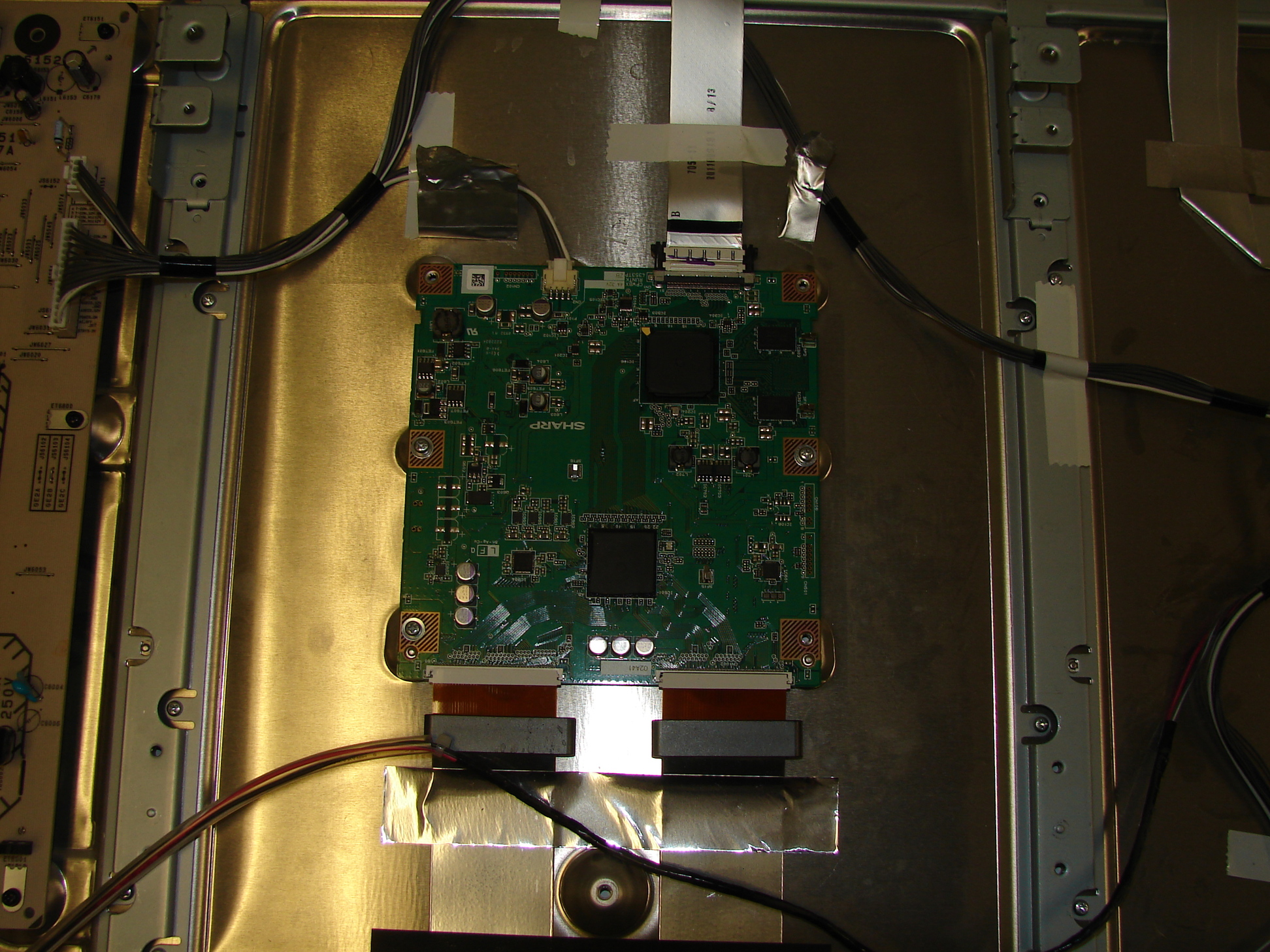

              Actually those are the only boards on the back surface of the panel. It kinda threw me that this was an LED since I was used to that driver board (as I call it) for the LED's that is on the later models (well a 46nx800 and maybe some ex series) but the wires going to the panel were really skinny nor was there any inverter on the p/s. Maybe its on the side? But on the left (top right in pic) of the power supply those are the two connectors for the LEDs I would presume.

                Well irregardless of what the front display is (red or green) the power supply is emitting those voltages posted above and the voltage on the caps is 396v. There is an initial click when you plug it in but thats it. Oh and here is the whole back.
                Panel is a Sharp LK460D3LA8S

                  It looks like the two plugs with red and blue wires are for the backlights LED's.
                  The PS_ON and the PFC circuits are working. So it is either the Main board is bad because it is not sending the BL_ON to the power supply board.
                  What you need to do now is to monitor the BL_ON signal to see if it even change state at all, put the DC meter on that BL_ON pin, then plug the TV in, see if it change, if not, turn on the power switch and see if it changes state or not. If it stays lo, then do the same at the BL_ERROR pin to see if it changes state also with the same procedure.

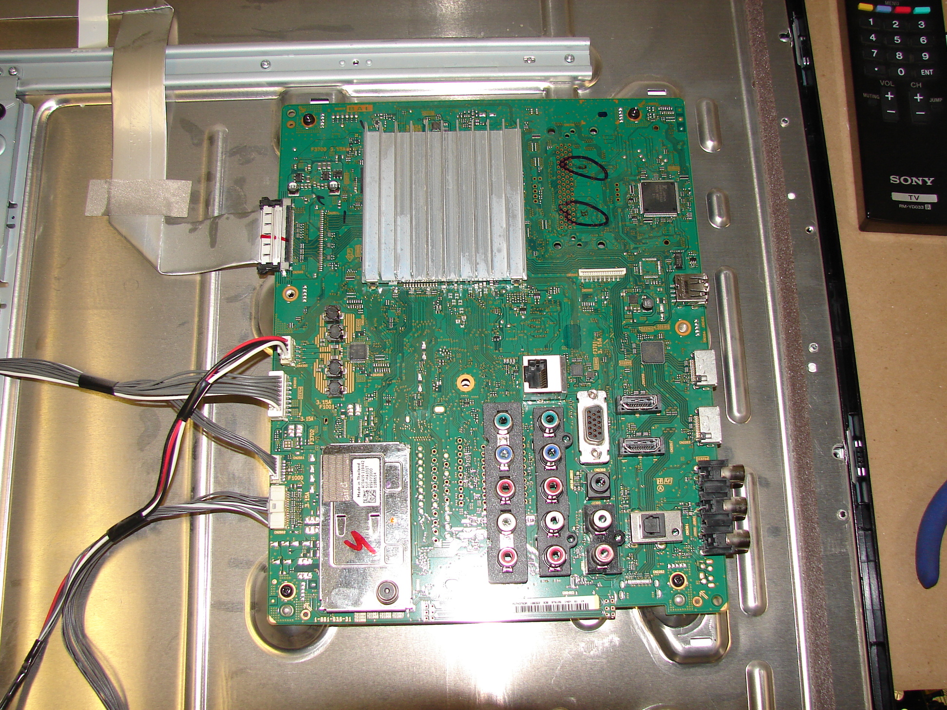

                    The BL_ON does nothing at all.
                    The BL_ERROR is .74 (when that power savings switch is on (so set is off)) and then whether it is "on" or "off" it is the 3.3v
                      The BL_ON should at least change when the TV is turn on because it should at least try to turn on the backlights, and after that if the backlights do not turn on then the error signal will be generated. Since the BL_ON is generated by the Main board, that is the next place you need to look at, there should be voltage regulators on that board.
                      I do not see them on that side of the board from you picture, but I do see that the main board has fuse/s on the board, you can see F1001, mad may be more that I cannot see, the voltage regulators may be on the other side of the board also.

                        Just out of curiosity, what is the generated signal? Higher voltage or no voltage...since there is already 3.3v on it?
                        And ya, there is a few spots that say F1000, F1001, F3700, F3701, F3702 with that 3.15 amp marking but I do not see what it is referring to. That may be for a different design of the board.

                            Oh and I did find the fuses :P....they are very minute and look like small smd resistors....the back of the board was much clearer and what it was referring to so now I see them. The only thing close to a regulator I see has the numbers 55 250 A0 9A on it unless Sony uses a 6 to 8 legged IC or bigger. But if things are pointing to a main board I might as well go for that but I can continue working on it......especially since this part is unavailable right now :P
