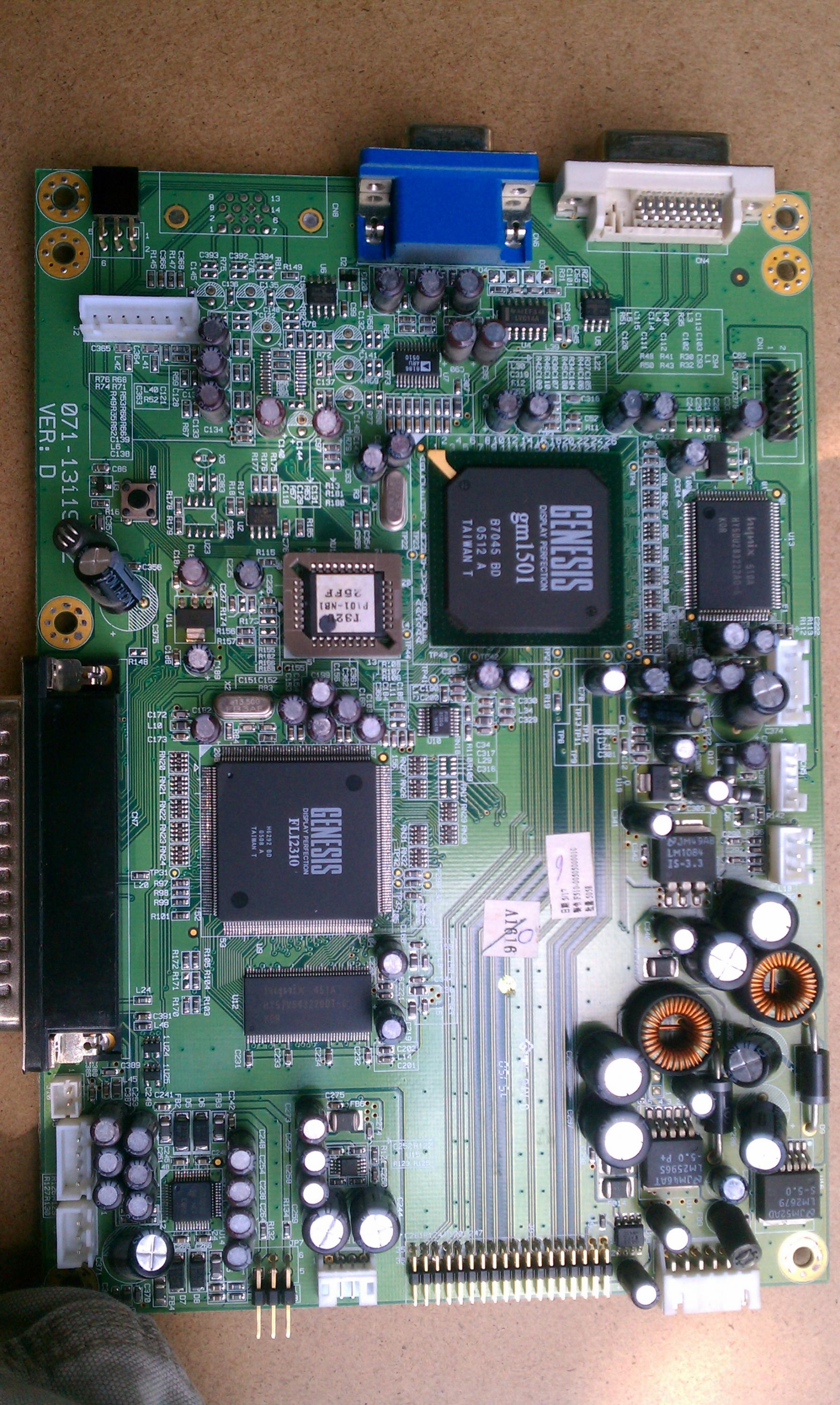

          Here is the main board.

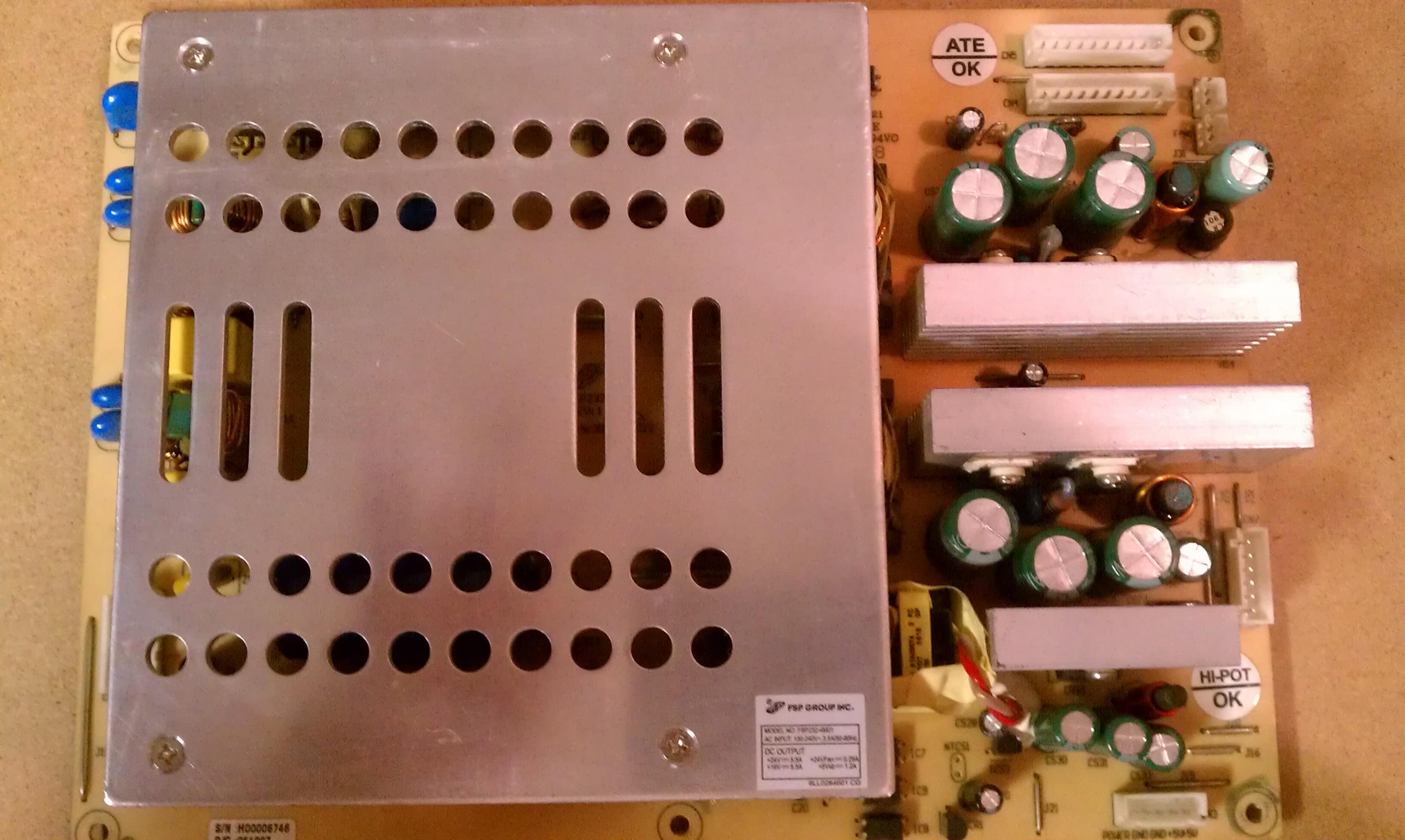

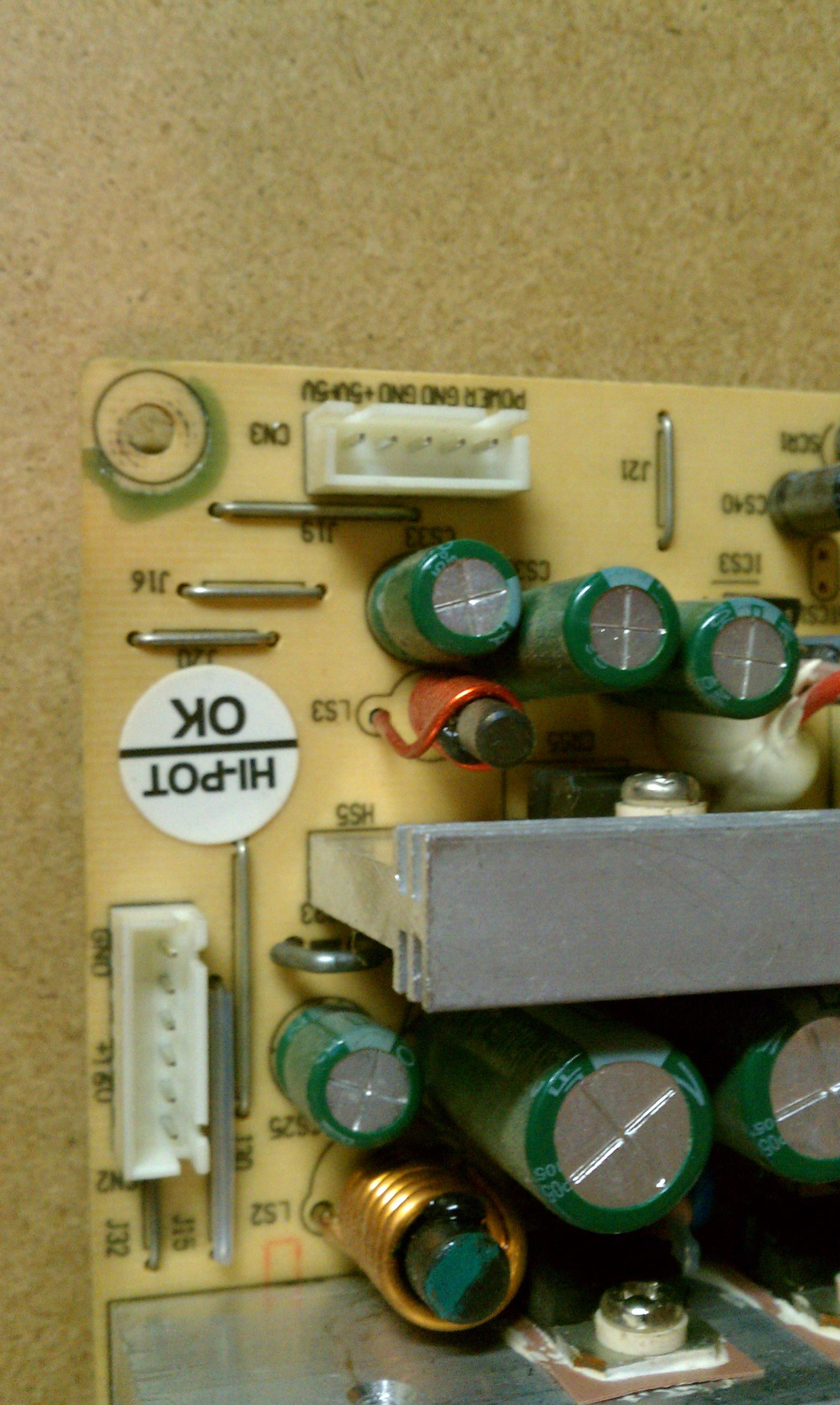

            Pictures of the Power supply board as a whole top and bottom, and close up of the connectors so we can see if they have any labels on them to identify the pin functions.
              Re: Protron PLTV-32c won't power on

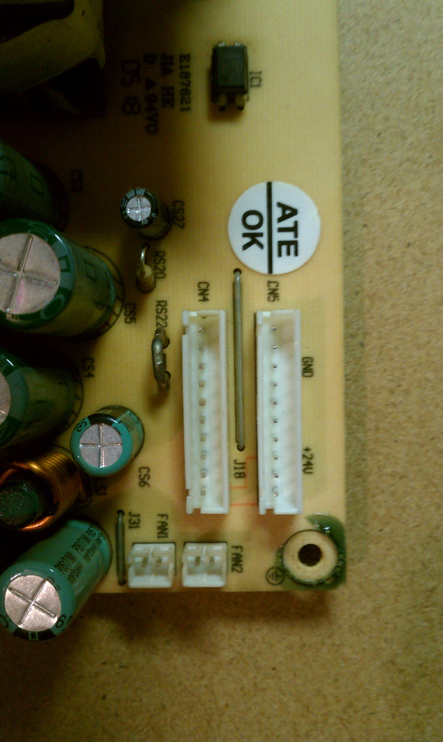

              Here is the Power Supply.
                OK, CN3 connector pin with the label 'POWER' is the Power supply on input signal sent from the Main board which will turn on the 16/24V power supply circuits, it should have more than 3VDC at that pin with ref to the chassis ground. See if it has that voltage.
                  I am getting 0 on that pin. I get 5v from the two 5v pins.
                    Well, that means the main board is not sending the signal to turn on the 16/24V power supply, without that, you will not have 24V to run the backlights (backlights inverter also need backlights on signal from the main board), or sound (16V is for sound).

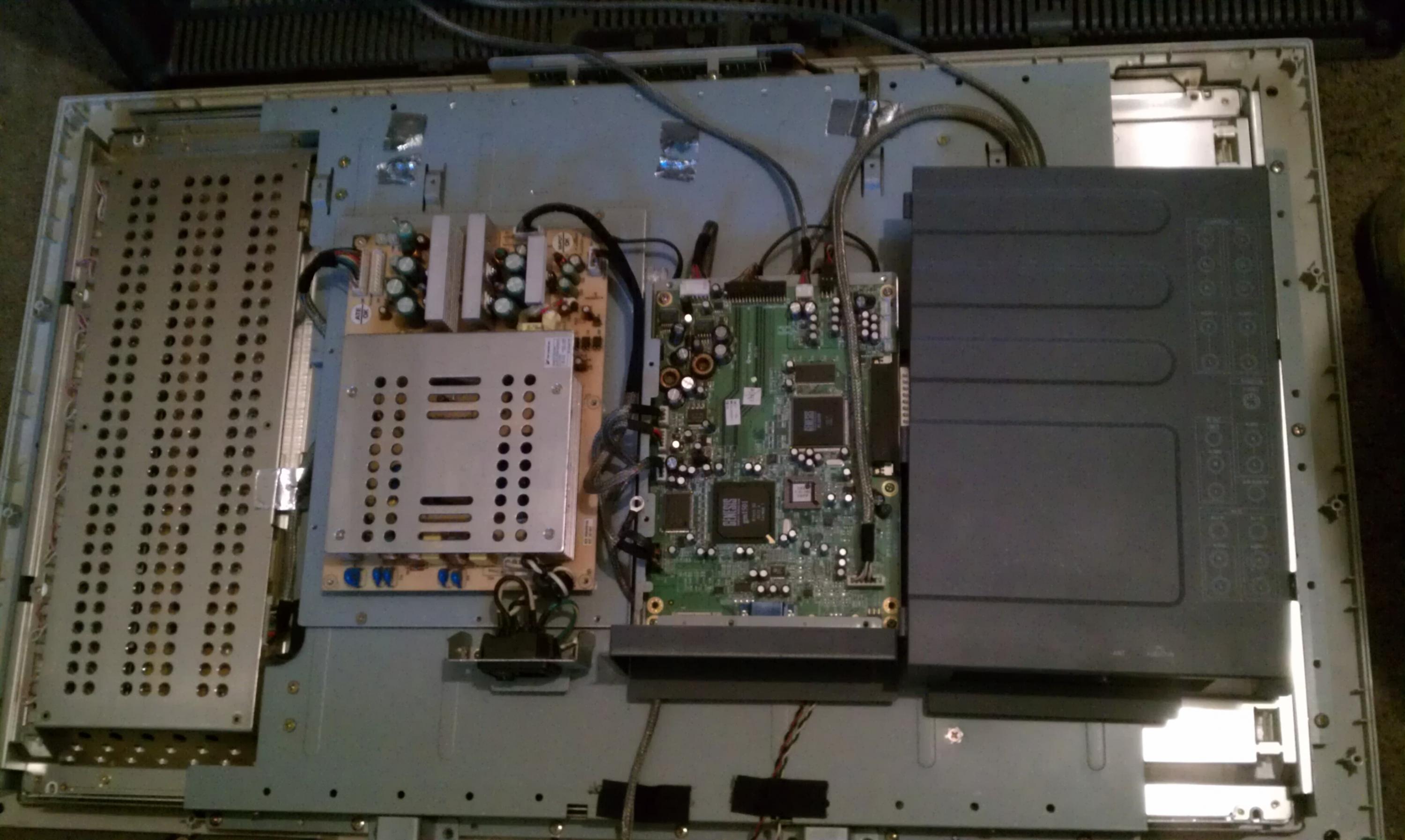

                    There are many regulator ICs on the main board. I need to see straight shot pictures of the main board.

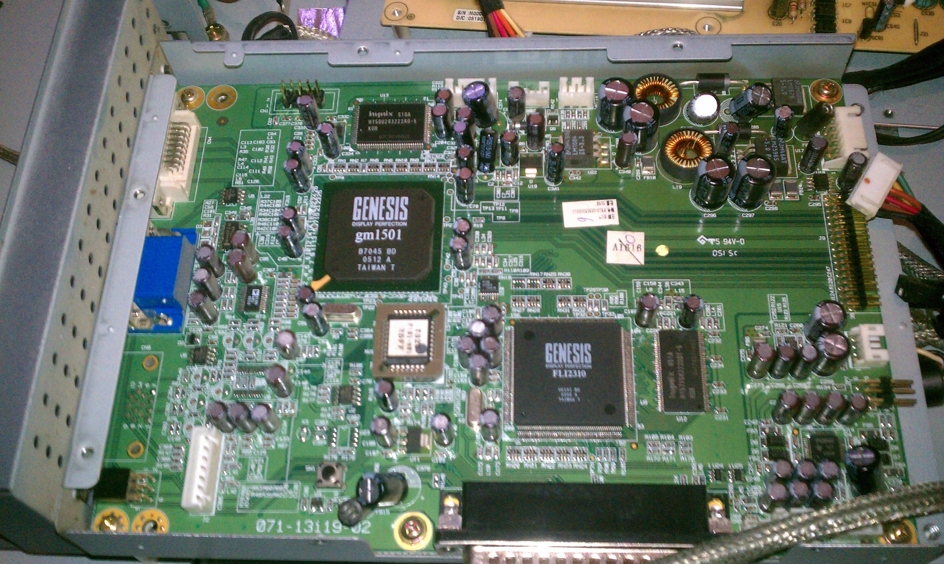

                    Can we also see the whole TV to see how all the boards are connected.

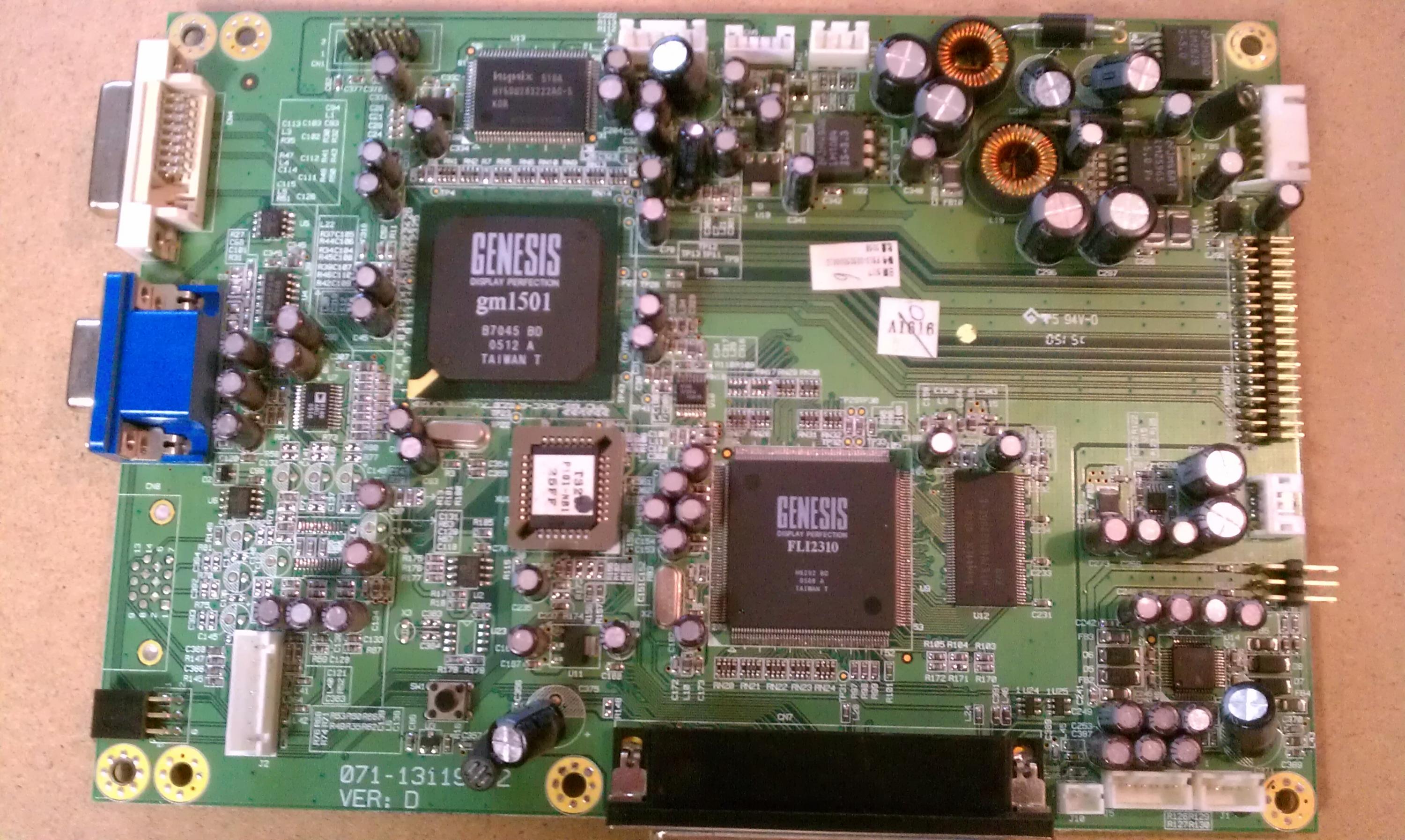

                      Here are some pics of the mainboard removed from the tv. On the pic of the whole tv, there is a gray box on the right. That is the tuner board. Just let me know if you think I need to take that out and get some pics of it too. If there is any specific parts of the main board that you need to see closer, just let me know. Thanks for you help!
                        Pictures are just not quite in focus - can you get them any clearer - good light
                        is the key. There re two brown blotches on the last picture - what is on the other side?

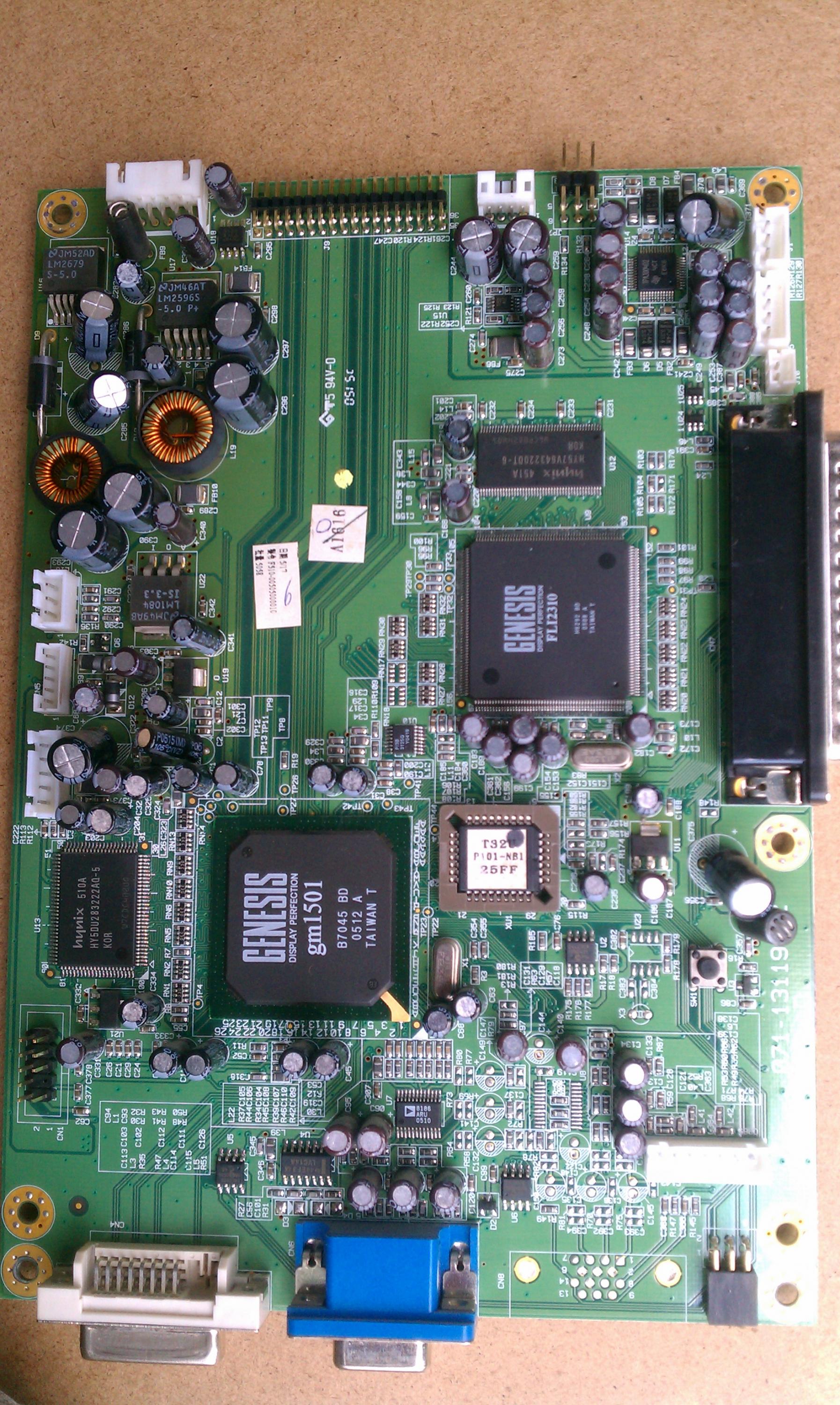

                            Here is some better pics. I took them outside to get better lighting.

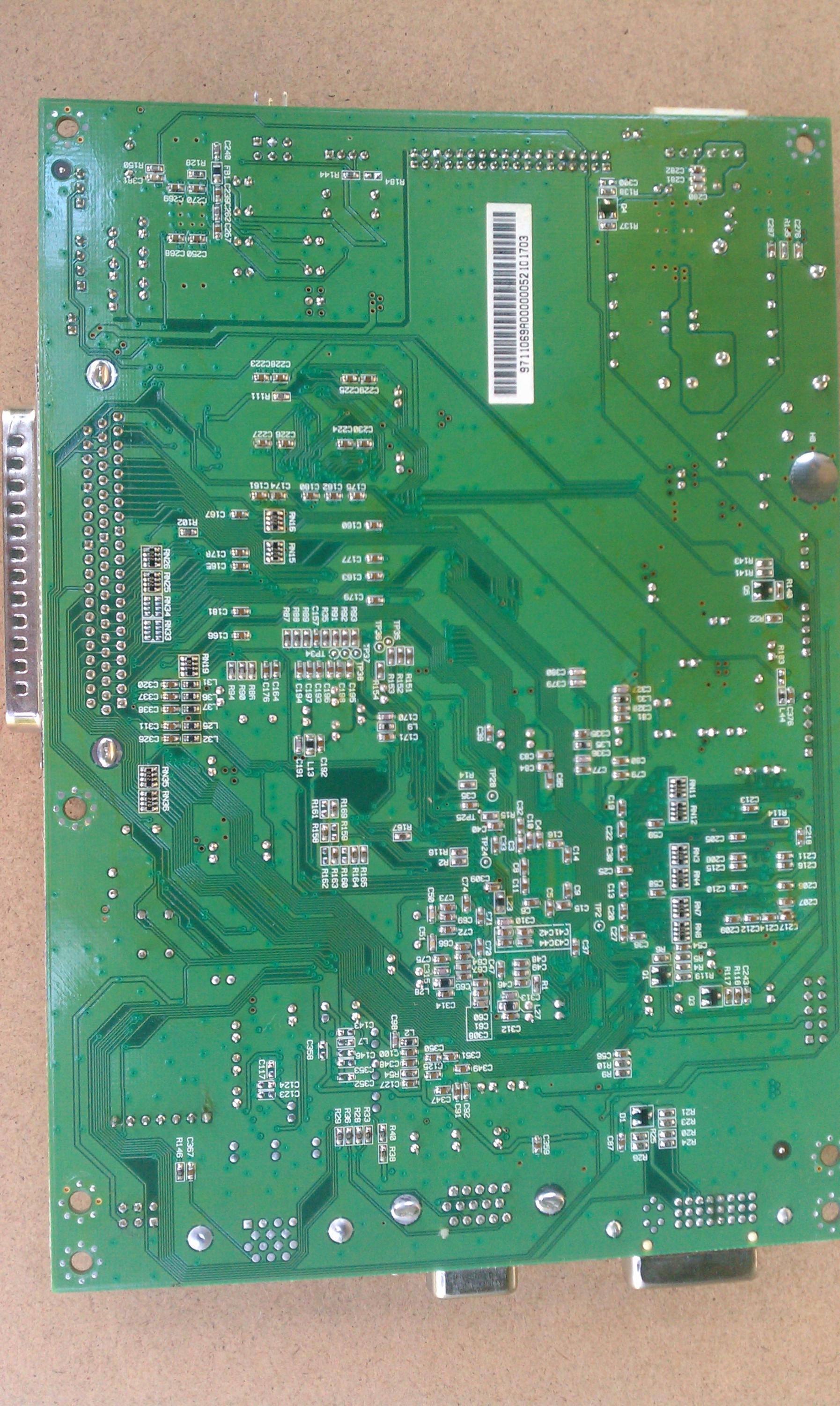

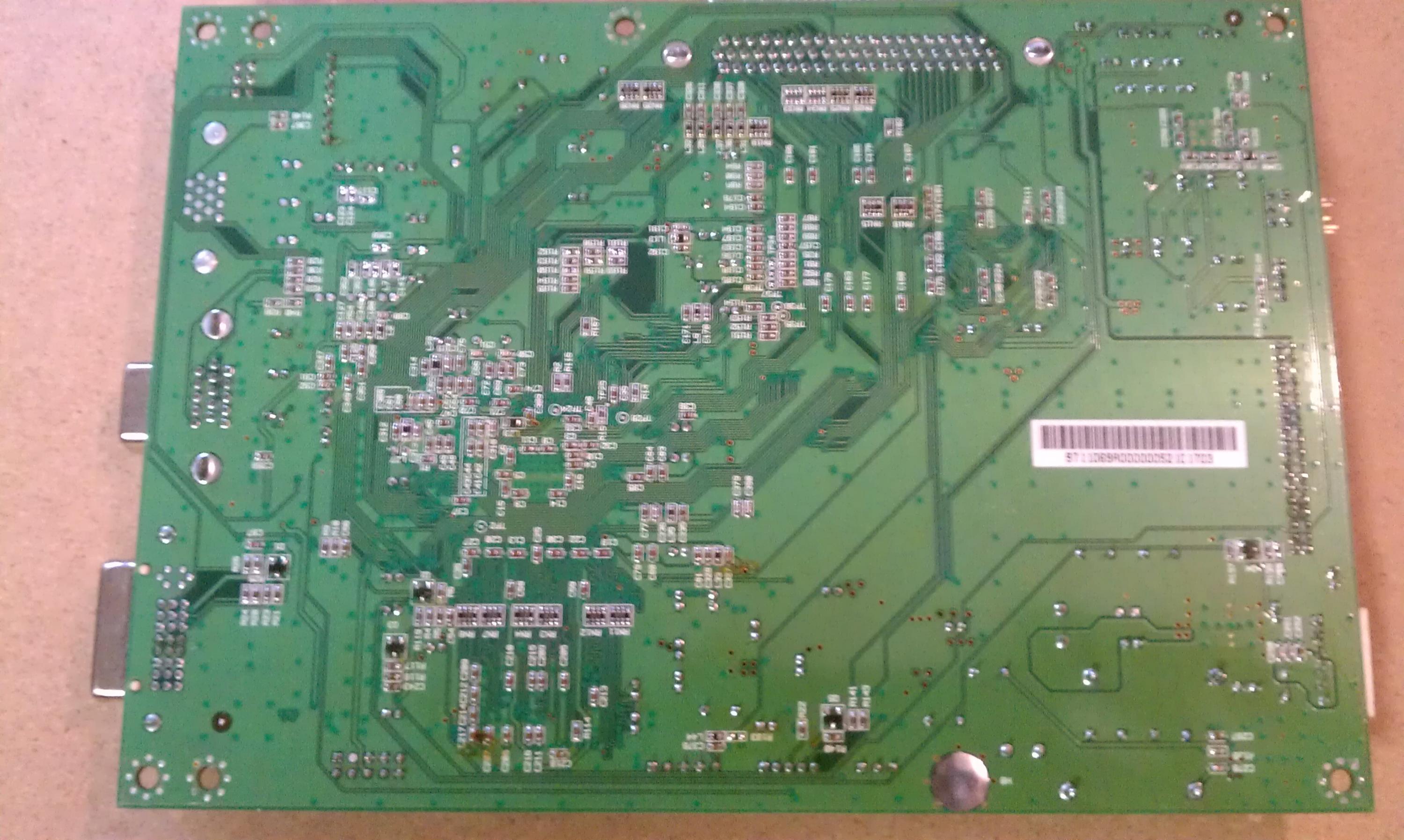

                              Ok its flux - but what is on the other side of the board
                                These circles are where the brown spots are on the back side of the board.
                                  Hmm - nothing there then. Picture is much better thanks - can you do the back as well
                                    Those are un-drilled or un-used holes on the pcb, quite common.
                                    Also don't scrap/pick, you can easily break traces.
                                    Focus on the task at hand, we need to find out why the signal board is not sending the PS-ON to the PSU.

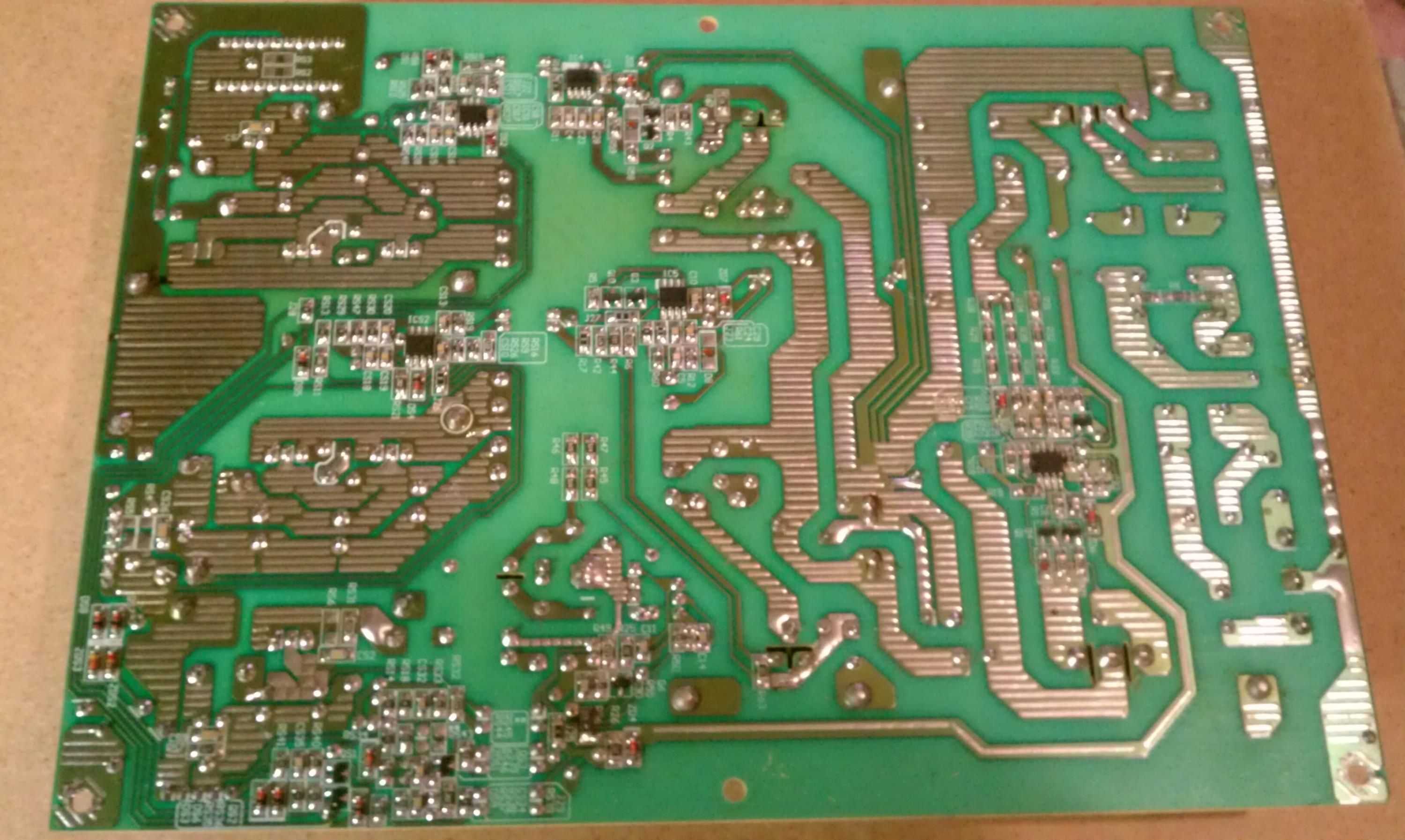

                                      Here's a better picture of the back.
