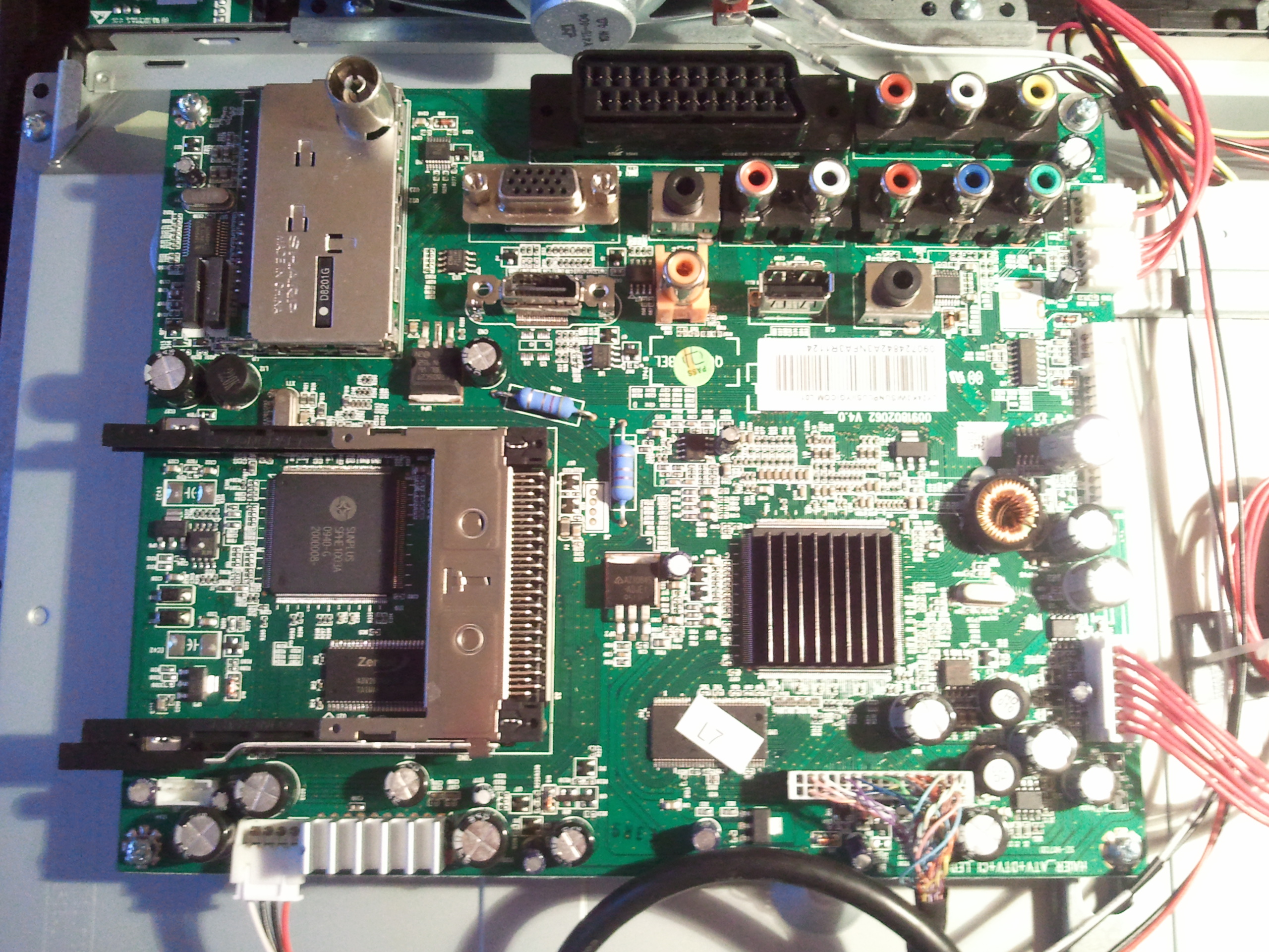

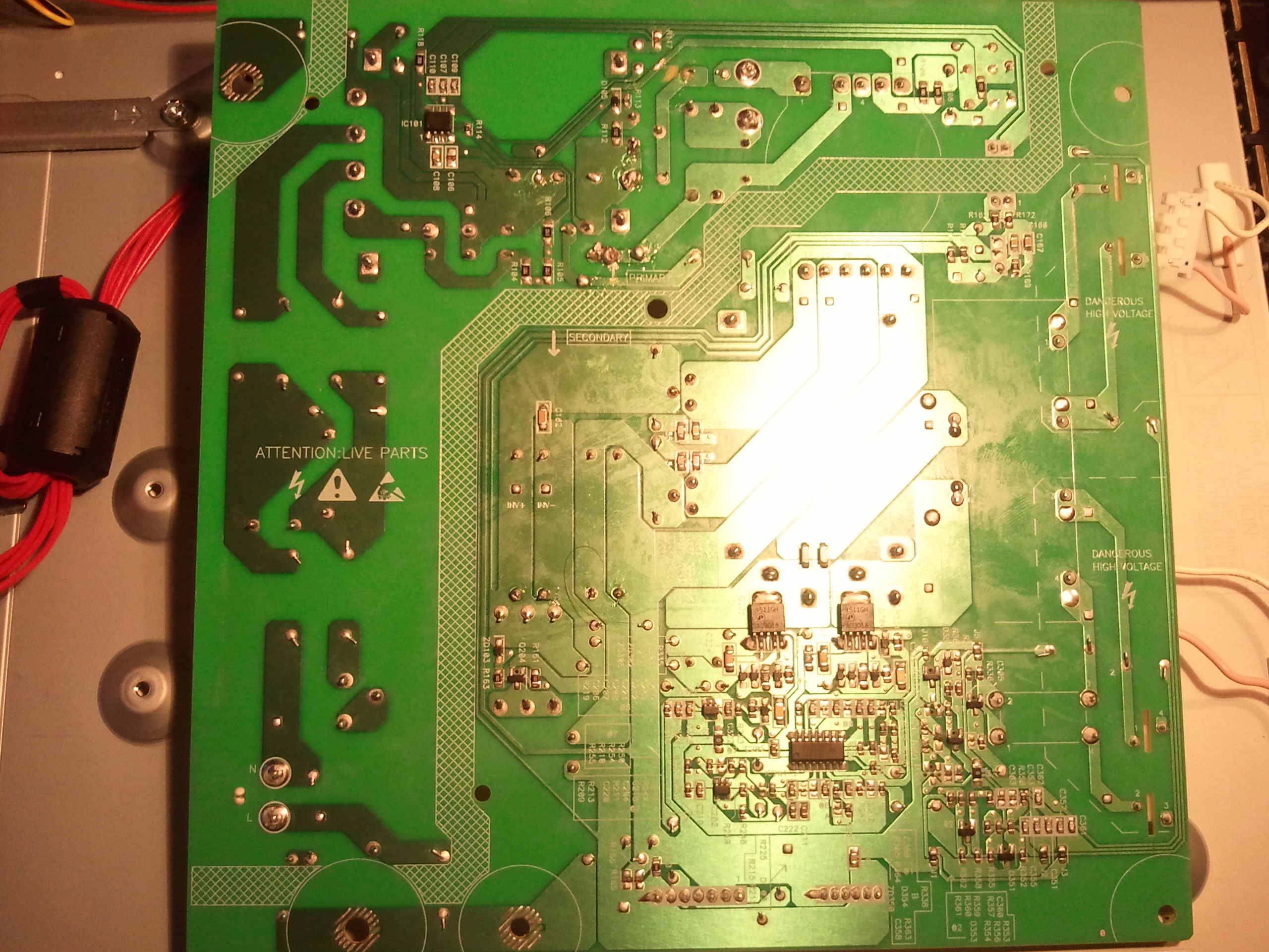

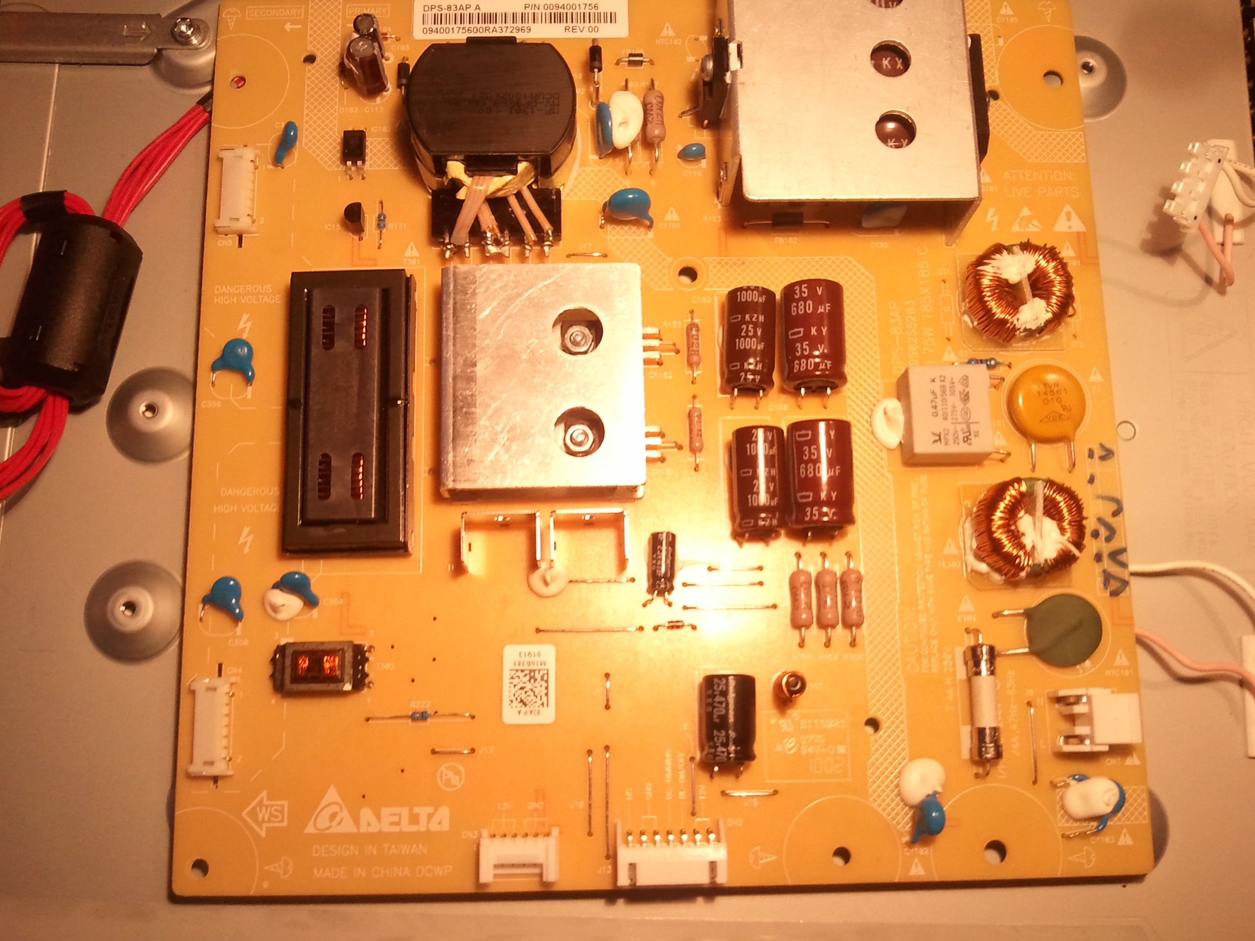

    As I said my knowledge is limited so I'm hoping one of you guys here would be able to point me in the right direction as to what to do next. Pics of both boards attached.

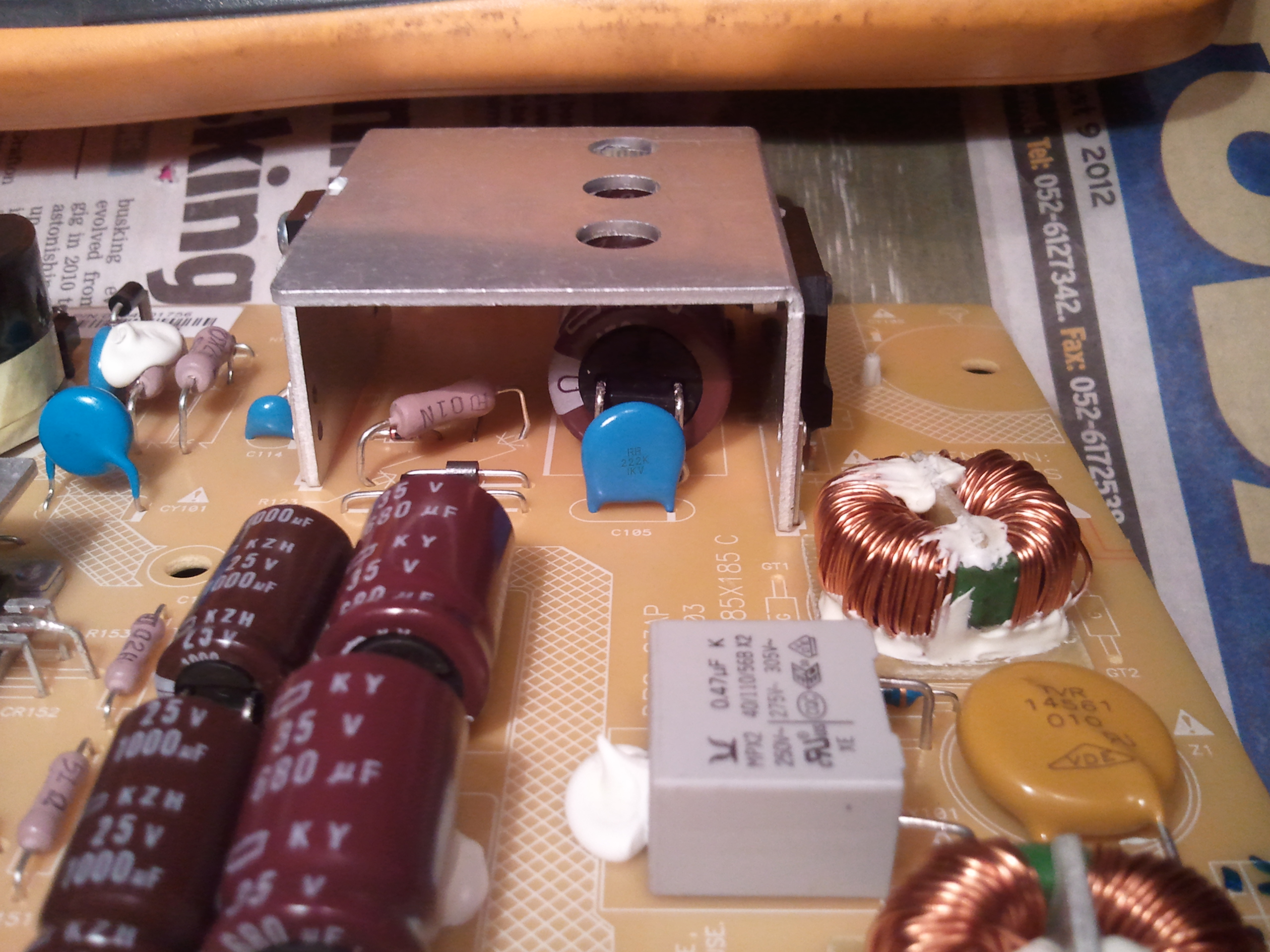

      My spatial mapping skills are weak at best, but underneath that top right hand corner heat shield might be an electrolytic cap in the 47uF 50V range that is your startup cap. It might be bad without visible signs of bloating. Since those caps are only around 33 cents, I would replace it first to rule out a bad cap. Use something like Panasonic FC series.

                  @retired caps - see attached pic of under heatshield. Looks like it says "RR 222K 1KV" printed on it . According to the ESR meter it's 0.26ohms. Does this sound ok or should I remove & test ooc or just replace regardless?

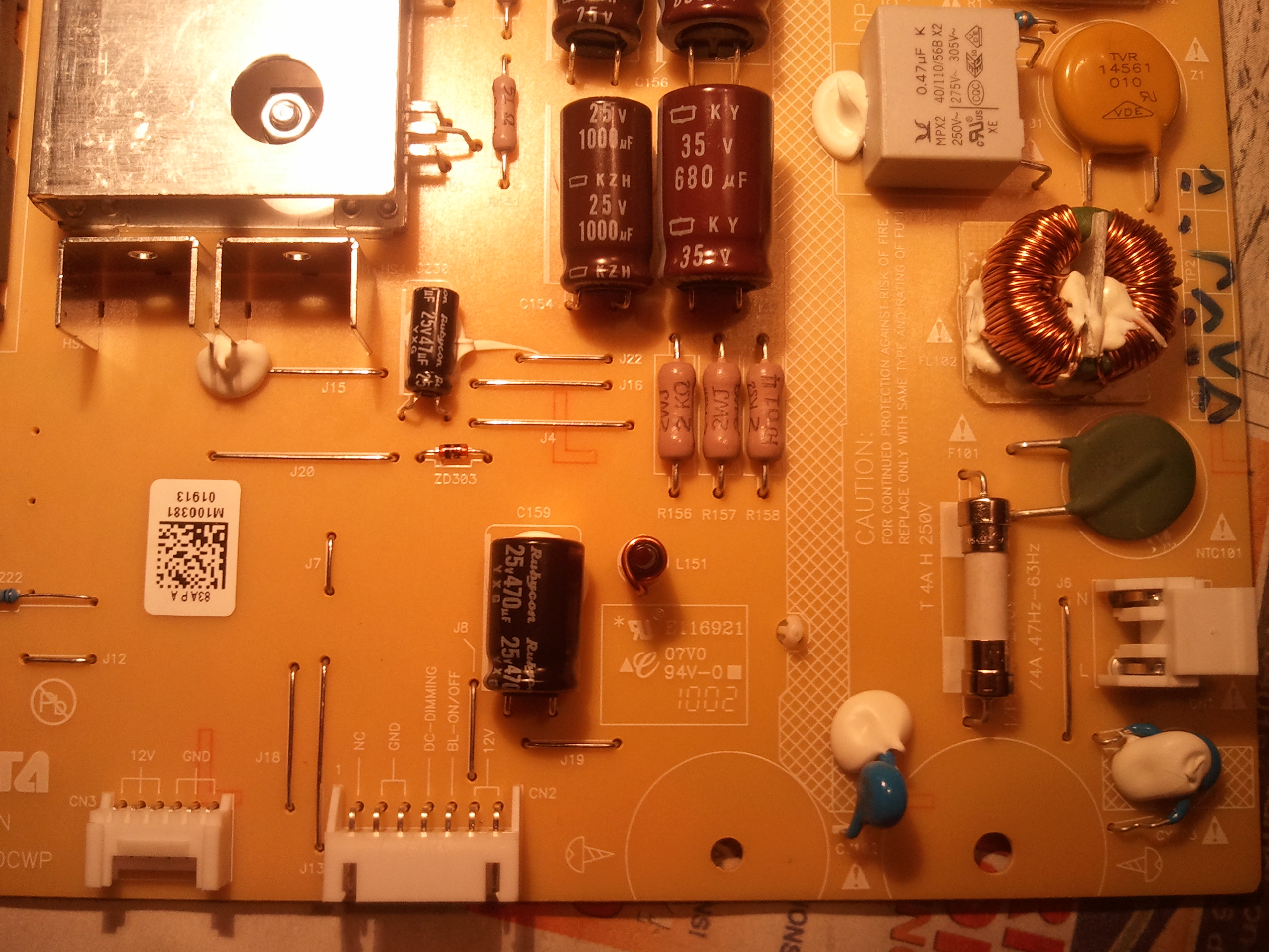

                    Can you post a pic of the power connector going to main board - of interest is the labels near it.
                      I dont think he meant that one - unless I have missed something - its a small electrolytic - perhaps its the one at C103

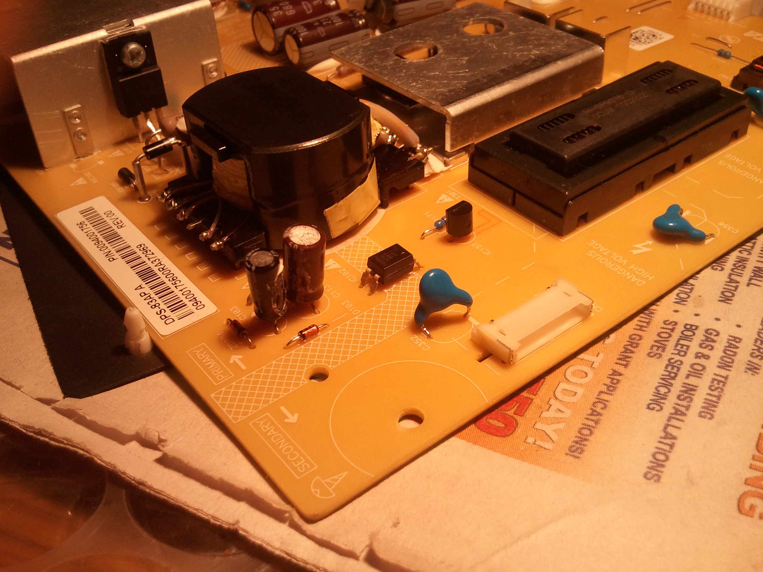

                        Just been looking at the bottom of the board maybe just the picture but a lot of the joints look a bit ringed. Perhaps resolder all the transformer joints?.
                          Re: Bush LCD TV no power *HELP!*
                          Pretty typical for Delta soldering to be excellent; the rings are support rings added for big heavy components, very nice touch to ensure long term reliability.

                            @retiredcaps - Attached is more cap pics, C103 & C113. Hopefully these are the ones you are referring to.
                            C103: 10uF 50V - Readings: 9.32uF, ESR: 0.50
                            C113: 33uF 50V - Readings: 36.66uF, ESR: 0.06
                            @tom66 - Attached pics as requested.
                            Anymore info needed let me know.
                            Cheers guys!
                              OK, do you get good 12V at the pin marked 12V? Looks like this PSU only has a single 12V output and no standby mode, pretty typical for a small 24".

                                        Ok guys bit of an update. Examined the board again & found a small crack on one of the tracks in the primary side, so rubbed it down to expose copper & joined with a bit of solder. Plugged mains back in & it powered up!
                                        So any recommendations for a broken track? A bit of solder joint enough or would a bit of resistor wire be better for the job?
