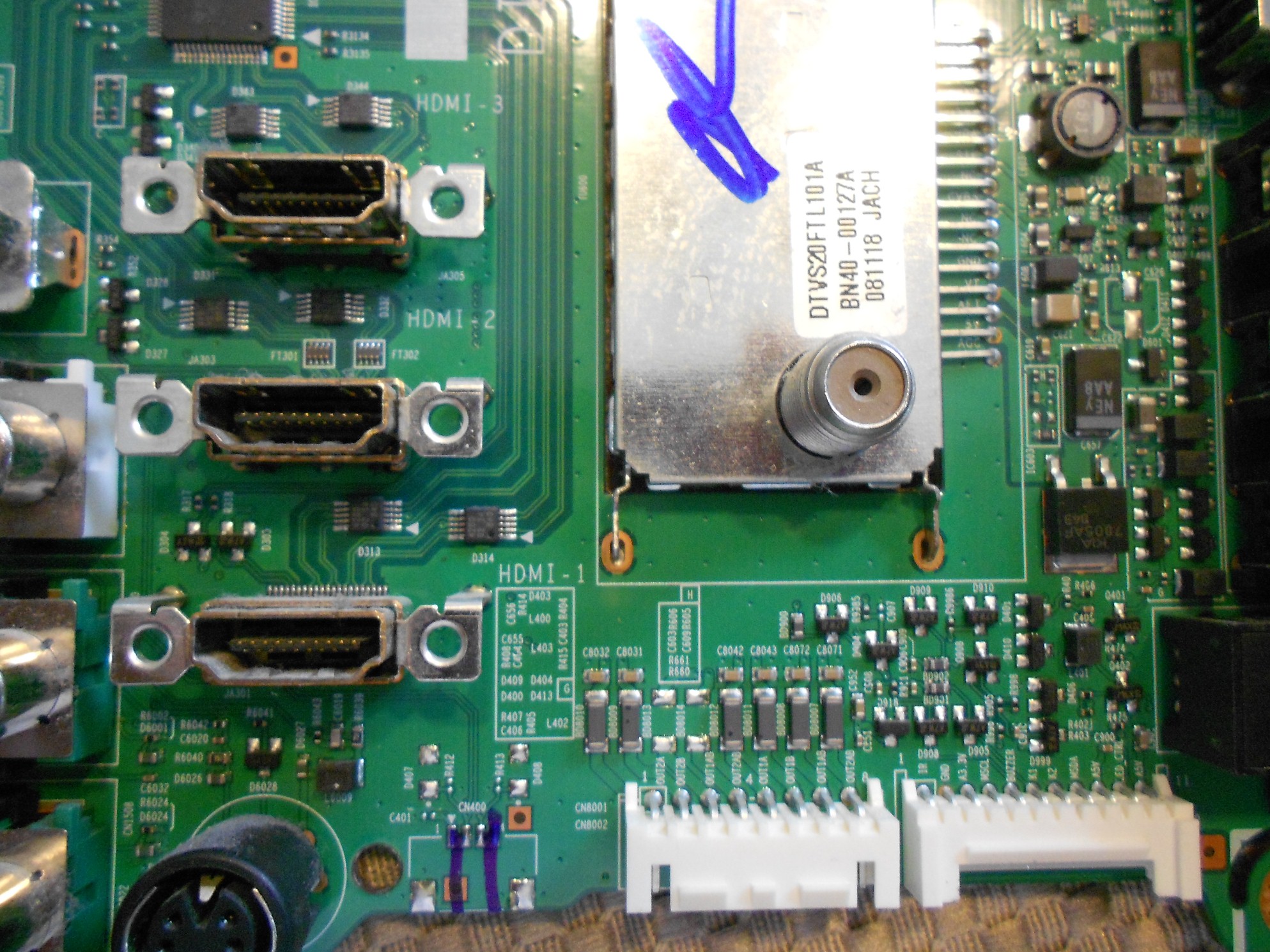

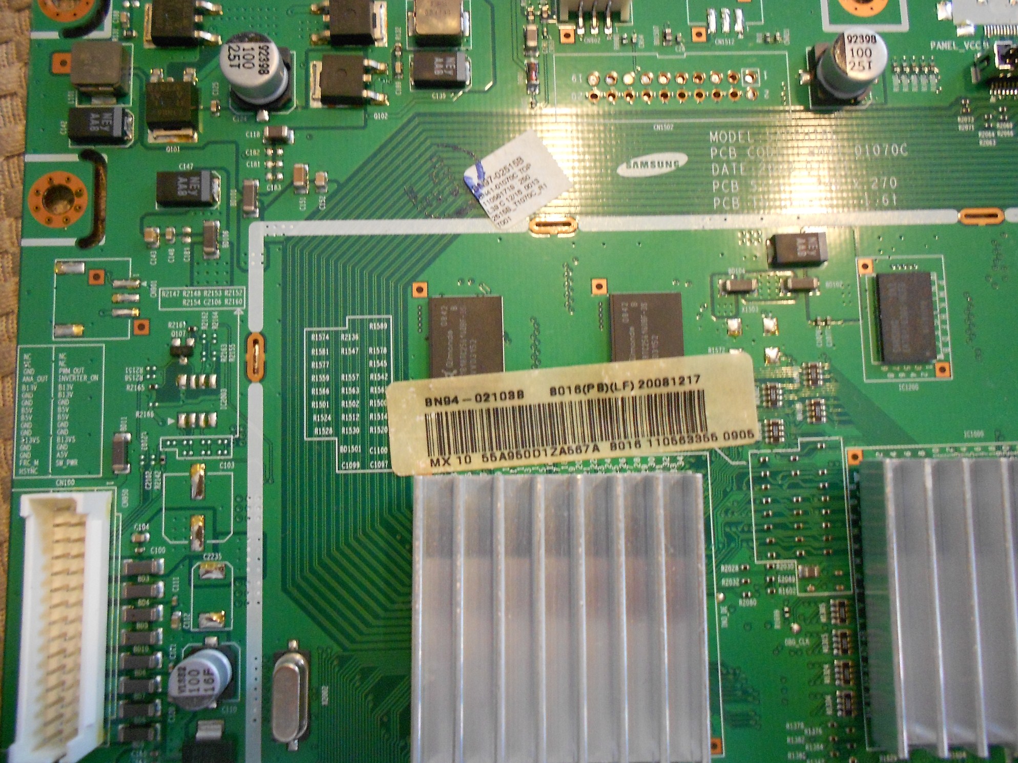

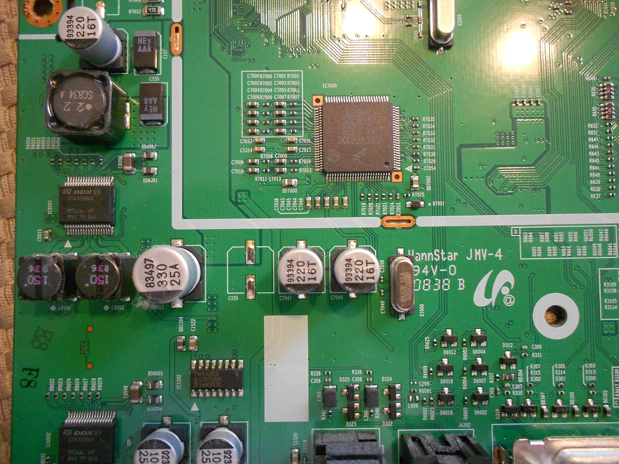

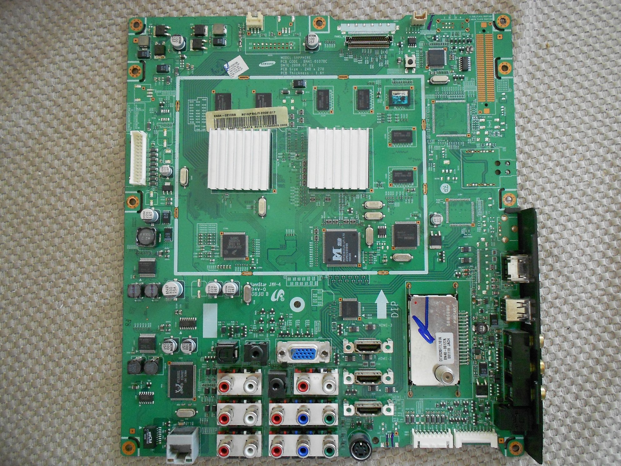

        Re: Samsung LN55A950D1FXZA Black Screen

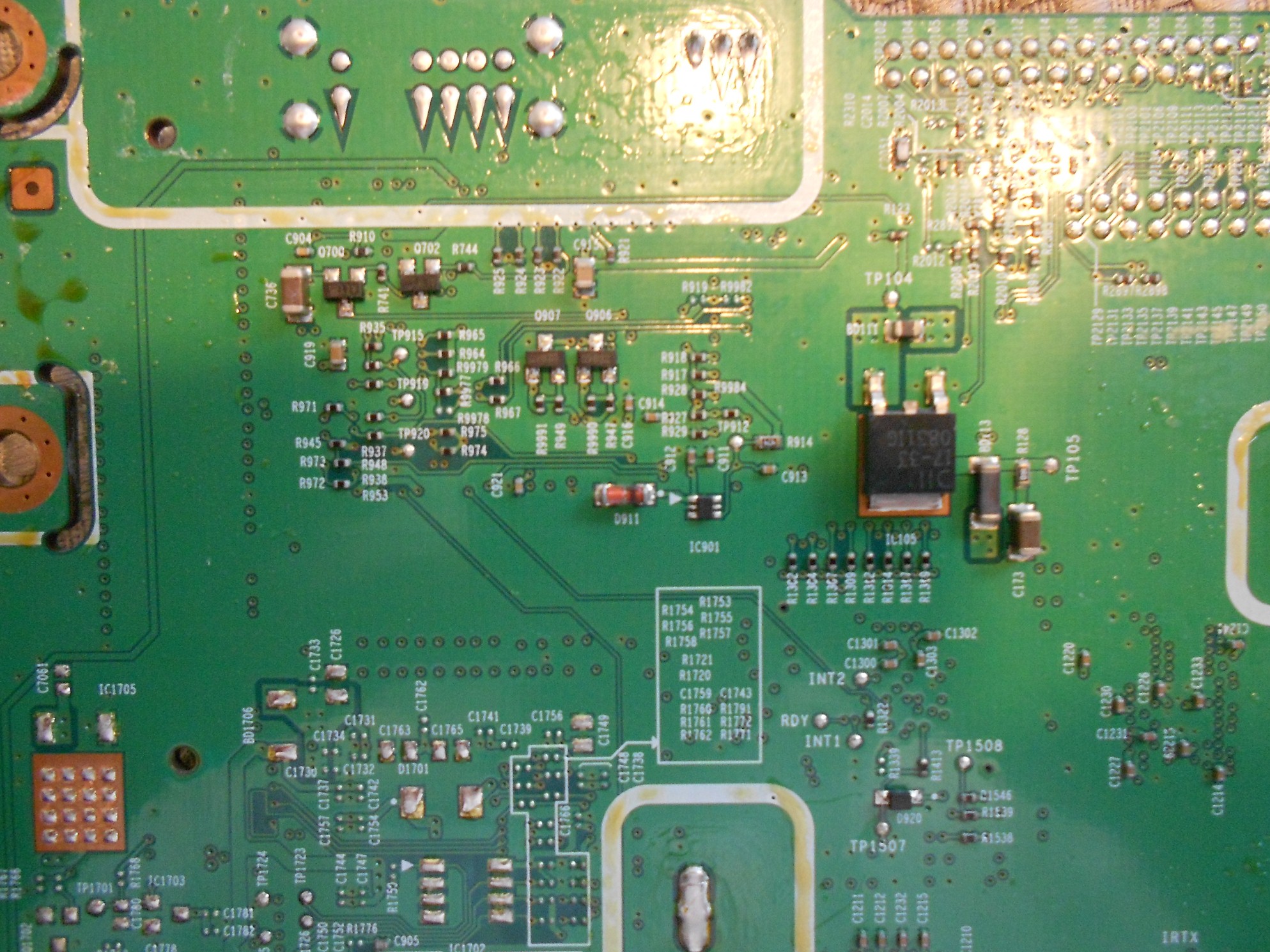

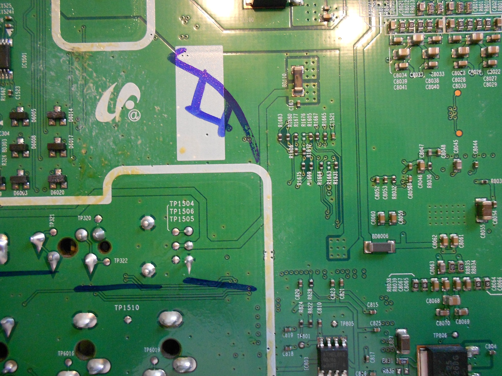

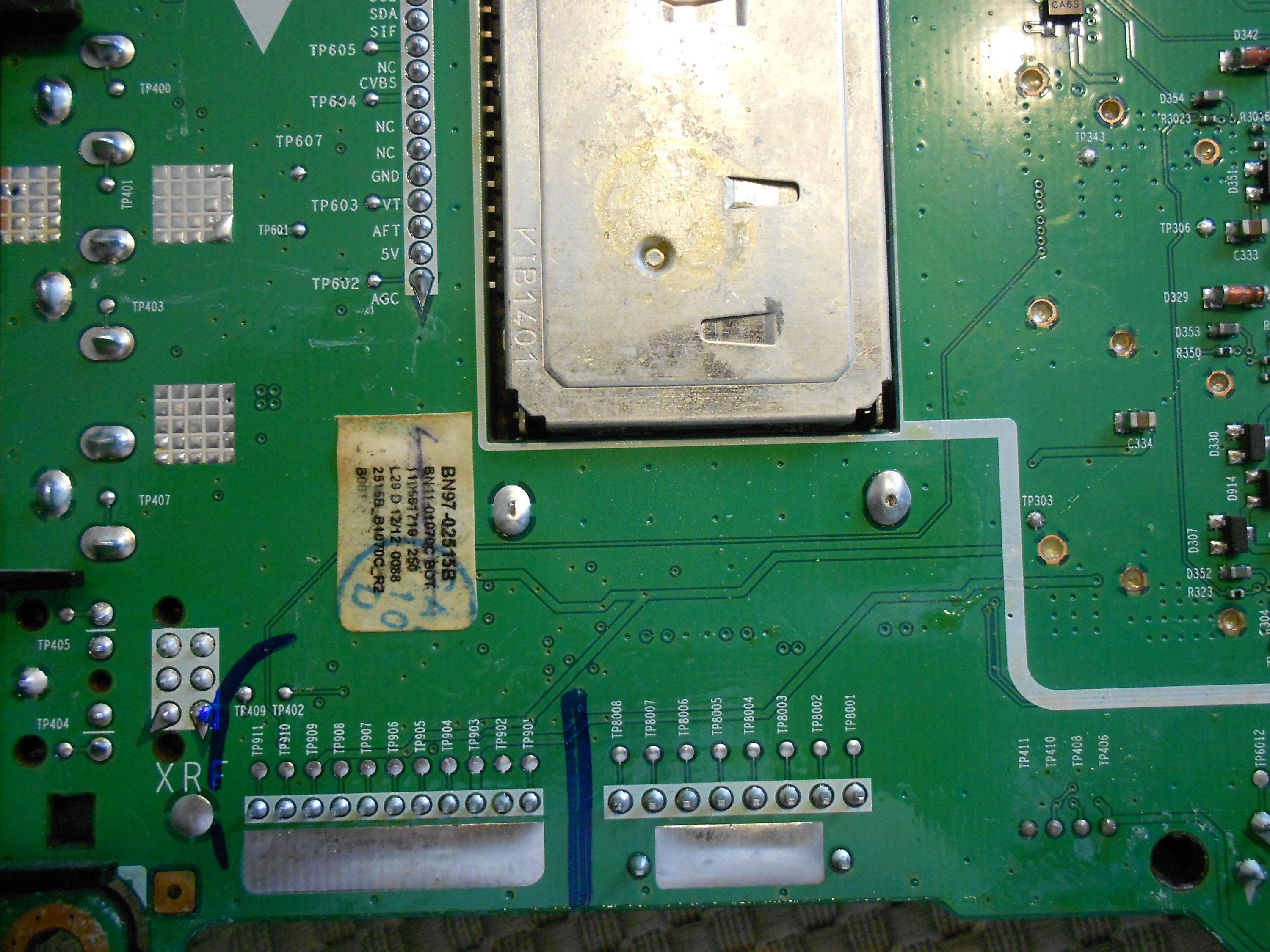

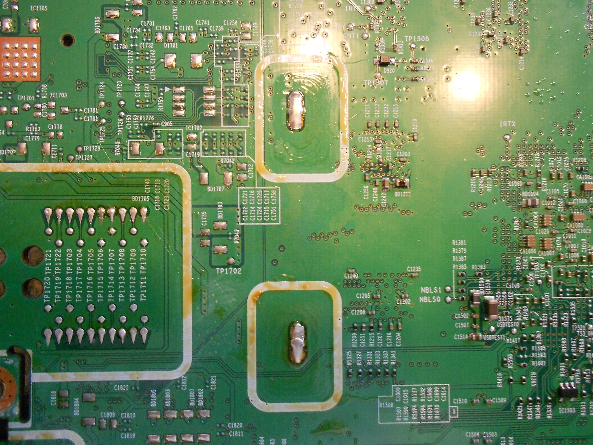

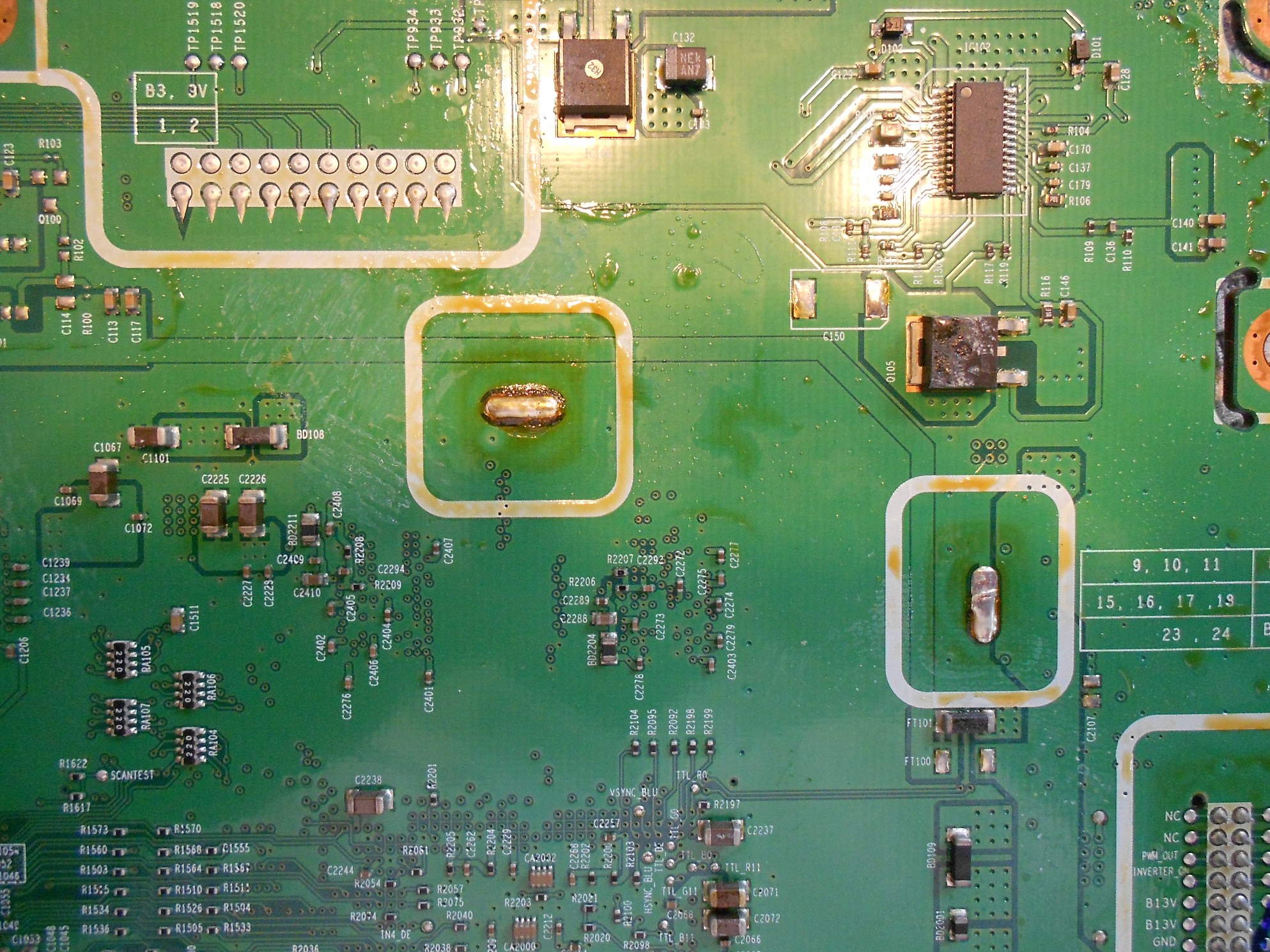

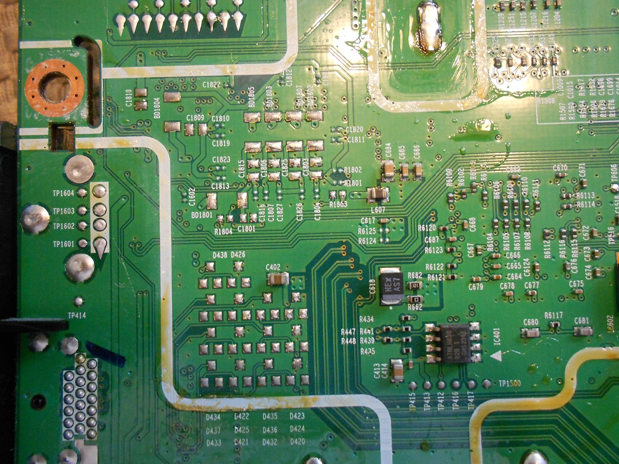

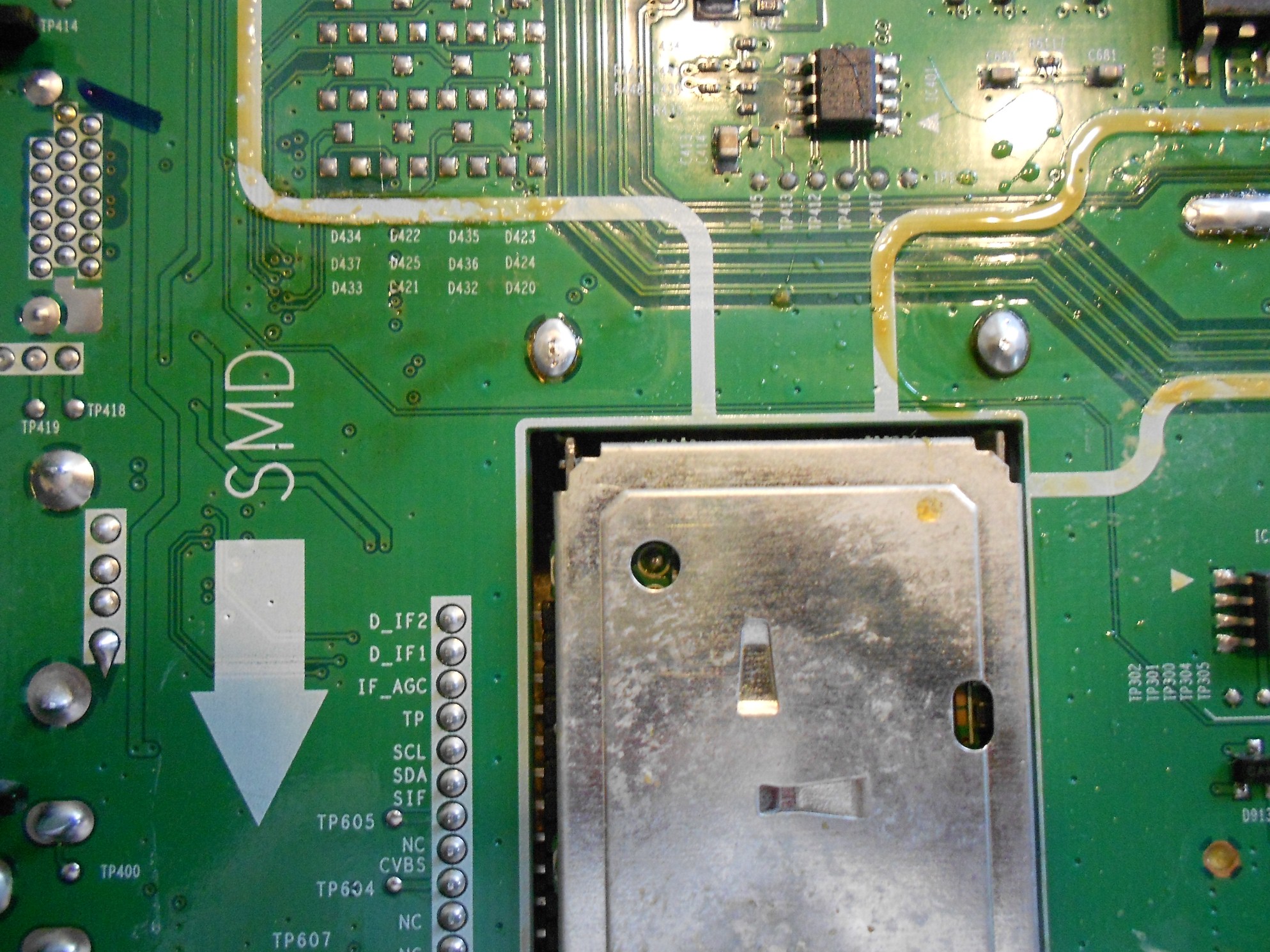

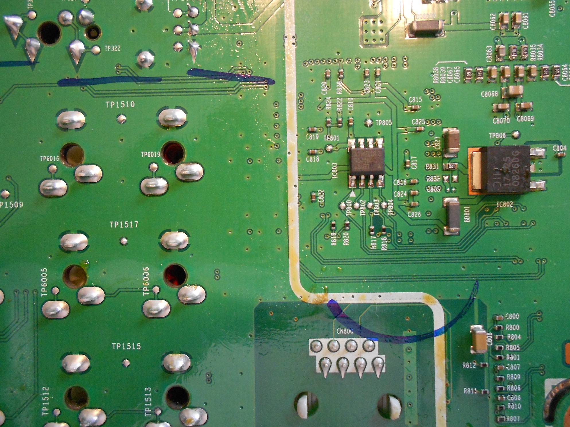

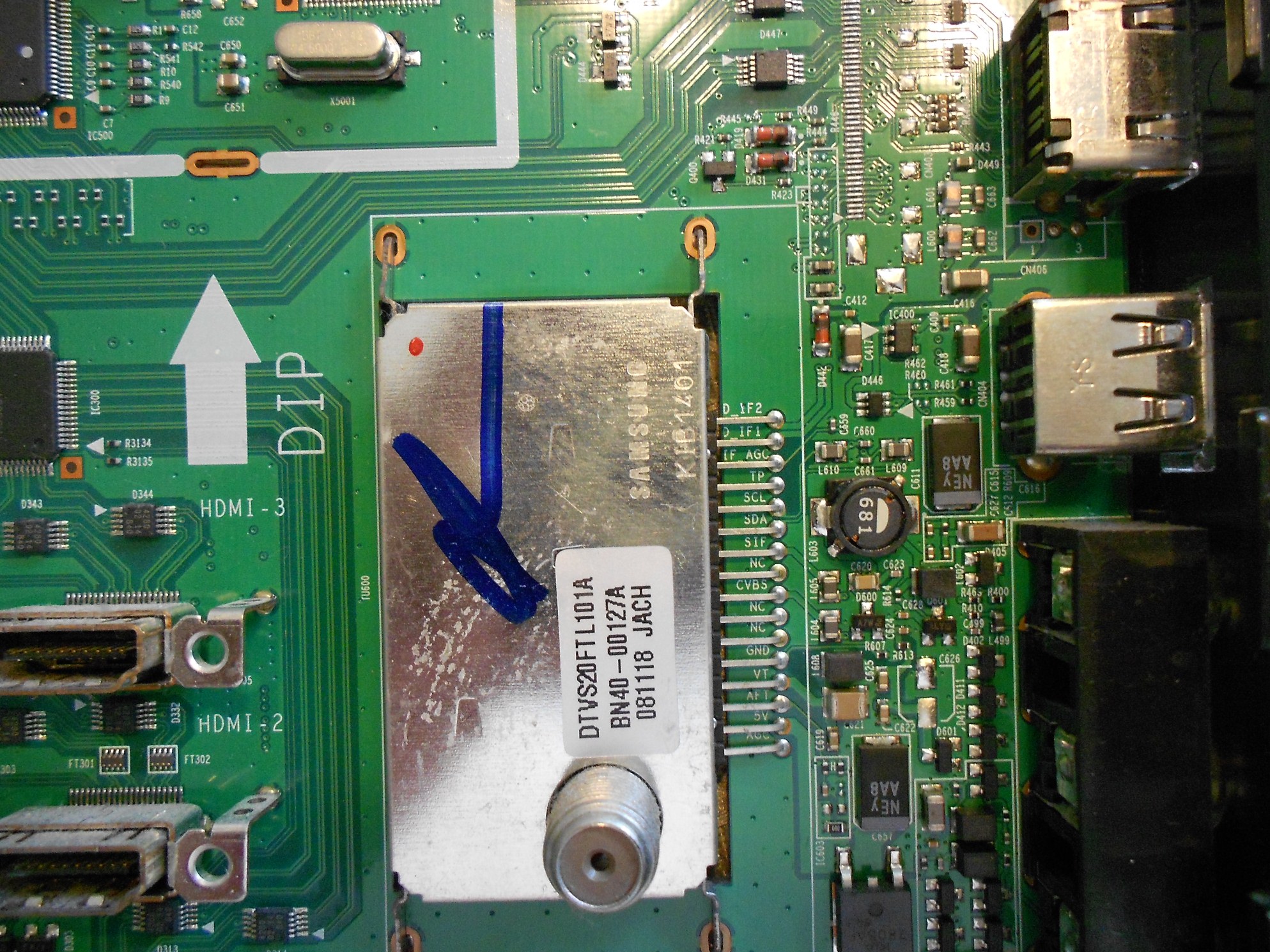

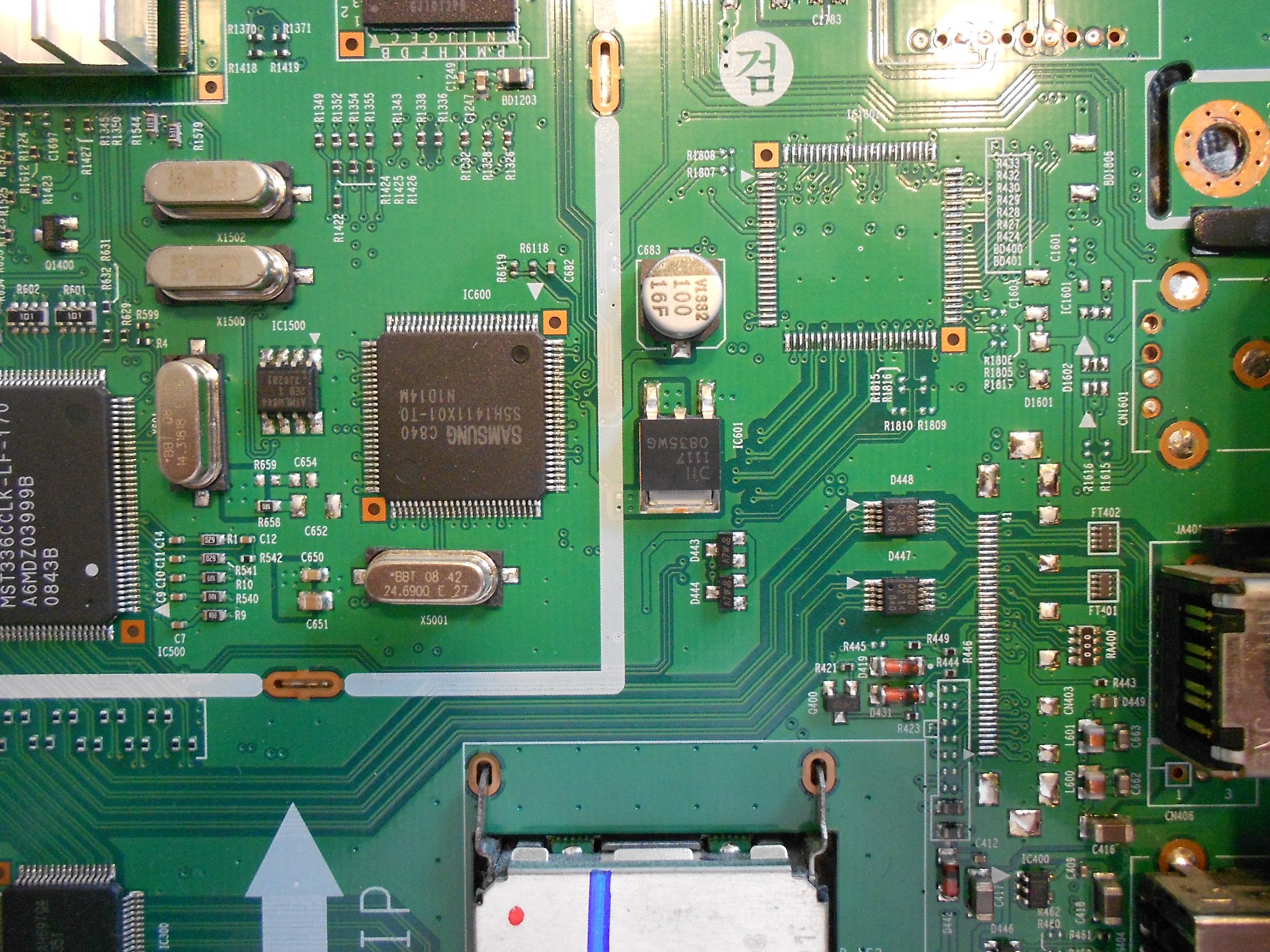

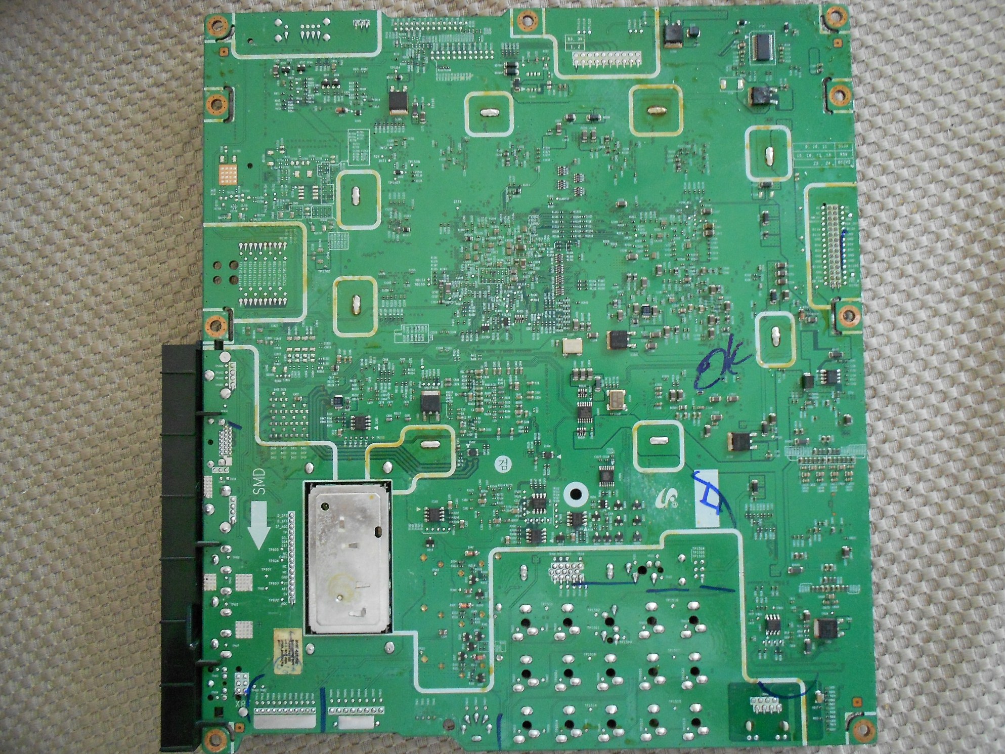

        Well the Dim Board was a bust, Included are pictures of the front and back of the main Board. Please help me Diagnose the board.
        • selldoor
          Slow Learner
          • Dec 2010
          • 7870
          Pics are not quite clear enough for trouble shooting - can you try and do them again
          -try half a board side at a time. Looks like many regulators. Couple of things - back of the board top right- two components with 2 and half legs look burnt - are they? can you read the part numbers?
          Front of the board the component with the Blued label has abrown spot on it - is it burnt?

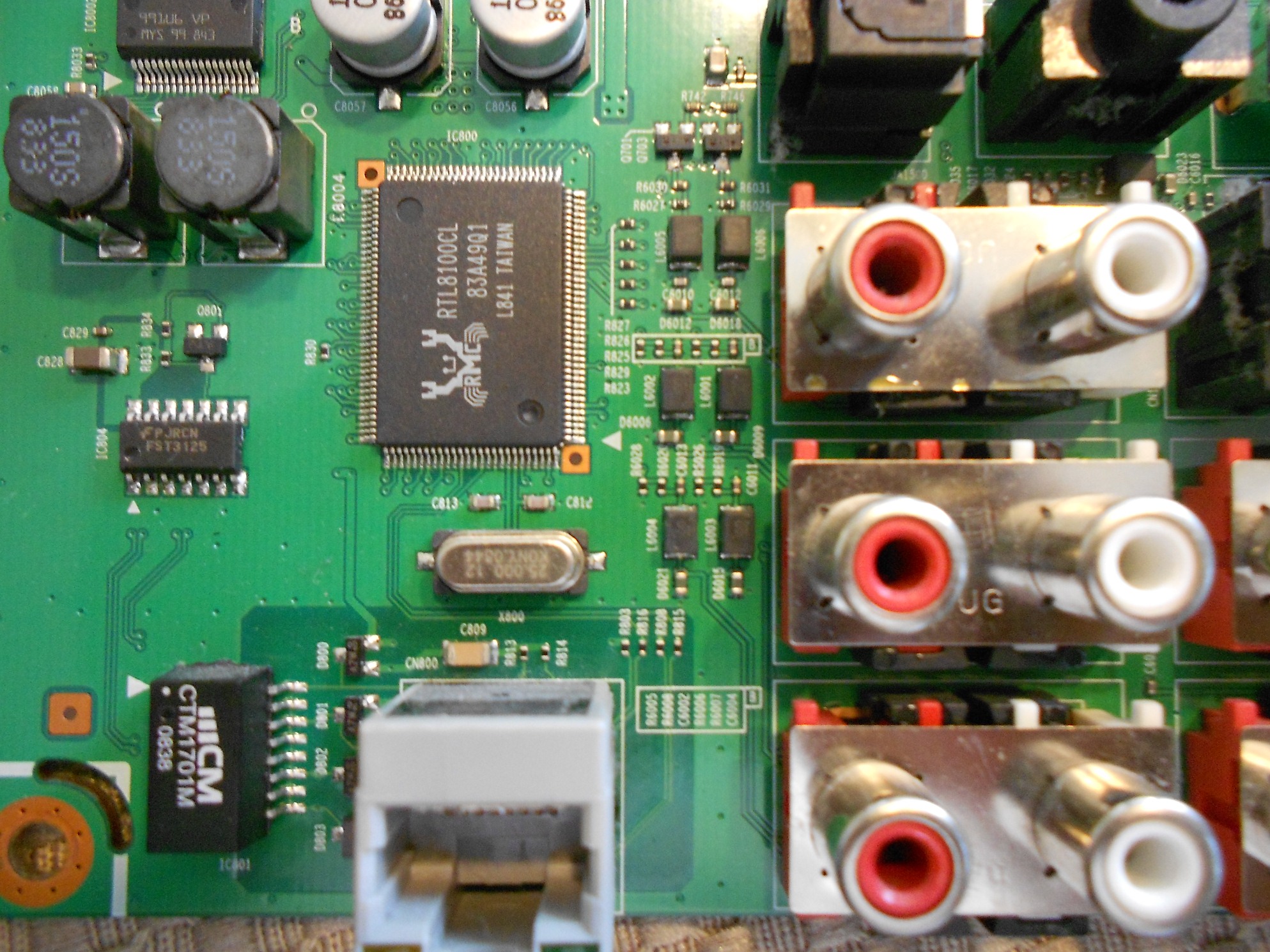

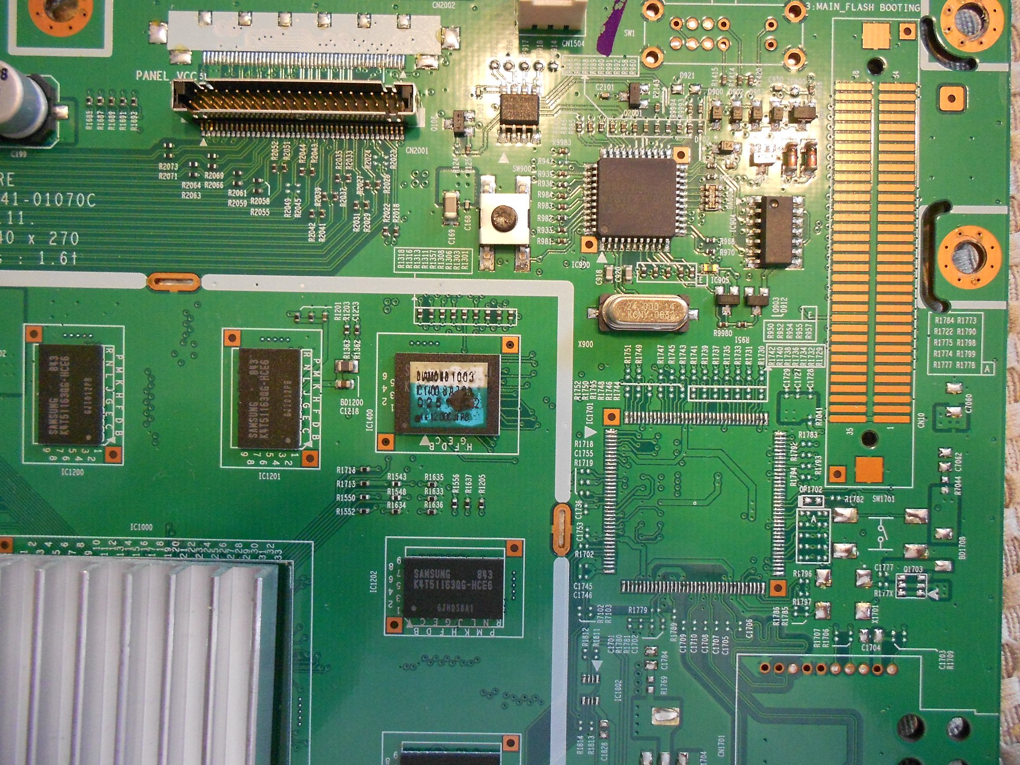

                They do not look burnt to my untrained eye, but how do I test them? Included are more pictures.

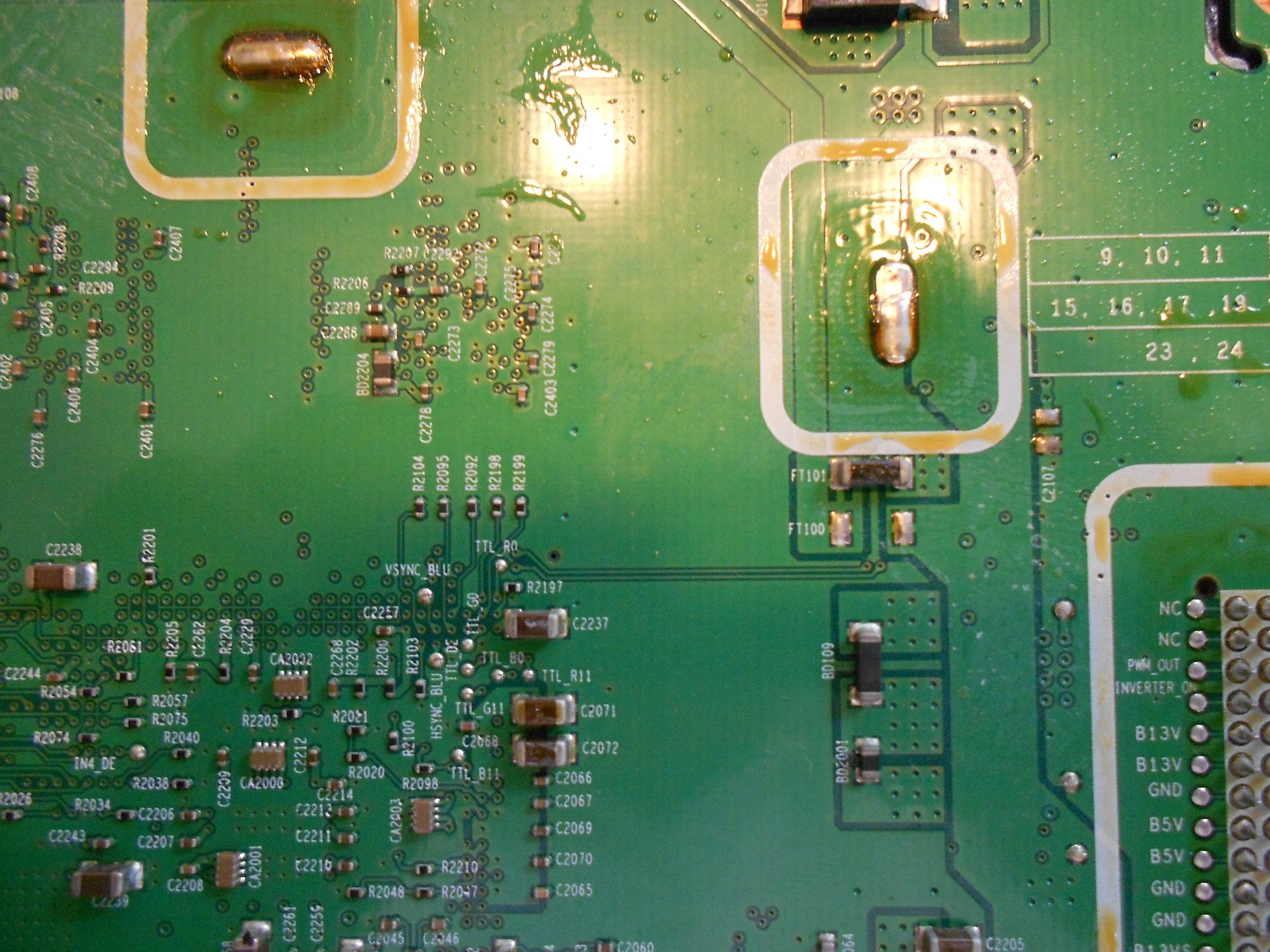

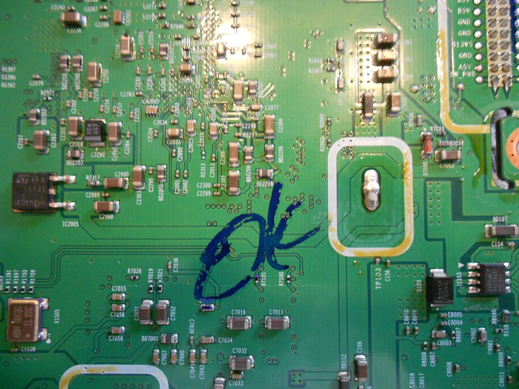

                    Rear Pics.

                      Forgot Two Pics

                        Hi - its getting late over here - will examine pics tomorrow - is that a reset switch I see and can you look again at Q105 - still looks burnt to me - can you clean it up with some isopropyl alcohol and see if you can read the part no with a magnifying glass
                        • Optix
                          • Aug 2012
                          • 7
                          • US
                          I cleaned it with alcohol and the part number i beleive is 19P06? Also has a number of T86B. How can I test to see if it is burned? The one corner looks a little funky, but not sure that it looks burnt.
                          • selldoor
                            Slow Learner
                            • Dec 2010
                            • 7870
                            19P06 is a mosfet
                            Test as here
                            Mosfets
                            If you have a manual range multimeter, set it to 200 ohms (two hundred). This is for 3 pin ICs only. You can test a mosfet (Q, IC designation) "in circuit" by (power off and unplugged)
                            a) black on pin 1- red on pin 2 - record ohms
                            b) black on pin 1- red on pin 3 - record ohms
                            c) black on pin 2- red on pin 3 - record ohms
                            If any reading is less than 30 ohms you might have shorted mosfet. Remove from circuit and repeat the tests to verify.
                            Some mosfets are more than 3 pins. To test those, identify the part number and search for its datasheet. Once you find the datasheet, the pins will be designated source (S), gate (G), and drain (D). It will probably be documented as S1, S2, G1, G2, D1, D2.
                            Simply test
                            a) black on pin S1- red on pin G1 - record ohms
                            b) black on pin S1- red on pin D1 - record ohms
                            c) black on pin G1- red on pin D1 - record ohms
                            Repeat for the "2" pins. That is S2-G2, S2-D2, G2-D2.
                            Note: a shorted mosfet would likely cause a very brief flash of the backlight or no backlight.
                            (From Retiredcaps guide)
