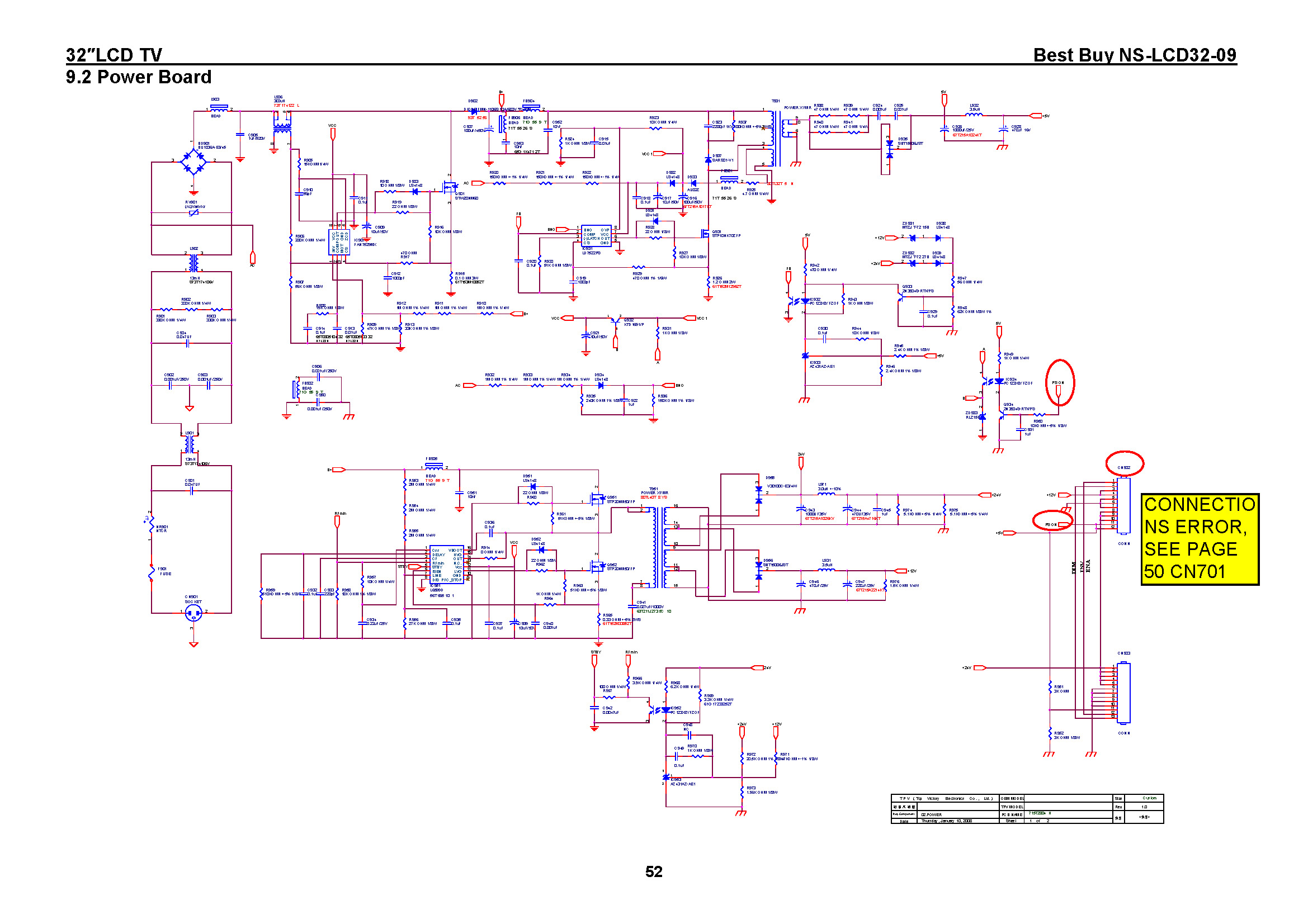

                    When it goes off, see if the 12V and 24V go away, these two voltages are turn on by the PS_ON signal as shown in the diagram. See if the PS_ON also goes away. See page 52 of the service manual.

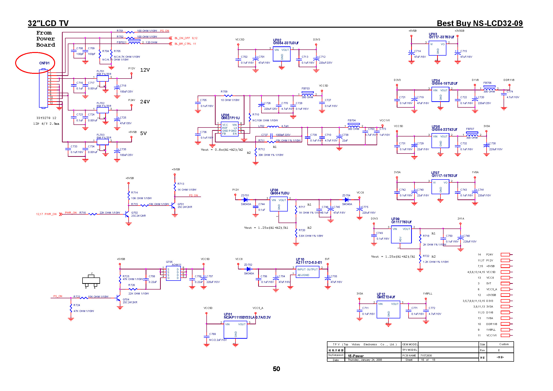

                    Please note that there is error on how CN902 is labeled and connected on page52. See page 50 at CN701 for correct pin out.

                                Also, I checked the PS_ON, per the schematic. When the unit turns itself off, the voltage drops off for PS_ON pinout as well. It falls to .059 volts and is steady. Let me know what's next.
