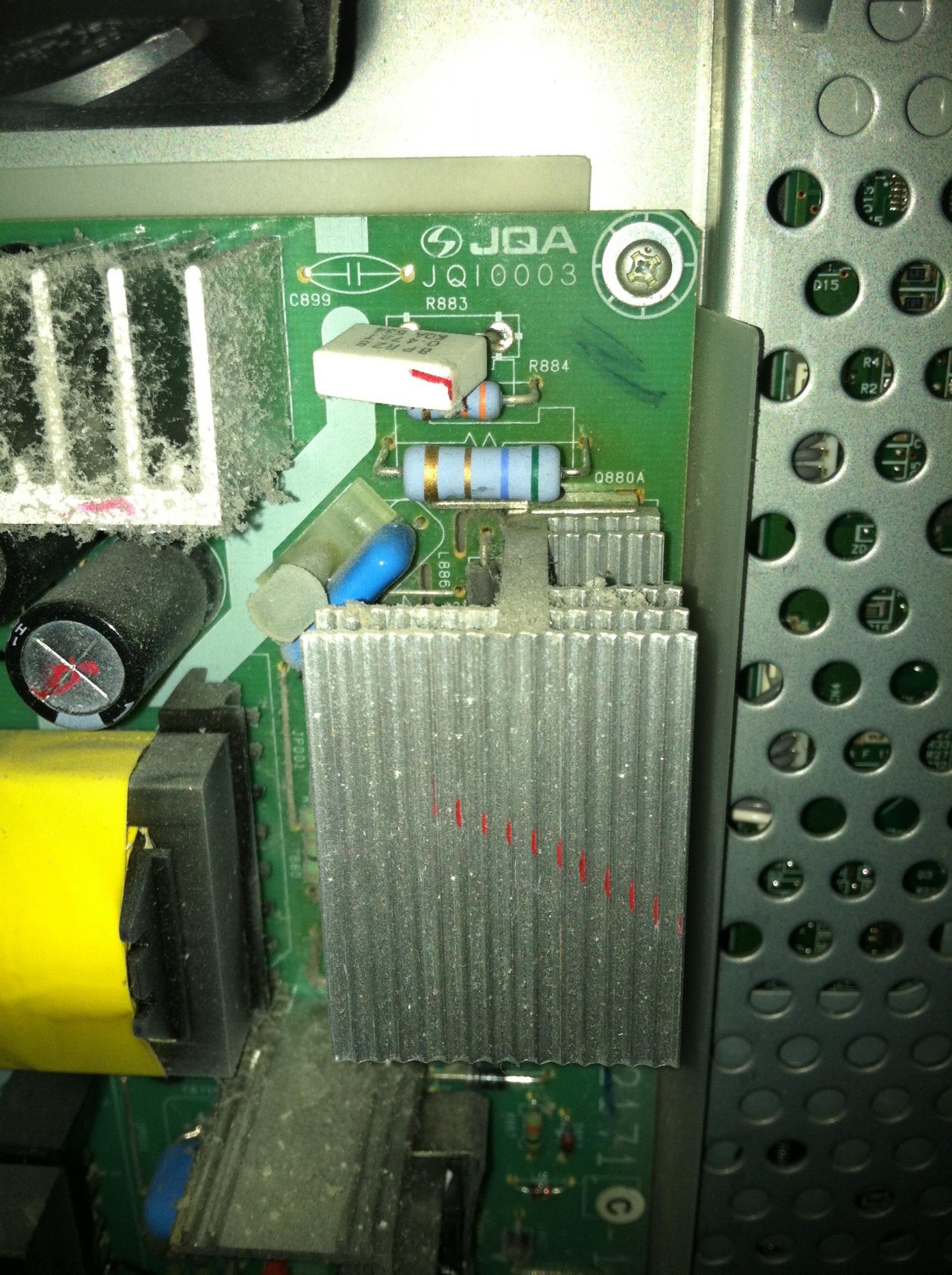

Can you circle it on one of these pictures? I have been hunched over the TV for 30 minutes with a magnifying glass and a light trying to find it. All I can find is things that say Q8XXX, no Q880.Comment

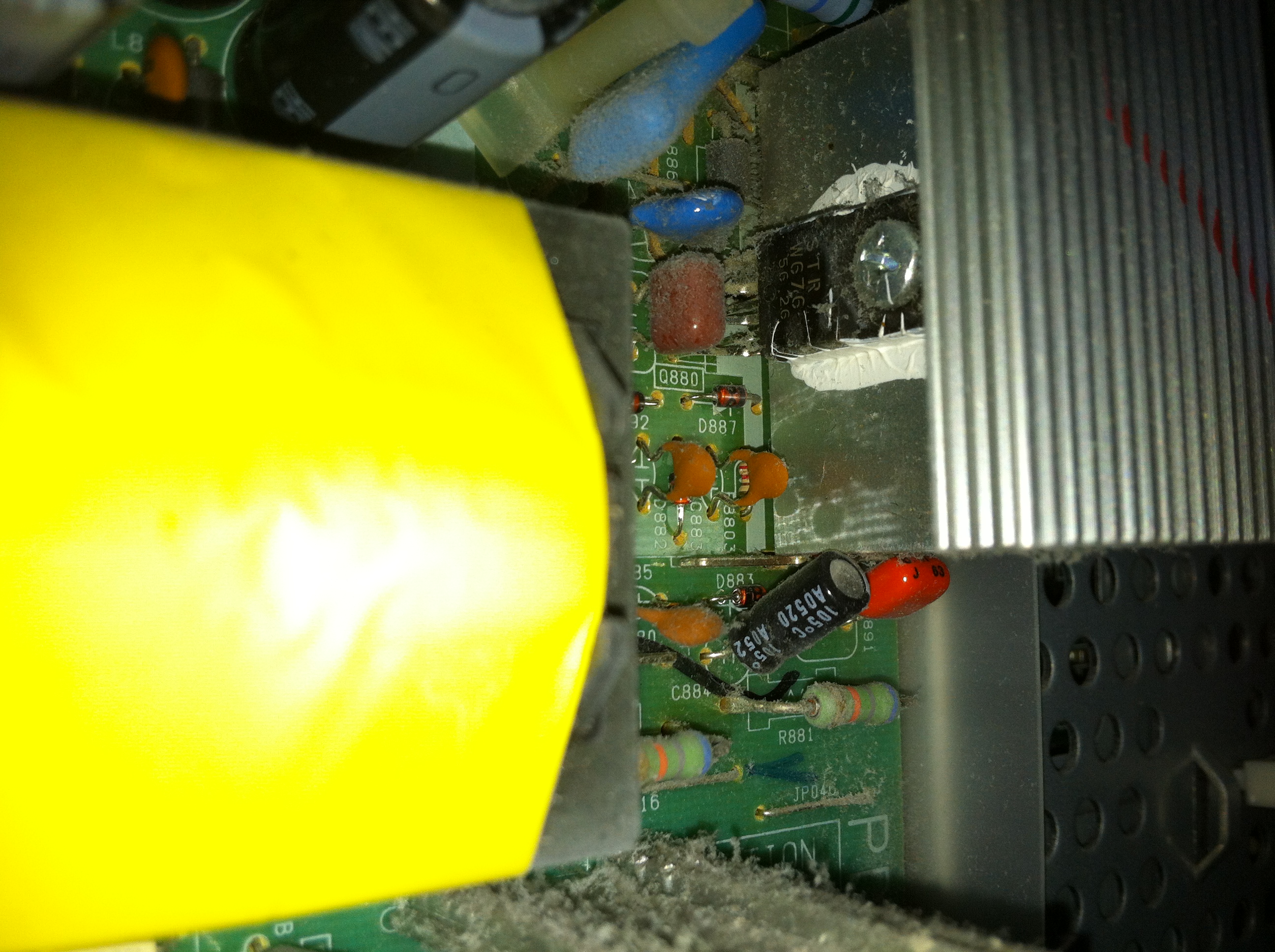

Here is a picture of it:
https://www.badcaps.net/forum/attach...1&d=1344298458
This sounds exactly like what was said in that other thread
(https://www.badcaps.net/forum/showth...213#post212213)
Same TV, Same Symptoms, Same Problem. I think we have found the problem. How do I fix this? What needs fixing? Where do I get the parts?

Underneath that heat sink that I showed a picture of, and to the left ever so slightly, I found Q880 with no "a" at the end. It probably still refers to the silver heat sink. What could be wrong with it that could prevent the TV from turning on?Comment

No it doesnt refer to the heatsink - It is a component that is under the lip of the heatsink
attached to the vertical wall of the heatsink and soldered to the board. Alexanna has said it probably has 5 pins.
You will need to remove the board from the frame then remove the heatsink and the component to check the part number.

The generic part # for Q880 is STRW6765. When I replace that, I also replace Q860, part # STRZ4479, as they most often seem to fail together, and they are not too expensive. I have had to replace these on numerous units of this model, as the power board has not been available for several years.Comment

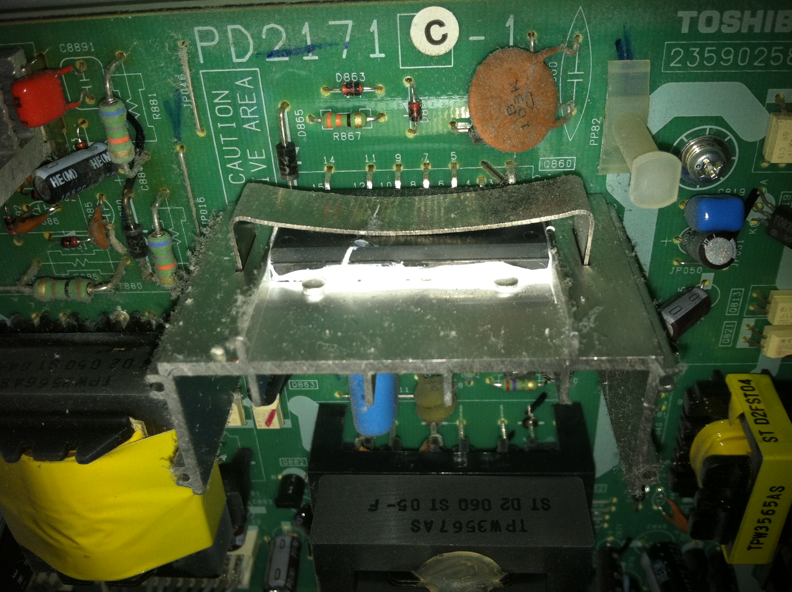

Just to be clear, the thing that needs to be replaced is this:

I found the Q860, but I am not sure what it refers to. Here is a picture:The generic part # for Q880 is STRW6765. When I replace that, I also replace Q860, part # STRZ4479, as they most often seem to fail together, and they are not too expensive. I have had to replace these on numerous units of this model, as the power board has not been available for several years.
https://www.badcaps.net/forum/attach...1&d=1344343044
UPDATE: Is it the black thing inside the metal thing?Attached Filesif you find these attachements useful please consider making a small donation to the site
