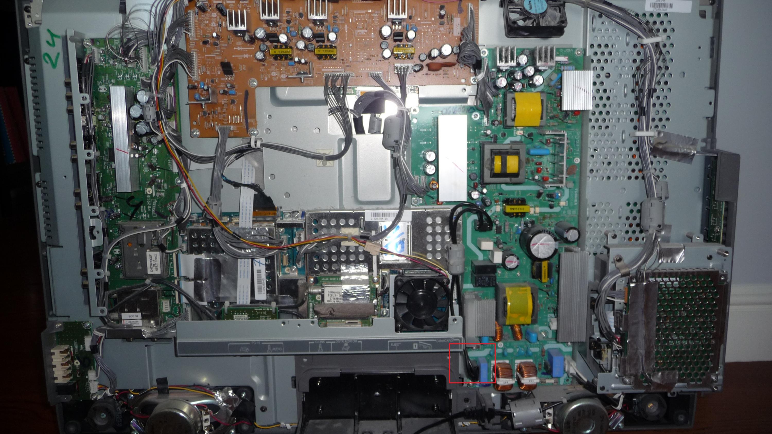

    There are 4 connections coming from the PSU. I am going to try individually disconnecting and reconnecting them and see what happens.
    UPDATE: I tried disconnecting the black plug on the bottom of the green board, a few inches away from the one you recommended, I disconnect, the fans started up for a second, when I tested it, but then it shut off again.

        Can you take some of the covers off so we can see more of the boards? I am not sure of what connector you said you un-plugged.
        Try to find the backlight inverter boards, I think they are under the shielded metal casings.

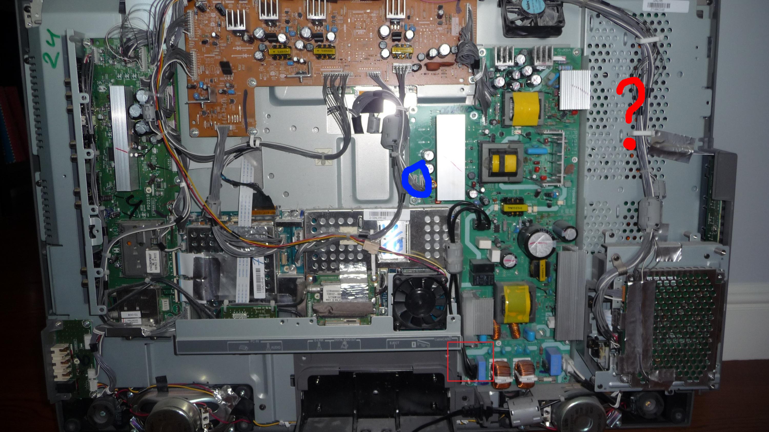

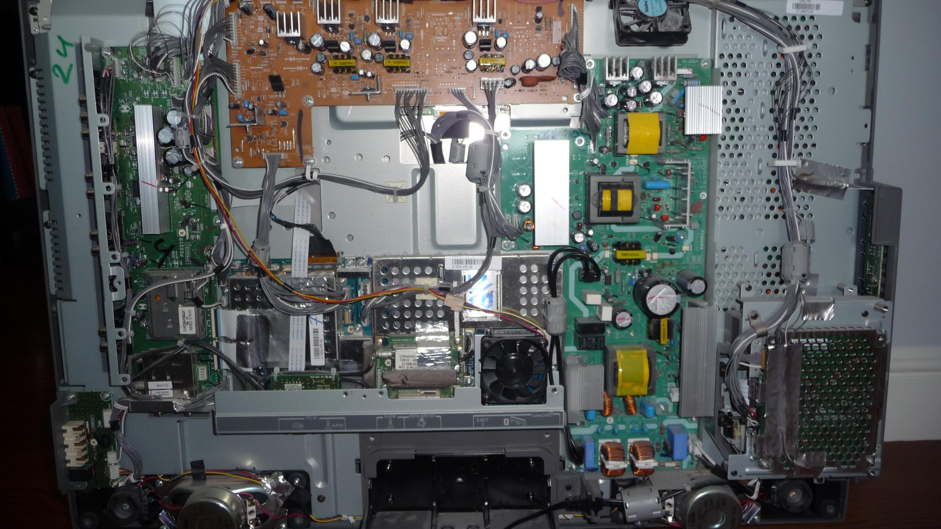

                      Re: Toshiba TV not powering on?
                      Okay, here are some pictures with the metal thing off. Sorry if it is not zoomed in enough. It is hard to capture the whole thing and get the details.
                      Here is that plug you asked about: https://www.badcaps.net/forum/attach...1&d=1344290489
                      Here is it with the metal thing off: https://www.badcaps.net/forum/attach...1&d=1344290489
                              Here is it with the metal thing off: https://www.badcaps.net/forum/attach...1&d=1344291224
                              Here is that plug you asked about: https://www.badcaps.net/forum/attach...1&d=1344291224

                                Ok, so, did you try un-plugging the connectors in the blue circle below?
                                And, what is under the red question mark? I think its the inverter, and we should try to un-plug it to see if it is at fault.

                                      Unfortunately, I cannot get to what is under the question mark since the metal panel is all 1 piece and is welded to the wrest of the frame. Also the blue circle connector does not come off.

                                          You can't. I tried. The metal is all 1 piece and it runs under all the boards, and is welded to the frame of the TV. No can do.
