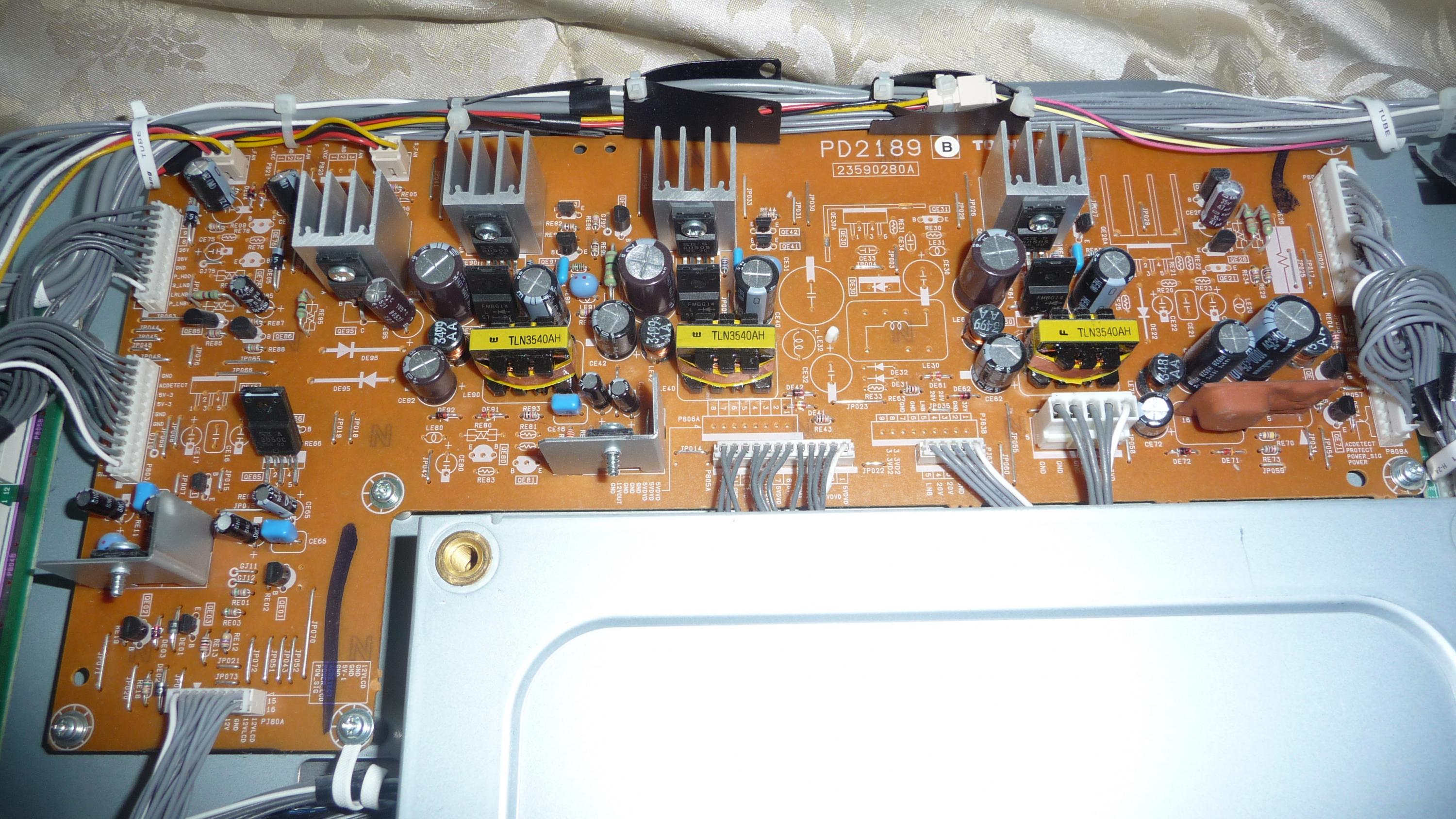

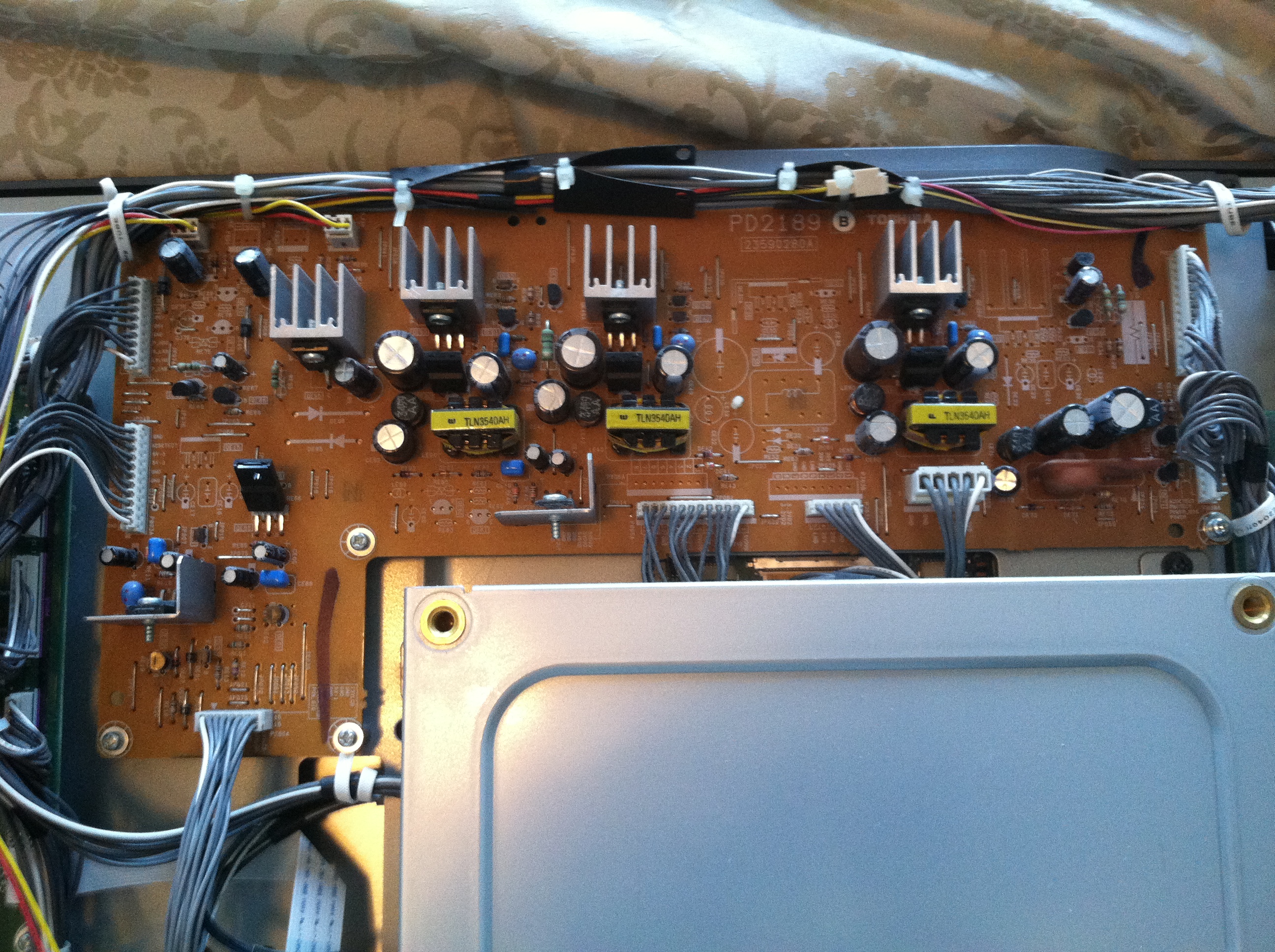

              I changed my mind. I might as well try to fix it. It is a Toshiba 32HLX95. It is 32 inches and it is 7 years old. Here are some pictures:
              Inside the TV
              The PJ63 up close.
              Let me know if you need more info or pictures.

                          Here is the PSU:
                          https://www.badcaps.net/forum/attach...1&d=1344270805
                          I only have a screwdriver, but I can get some more tools if I need to.

                              Pictures are a little too grainy for troubleshooting - we need to be able to read
                              the writing on the board. Not sure what this board is? more like power distribution - can you do the one with the mains connector on it.
                              • randtek
                                • Oct 2011
                                • 280
                                • US
                                Re: Toshiba TV not powering on?
                                The above picture is not the power board. It is the "Sub Power" board. The board we need to see is to the right of this one, is green and mounted vertically. It is the tall board just to the left of the DVD deck. (When viewing from the back of the TV)

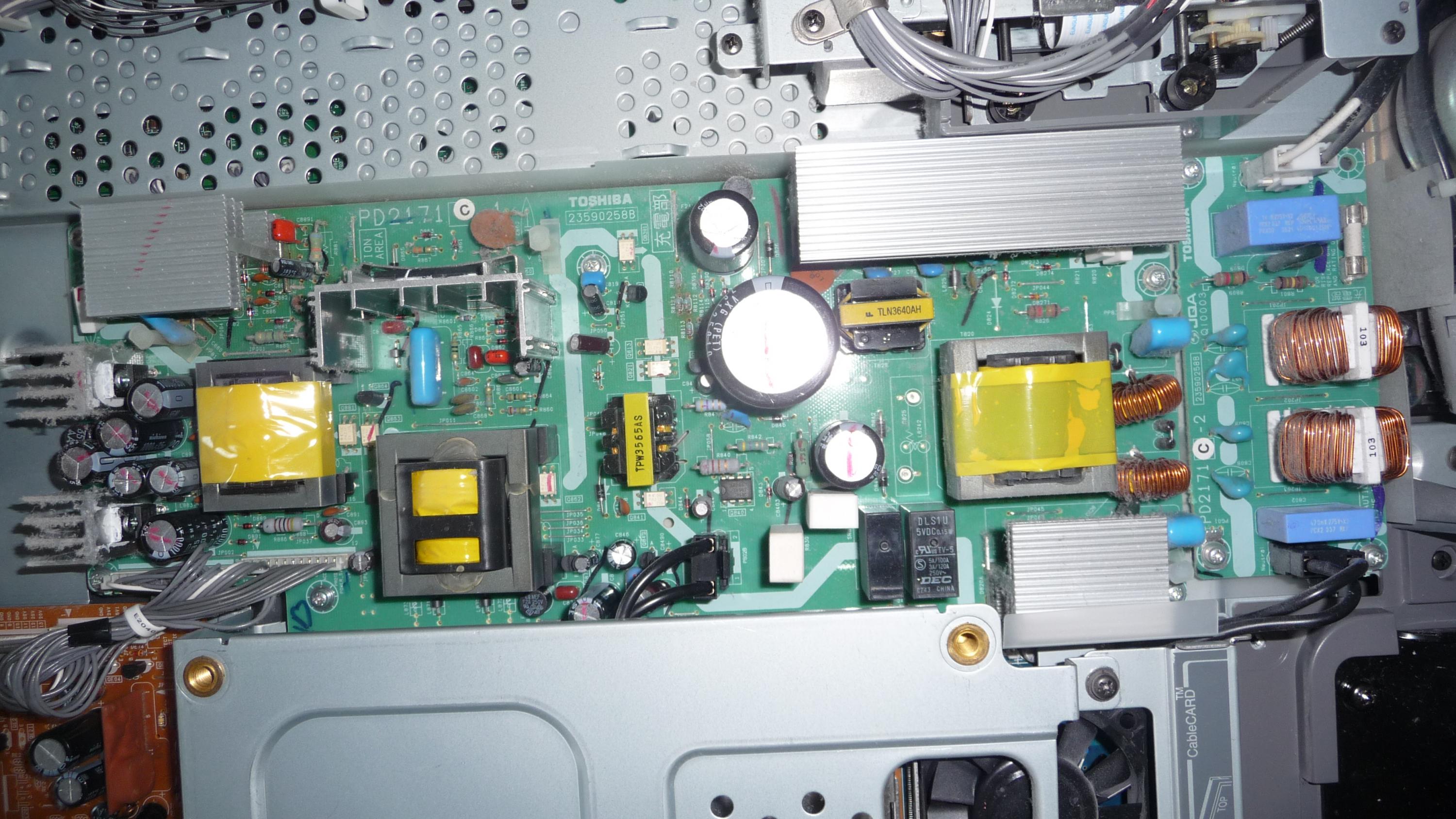

                                    Ok, sorry. I am currently trying to take some pictures with my better camera. It is difficulty to get the whole the board in 1 picture and not lose detail. Hold on.
                                    • Senatov
                                      • Aug 2012
                                      • 51
                                      Here are some high-quality images.
                                      Sub-Power Board: https://www.badcaps.net/forum/attach...1&d=1344273971
                                      Also, my neighbor repairs appliances, unfortunately not TVs, but he just came home for lunch, and I asked him if had a multimeter. Luckily he did, and he offered to test the caps for me. He tested all the caps on those 2 boards, and he said they are all working fine, so I will take his word for it.

                                        Ok, try measuring the voltage on the really big capacitor in the power supply. It should be about 300v DC, if its only about 160v, press the power button and see if it goes up to 300v before it goes into protection mode.
