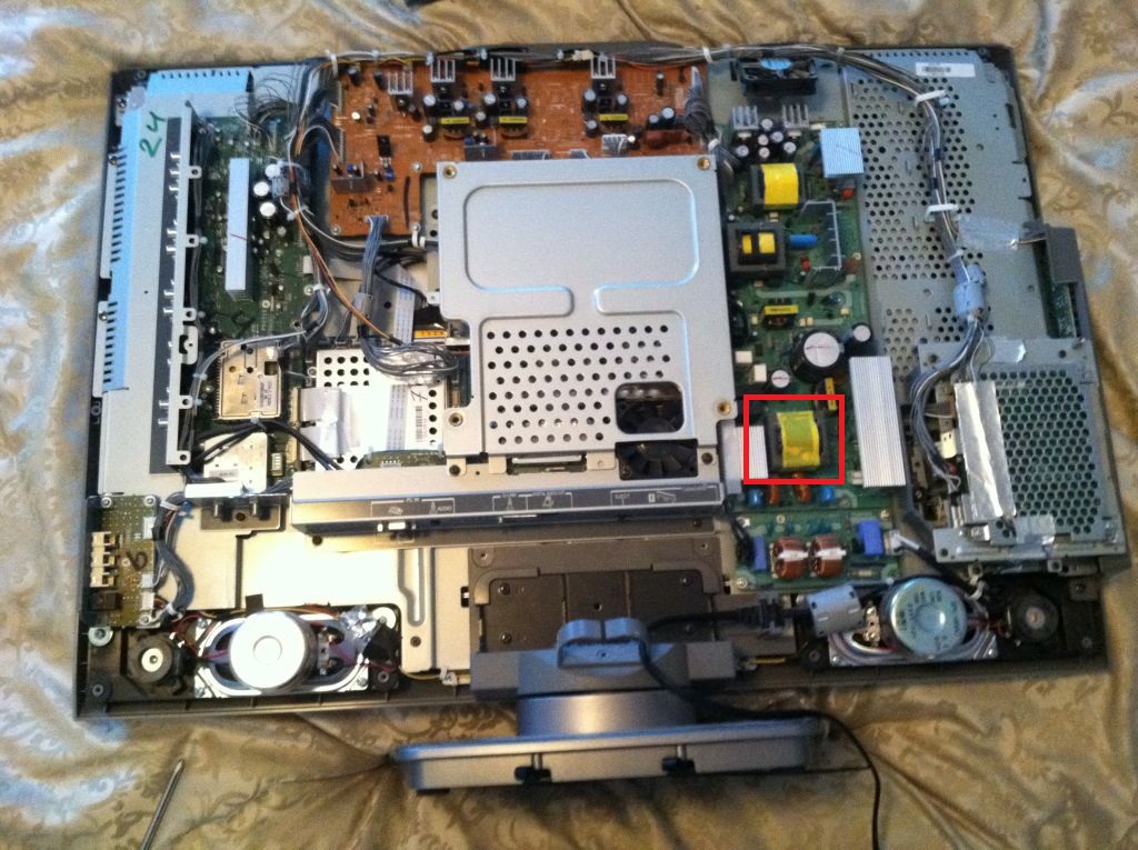

                        I have identified the source of the clicking:
                        https://www.badcaps.net/forum/attach...1&d=1344276648

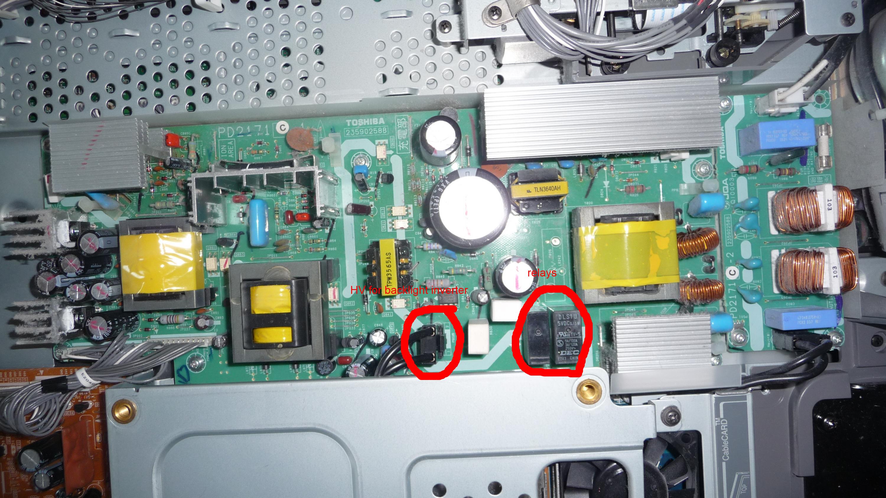

                              I think the clicking your hearing is coming from the two relays next to the yellow PFC choke you pointed out.
                              Muh-soggy-knee
                              • ben7
                                Capaholic
                                • Jan 2011
                                • 4059
                                #35
                                Re: Toshiba TV not powering on?
                                I have attached a pic of the PSU.
                                I circled the relays I was talking about.
                                I also circled a connector which I presume is carrying ~300v DC, it probably goes to the backlight inverters. Try unplugging that and see if it turns on.

                                • Senatov
                                  • Aug 2012
                                  • 51
                                  #36
                                  Ok, I will try in a minute. I am actually working on my irrigation system at the moment. I am having a busy day off. Why do you think that the clicking did not happen when the TV worked?

                                      Well, it should click on when you press the power button. It might happen as soon as you press the button, so maybe you have just thought it was the sound of the actual power button clicking.
                                      When our samsung plasma broke, it kept power cycling, and the relays kept clicking every few seconds. Two transistors later and some soldering, it was fixed.
                                      I'm not so sure anymore that the connector goes to the backlight inverters. Most likely they are on the sides, under the perforated metal covers.
                                      Muh-soggy-knee

                                        Ok, I tried it. The clicking stopped with that unplugged, but the TV still does not turn on. Still no red light. I really appreciate the tremendous support.
                                          Yeah, I thought so.
                                          After careful looking at the pics, that seems to be the main power input from the filtering board next to/below the PSU.
