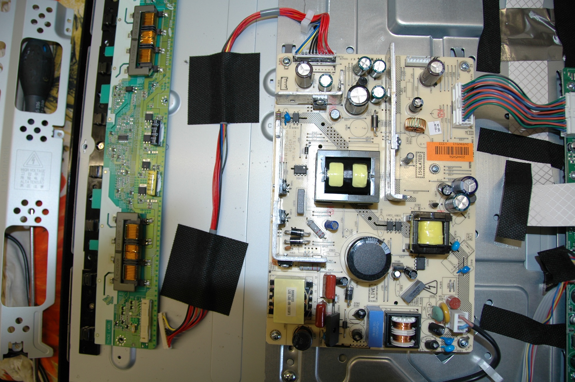

Re: Sanyo CE32LD47-B flashing standby light
Picture is no good for us to help look for cold joints - perhaps tryagain in natural light tomorrow?.
Looks like a Voltage regulator which is odd for an IC number I wonder if that relates to something missing off the board or on the other side ( have made that mistake before and it could be a mosfet) - do you mean you cant read the part number?
Try and clean it with isopropyl alcohol and use a magnifier
Sanyo CE32LD47-B flashing standby light
Re: Sanyo CE32LD47-B flashing standby light
they do suffer BADLY with cold joints,ive repaired a few vestals now,everyone had cold joints,in fact in one of my other posts,there was one where i could pull the caps off without unsoldering them,well shocked !,and i found one with a galvanised roofing nail cut down,and used as a 3.15 antisurge fuse!,the bridge was in meltdown ,totally blown to pieces only the legs visable lol,the makeshift fuse was ok though
Leave a comment:
Re: Sanyo CE32LD47-B flashing standby light
I believe a lot of the boards suffer from poor soldering , cold joints so can you get a picture of the back of the board - the front one is really good- thanks.Leave a comment:
Re: Sanyo CE32LD47-B flashing standby light
on pin 12 of pl802 what resistance reading do you get with respect to cold ground?Leave a comment:
Re: Sanyo CE32LD47-B flashing standby light
Tom66 knows a lot about these vestel boards - hates them- so you will probably get him going.
Does the backlight flash on at all during startup? Is there any sound?
Is there any noises, hissing ,ticking, have you been trying it with a known source
dvd or pc.Leave a comment:
Sanyo CE32LD47-B flashing standby light
Hi Guys
This set has the Vestel 17PW26-4 power supply.At switch on the 24volts and 3.3volt lines come up that supply the inverter but no enable voltage on pin 12 PL802. After a few seconds power supply powers down then restarts then powers down again then powers down for good with standby light constantly flashing.Unplugging the supply to the inverter produces the same symptom.Does anyone know if this board will work without a load on it.Is it shutting down because the back lights are not starting?Any help in diagnosis will be appreciated.
Thanks.
Dave.Tags: None
by 7onyThe TV is a 2013 Samsung plasma, model # PN60F5300AFXZA.
Snagged it up in non-working condition a couple years ago. Previous owner said that sometimes he could get it to come on after repeated tries but other than that he couldn't get it to turn on.
Personally I haven't been able to get it to turn on at all. The standby light comes on solid when plugged in, but pressing the power button results in the standby light flashing once every 4 or so seconds. No "click" noises, no light from the panel at all. Just the flashing standby light.
No visible... -
by BloopetaHave a Samsung UE43KU6400U that will not turn on, just continuous flashing red standby light.
Power button does nothing
Have unplugged the mainboard, and backlights illuminate.
Have tried removing panel ribbon cables one at a time, and that makes no change.
With mainboard unplugged, all voltages from powerboard seem ok, but with mainboard connected, they never quite reach full voltage, and drop and raise in a constant loop (in time with click noise from mainboard.
Using backlight tester, I get 63.6v on both sides, so seems like no bulbs... -
by fuxxyThis is a set I posted about a few years ago. Replaced LED strips and worked fine until now.
Plug the set in, and it will turn on and functions with no issues.
After a while, (sometimes hours, sometimes minutes, sometimes immediately) the tv shuts off. When I approach the TV I notice the standby light is flashing rapidly, but the pulse of each flash is not long enough to notice from afar.
Other than the standby light, the unit is completely unresponsive until the power is removed and reapplied, then the cycle starts over. It does appear that the time it takes... -
I got a Samsung The Frame 55 inch TV for free from uncle cause it is not turning on anymore. I am in the second year of training as an electrician so I have knowledge already but I am far away from to be a pro.
The TV has Standby but ist not turning on. A Friend of mine owns a 50 inch Frame TV so I checked the One Connect Box and the One Connect Cable there. Both are good and working normally. I have opened the TV case and measured some voltages on the Board.
What I already found is that the 12.8V are not an the connector to the main board connector to the power... -
by esqmoooHello everyone.
This is my development machine. I've been using it since two years and half without any problem except sometimes it wouldn't wake up from sleep.
Lately the issue became more frequent and powering it up would take few seconds to show the POST screen.
Then the computer refuses to power on at all. Now only the caps lock button flashes 7 times then stops. The charging light is always on whenever a power source is connected (battery or charger).
I tried long pressing on the power button, after several seconds it would go off then when the button is released... - Loading...
- No more items.
Leave a comment:
