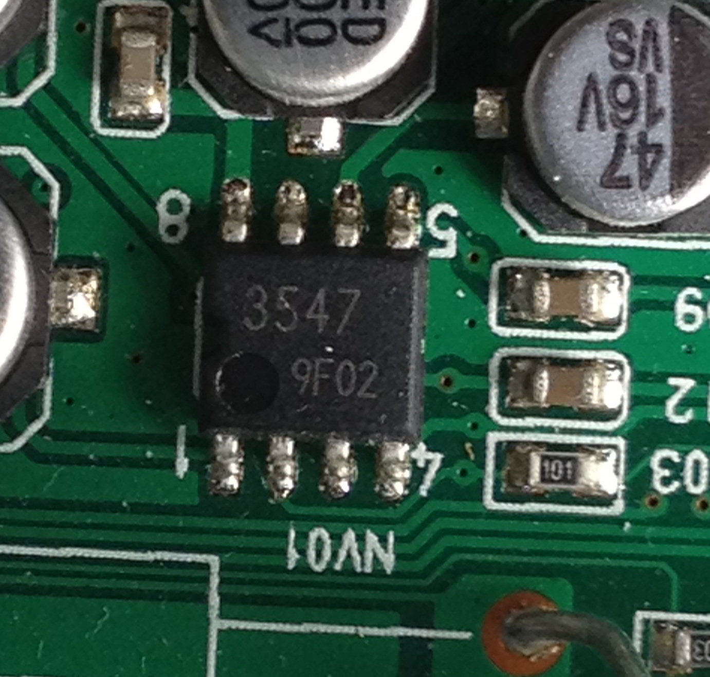

    What are the markings on these 3 chips? Just peel off the paper label that is on one of them.

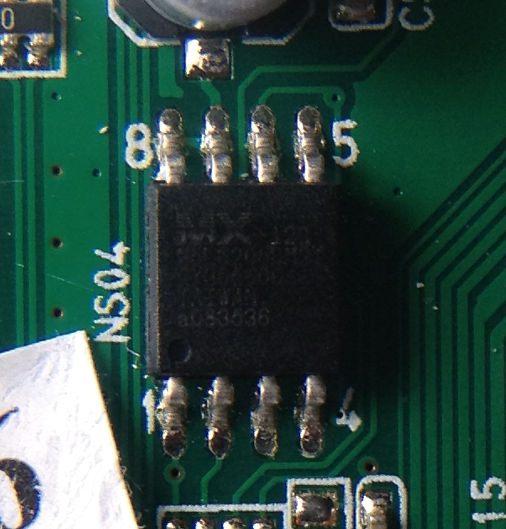

      Heres each IC chip going from left to right. I couldn't make out the middle one with paper peeled off.

        The first one is a headphone amp.
        The second one, I cant read the text on it either.
        And the third one, I cant find any info on it.
        Try getting a bright flashlight and putting up to the chip, and move around and see if you can make them out.

          Second one is probably serial FLASH due to its size.

            Thats what I am thinking, its hard to figure out the marking codes for them.

              Eh no luck, i can't seem to make any of it out, my eyes are going =/

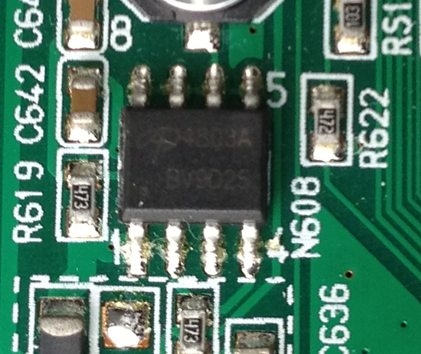

                      Is the last one not a 4803a
                      http://www.digikey.com/scripts/DkSea...O4803A&cur=USD

                        It sure is! The symbol is the symbol for Alpha & Omega too.
                        Tieny, whats the voltage on pin 5 of the AO4803A?

                            If only I had some chalk. On pin 5 I get 0v

                              What voltage do you get on pins 2 and 4?

                                Both pins I get 11.34V

                                  So that chip must be ok, and its powering something.

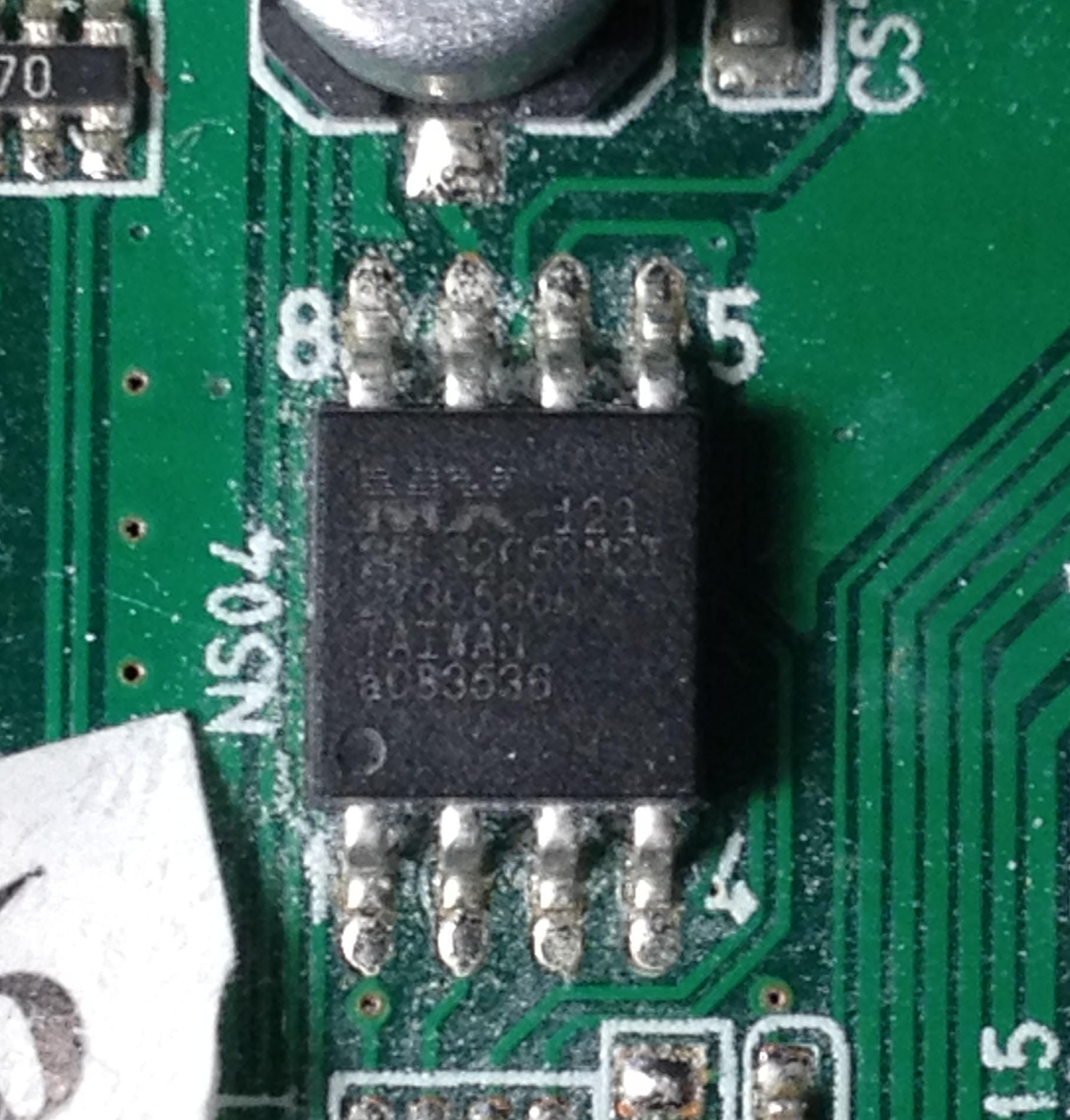

                                  We should figure out what that other chip says on it.
                                  Try taking a few more pics to see if you can make out what is written on it, and try it with flash a few times too.

                                    I didn't have chalk so I used baby powder instead, I can kinda of make out the numbers now more than before.

                                      That middle chip - is it the one that had the label on- what did the label say.
                                      Also it may just be glue obscuring the lettering even if you havent any chalk
                                      try cleaning it with alcohol.

                                        I just figured it out, its a MAX120 ADC chip.
                                        EDIT: Turns out its NOT a MAX120, I don't know what it is.

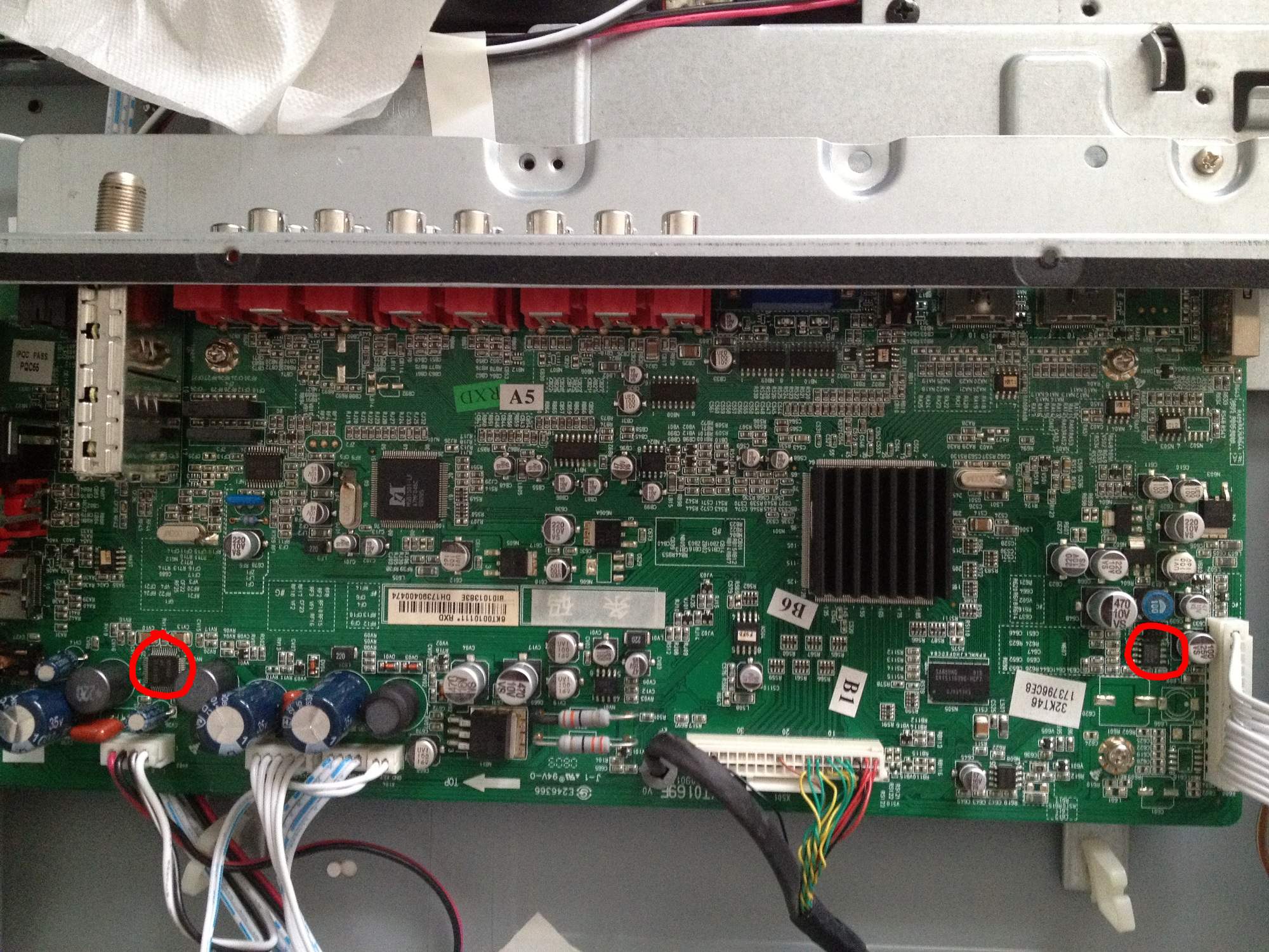

                                          Tieny, you said you found 6 voltage regulators on the board back in post 38.
                                          I see two more chips that I think could be voltage regulators.
                                          They are both near inductors and capacitors, so I'm guessing they are buck-regulators.
                                          What are their chip numbers?
