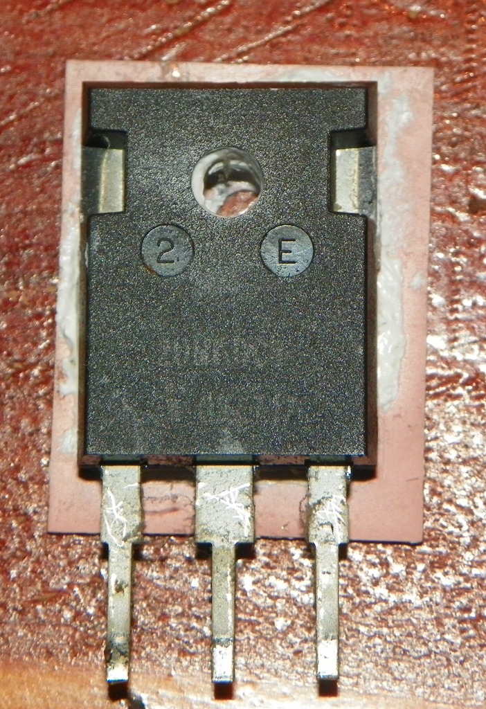

    Hi part numbers look good. For the 2E one perhaps put up a closeup picture
    someone may recognise something.
      #42
      Re: Vizio VW42L -No Power/Fuse keeps blowing
      Thanks for the data sheet. I have attached a close up pic of the 2E FET. I hope you can recognize this.
        There's definitely a marking below 2E if you look carefully.
        Try this trick:
        http://electronics.stackexchange.com/a/5410
          #44
          ^^ I Agree
          We need CSI on this failing that perhaps you could do something with the original picture as it obviously degrades each time its saved. ( That is why I have saved as bmp on this occasion)
          I get the attached which looks like it starts with 20 - not a lot of help but gives you the idea - I messed with color depth etc then changed to a negative view.
            I have talked myself into believing it could be 20NK50 something
            What does anyone else think.

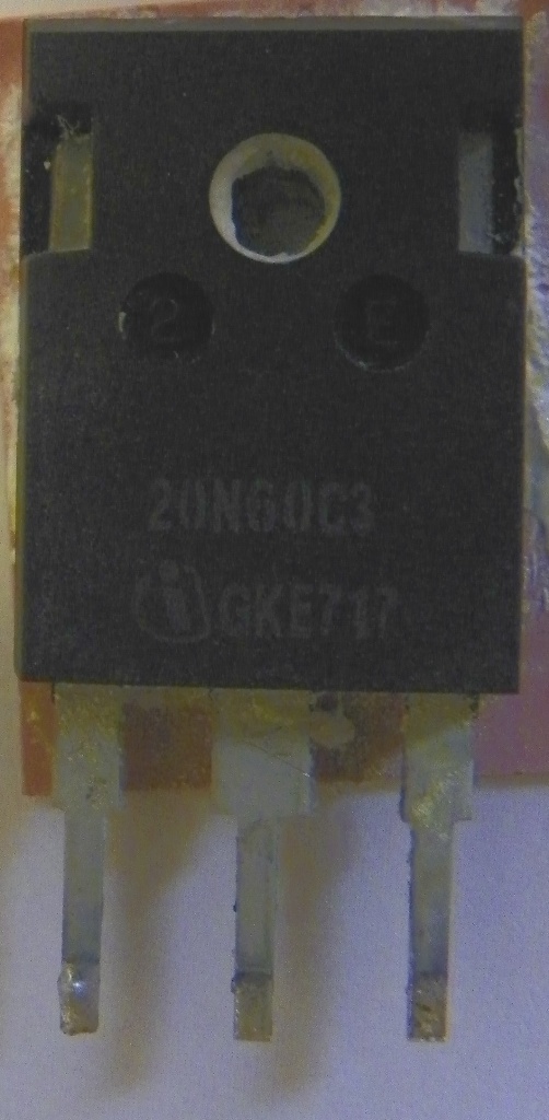

                The chalk trick worked.....
                Here are the bottom numbers from the Q801 FET that I thought
                just had an (2) (E)
                The bottom numbers are:
                Q801
                20N60C3
                GKE717
                I attached a pic of it.

                  Is there a datasheet for this part available?
                  Q801
                  20N60C3
                  GKE717
                  Thanks,
                    #49
                    Looks like this one:
                    http://www.digikey.com/product-detai...C3IN-ND/509556

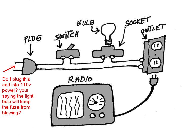

                                    http://antiqueradio.org/dimbulb.htm
                                    Get into the habit of using one of those when powering up anything that has had a blown fuse. If something downstream is shorted, the bulb will save you fuses, MOSFETs, and a whole bunch of other parts. Use a 40-60W bulb for small sets and a 100W bulb for large ones. The bulb will always be enough to start the set in standby mode if all parts are good.
                                    Check the MOSFETs that you replaced. You may have the nasty surprise that they're all gone again.

                                          I do like the idea of the light bulb to test with, I had a question just to make sure I understand, the other end I have marked in the pic does get plugged into live 110v power and the light bulb keeps the fuses and other parts from failing?
