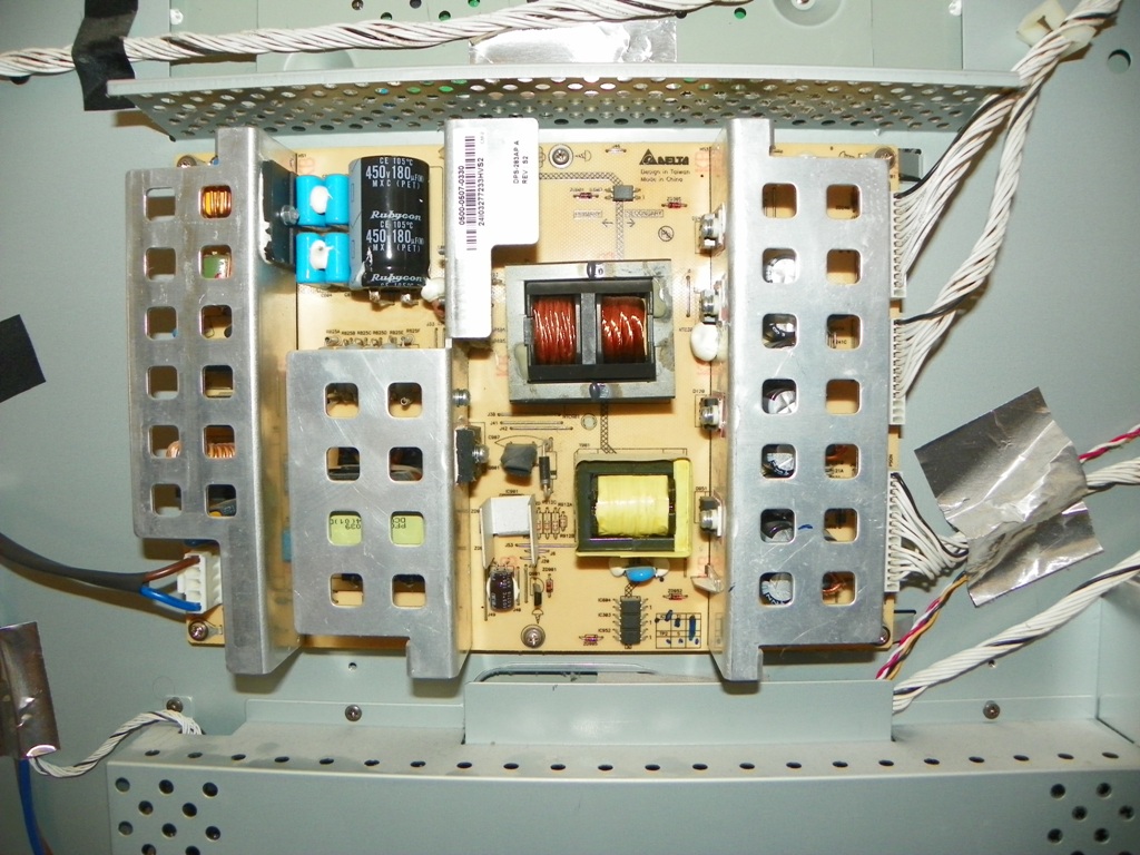

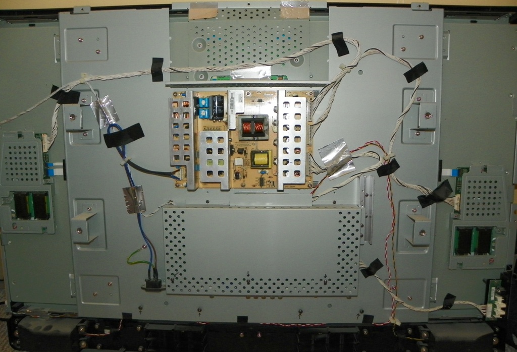

      Re: Vizio VW42L -No Power/Fuse keeps blowing
      Here are some pics from the inside of the TV.
      I appreciate you looking at this for me.
      Can you point out to me were the bridge rectifier or MOSFET
      is located. How would I test these to check if they are bad or good?
      Thanks again..

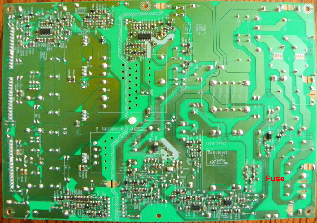

        Can you unplug the PSU and unscrew it, and post a picture of the underside (green side)?
              Here is a pic from the backside of the PSU.
              Thanks again for your time with this. I marked on the pic the area of the fuse.

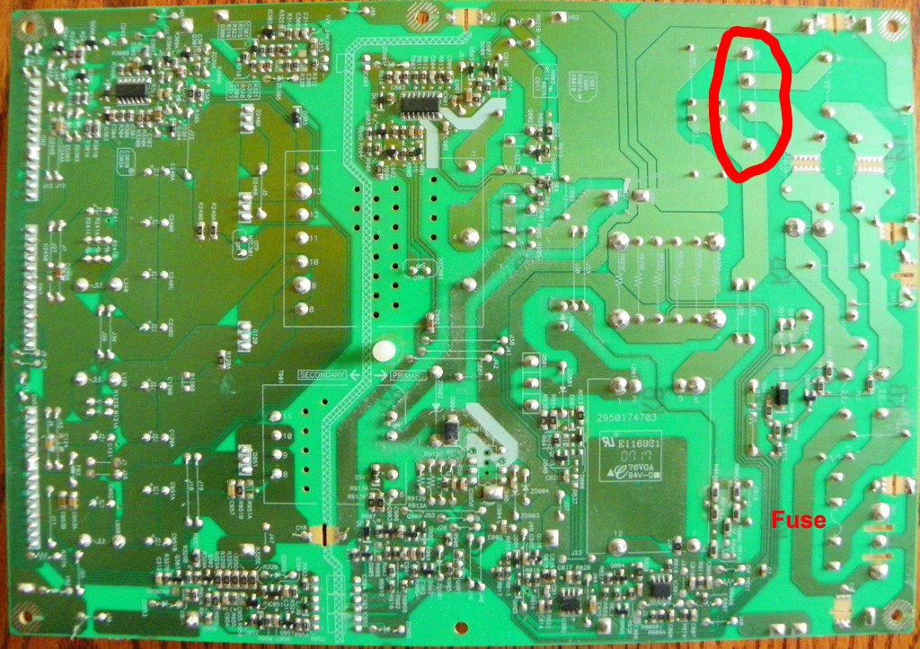

                This is your bridge rectifier.
                To test:
                - Unplug board.
                - Mentally number the pins 1 thru 4.
                - Set meter to DIODE test; red probe in VOLT/OHM, black in COM.
                - Test from 1 to 2, 3, 4.
                - Test from 2 to 1, 3, 4.
                - Test from 3 to 1, 2, 4.
                - Test from 4 to 1, 2, 3.
                If the bridge is good, on all readings you will either get a single "1" or "OL", or a reading around 400 to 800. If something is bad with the bridge or something further along the line is shorted you will get zero or nearly zero.

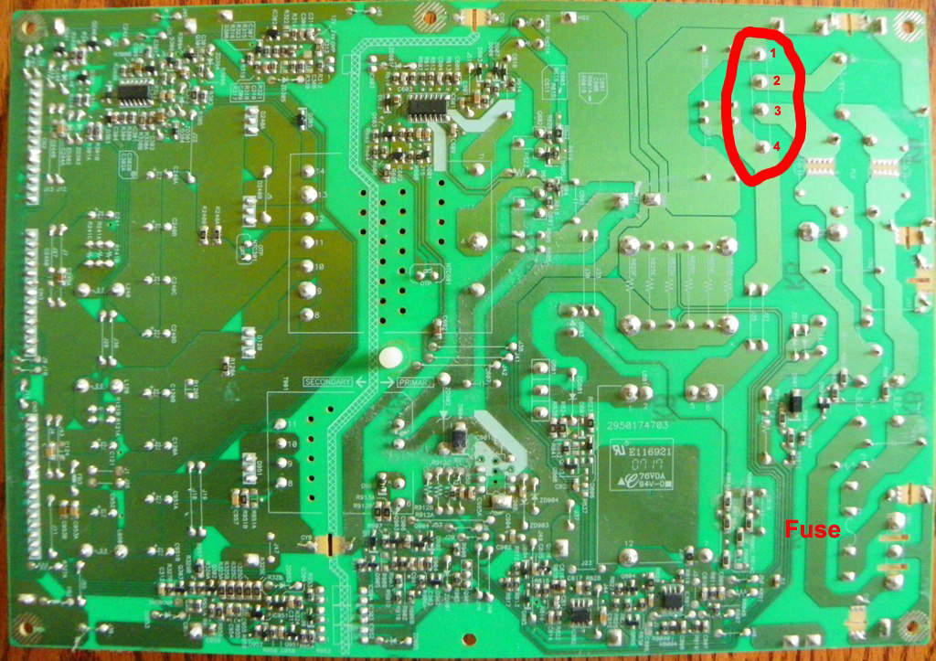

                  let me know if this pic is not clear enough and I will post another one, I didn't know how large of a photo I could post.
                    Gah! I'm an idiot!
                    I forgot to upload the attachment.
                    Try my test this time with the attachment to help.
